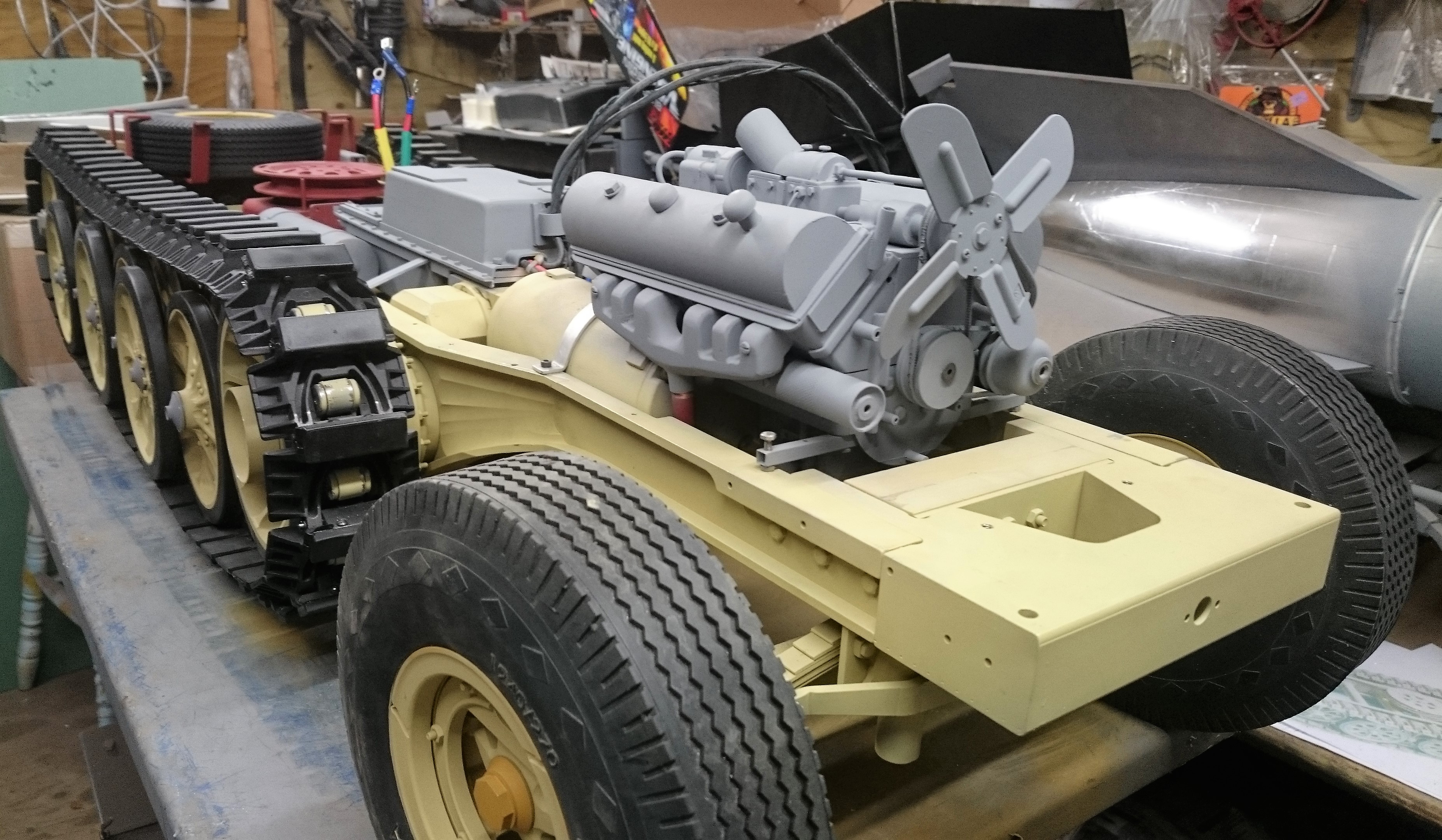

nice detail to place an engine in there, big area to fill, regards simon manning.

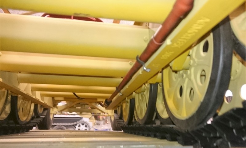

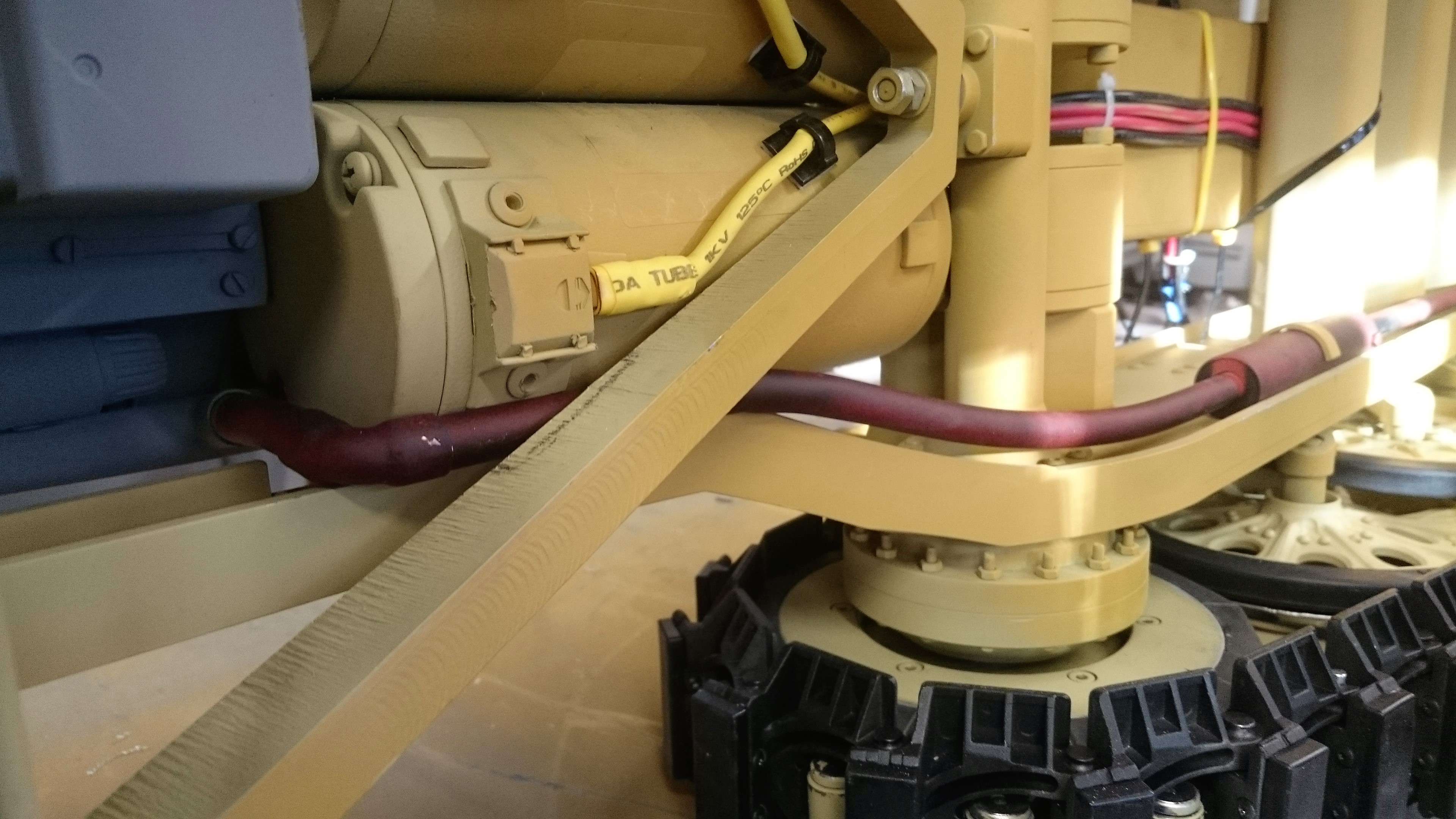

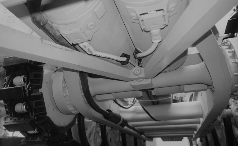

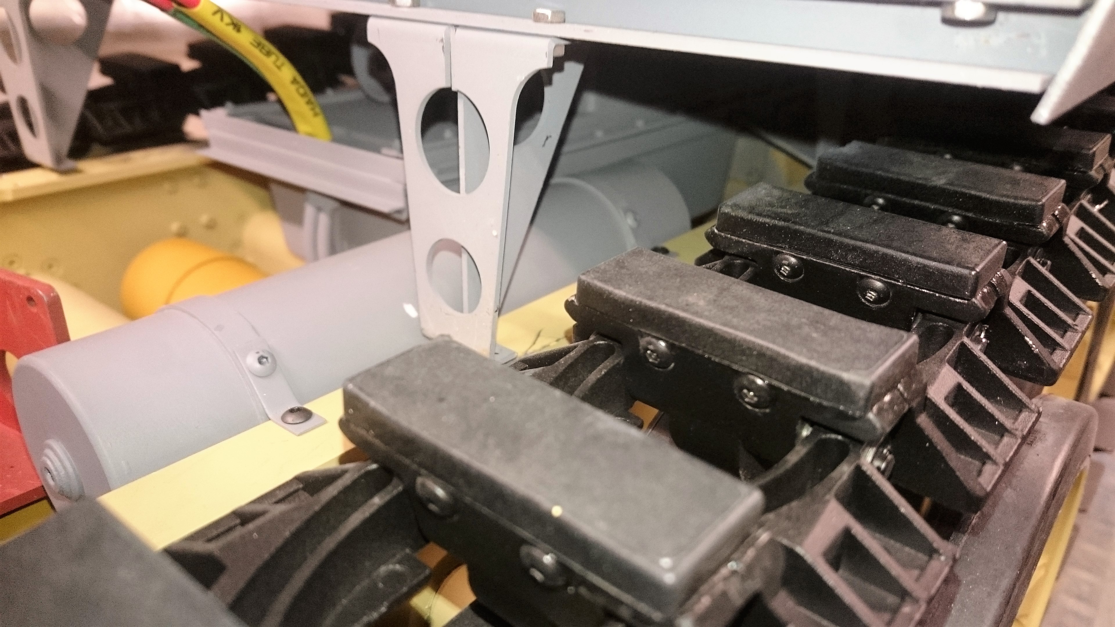

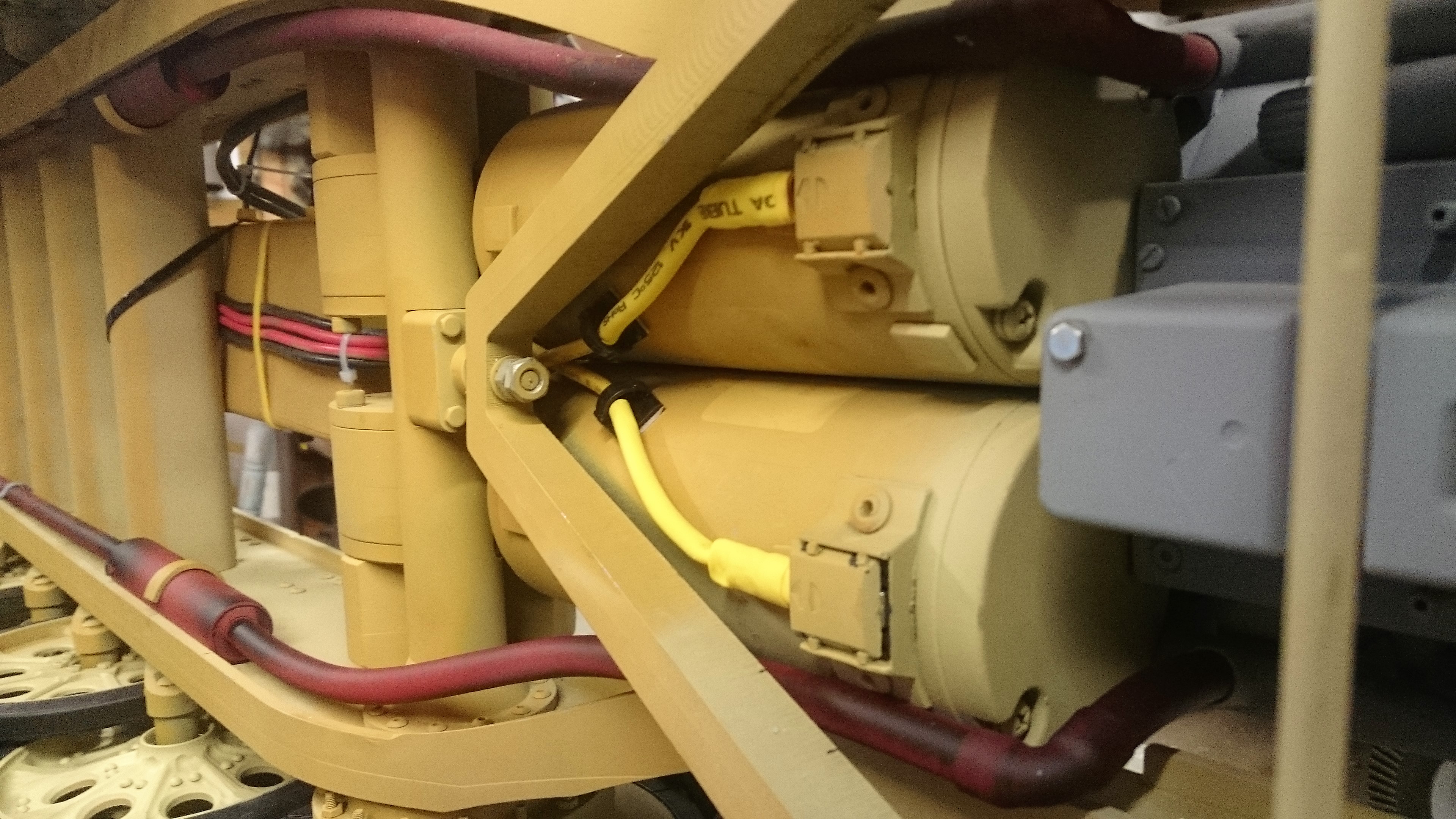

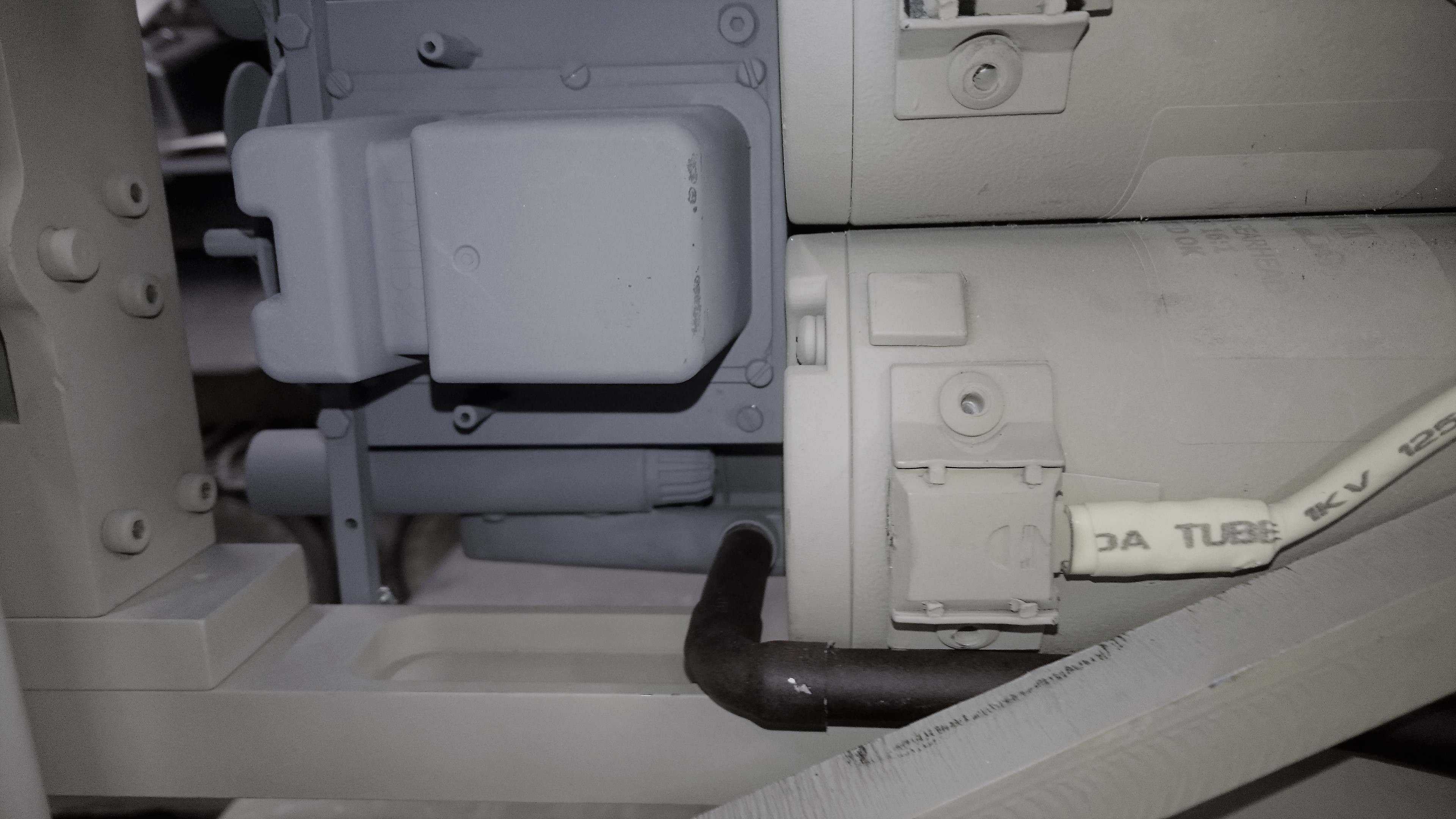

Made and fitted one side of the exhaust system. Now for the other side. The next job is to fit 3 air tanks, two across ways and one longitudinally next to the gearbox.
Theres just enough room between the motors and the front suspension "A" beam, although I have removed some material from the beams top edge just in case. The real exhaust pipe would sit just inside the chassis rail but there's two dirty great electric motors in the way.

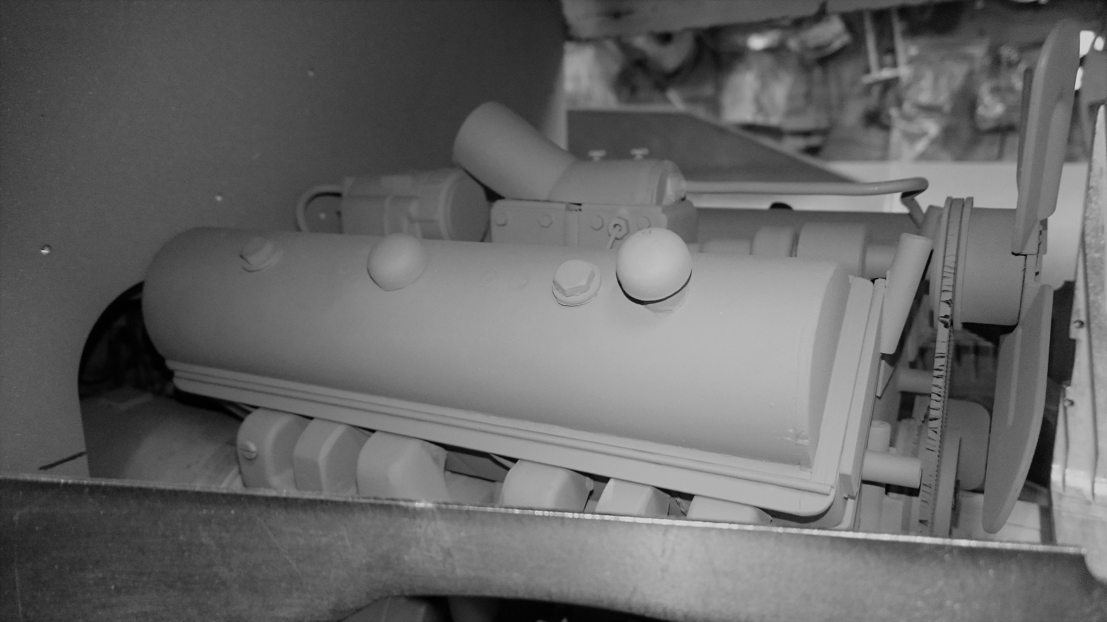

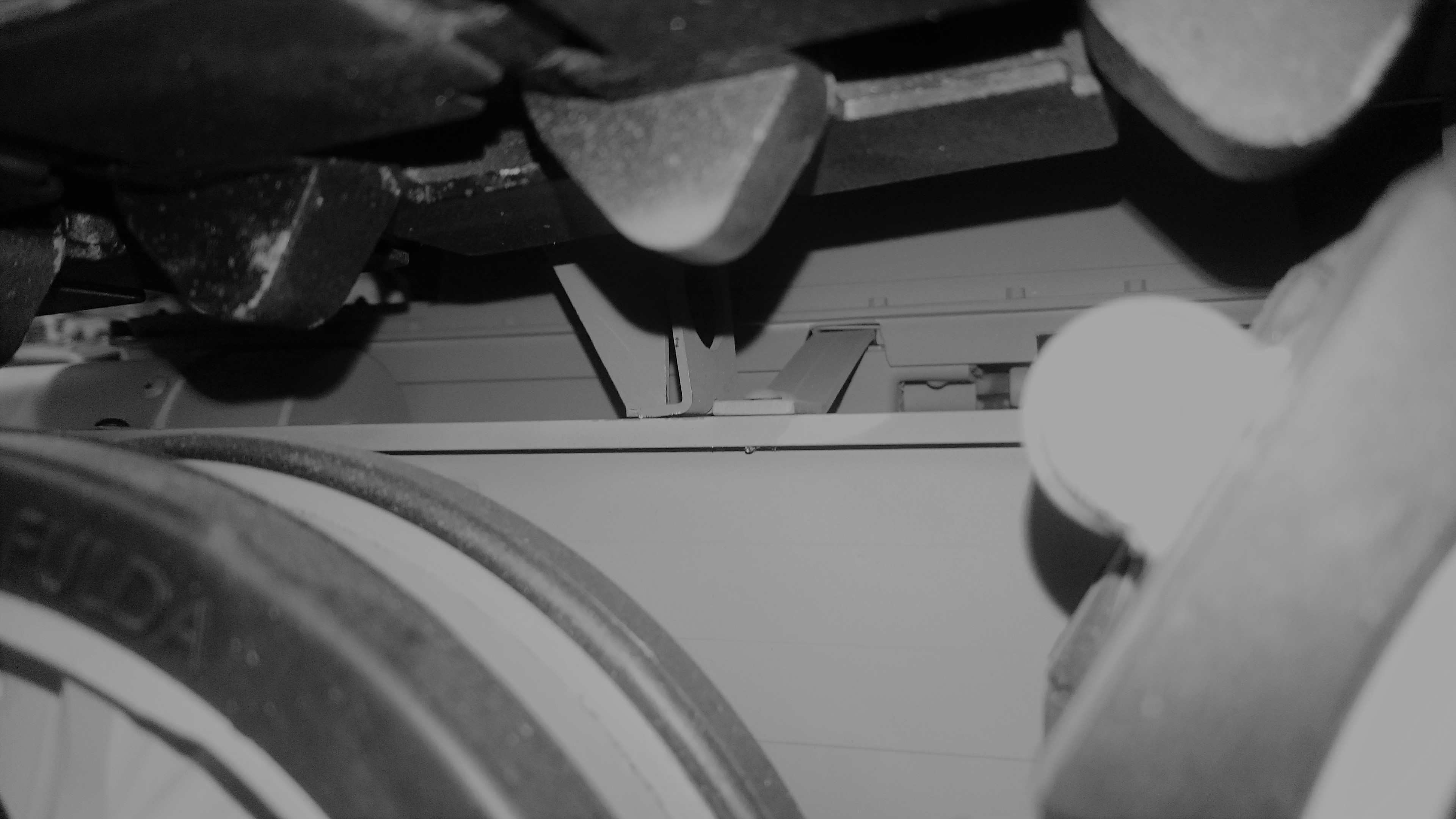

The exhaust riser is a push fit into the header collector pipe, this enables the dummy engine to be lifted away if needed

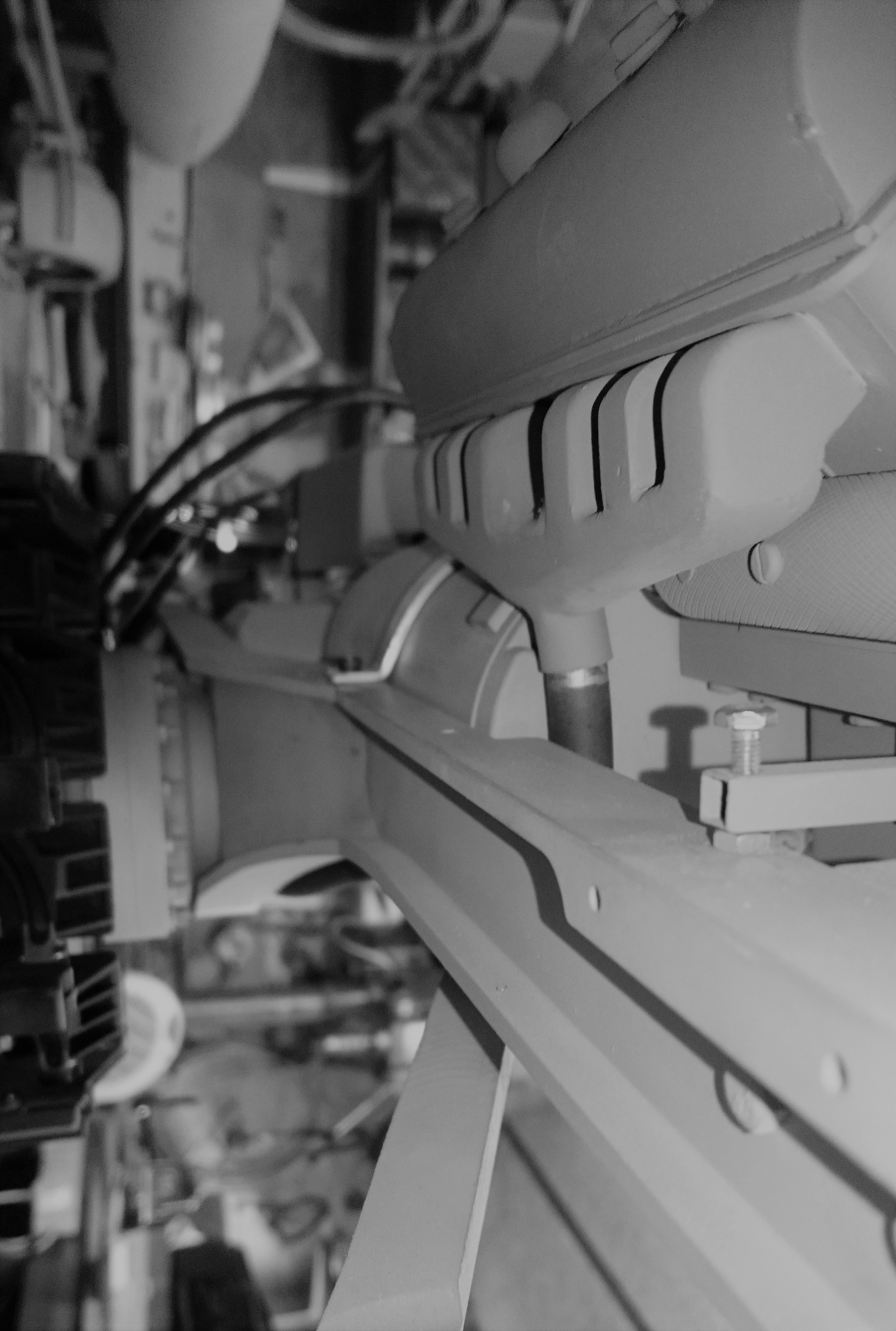

For this job it's easer to work on tipped on it's side.

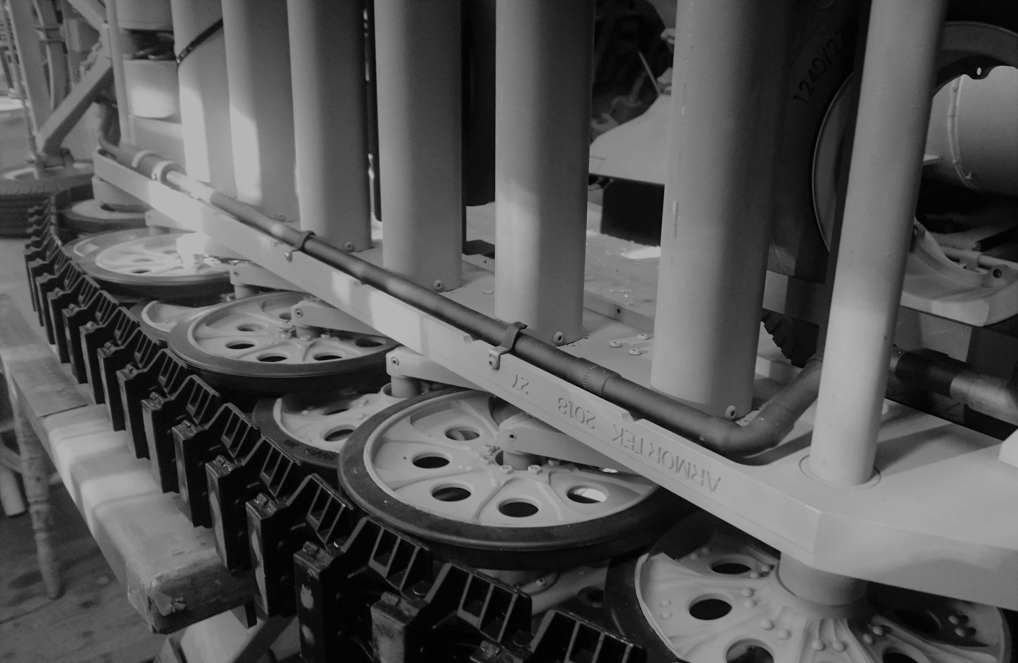

Half a sump! I must add a sump drain plug.
All made of 8mm copper pipe and fittings
It's so long!
It's so long!
Re: Phils Famo build
All done, now to those air tanks and then the dummy gearbox to disguise the esc and cover those cables. So much for an "out the box build" :?
The sump now has a drain plug, looking at the reference material I need to add an oil filter also.

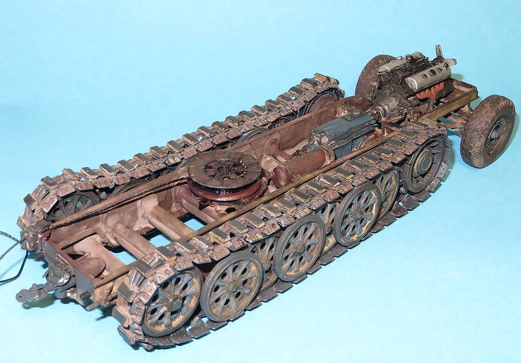

Hi Florian, 8mm copper oil pipe, you can buy it with a plastic sheath, which you then cut away ( this is the best way to buy the copper tube for this kind of work as the metal finish is perfect under the plastic ) then use corresponding 8mm elbows and tee's and couplers. Use cyno to bond as soldering is not necessary. Cut with a dedicated pipe cutter as this forms a nice chamfered end. Season to taste and serve on a bed of spinach. :lol:

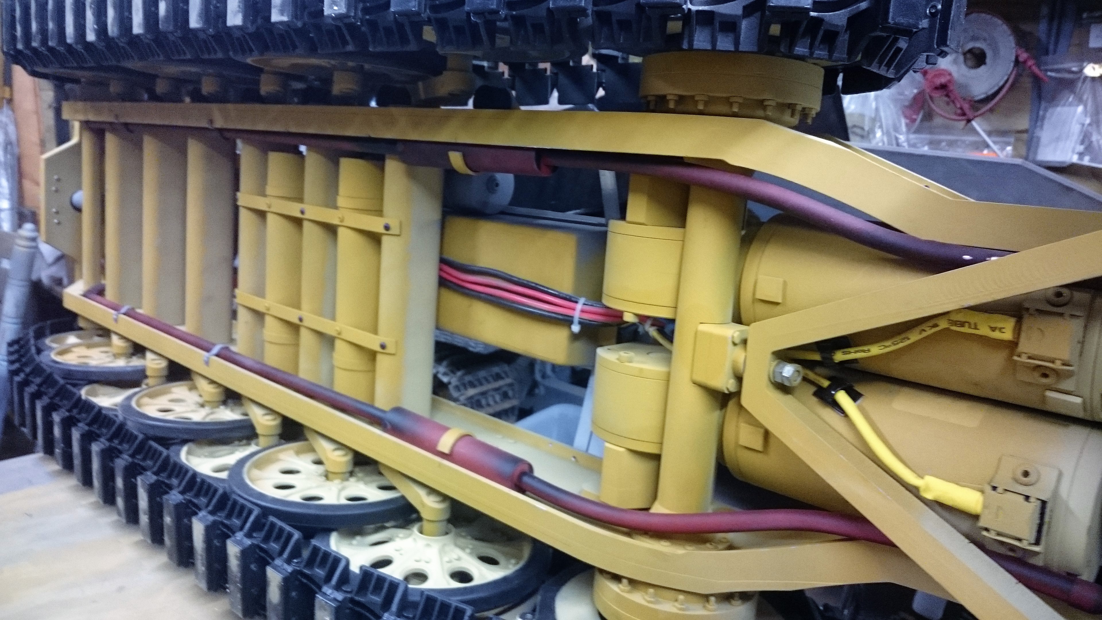

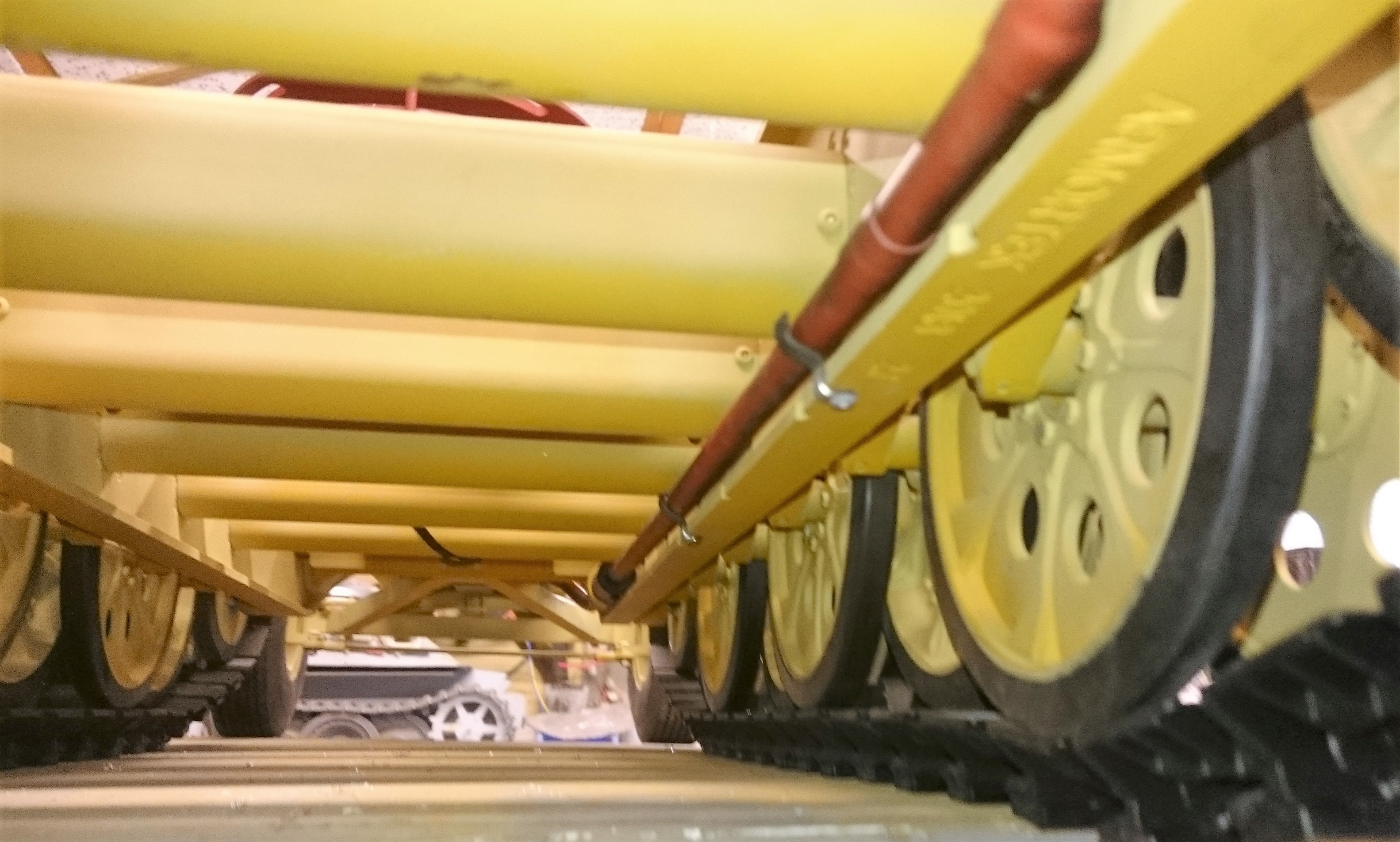

I do like the colours and weathering on this example

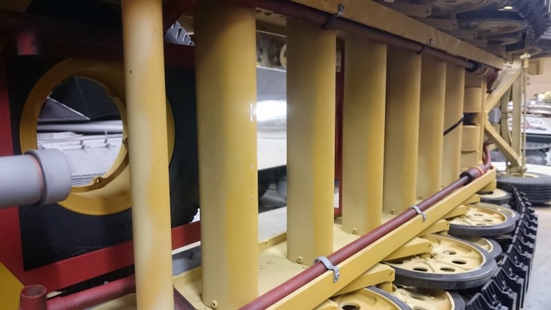

Here's a photo I have never seen before

Thanks Phil,
so I thought about.
On your secound picture is exact the FAMO I'll build. Is the FAMO with the tiger image, because helping the tiger 813 in Beja Tunesia.
I have a spare very reasonable new early Tiger 1 kit for you to make that tank 813 if you want it? Regards Phil

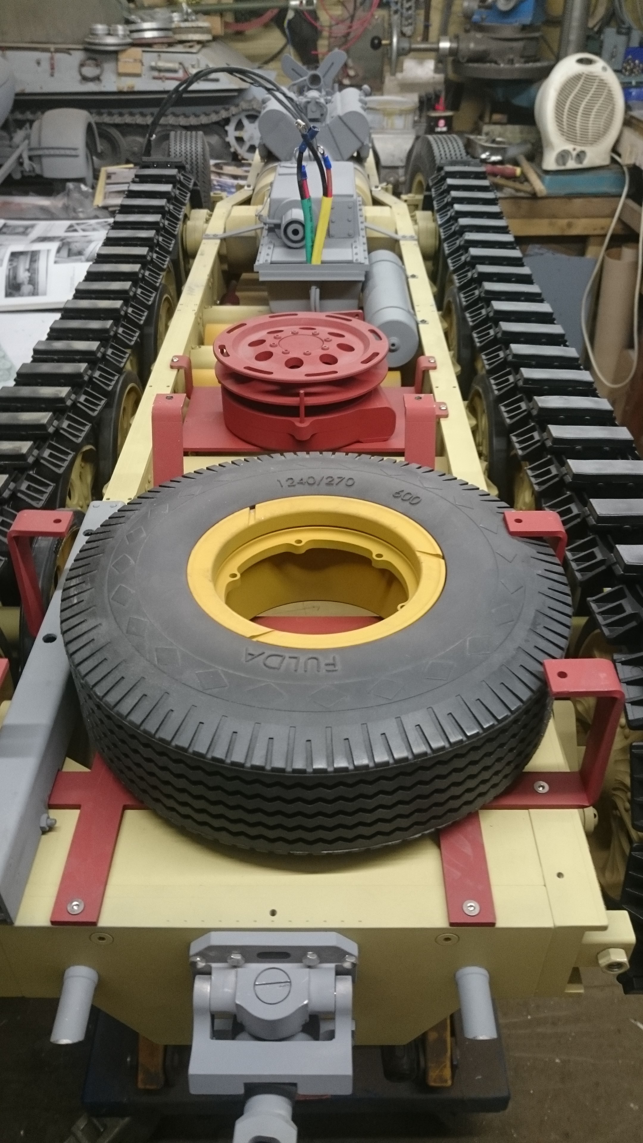

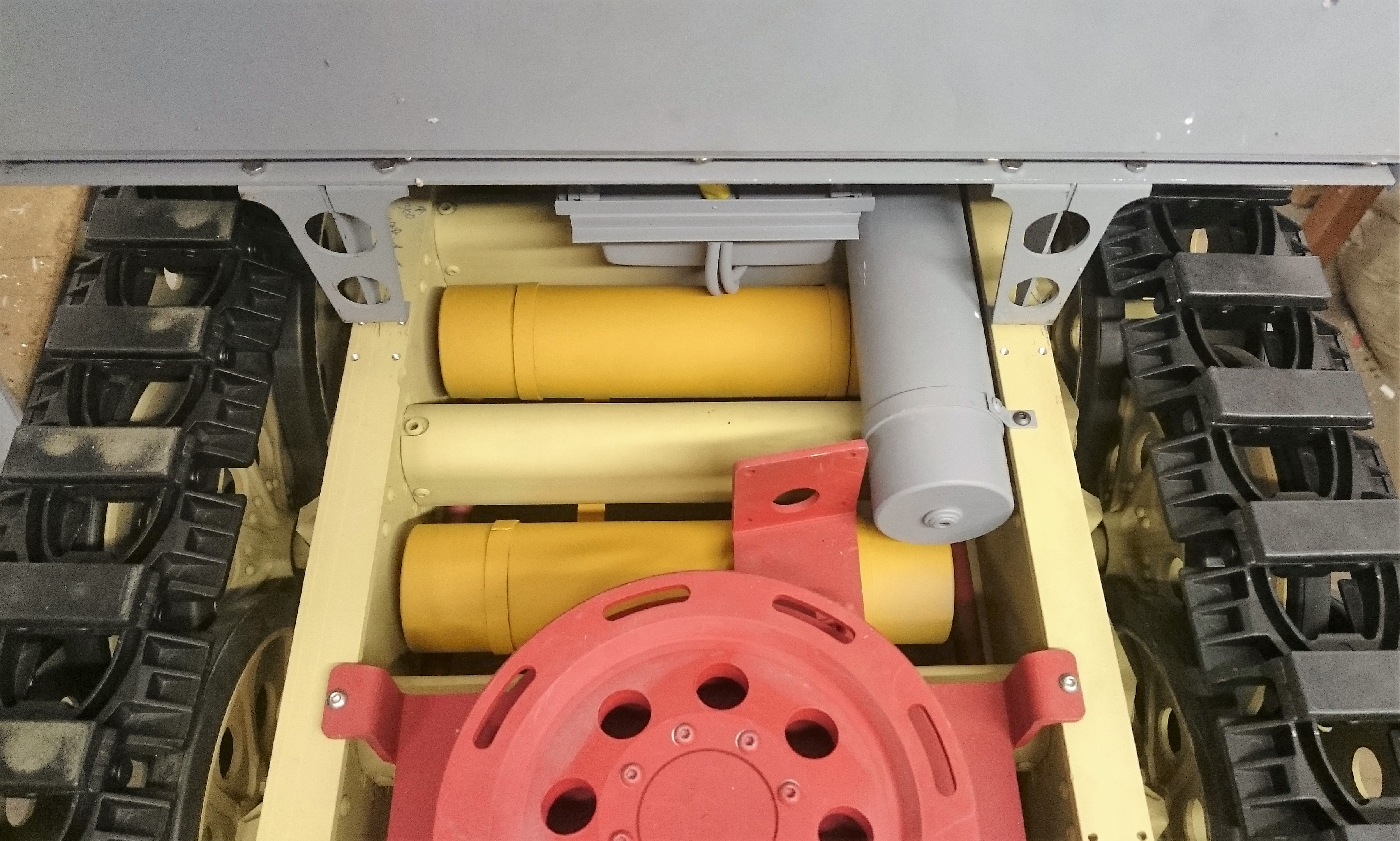

Dummy gear box and the air tanks.

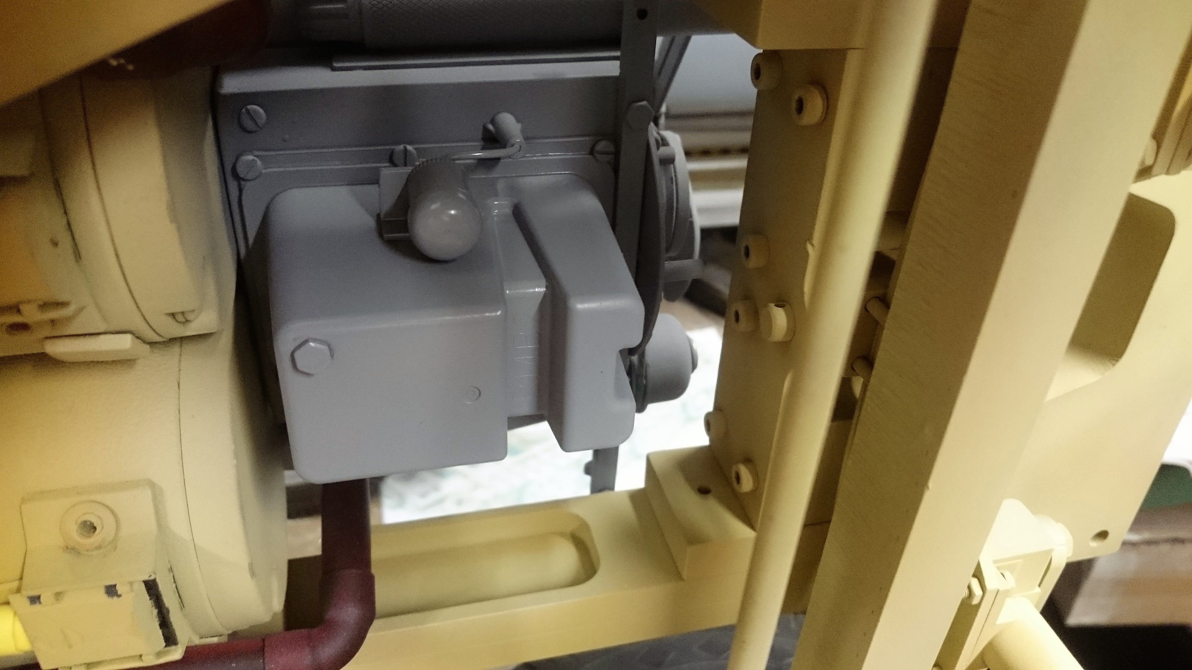

Made a little oil filter, and if you really want to you can unscrew the filter and insert a new filter element, a bit over the top but I had one in stock.
The two compressed air tanks from below, next job is to make a dummy bottom casting for the gear box to hide those cables.
I need to start thinking about an air filter
The three air tanks from above, just need to add the air lines to connect the tanks together.
