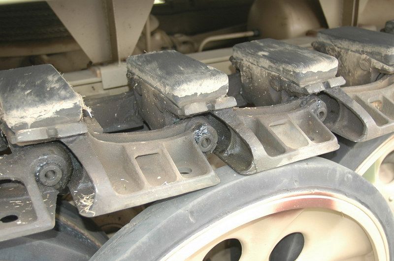

My thinking is to make the "rubber pad" as a part of each track link, then simply painted as a rubber pad .
No need to make it separately. There will be no worry on loosen or damaged then. If I remember correctly, the Sherman's track link was so-made.

, with reference to the rubber track blocks, I feel without the rubber there will be little traction on hard surfaces ( like the tank hall at Bovi) the model would skid about, make a clatter and look rediculous !
Although it will be a big heavy model the ground contact area would be small, and so the ground pressure would be high increasing wear, if the link had an integral metal block this would wear very very quickly and so not only look rediculous but the tracks will soon need replacing or the link itself would become damaged and break, the rubber blocks would be sacrificial , and like the real thing (Say, ref an APC ) they could be changed out when worn. They may last years they may need replacing sooner , this depending on the amount of use and the amount of towing ( which is what the vehicle was designed for) and the surface it's driving over, mud or grass being the most forgiving. The odd block missing would look like the original and not affect performance and could be replaced as soon as is convenient.

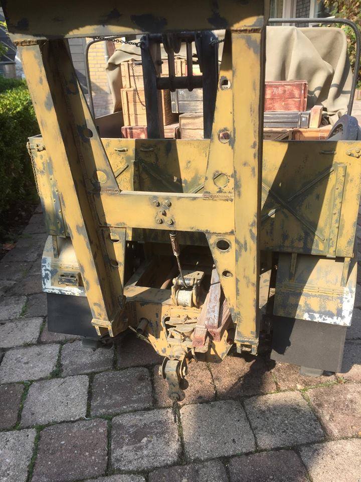

Simon, I do like the idea of steel tracks with the rubber inserts, and i agree with the "high quality building block for all" , all I am asking for is two tiny lugs of little cost to be provided in the kit, it's already been said that we are not getting a spade.
Going back to those steel tracks that opens a whole can of worms, with casting/machining issues, as the prototypical tracks would be quite skinny like the full size version, steel could be more prototypical than the ali equivalent due to it's higher strength but would be more expensive to produce, quid pro quo and all that
See useful chassis eye lugs in the photo below, good for towing armour with double heavy towing arms, and somewhere for your towing shackles to hang from. Oh before anyone points it out, I can see the central towing pintle
Regards Phil
