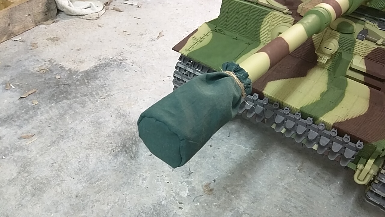

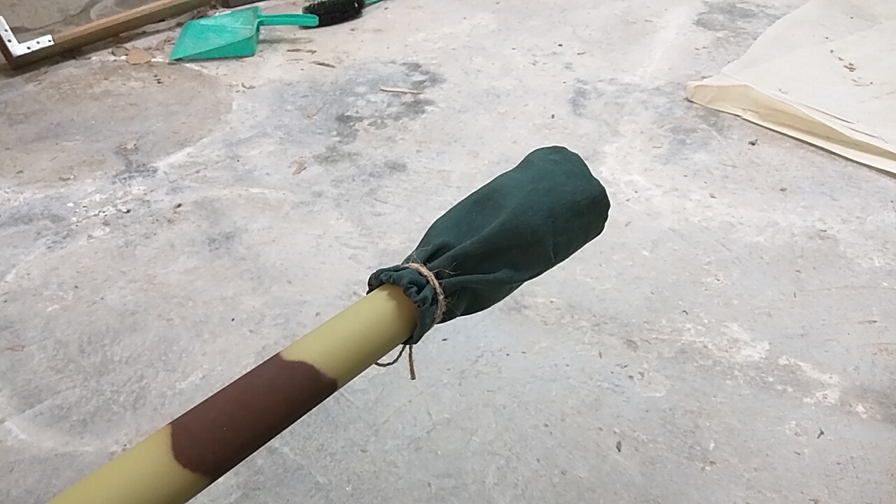

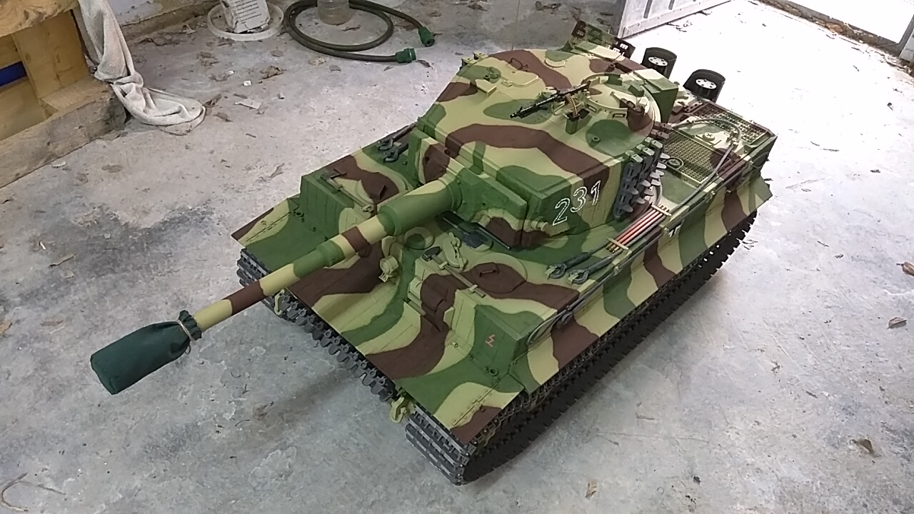

The last two items on the list have already been done and today I (my wife) managed to finish the first item on the list.There are still a couple of things to do, namely:
Wife promised to do a canvas muzzle brake cover for me.
Pluck up the courage to make the left stick of my DX8 spring loaded to center.
Try and find a suitable ammo bag to fit Mark's MG34 cupola mount (any ideas anybody?).
Try and find one of those buckets to hang somewhere on the Tiger (any ideas anybody?).
She actually made two but I still haven't decided yet if I should change the colour of the cloth that was used.
Still haven't plucked up the courage to do item 2.

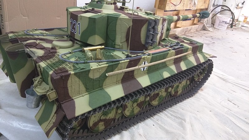

- Has liked: 792 times

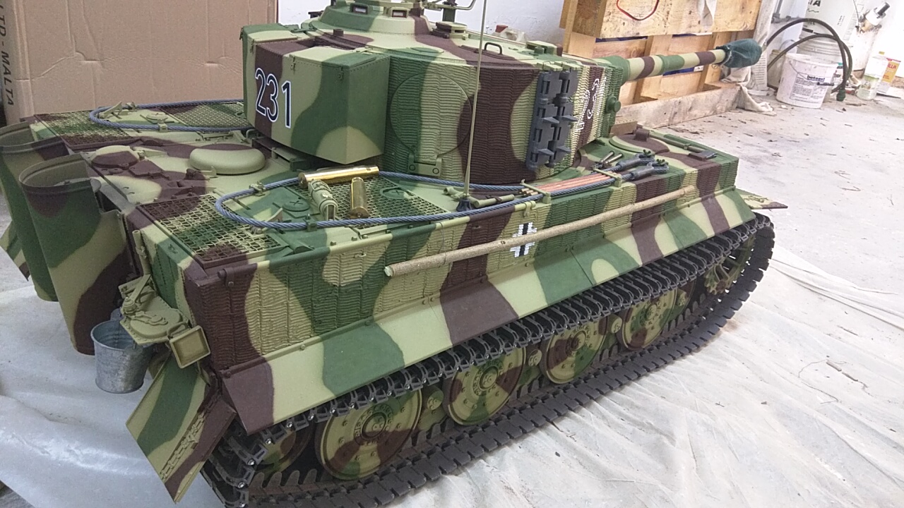

Yesterday my wife was in the backyard pruning some plants that were getting too tall and I happened to pick up something before it was thrown away.
I picked up a branch which looked like it would be good to replicate the log hanging on the side of the Tiger 1 that sometimes one sees in photos. Looking at the photos I suspect that the "log" could be a bit thicker although there was no standard size for these field additions. I will leave it like that for now to see if my eyes get used to it, but what do you think? Should I find something thicker?

I think your trunk may be a little thin.
Ask your good lady to plant a Buddleia and you will be able to supply the whole of Malta with fresh 1/6th scale logs every time she prunes
Thanks Adrian.I think your trunk may be a little thin.
It confirms my suspicion.
I have to be on the lookout for something thicker.
Now where did she hide the tree saw?

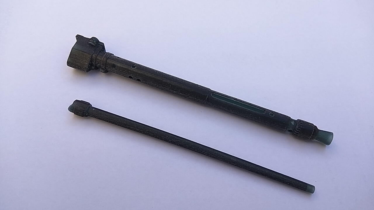

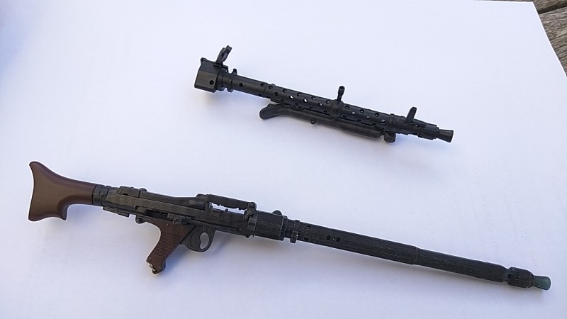

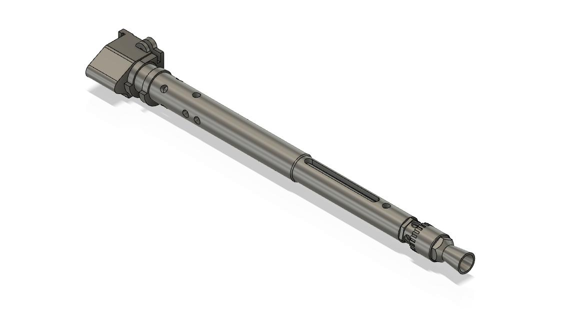

Some more work on the MG34 armoured barrel shroud.
A while back I asked Chris Hall if he could kindly 3D print the barrel and the shroud. He was kind enough to print me two not just one. Unfortunately, when I received them they did not fit as well as I would have liked the rear part of the MG34.
So back to the drawing board, actually back to CAD, to do some minor adjustments to the back part of the armoured barrel shroud.
This time I sent it out to a commercial printer in France and just for a change requested it to be printed with Polyjet printing technology. I also requested it to be printed in black for no extra cost.
Received them today.
They came out nice with no printing defects and now it fits perfectly the rear part of the MG34. It also fits nicely on Mark Lawson's cupola mount.
The only thing I do not like is that in some areas of the armoured shroud the print lines are just visible which was a surprise for me. I will try to do some fettling with a fine sand paper to see if I can remove the print lines.
Fingers crossed.
Fingers crossed.

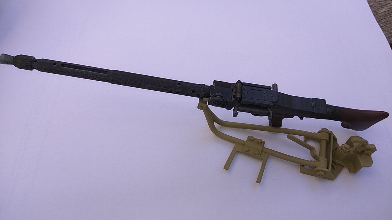

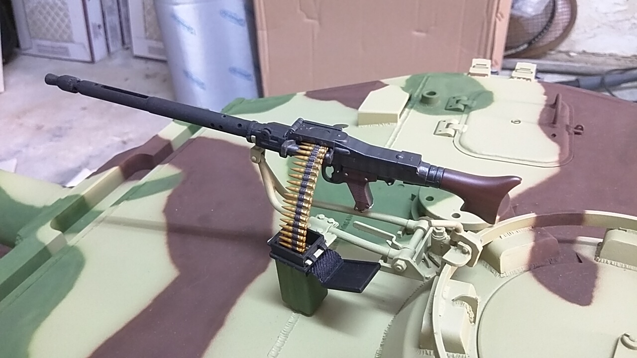

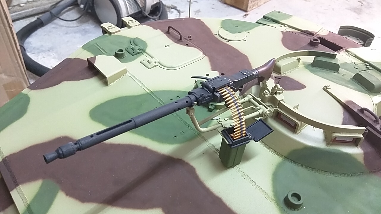

The MG 34 with the new front part is back in it's place.
I sanded off the print layer lines as much as I could. Gave it a good wash in clean water, let it dry and then applied a dark wash that I had used when painting the Tiger tools.
Now to sit back and enjoy some Panther builds.
