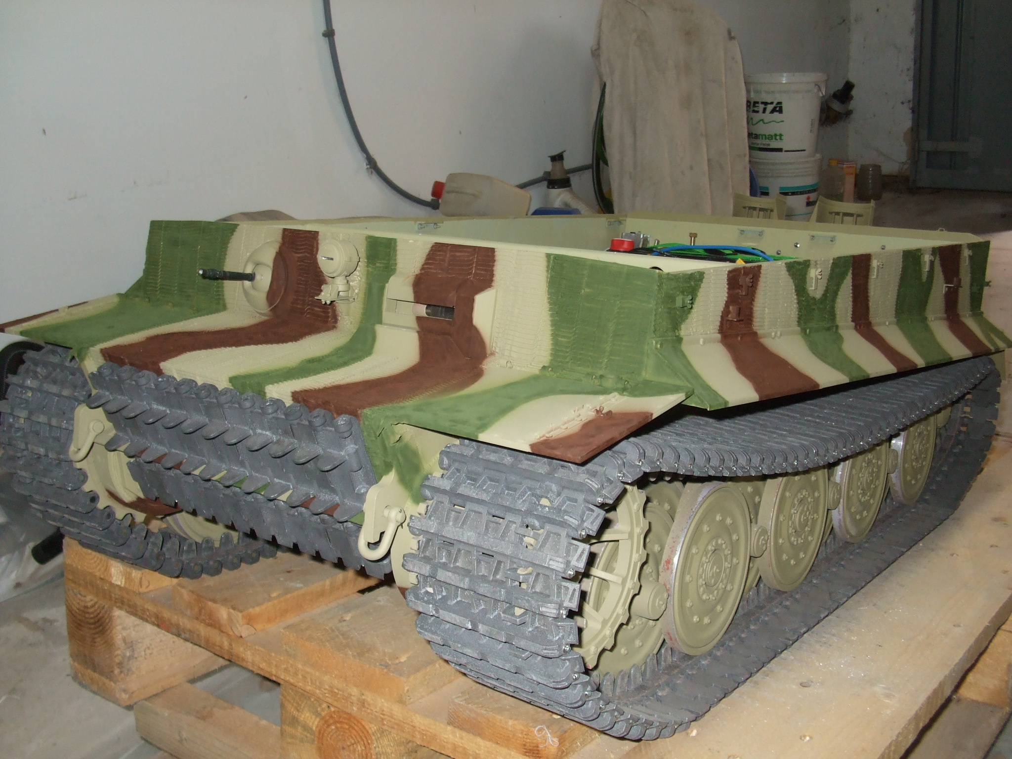

Onwards and upwards!
Really got bored of practicing with the airbrush so plucked up some courage and did one side of the model. It's not a Dali or a VanGogh but will do considering it's my first time.
Good thing I took a photo because it really shows up areas that I need to touch up.

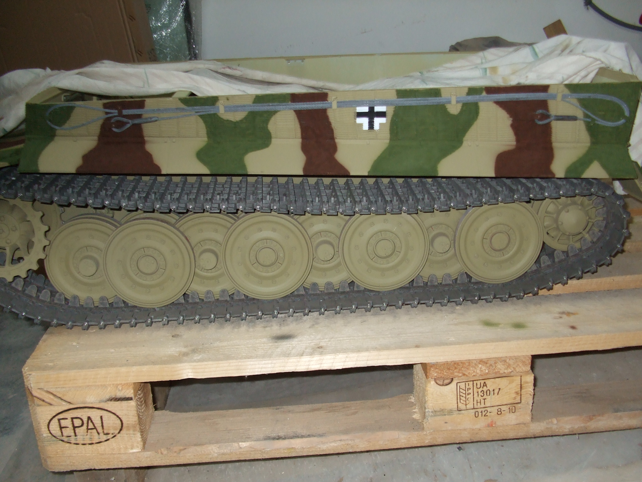

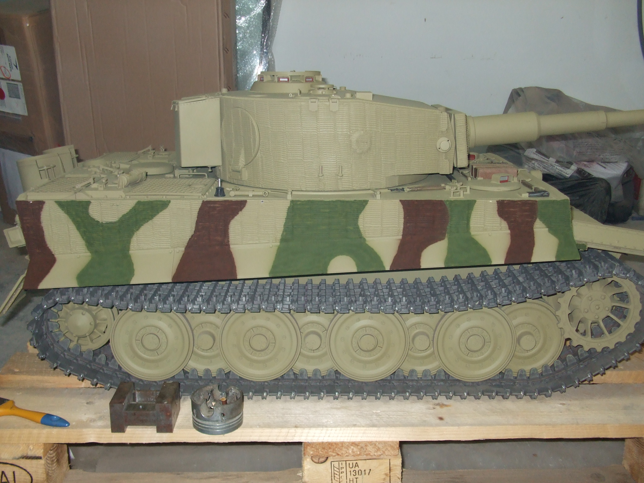

A quick update.
I am finding this airbrushing thing quite relaxing. Learning another skill for when I go back to scratch building model engines. Fortunately (fingers crossed) I have not had any problems with clogging or water in the air. I have done both sides and the front and now starting on the back plate.
As one can see, I have not done anything on the wheels. I suspect this is going to be a last minute decision. I have also removed the turret, engine deck and hull roof as these will be painted separately. I am finding that it is easier to paint a vertical surface than a horizontal one. The camo scheme is first pencilled in than airbrushed freehand. I am not too worried with some overspray as I suspect in real life, painting in the field, the same thing would happen.

There's been some discussion on the painting of wheels, with I think three distinct camps:
1) Wheels stayed in Dunkelgelb, so that they lightened the lower hull shadows.
2) Individual wheels were sprayed in solid colours, to break up the shape of the lower hull.
3) Wheels were sprayed with a camo pattern which matched the rest of the hull.
Camo pattern on the wheels is contentious because of the idea that the rotation of the pattern as tank moved would be more obvious to an observer than single colour wheels. From a quick Google of Ardennes King Tigers pictures, most would appear to me to have Dunkelgelb wheels, though of course all the pictures are in black and white. There certainly seems to be a difference in the shades on the turret sides and the wheels.

Thanks Adrian for your reply. There are a lot of modern colour drawings of Tiger 1's with camo on the wheels. Similarly, there are some museum pieces which have their wheels painted. I am trying to avoid using these as reference. The majority of the period black and white photos depict the wheels without camo, but having said that I have come across a couple photos which seem to have camo on their wheels. This basically is telling me that camo on the wheels is more the exception than the rule and that's the reason I just can't decide what to do.
My plan at the moment is to wait unit the model is fully painted and then try and decide what to do.

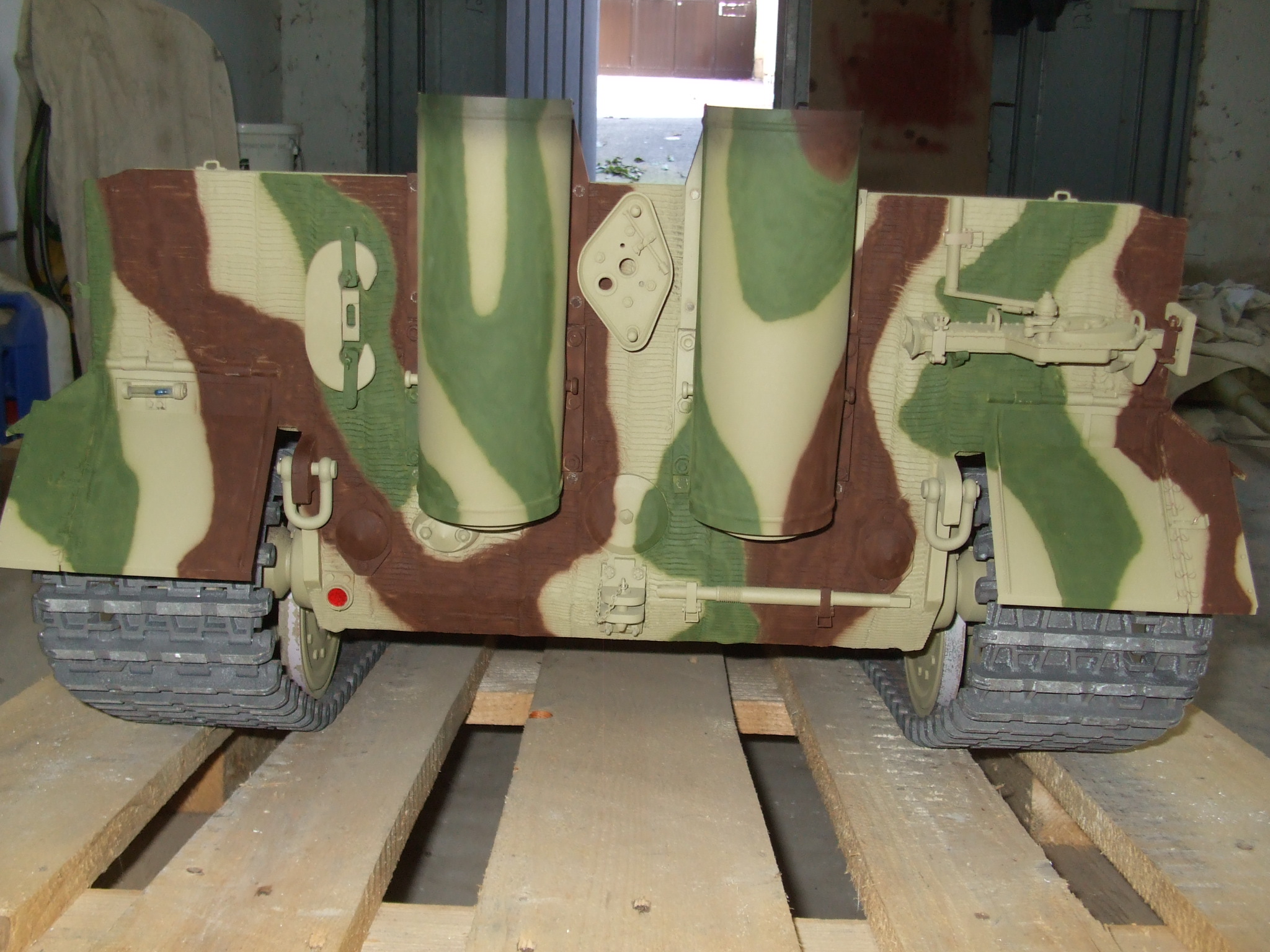

Backside finished also.
I wanted to add some soot marks around the exhaust and heat shield but I did not want it to be very dark as the idea is that this is a freshly field painted new tank so lightly used. After a lot of experimenting I used a dark wash and sprayed from a distance.

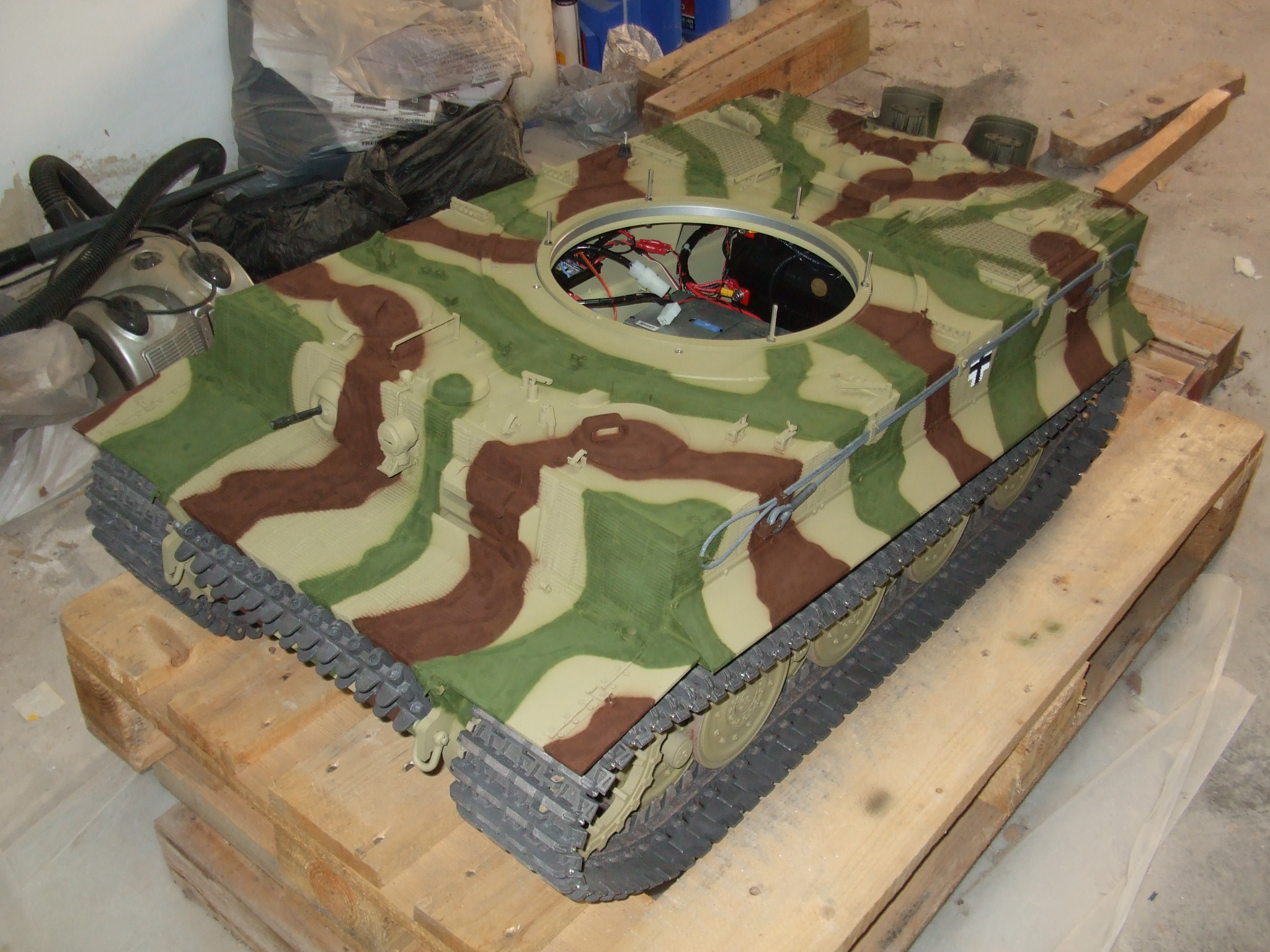

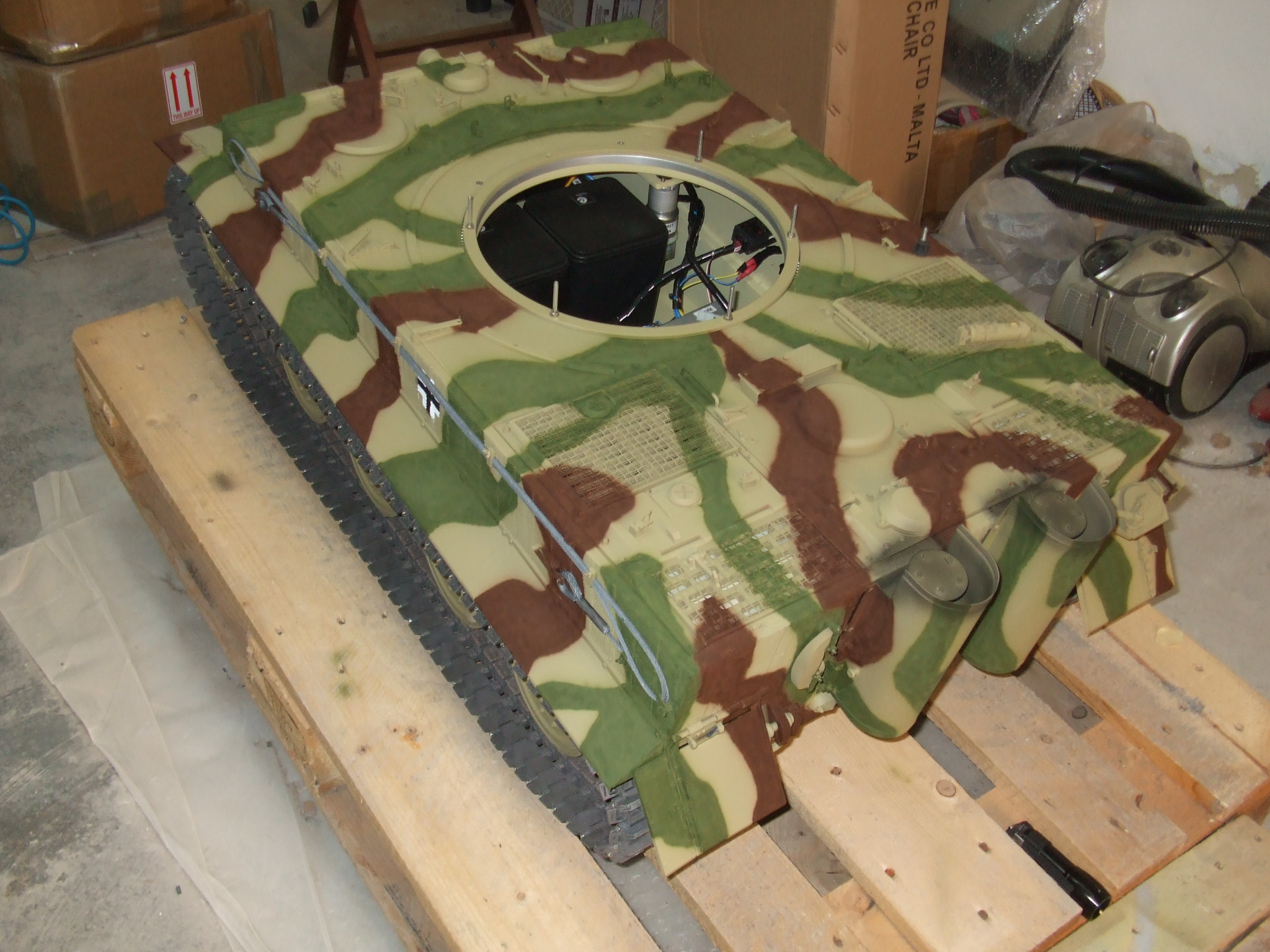

A little more painting progress. Finished the hull roof and engine deck and they are back in place. Not perfect but not too bad for a first timer with an airbrush. Happy to report that my el cheapo airbrush is still going strong.
I have decided that I will be giving the road wheels some light camo but that will be later on after I finish the turret and barrel. Also, I haven't done the two unit markings yet. It was suggested to me on a different thread (viewtopic.php?f=6&t=7944) that these should be pink. I have not found any ready made paint for these yet so I will be experimenting with mixing some red and white colours to see if I can get the colour. If this does not work out then I will paint them red.

Camo is looking good so far.
The color to use for the unit markings is Vallejo sunset red 70.802.
