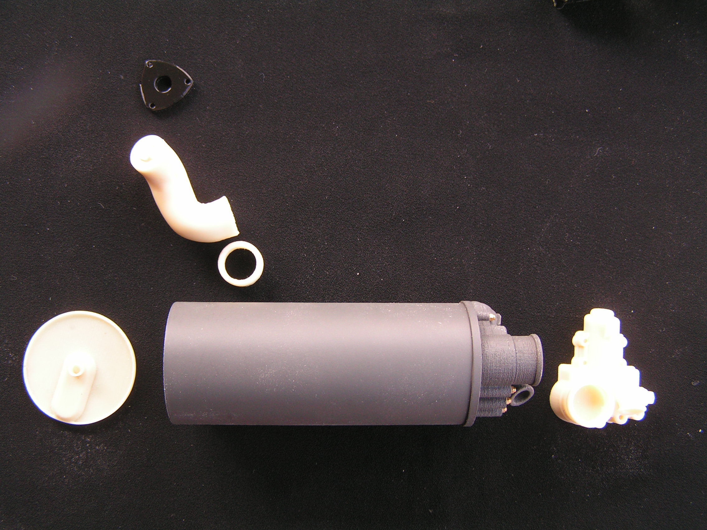

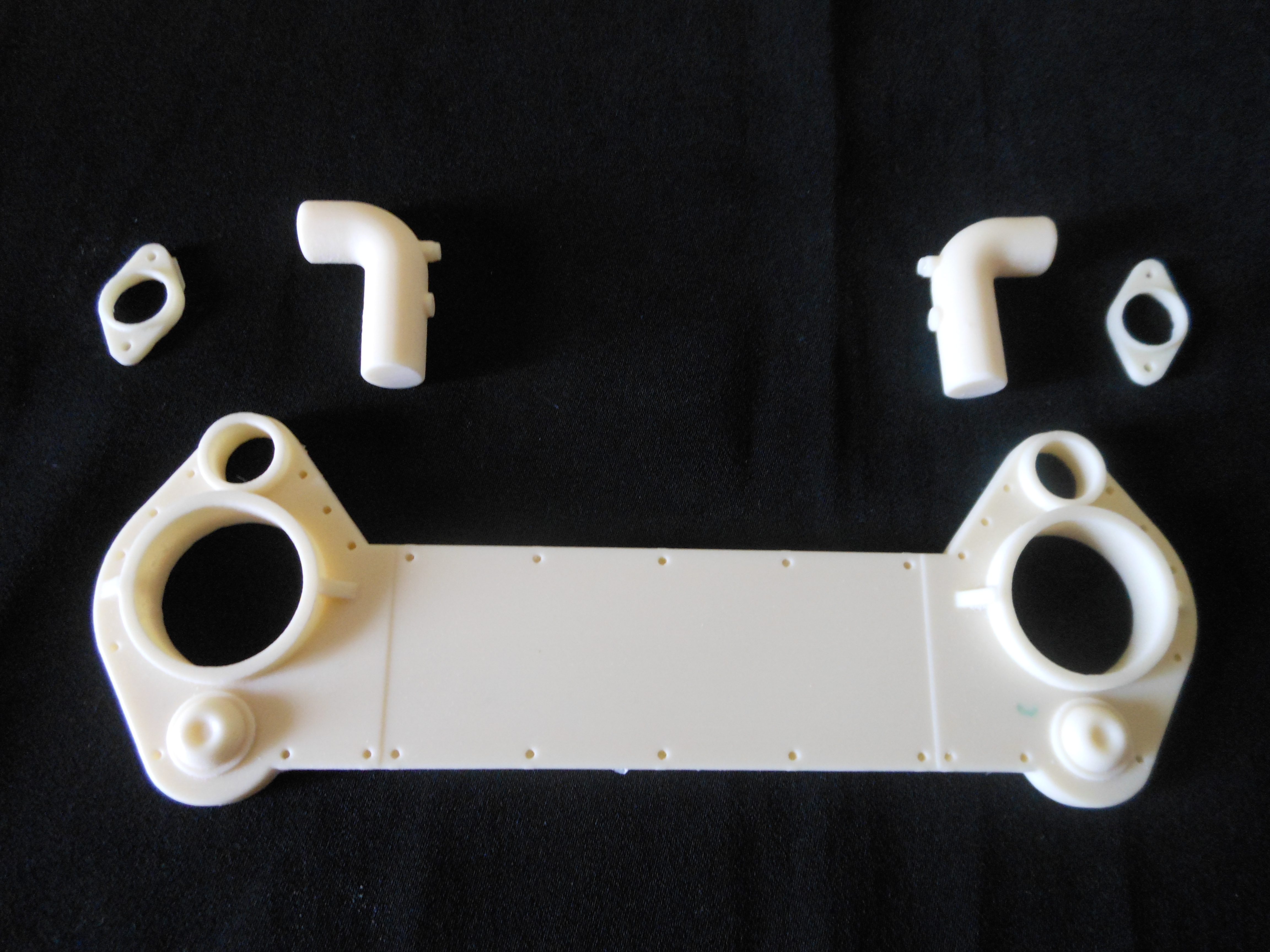

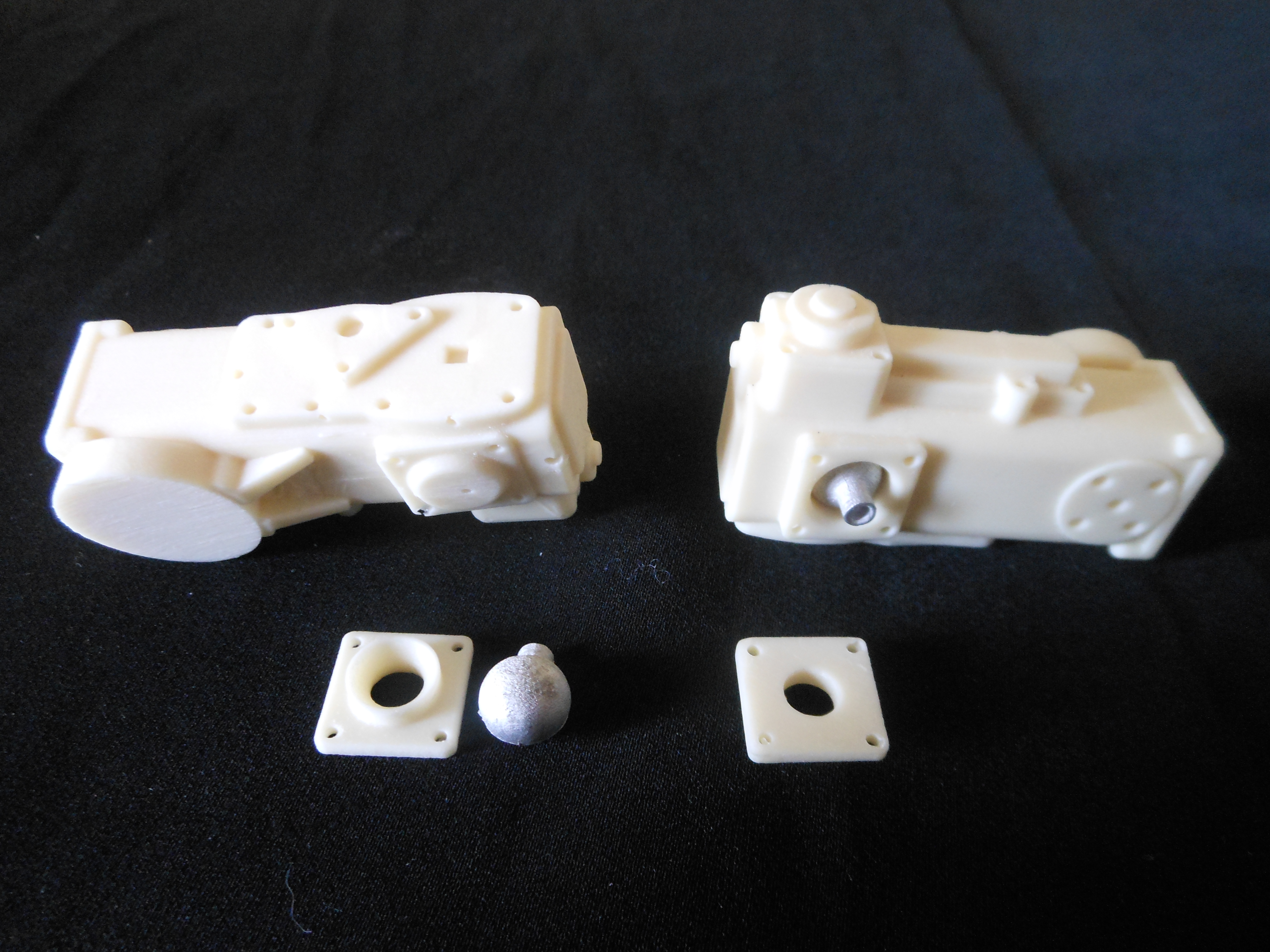

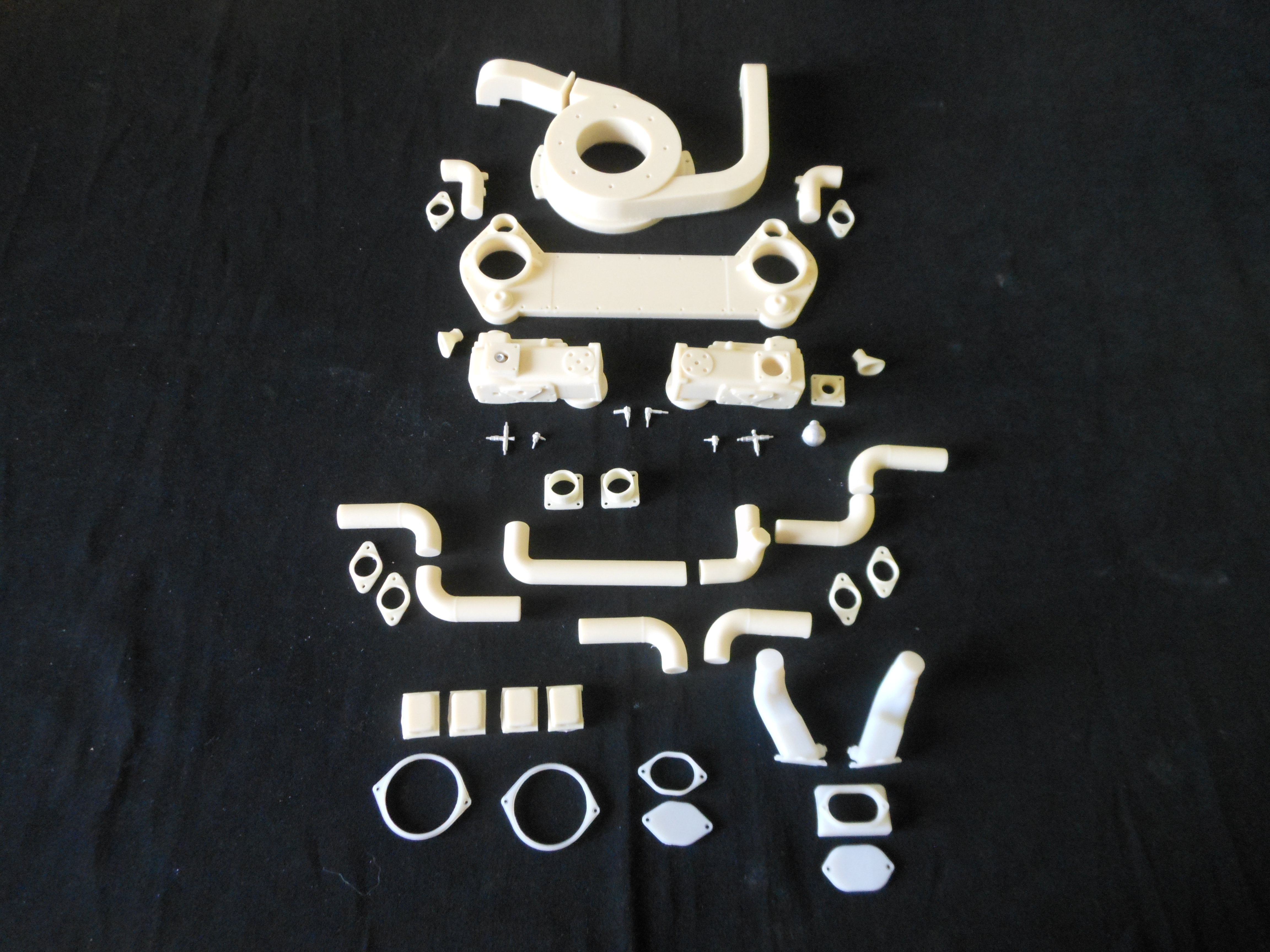

Hello to all,

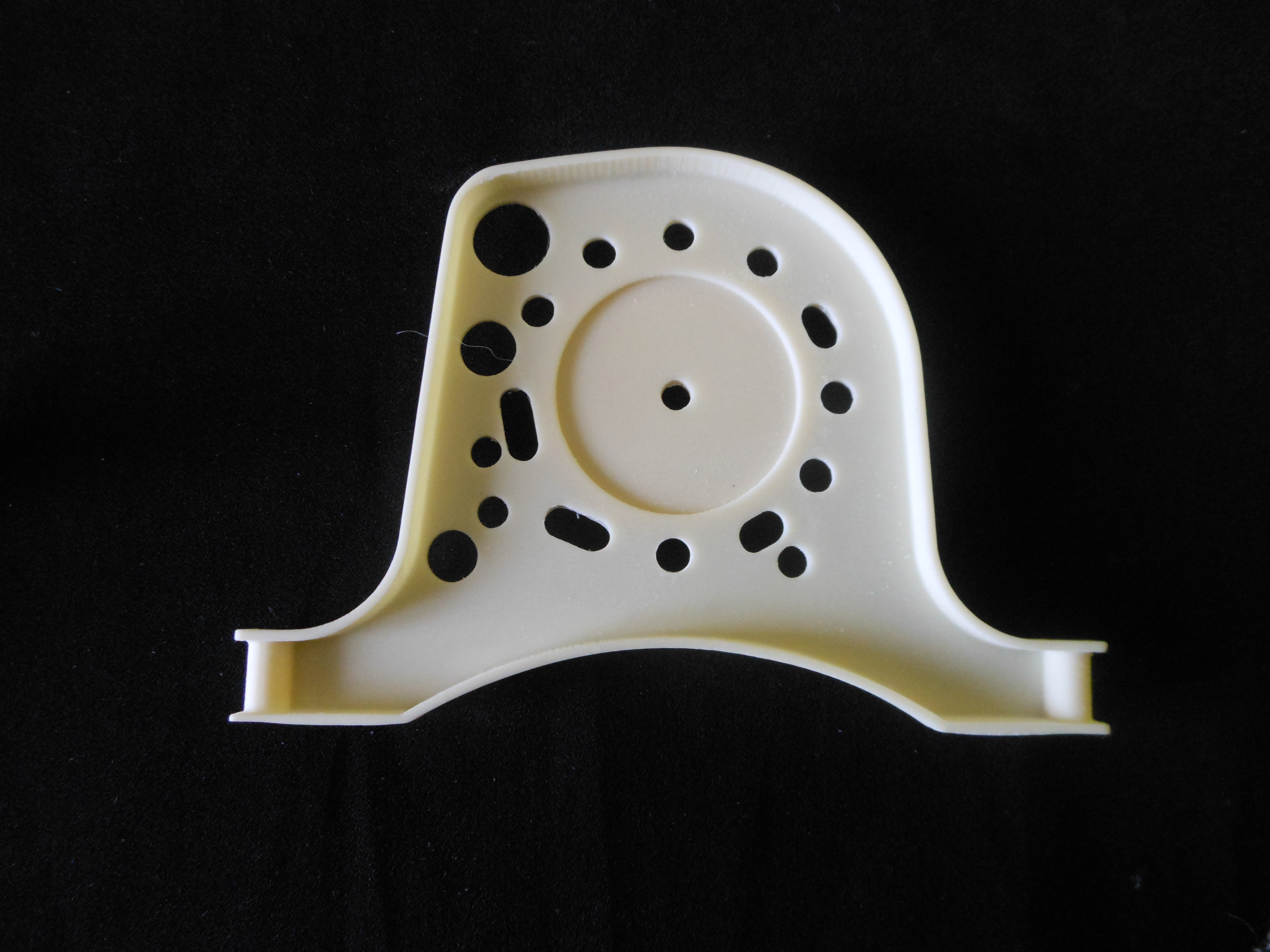

I have prepared the accessories of the engine compartment.
At the request of some modellers,i made new support rear.

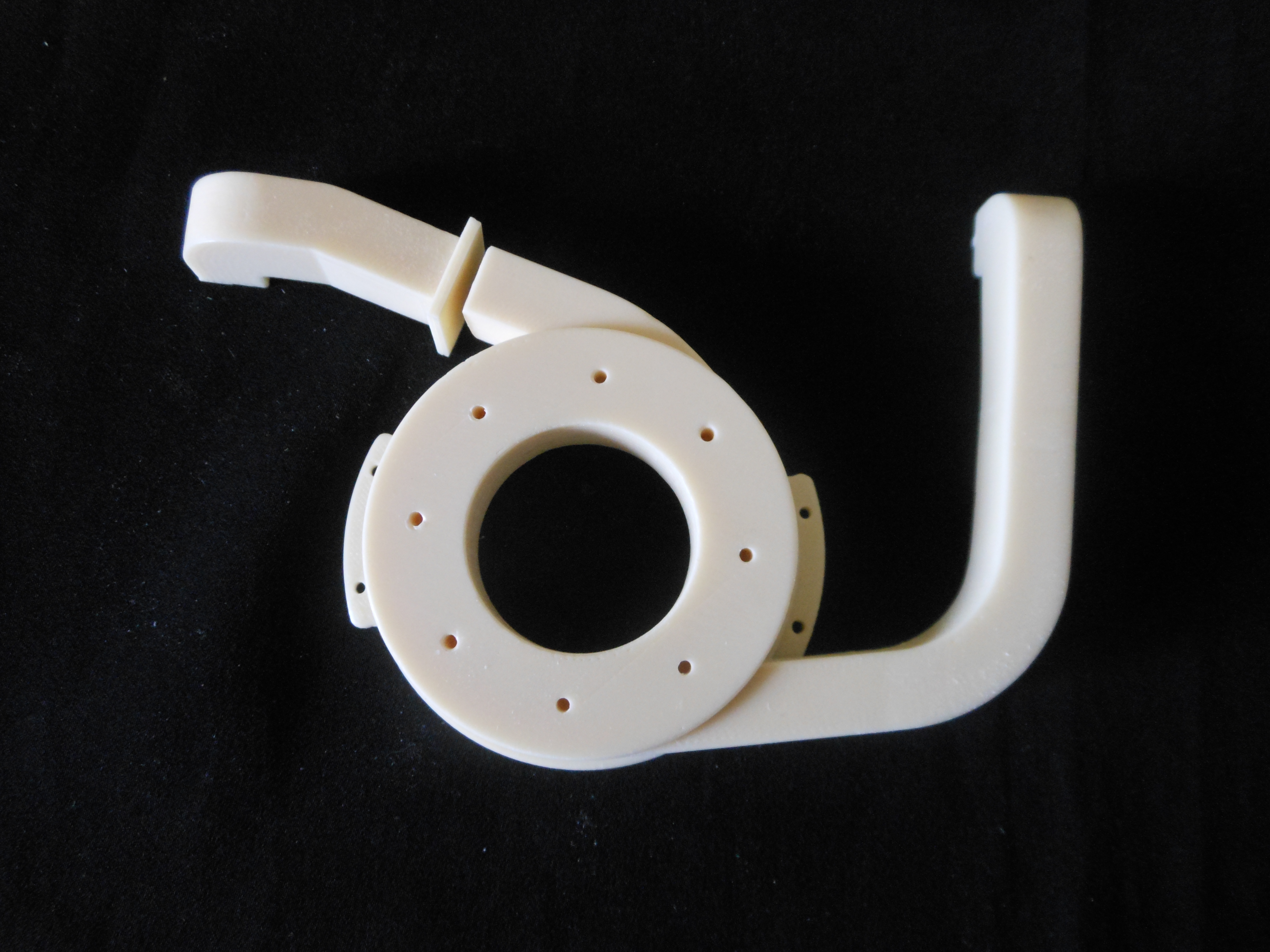

And 'higher than 1 cm
As always, the price will be no bolts or with bolts.
The kit is composed of 44 pieces in resin,8 white metal pieces,
100 bolts / nuts,50 cm. rubber tube black.
Excluded axes, universal joints clutch
Quality usual, there are no instructions, just look at the photos on the internet

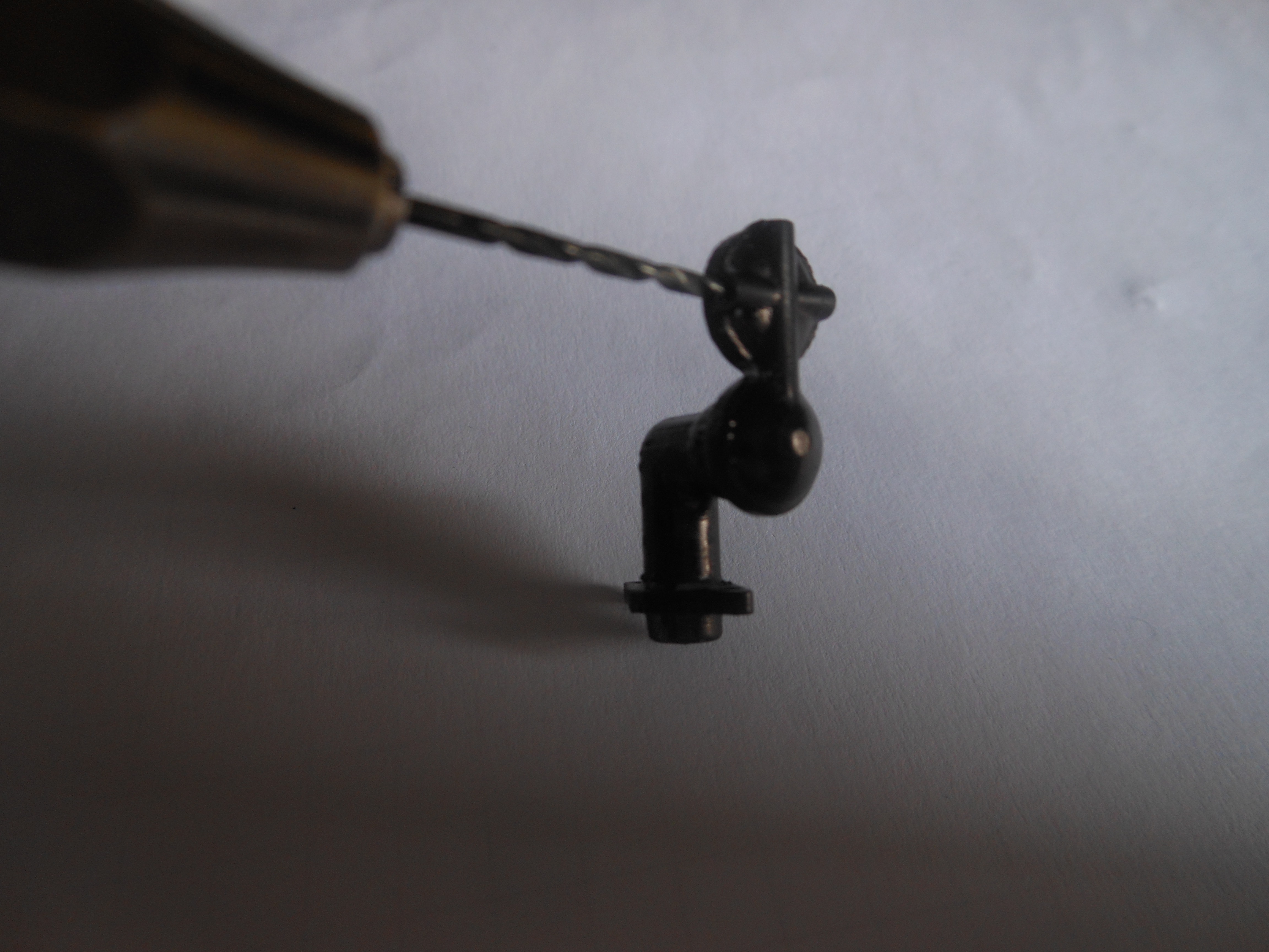

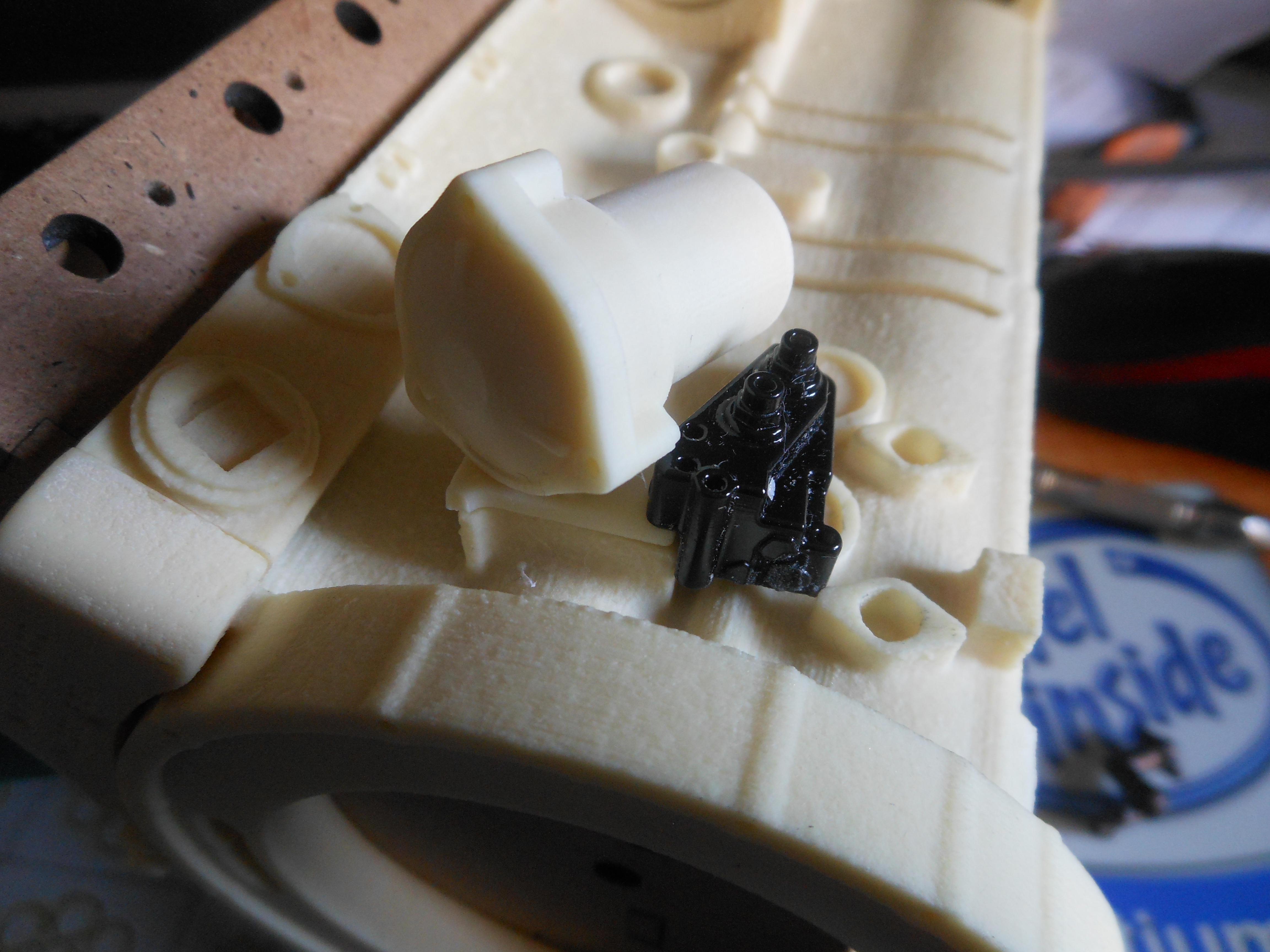

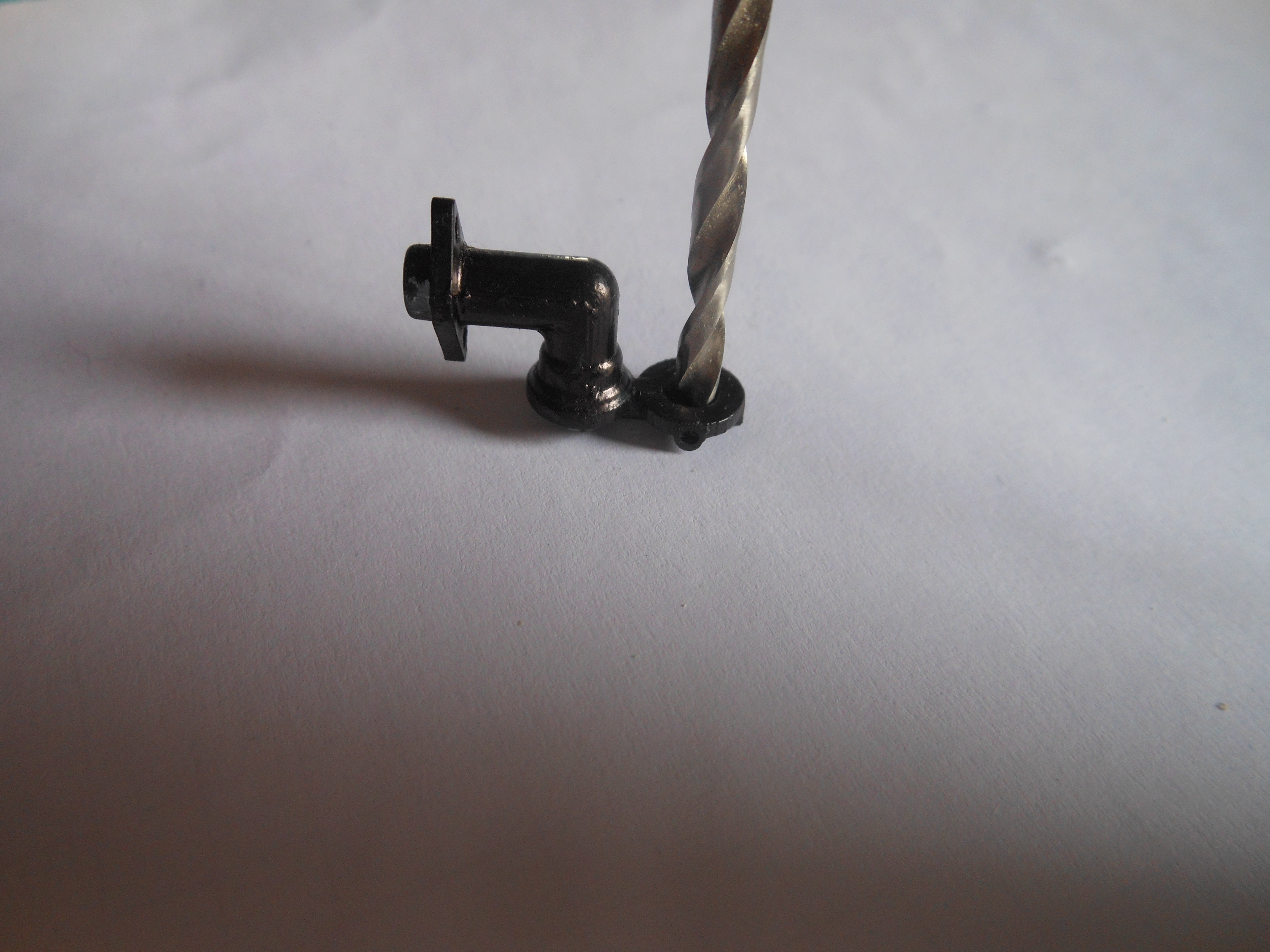

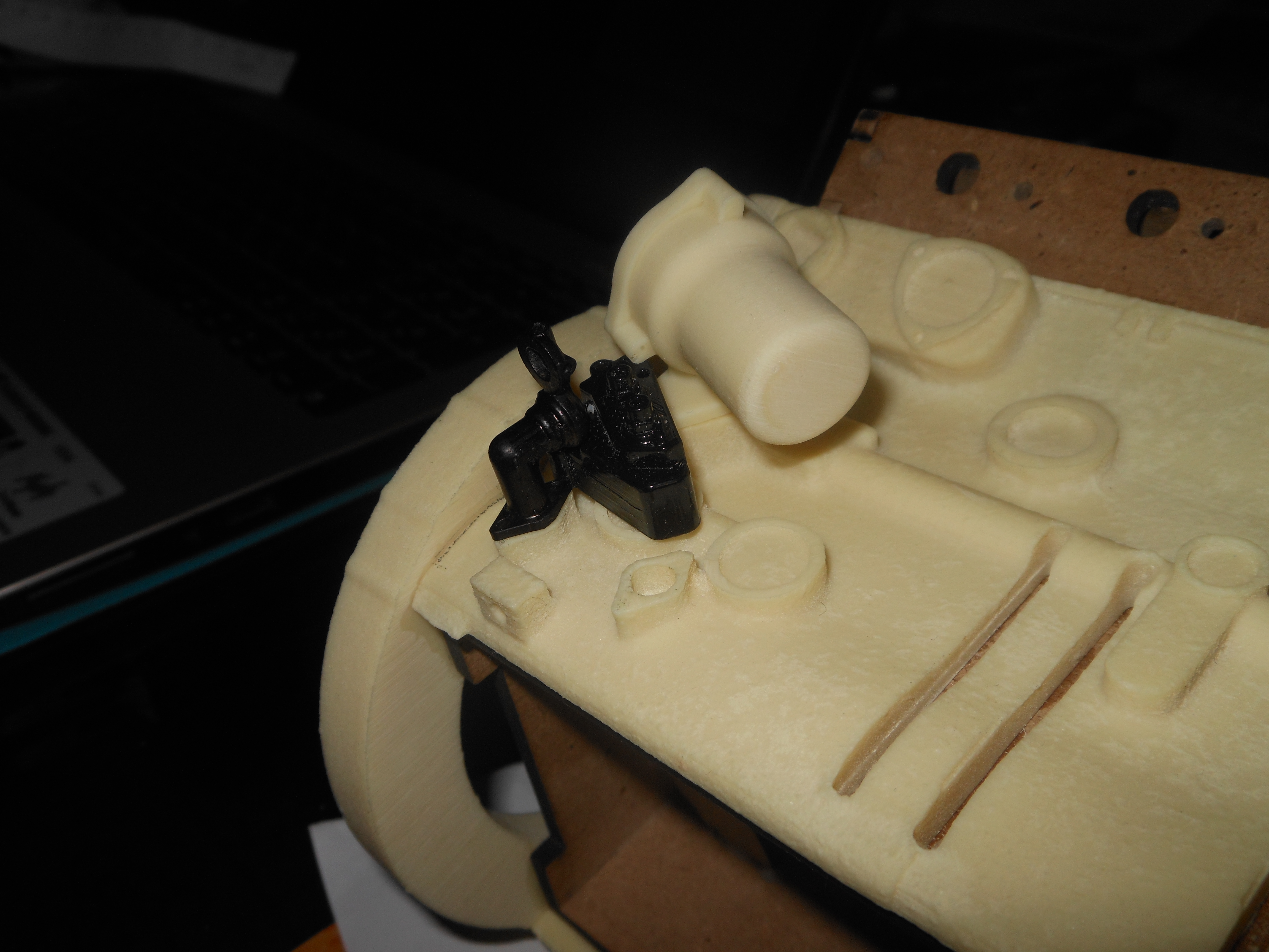

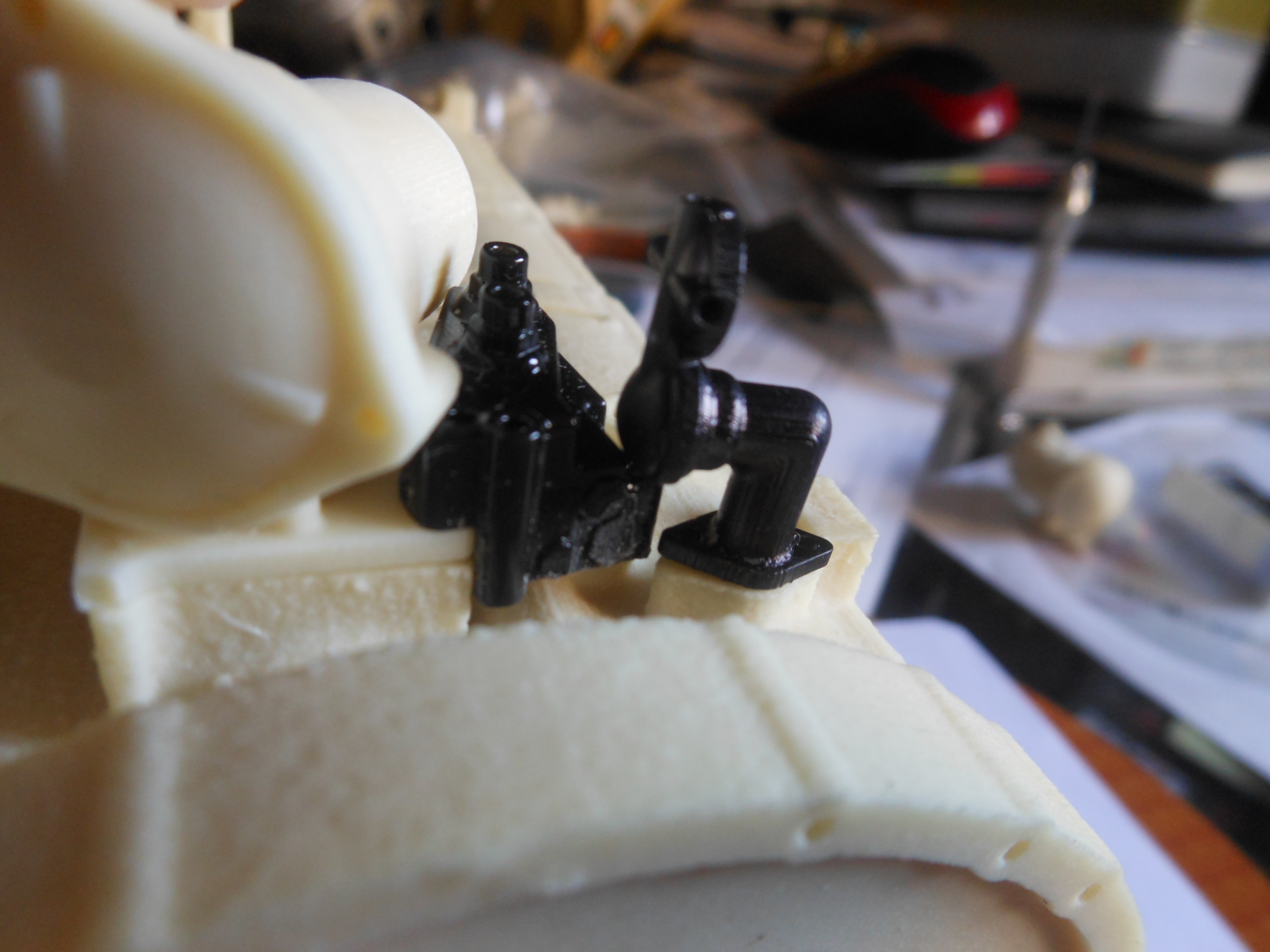

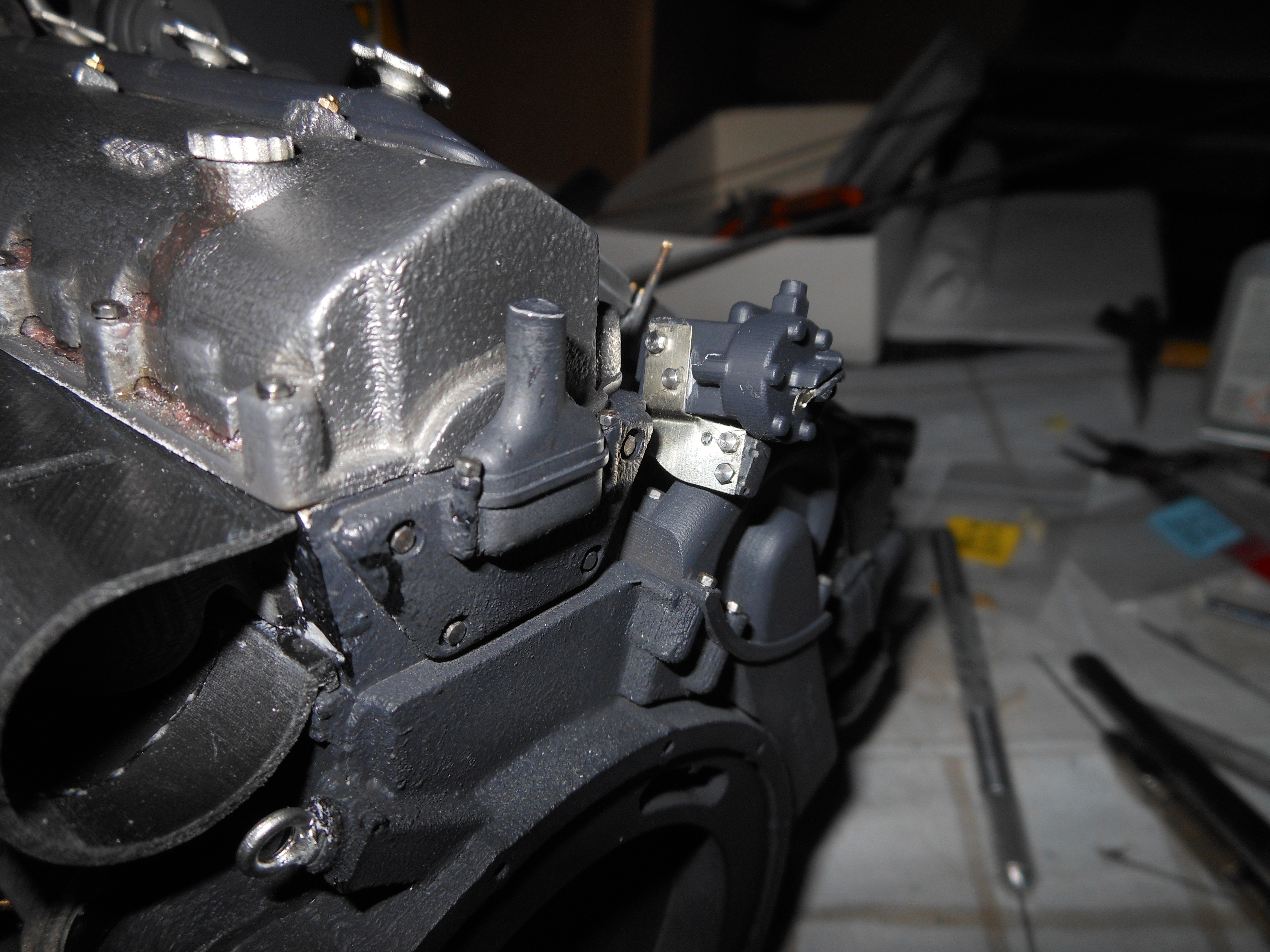

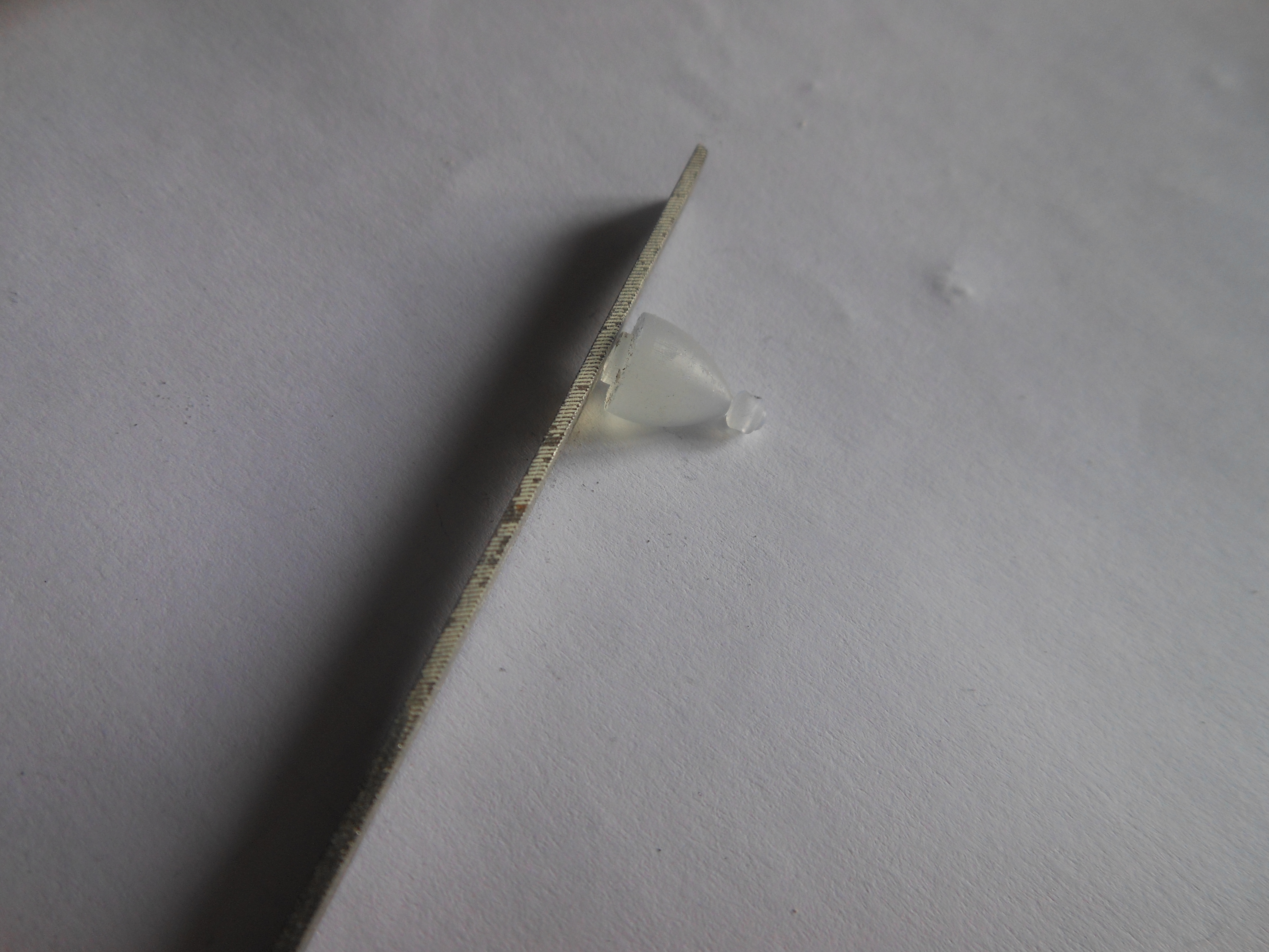

Mounting fuel filters.
Holes with the tip 1 mm. 1mm deep. for the brass wire
If it is necessary to ream the hole where it goes pasted the transparent filter.
If necessary, adjust the basis of transparent filter with a small file.
Paste the filter and the tap
Bend the brass wire for realize the latches.
holes with the tip 1 mm. 1mm deep. for the brass wire

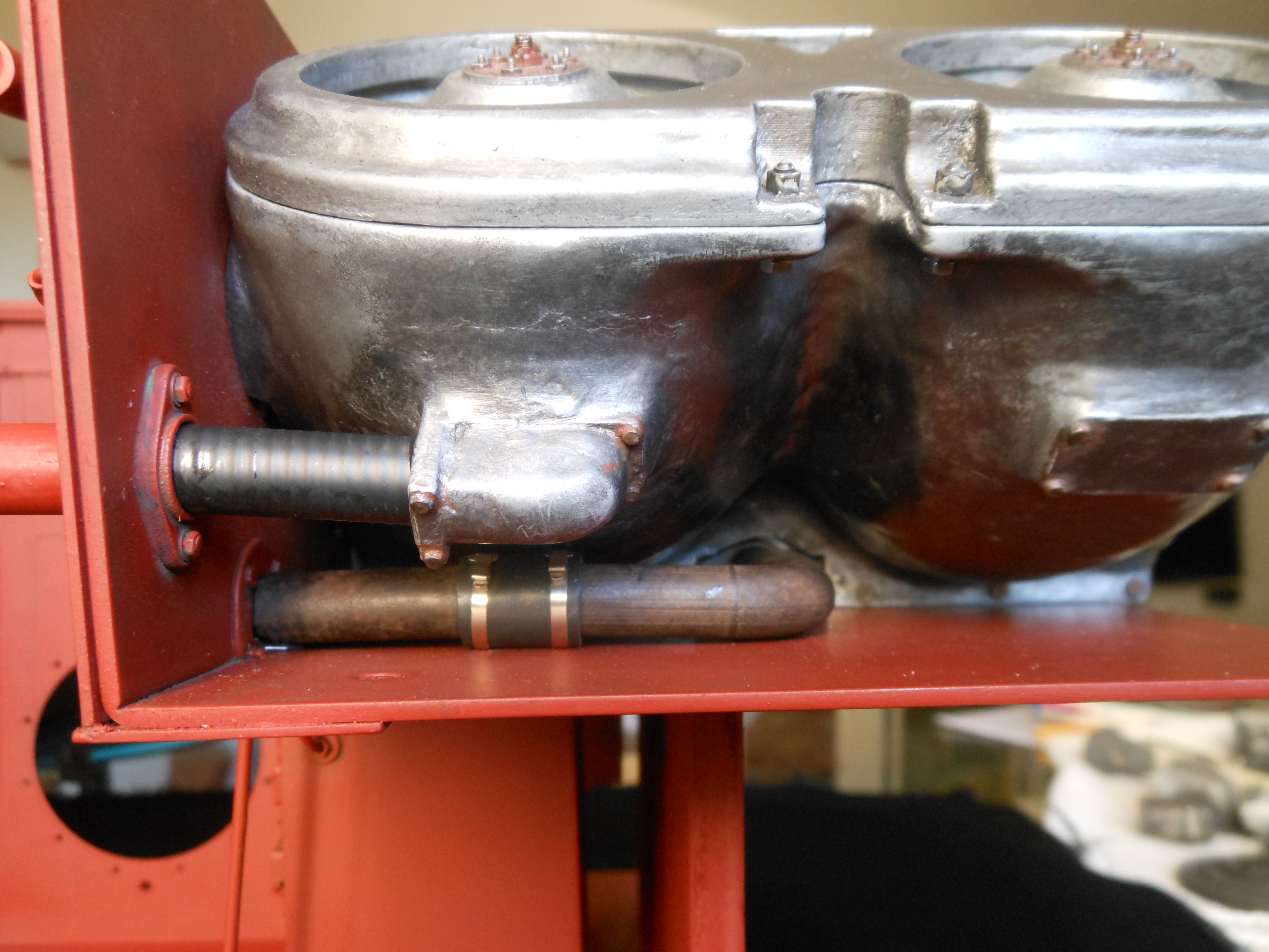

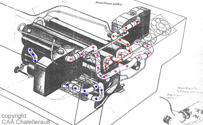

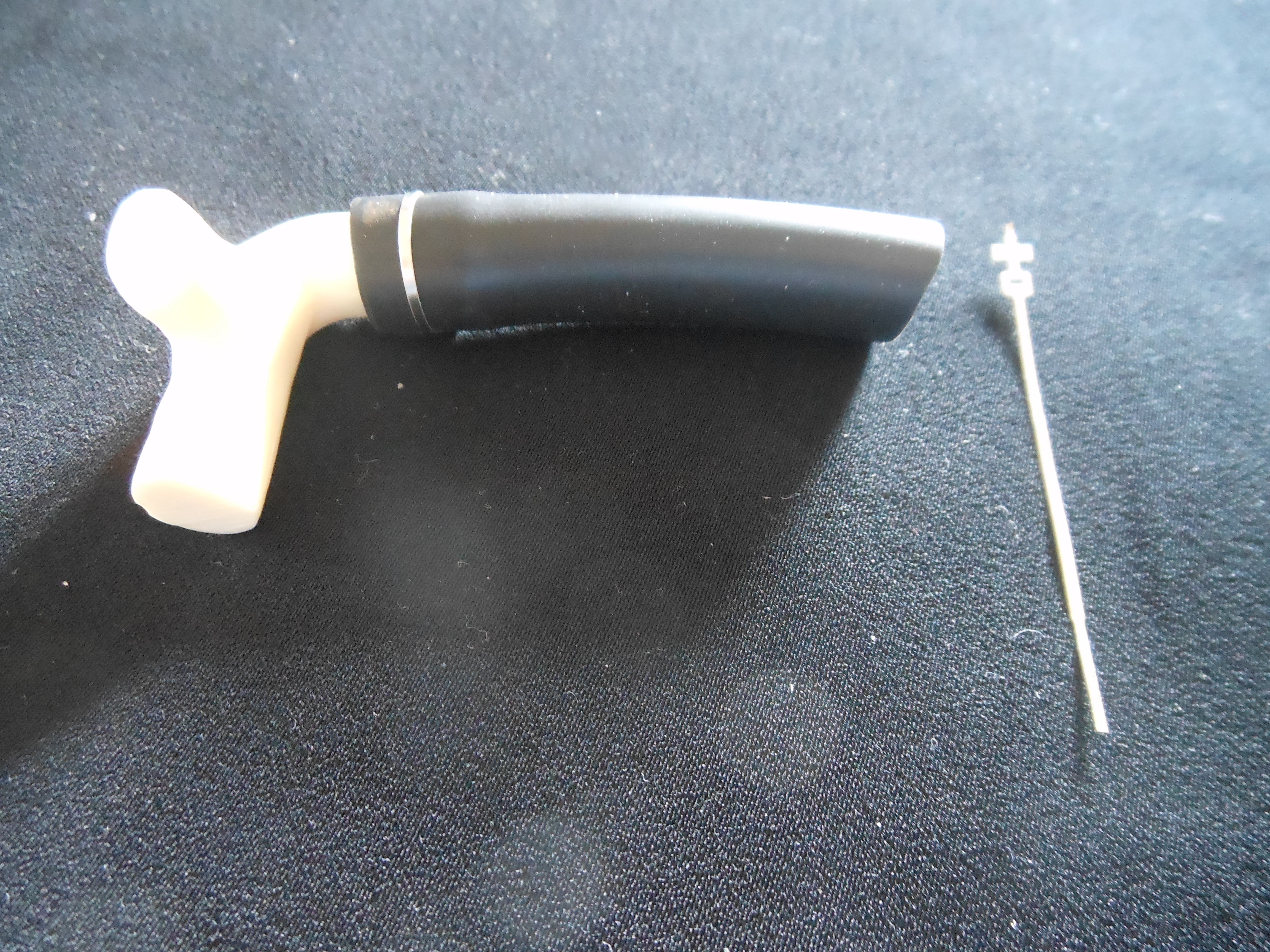

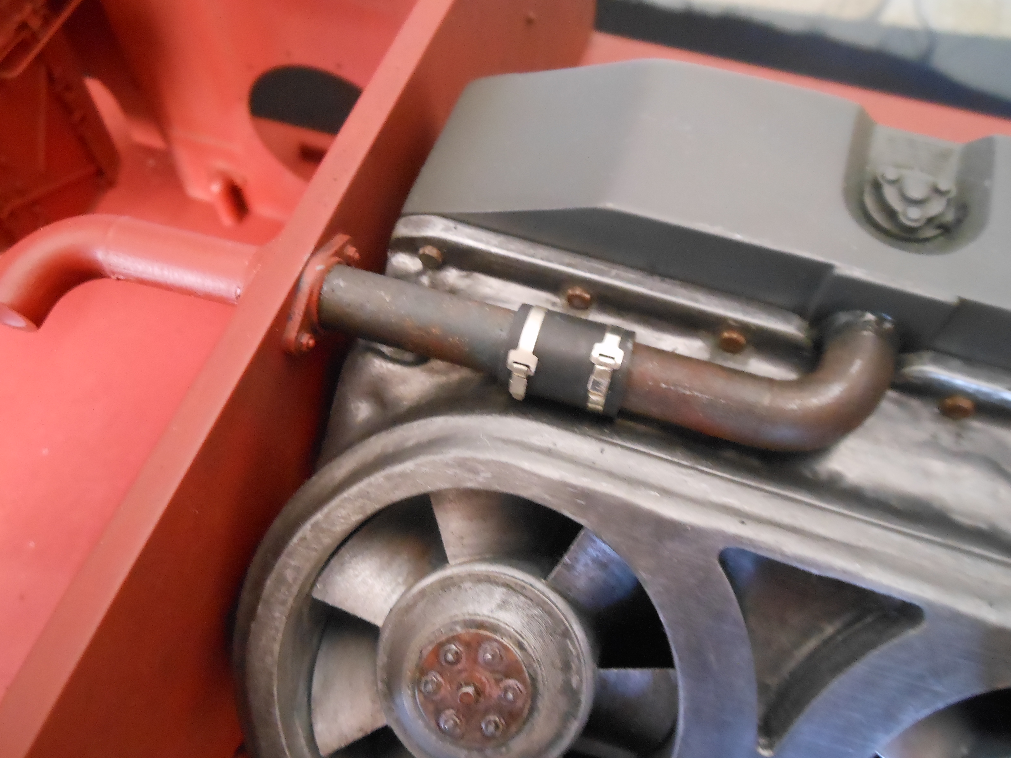

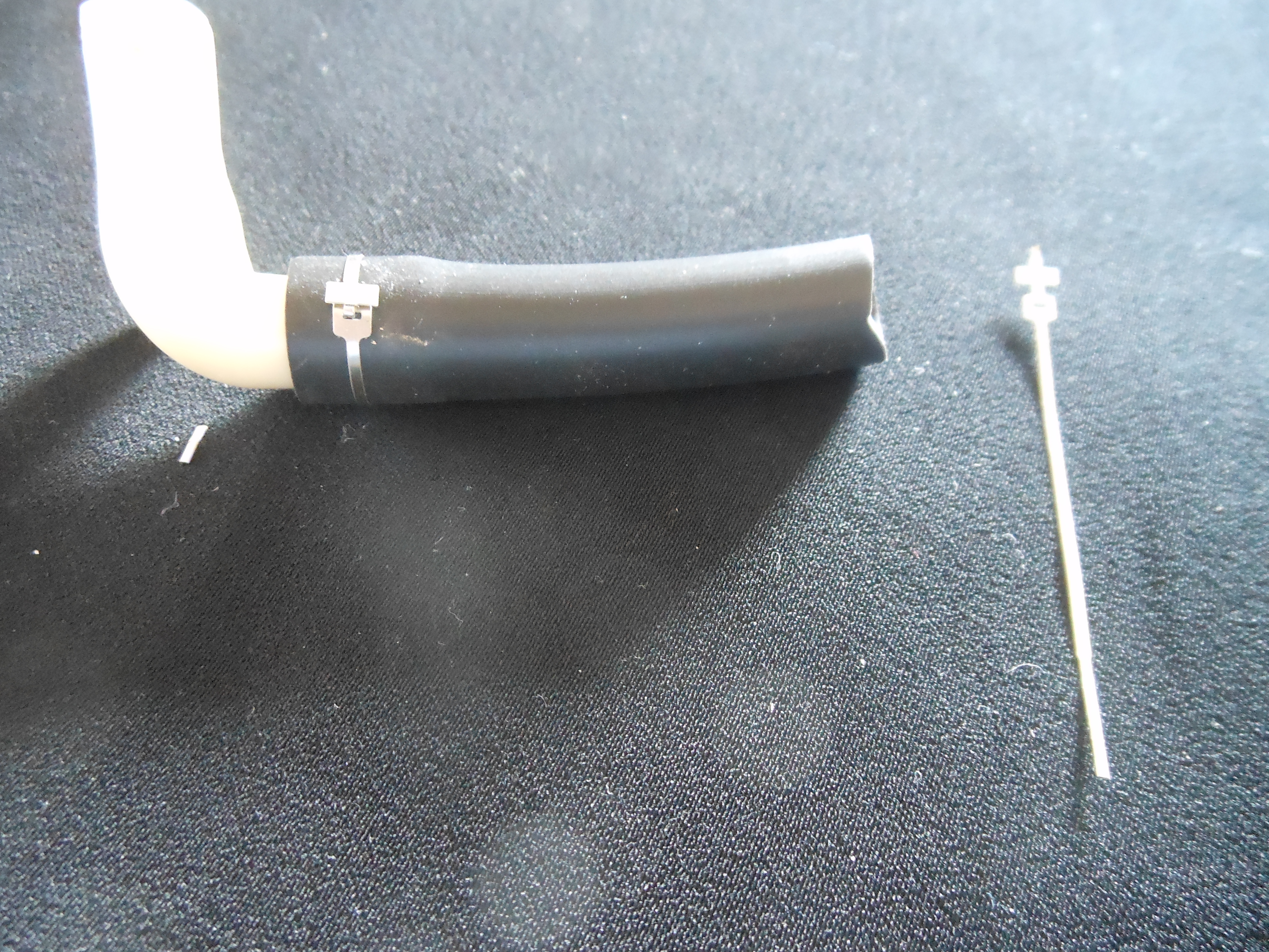

This tube should be positioned in this way.
You have to find the right placement

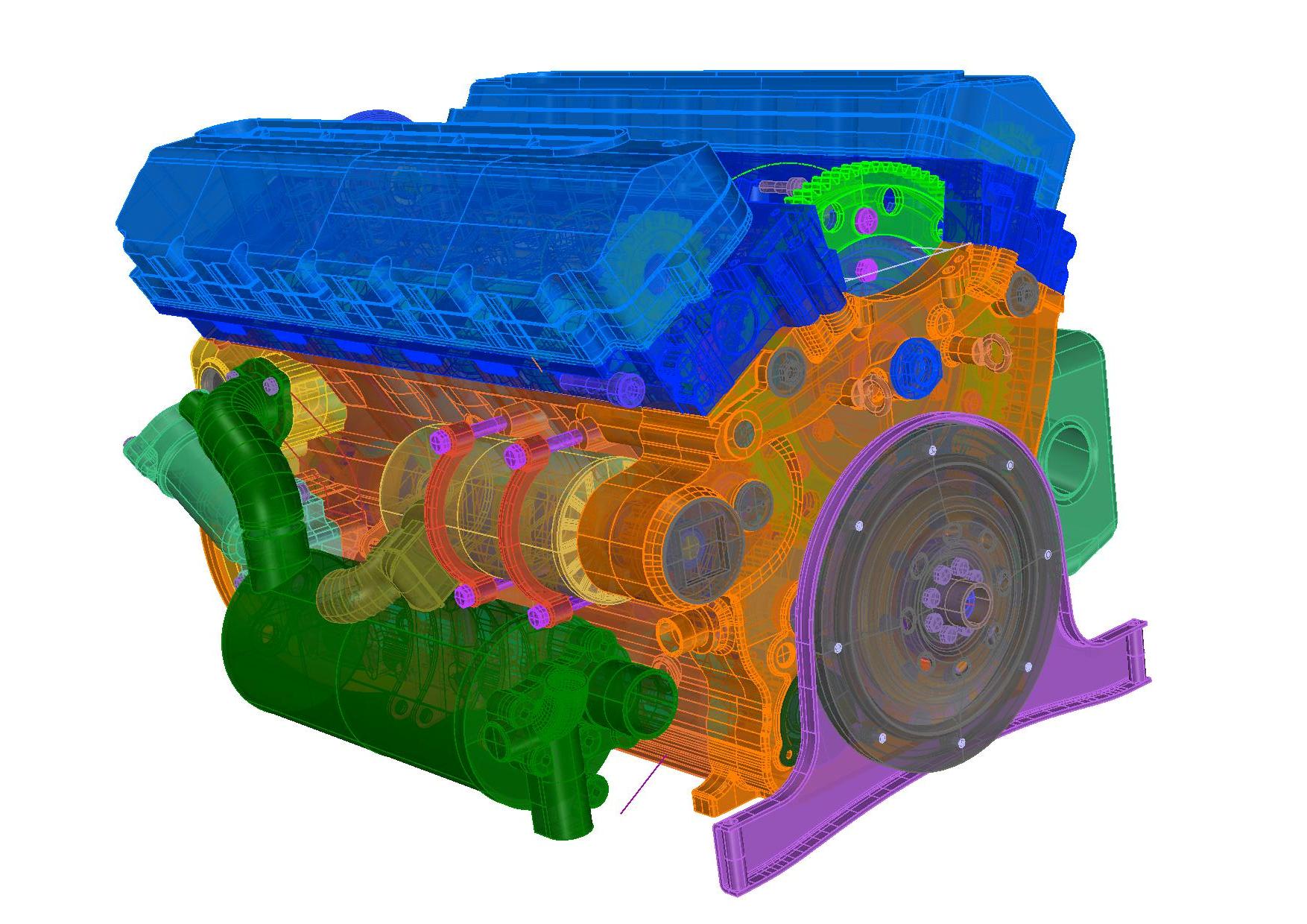

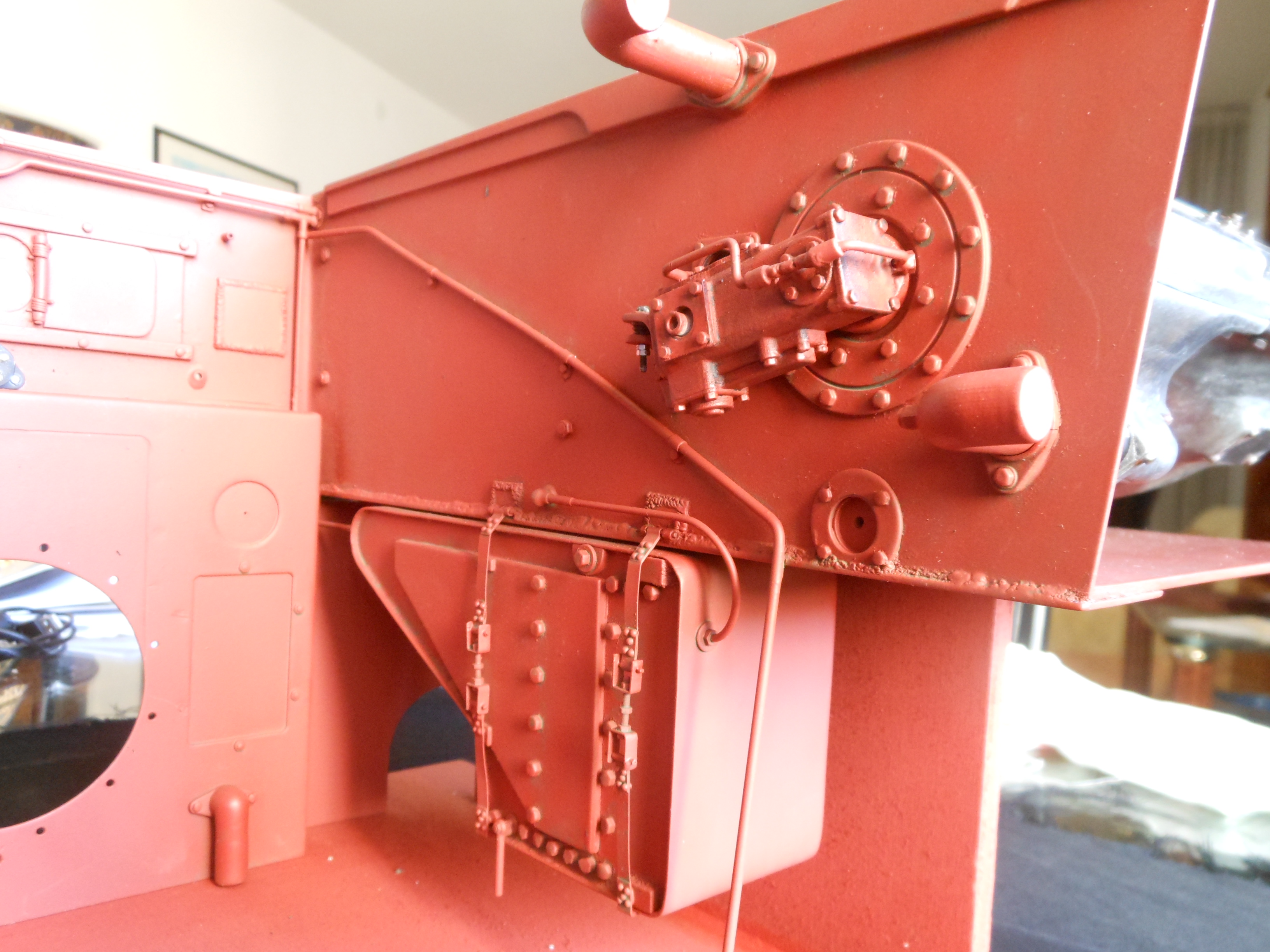

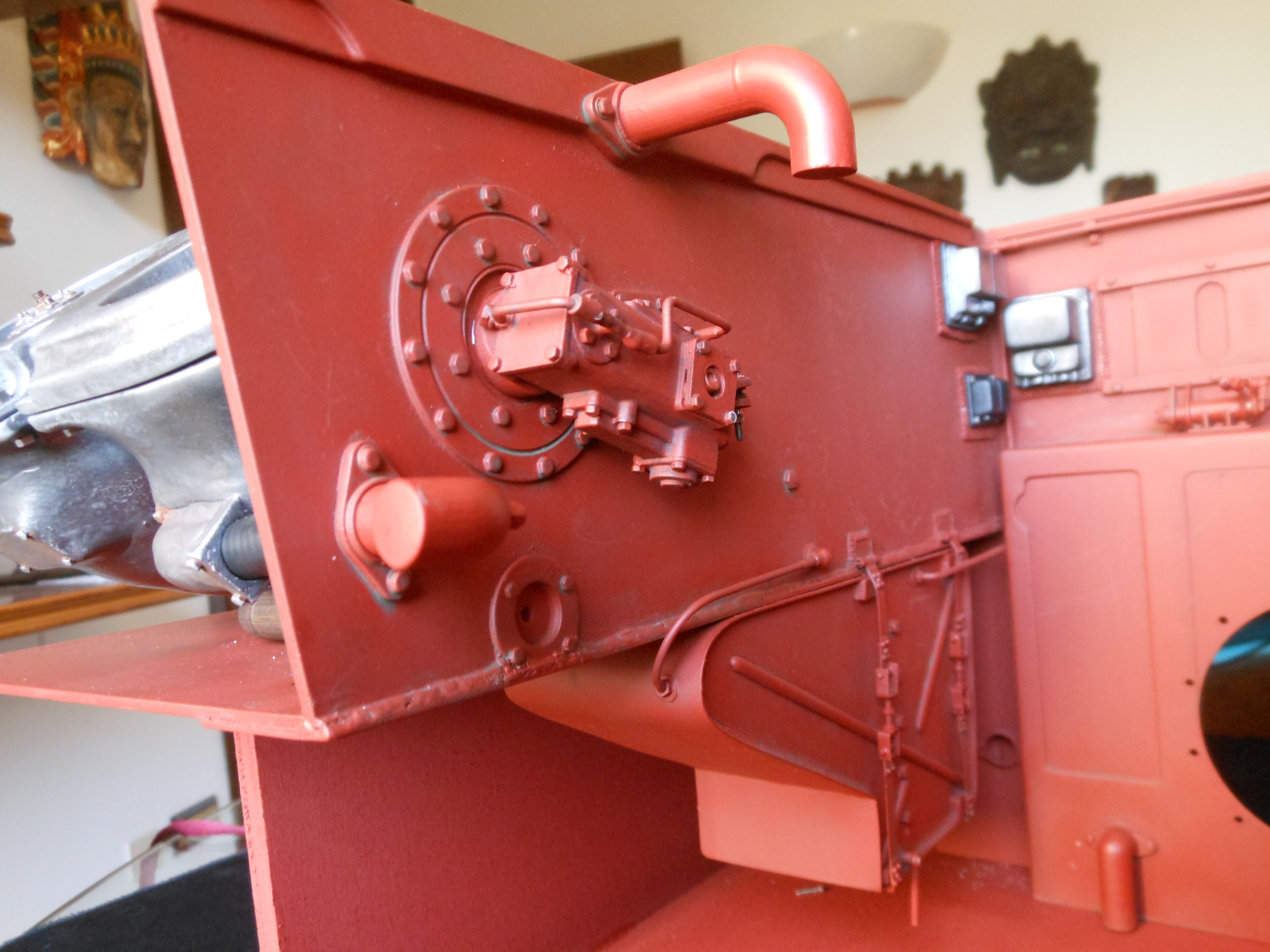

Sorry, instructions on a photo is wrong.
The fuel pump and filters must be mounted in this way.
You can make mistakes. That's why I recommend you also look at the photos of the real engine
Ivano Costantini
Posts: 533
Been liked: 735 times
Re: New engine for Tiger1
Post by Ivano Costantini »
The transparent filters,
they must be positioned downwards

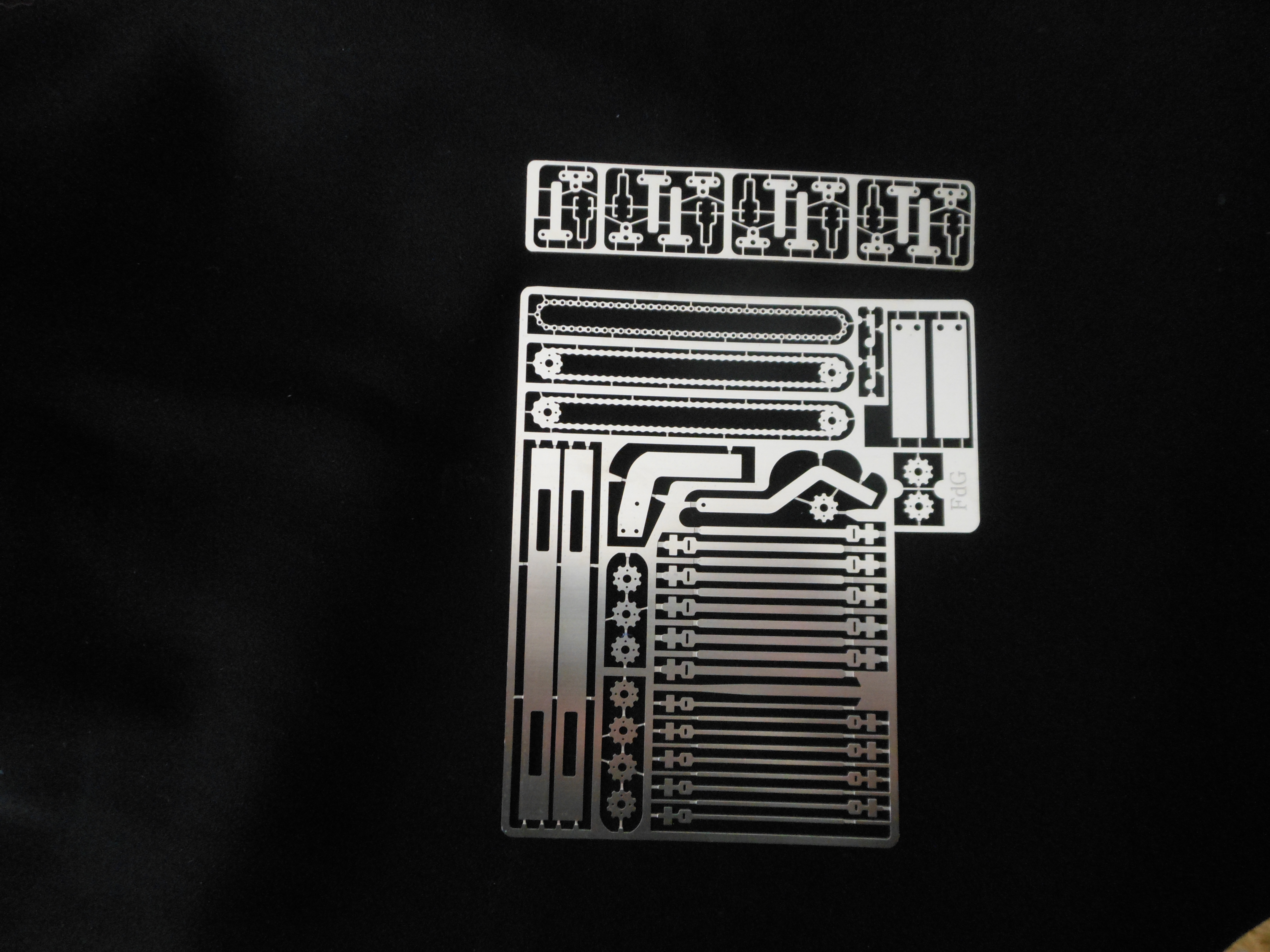

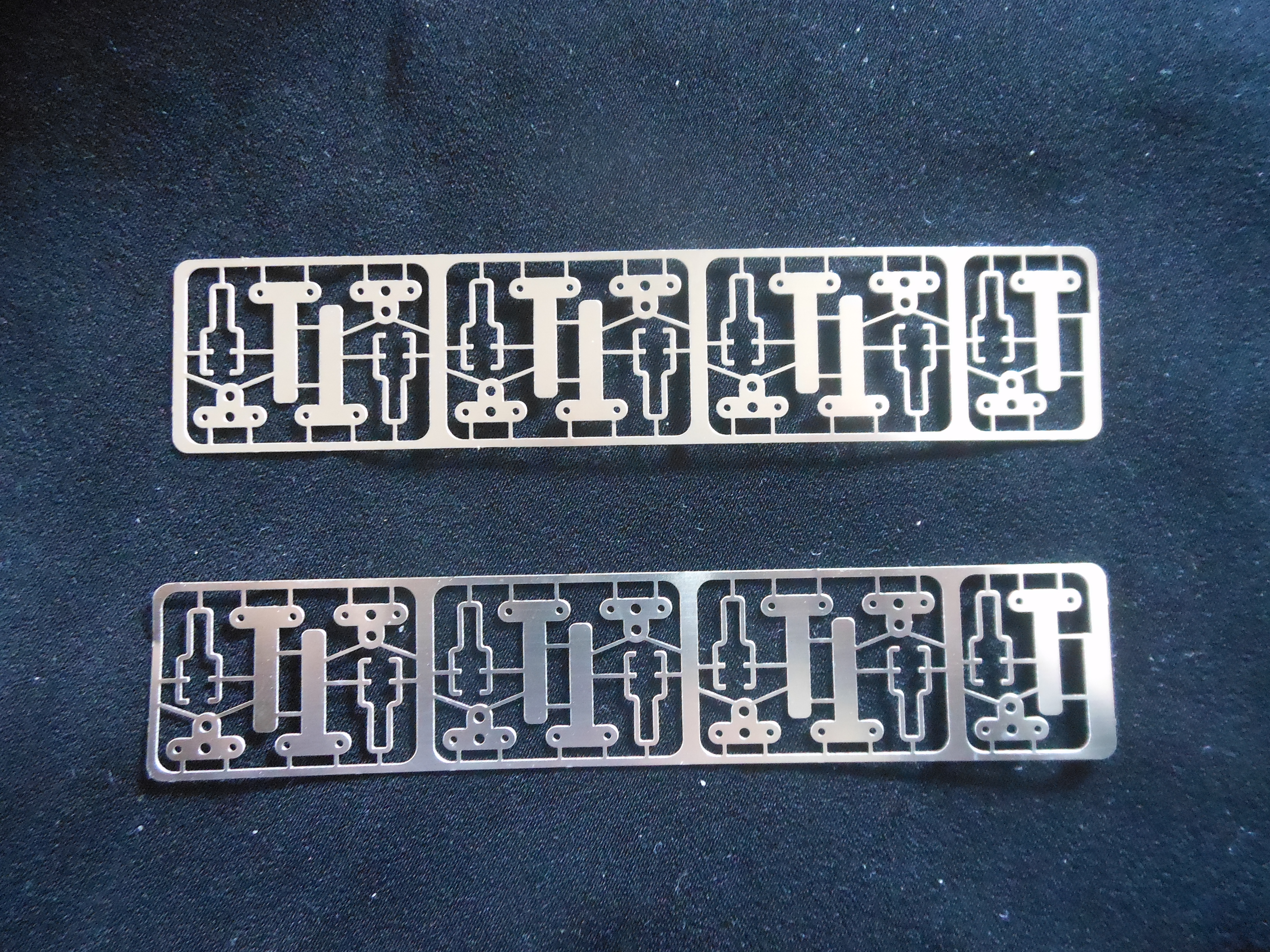

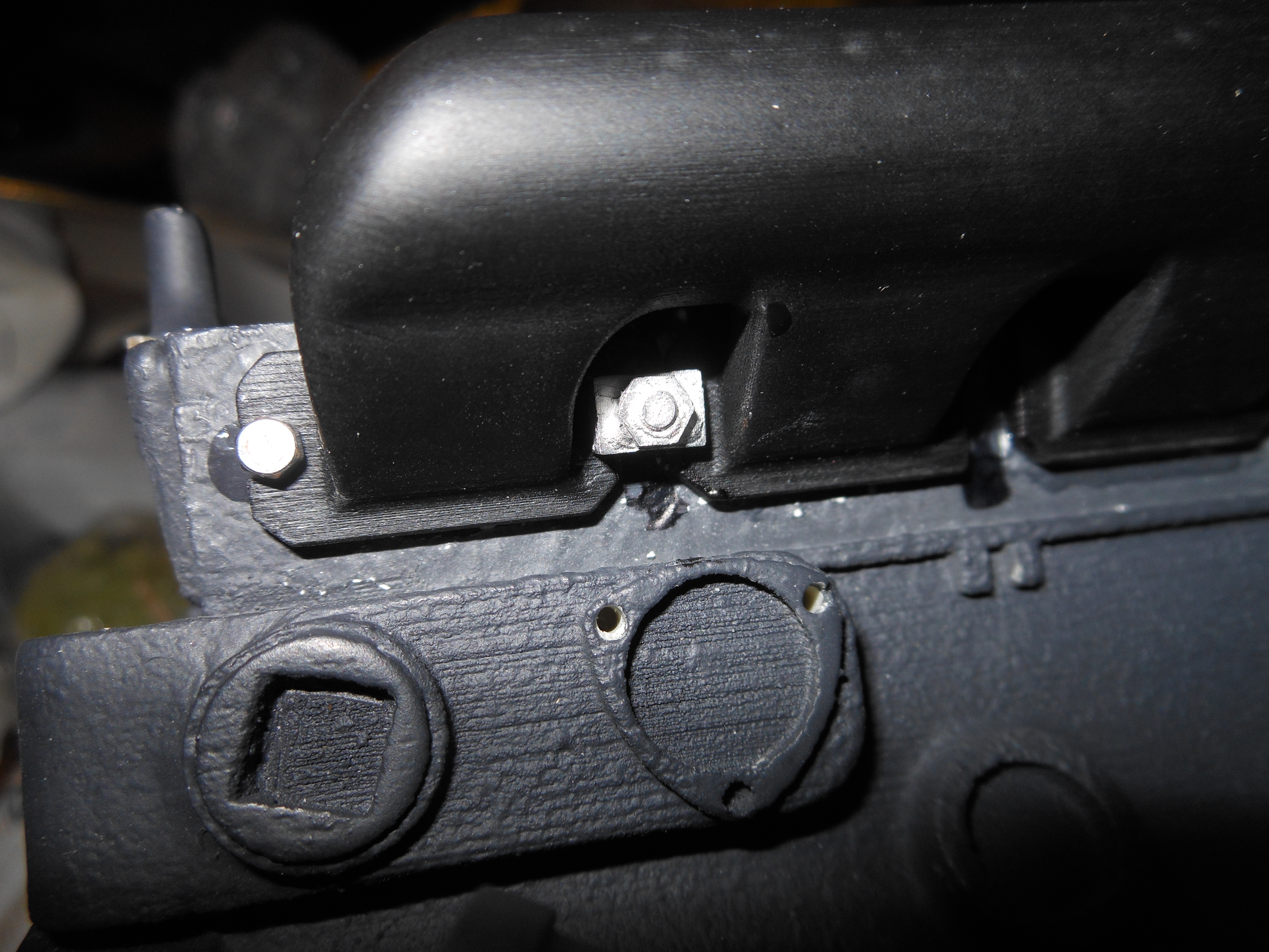

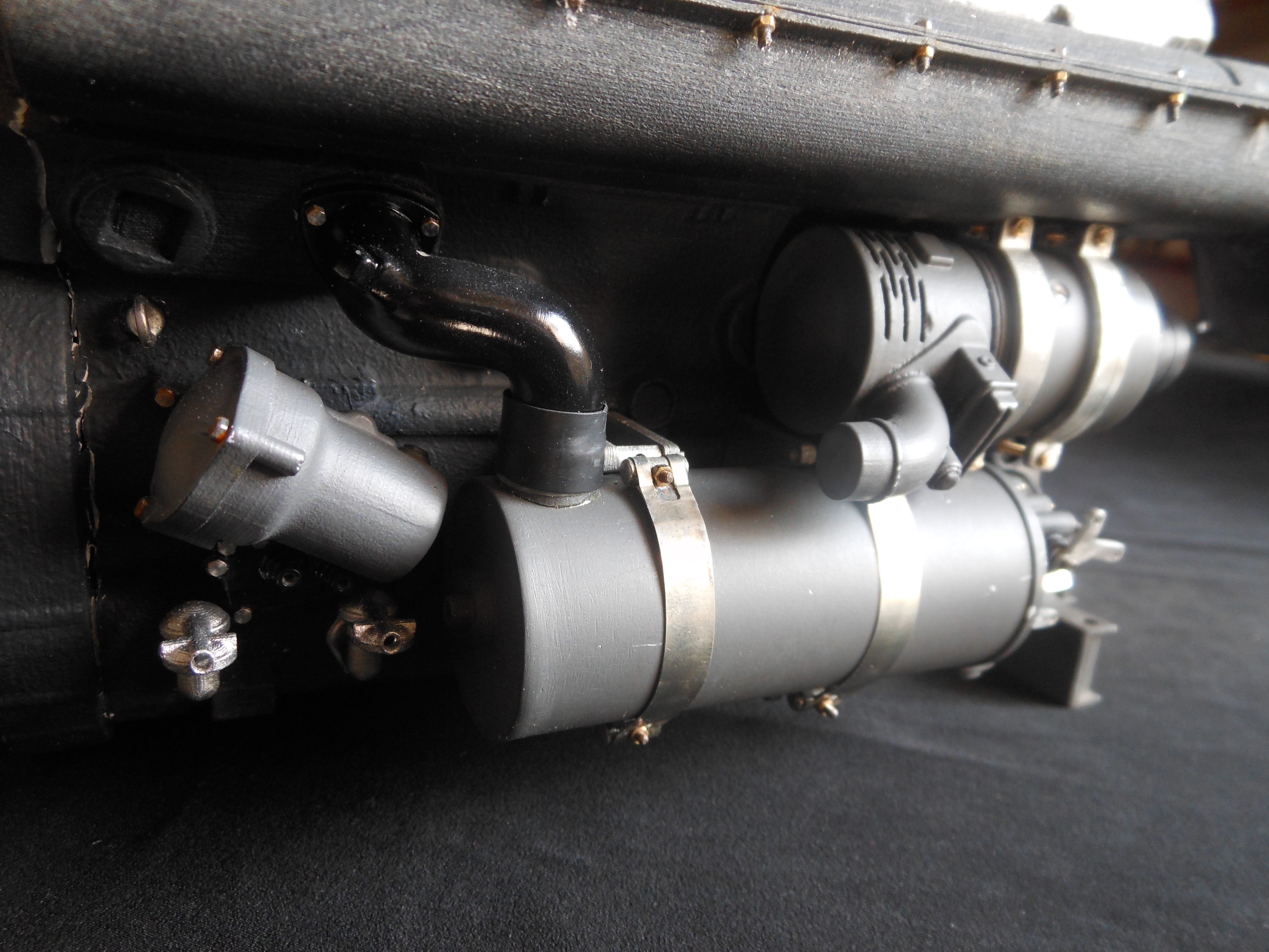

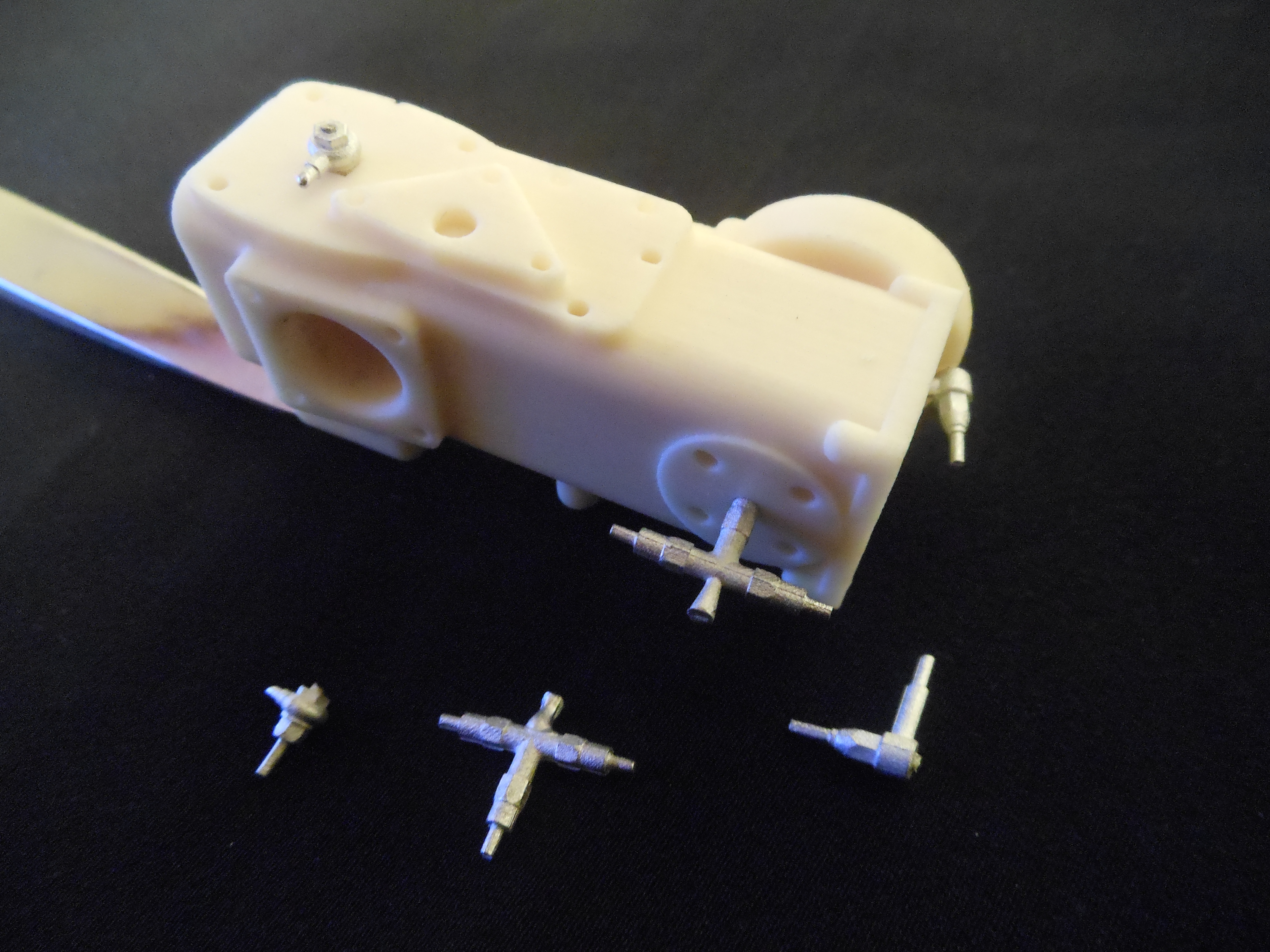

some photos to show you where to put metal pieces
Closing clamps for air filters
Hose clamps
Hose clamps

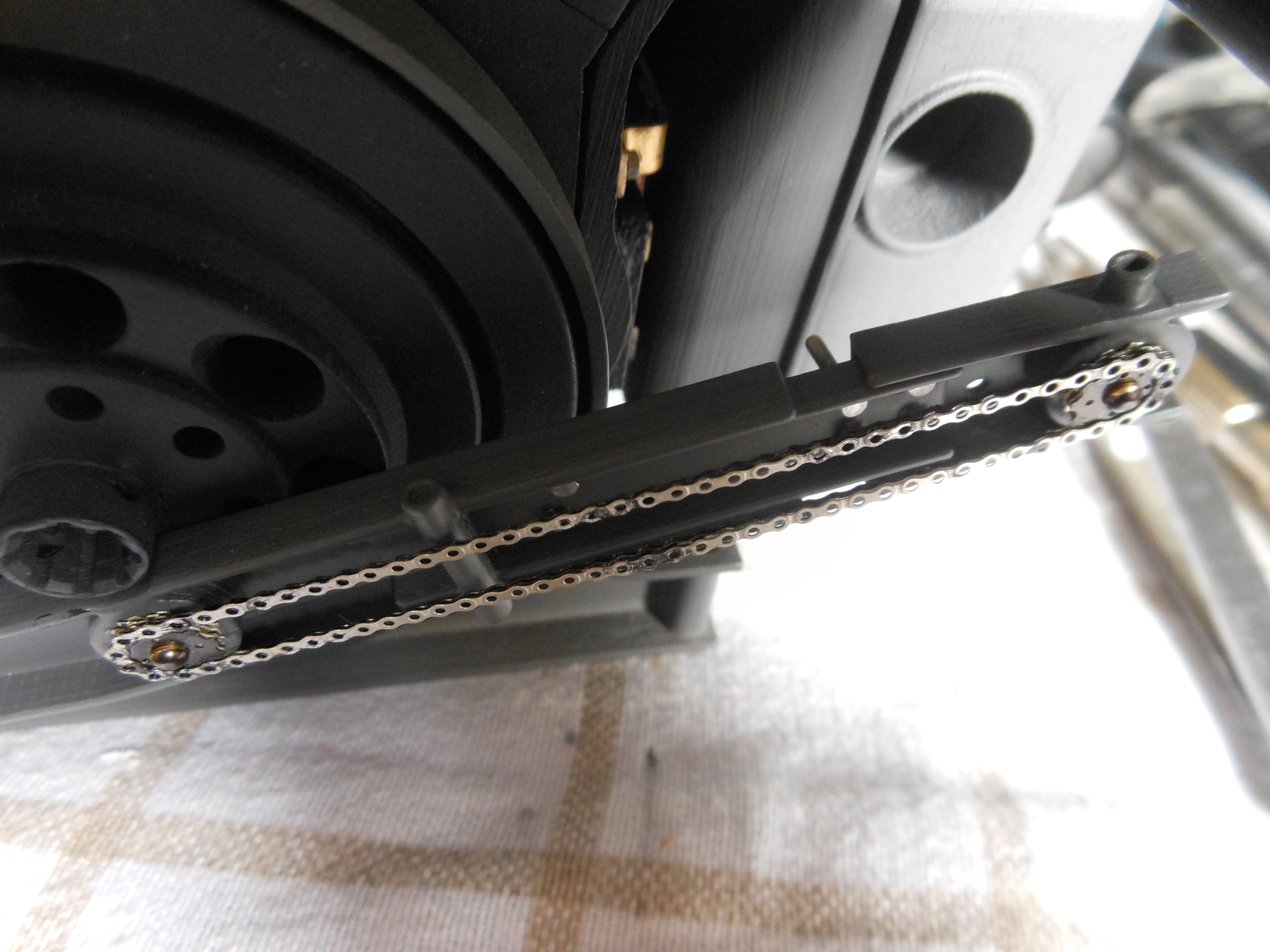

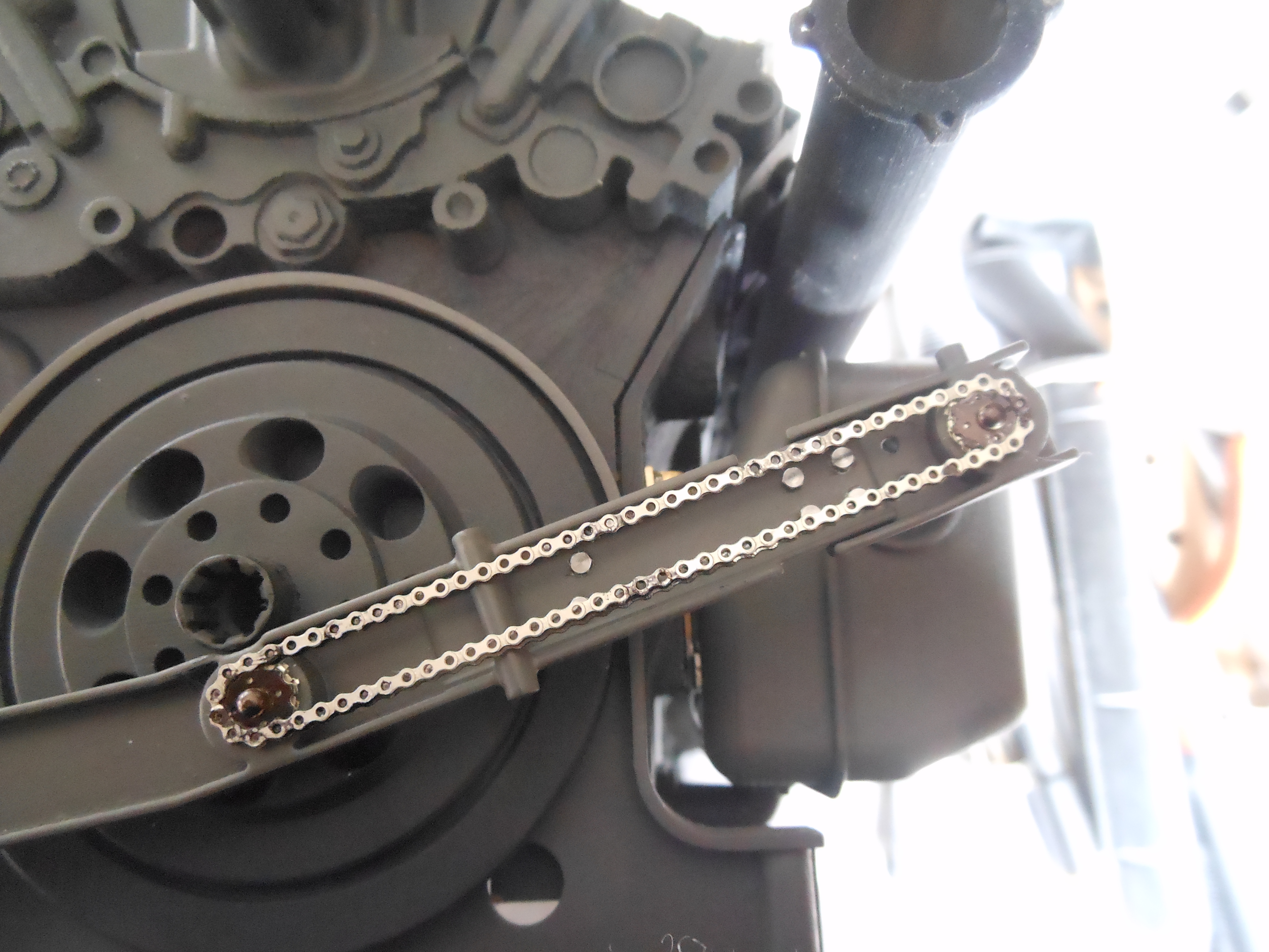

The chain is mounted this way: overlap five toothed wheels on each side, then insert the two chains with the wheel and, in the end, only the chain.
All glued or welded with tin. Attached to base with rivets and nuts M1.6.

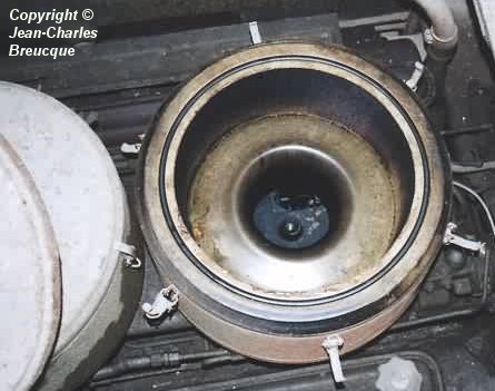

Clamps air filters to the truth
filtro aria clamps.jpg (13.56 KiB) Viewed 10330 times

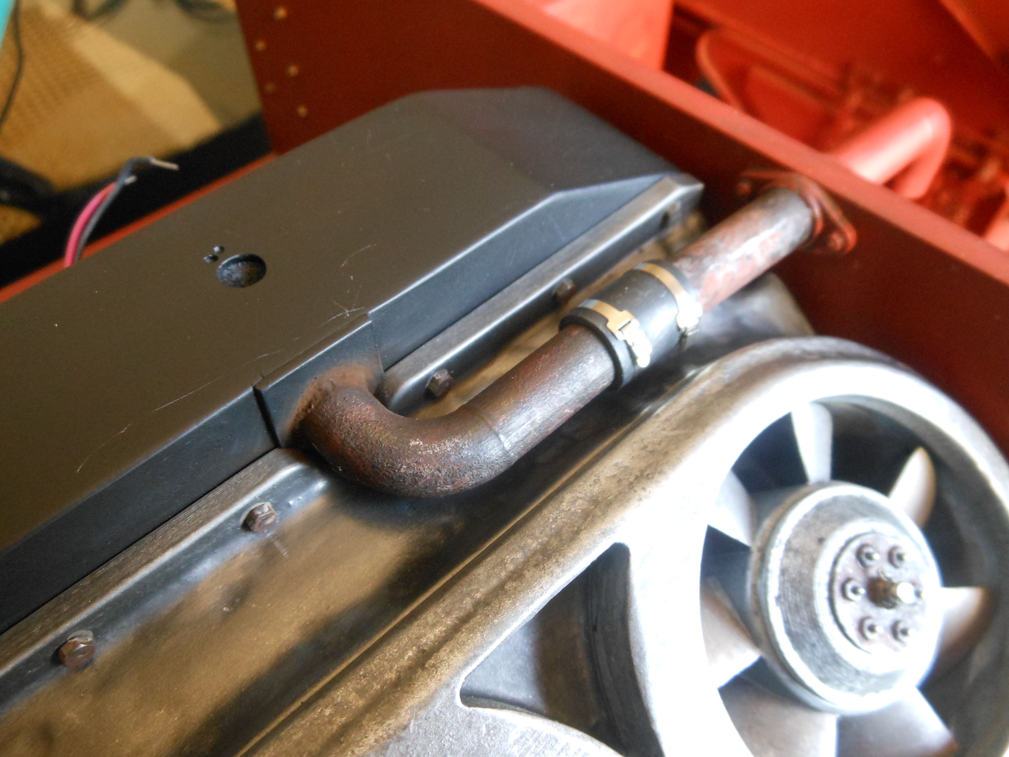

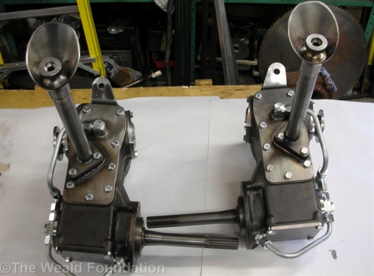

Hello to all,
Do you know what this mechanism is and how does it work?
I did not find any documentation.
Thank you very much

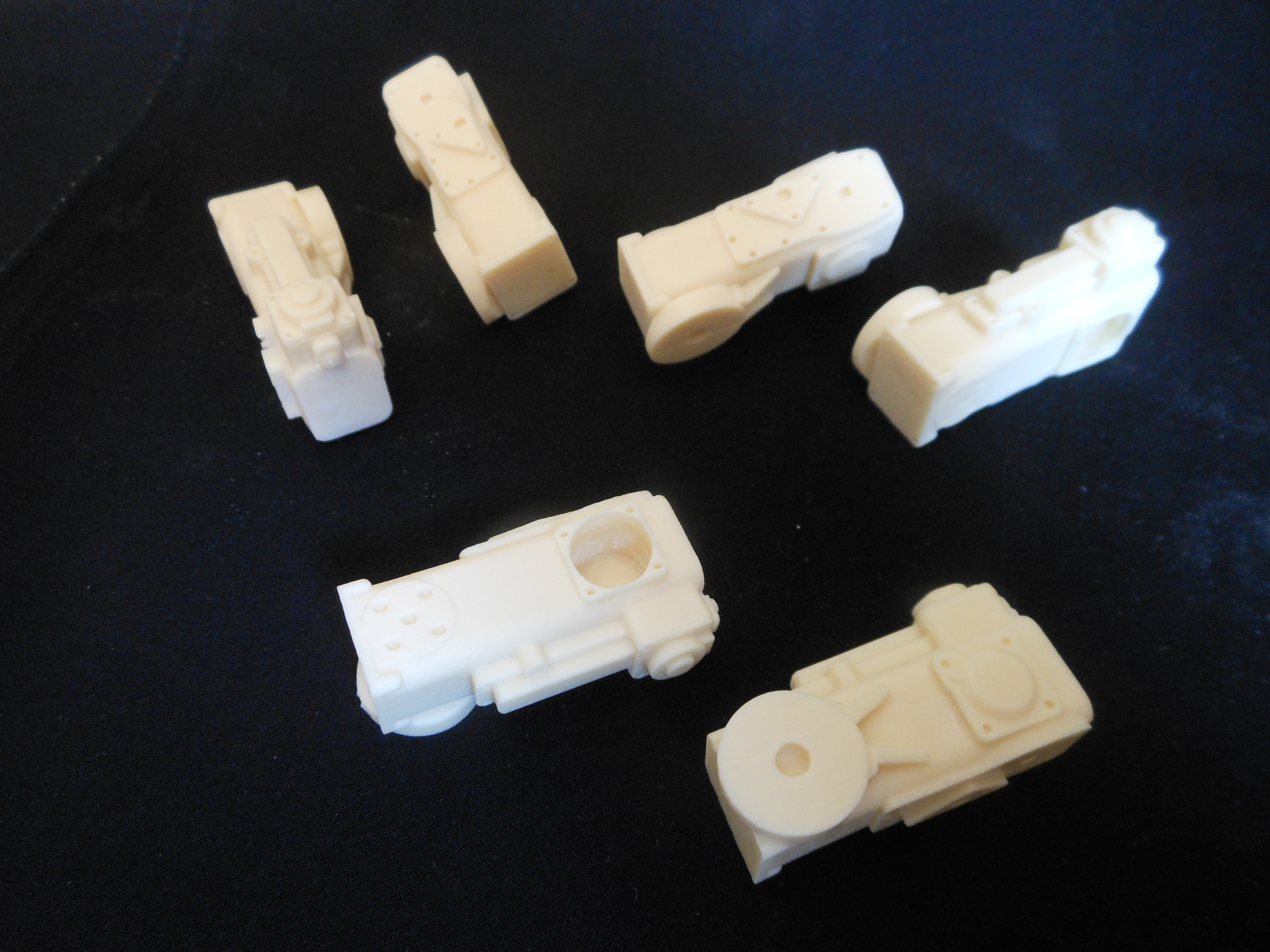

I have reduced the size of the fan clutches.
In some engine compartments they are not in scale, they are better. I will send them
Free for anyone who has purchased the engine compartment details.
Thanks Ivano

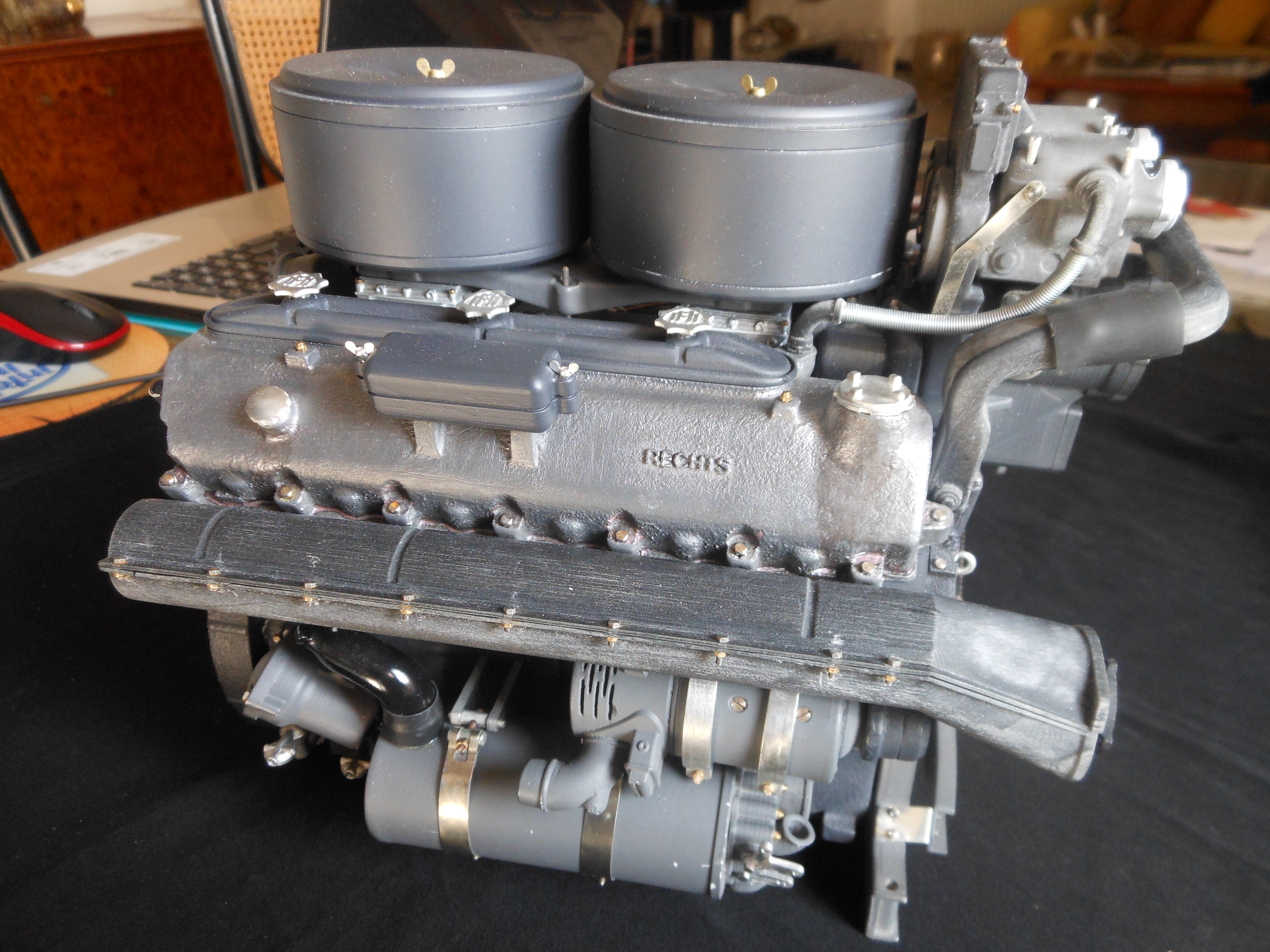

Hello to all,
here is how you can set up the engine compartment, a bit of patience and some
self-built details-Now I just have to install my engine with all the finite details
Paul Wills
Posts: 1043
Location: The Lake District
Has liked: 646 times
Been liked: 143 times
Post by Paul Wills »
Wow, that is lovely work Ivano, really great eye for detail.
Paul. :wink:
