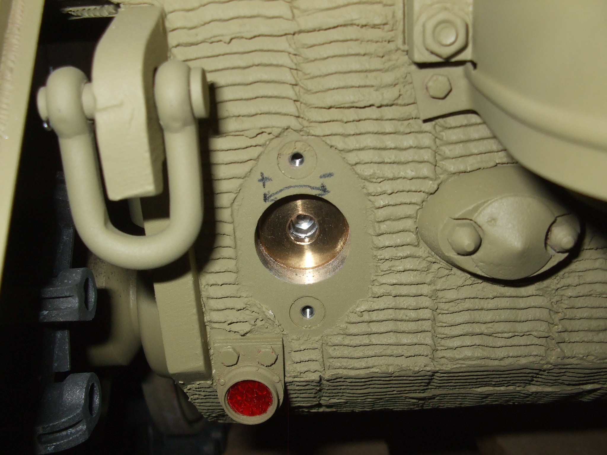

I then decided to tackle two issues which I had been putting off. The first one was the track tension. The left hand one was nearly good as is but the right hand one was a bit loose. So first I tried to remove a track link but it was obvious that the track would become tight. So next I resorted to adjusting the track tension mechanism but wasn't sure which way I need to turn to increase tension. So decided to open the engine hatch to see which way I need to turn the allen screw to increase the tension.

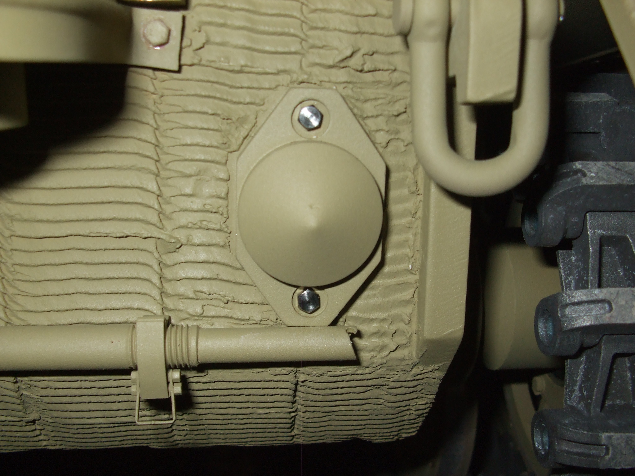

This is where I found that I couldn't open the engine hatch as it was hitting the zimmeritt of the turret. I also noticed that the two tie-downs I had fitted in front of the engine hatch had broken off. Must have broken them off during the turret turn trials.
Broken tie-downs and scratched zimmeritt
Had to reduce the thickness of the zimmeritt to be able to open the engine hatch. After adjusting the tracks, I left a pencil mark to show me in the future which way I need to turn the screw. I copied this from Phil's Tiger 1 build.
Track tension adjuster markings

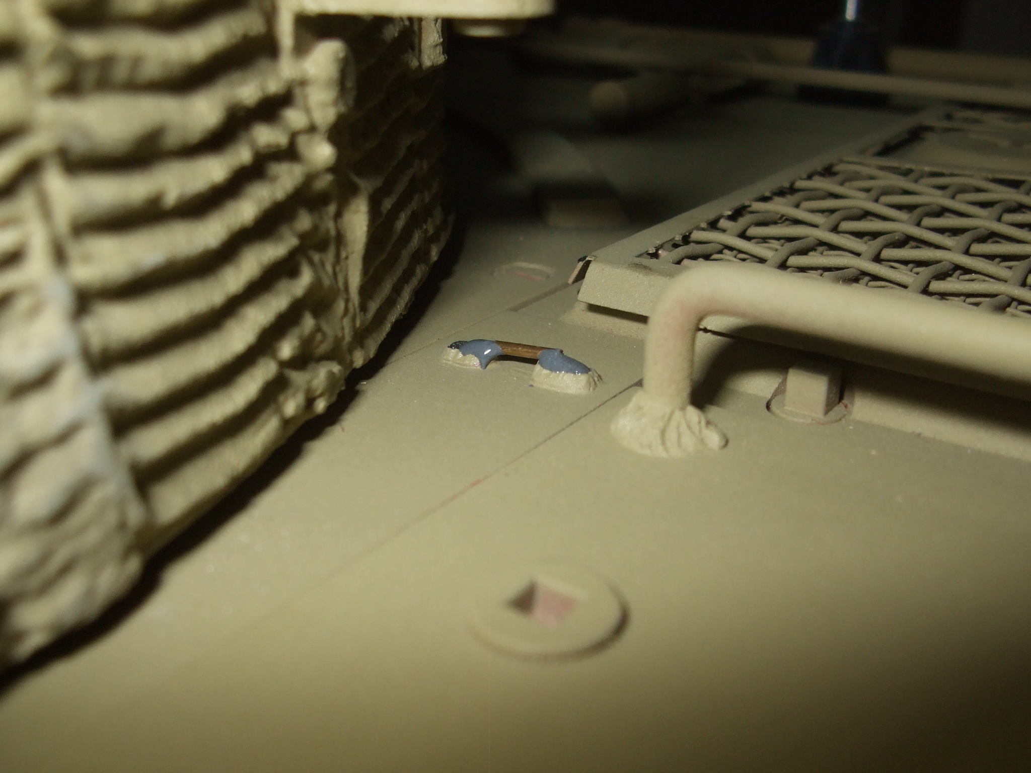

Finally, fixed the two broken tie-downs by gluing a piece of 1mm rod. This would give them a low profile so that they won't be broken again by the turret.
Low profile fix
Low profile fix

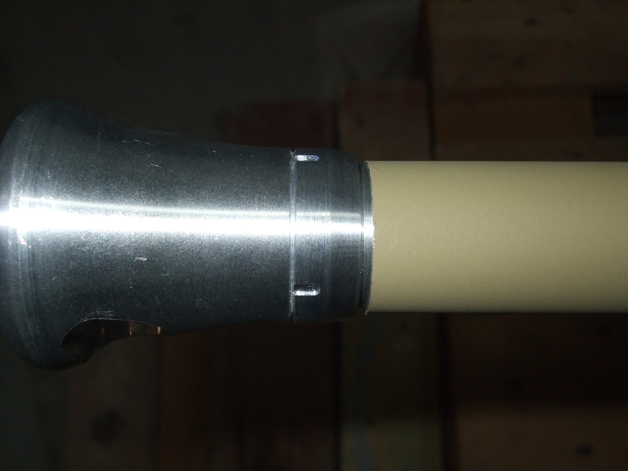

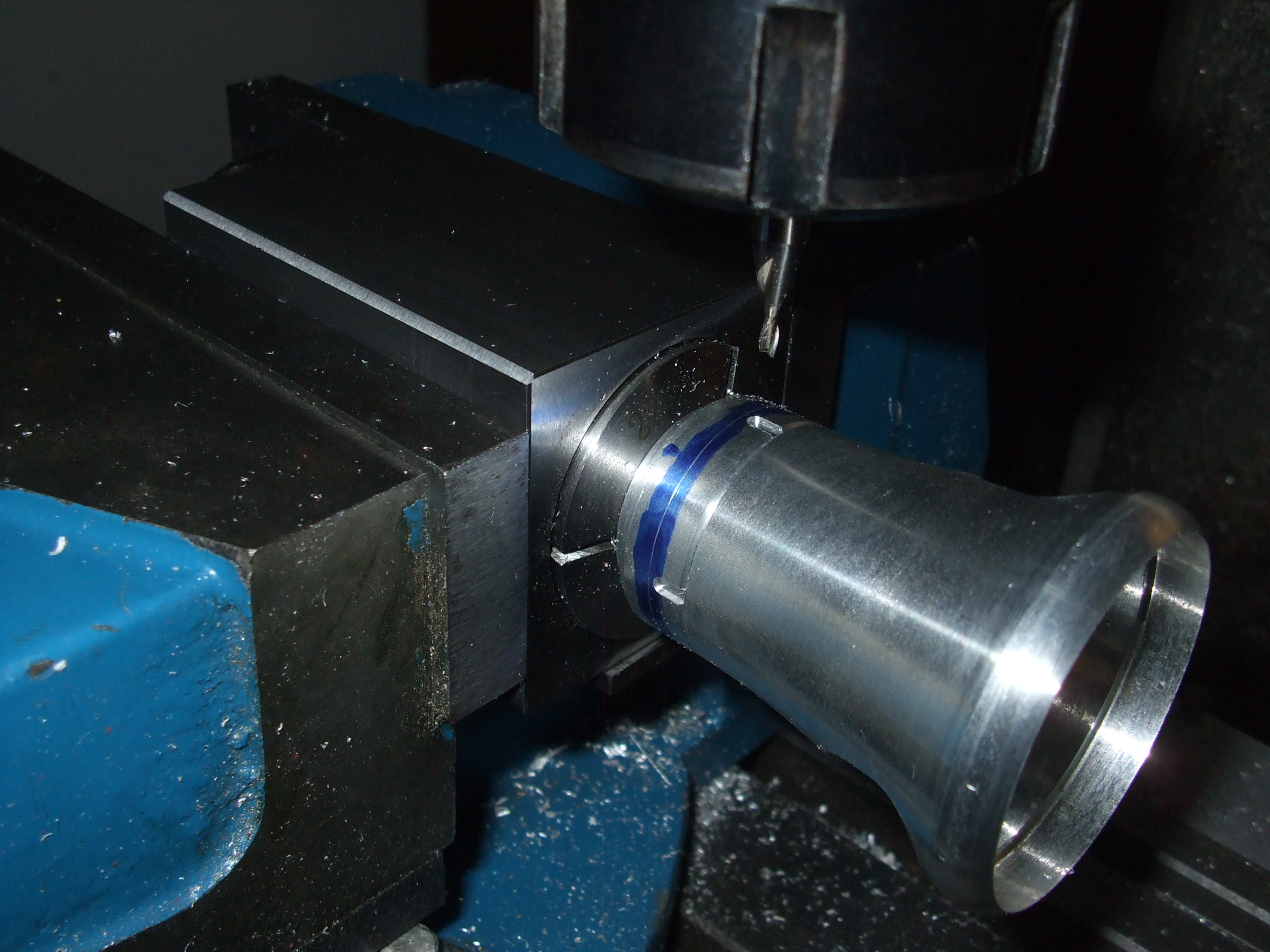

Last Saturday received the 22mm 5C collet I had ordered and started work on the muzzle brake. Today I finished all the work I wanted to do.
Cutting the C spanner slots
Added a slight taper at the back of the locking ring
All the parts
All the parts
The muzzle brake parts have increased from the original three to eight. Now to paint and assemble them.
