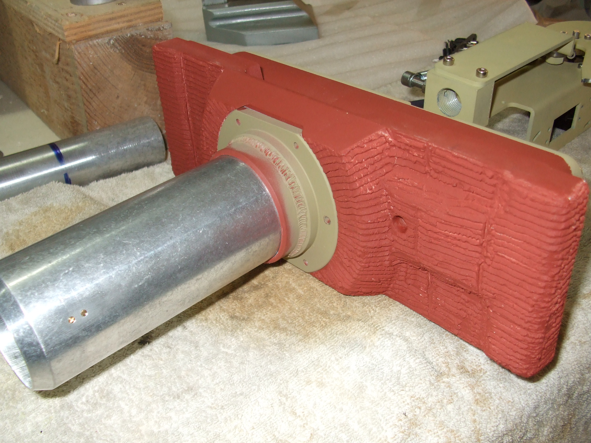

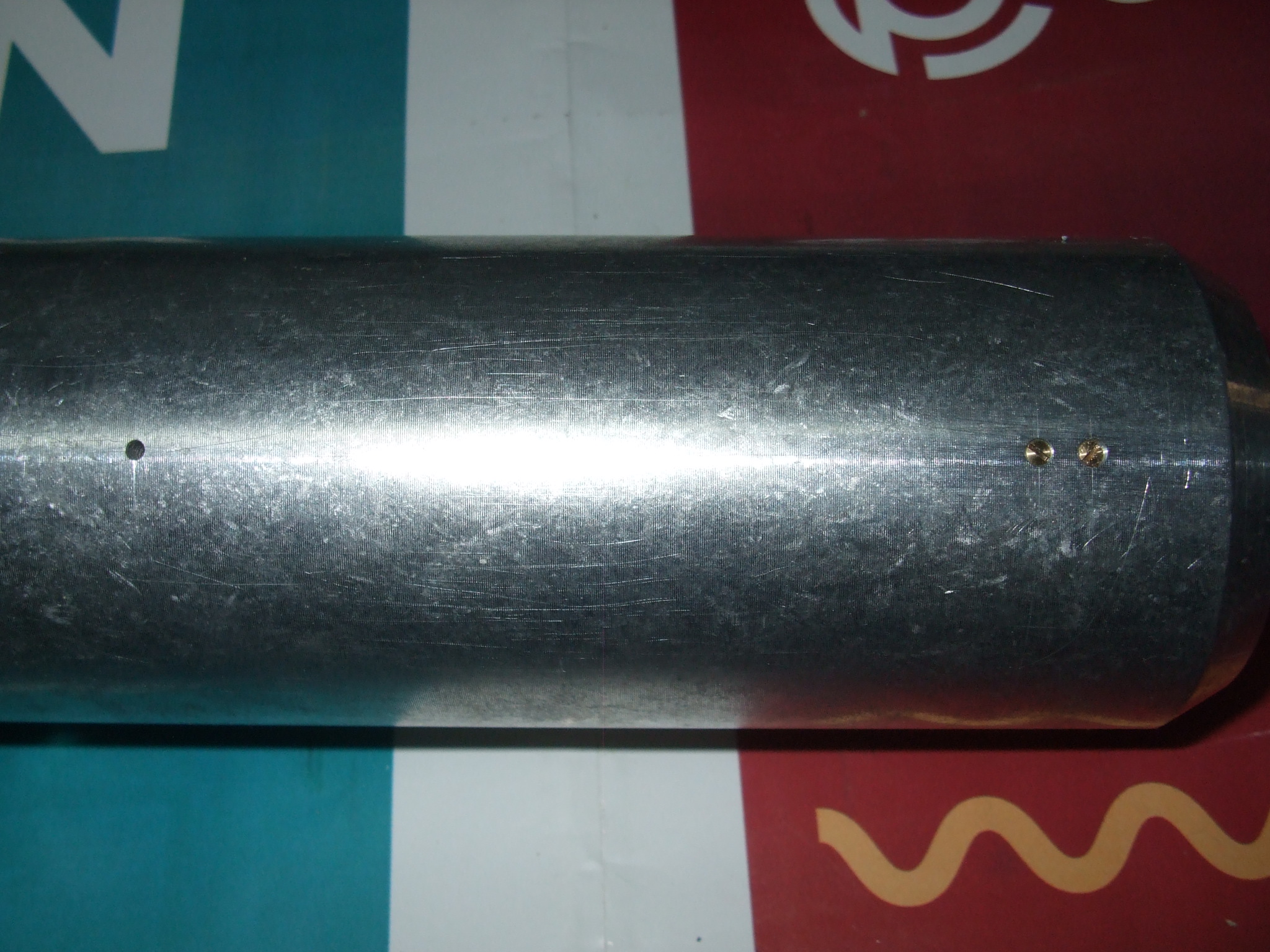

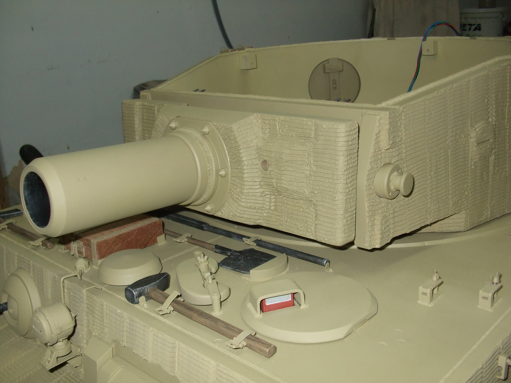

Have all the parts to finish off the barrel sleeve.
Cute little things but fiddly to handle. As the screws will not be functional, I just drilled and glued them in. Also wasn't in the mood of setting up my 20kg dividing head and just used a tailor's inch tape to locate their positions. Must be an age thing.
Now I can continue to paint the mantlet. To not have my usual paint interference problems, I will be painting the barrel sleeve in situ.

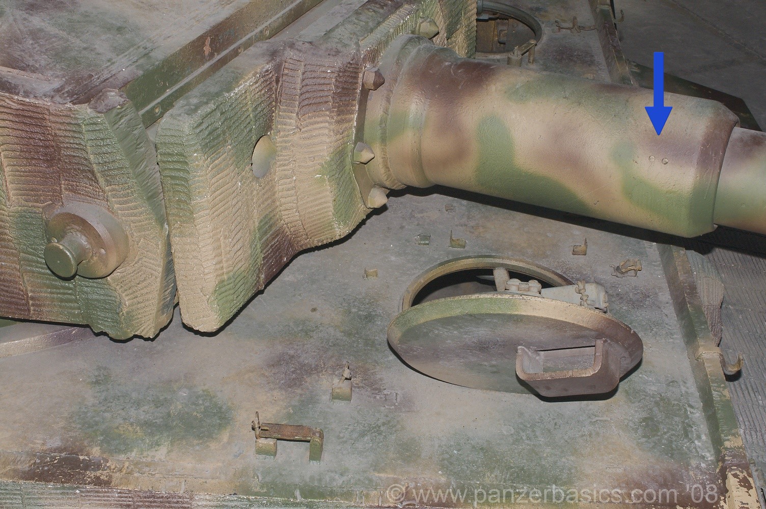

Hi Vince,
there were three pairs of equidistant screws, which contained an inner rubber ring that prevented dirt from entering the inner area of the gun.

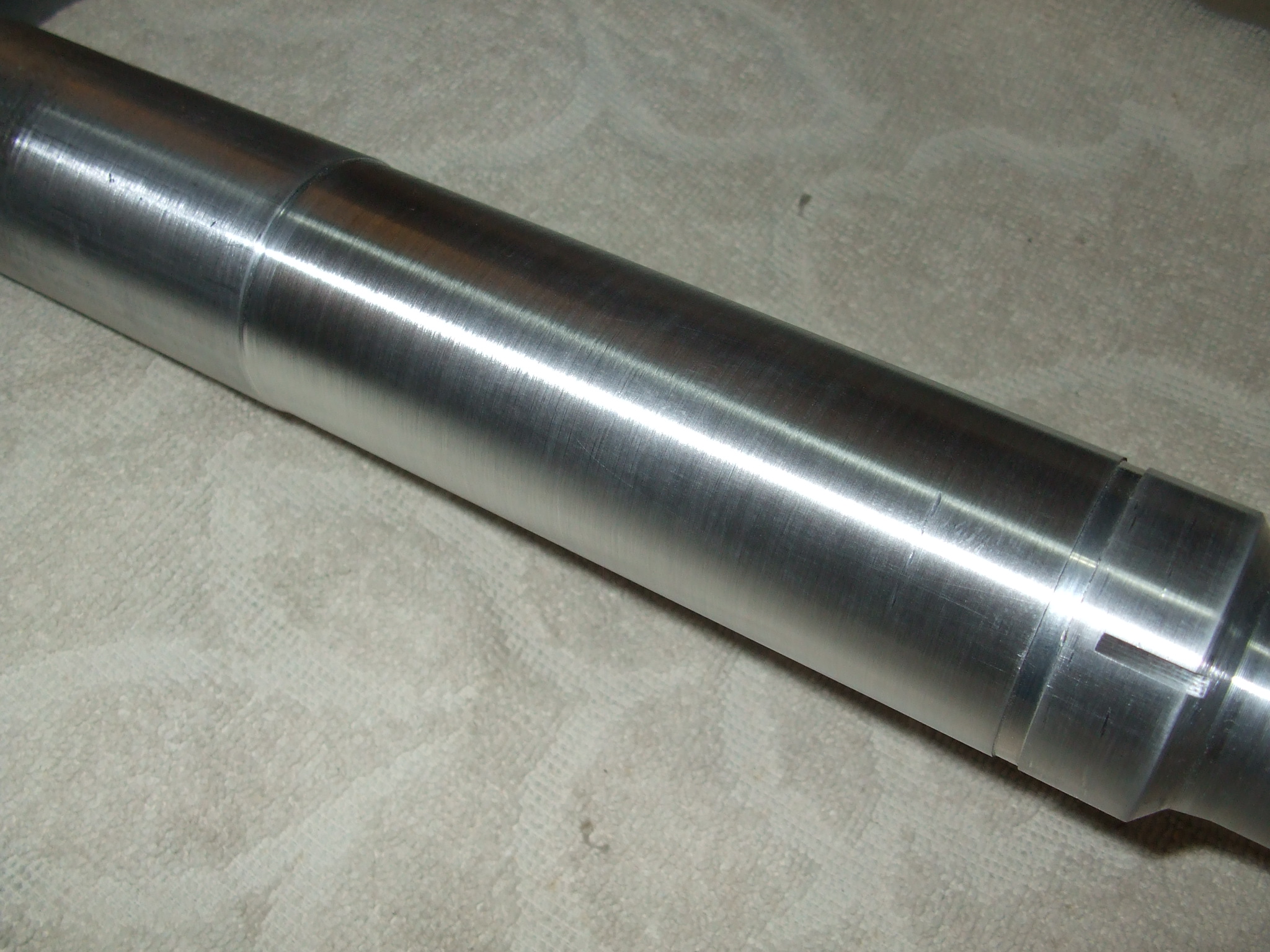

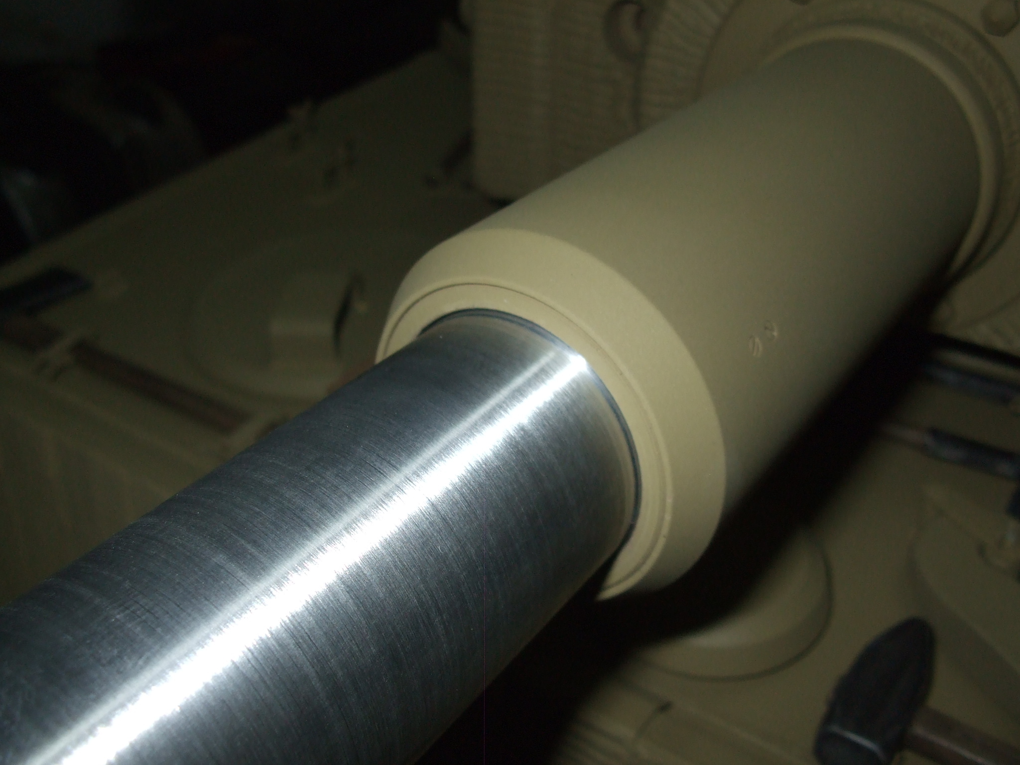

Today it was a productive day. Finished work of the barrel. All it needs is painting.

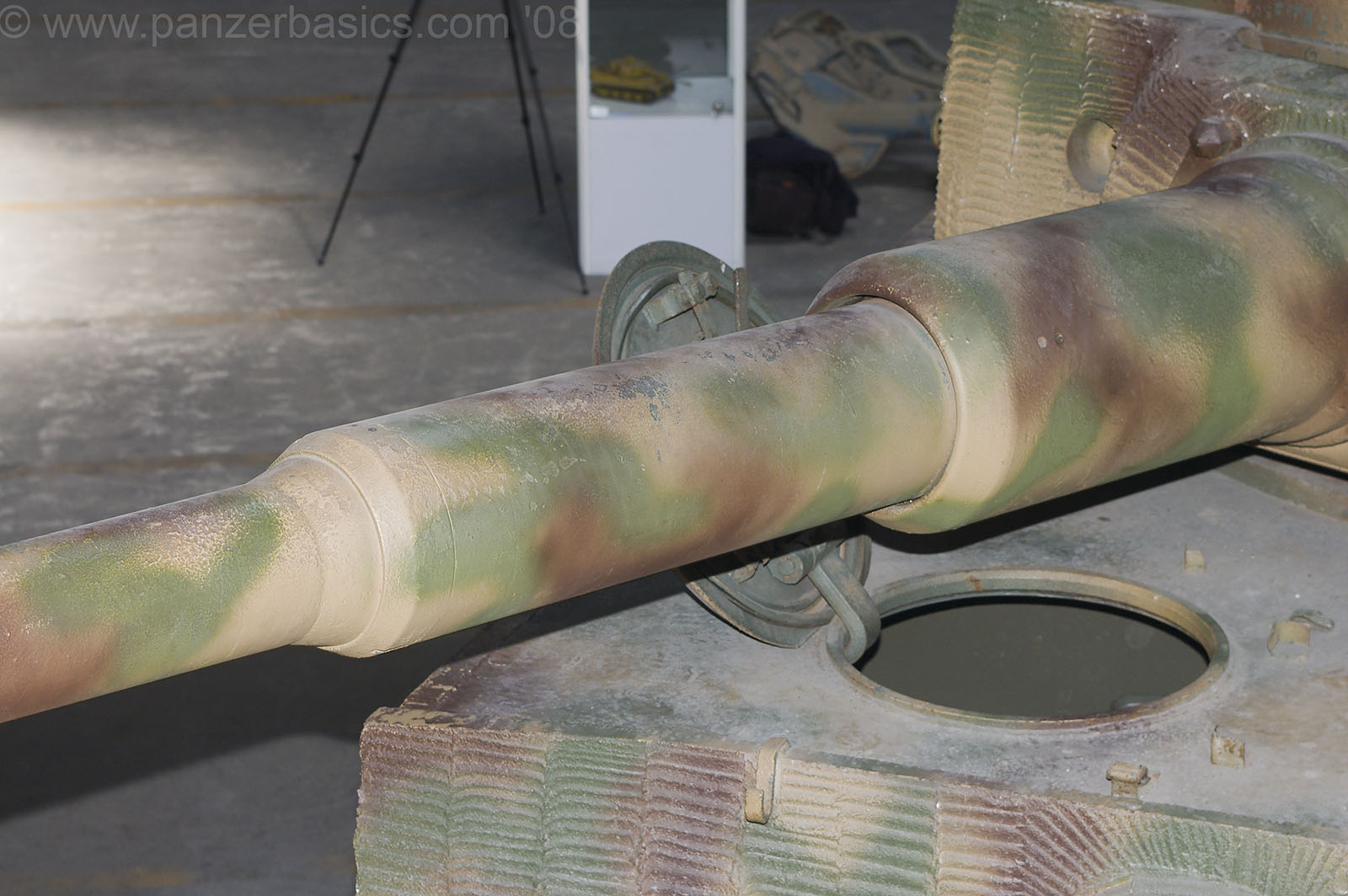

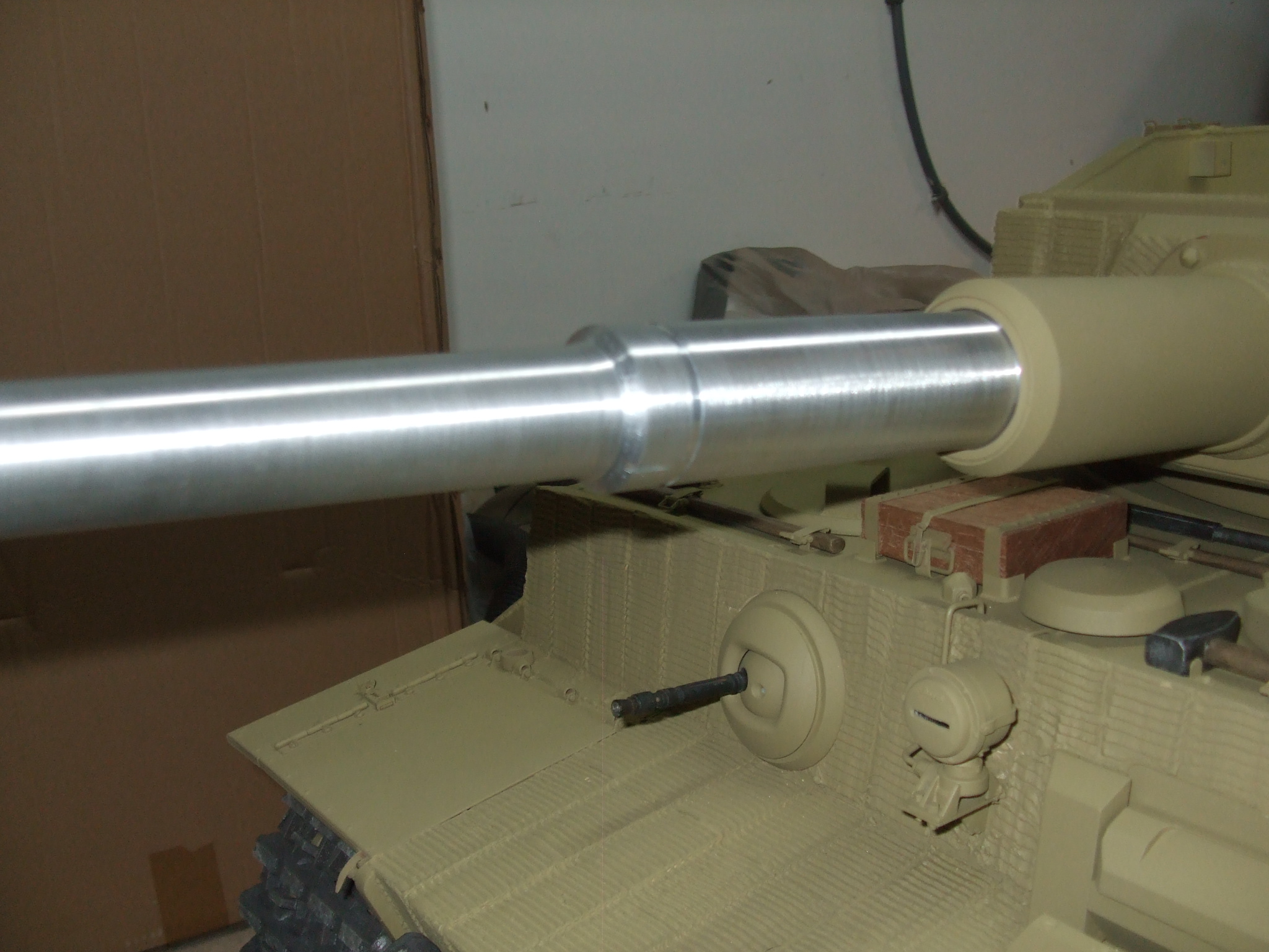

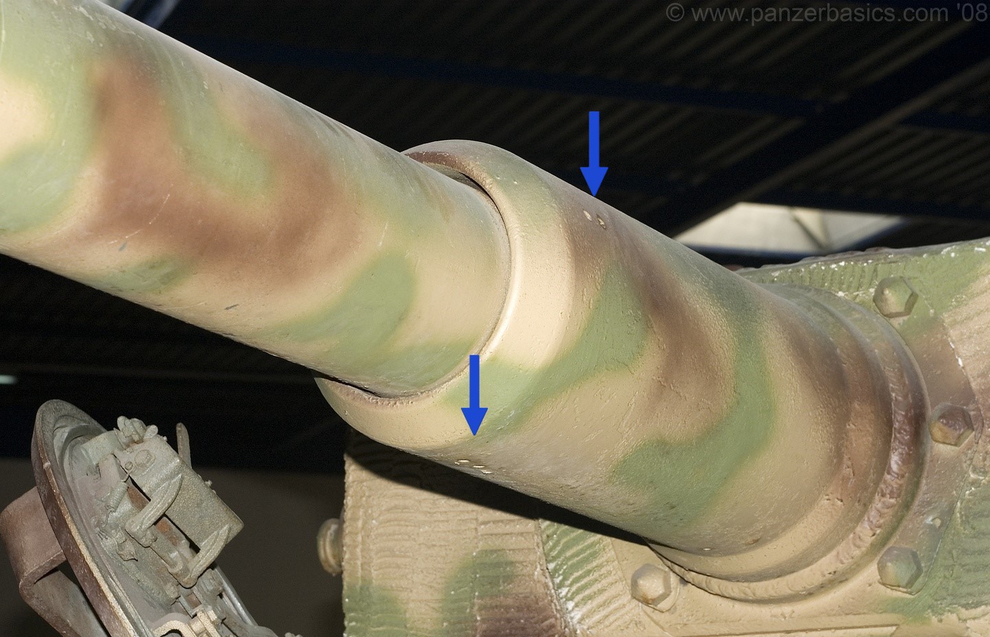

Something that has been bugging me since I started playing with the recoil is will the recoil continue to work once the barrel is painted. Most probably it will work but at the very least the paint will start getting rubbed off and at the worst the barrel will start to bind in the plastic bush of the barrel sleeve. Fortunately whilst I was researching the number of grooves in the barrel locking ring, I came across the following photo.
If you zoom in, one will notice that there is a step in the barrel diameter as the barrel enters the barrel sleeve. It is even shown here:
http://tiger1.info/EN/Gun-dimensions.html

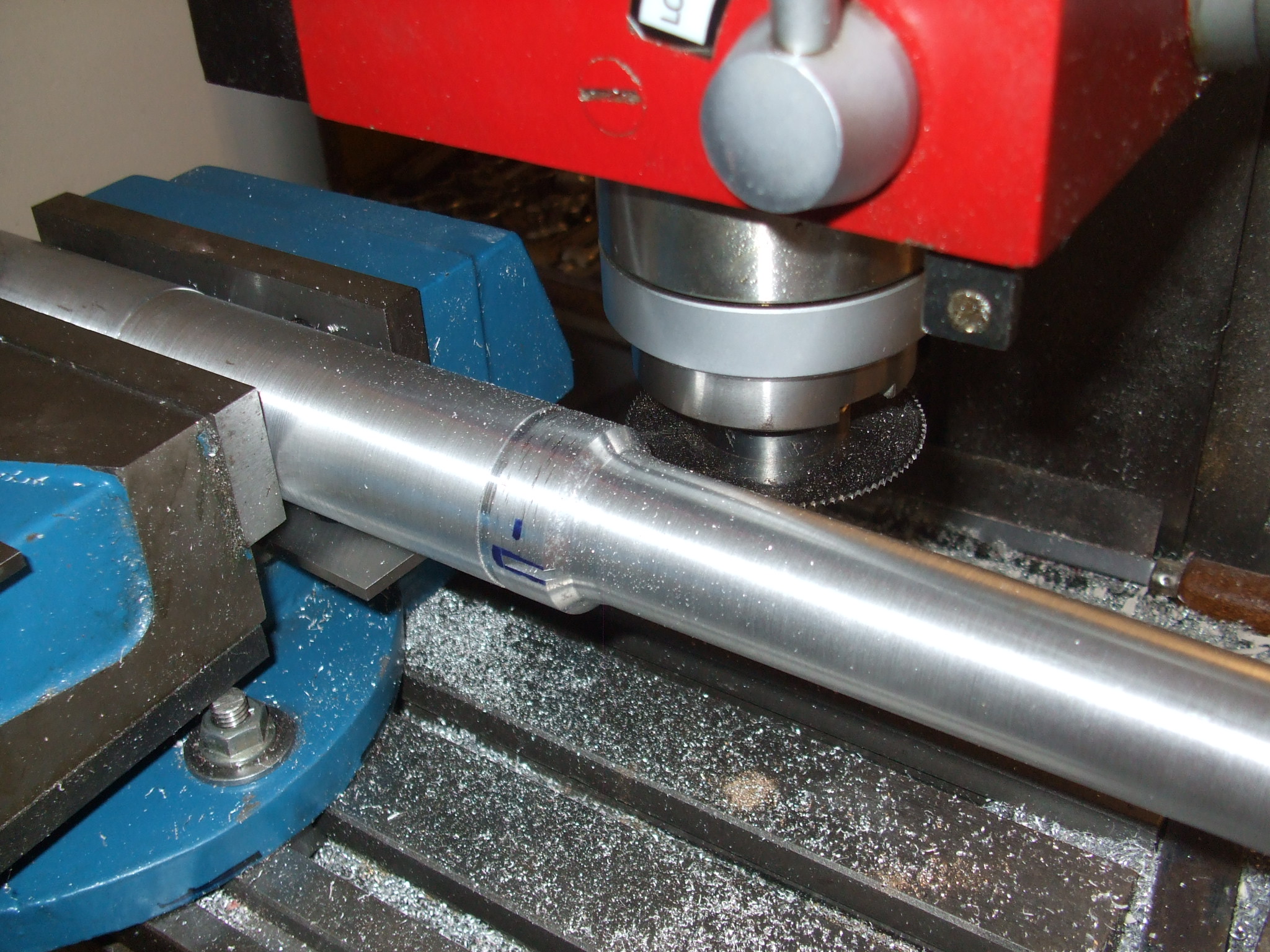

So first thing I did today was reduce slightly the barrel diameter to create the step. I then cut the two grooves in the locking ring. I made the groove 2mm wide and 1.5mm deep using a slitting saw.
Next and final component on the list is the muzzle brake. I suspect this will take some time to complete.

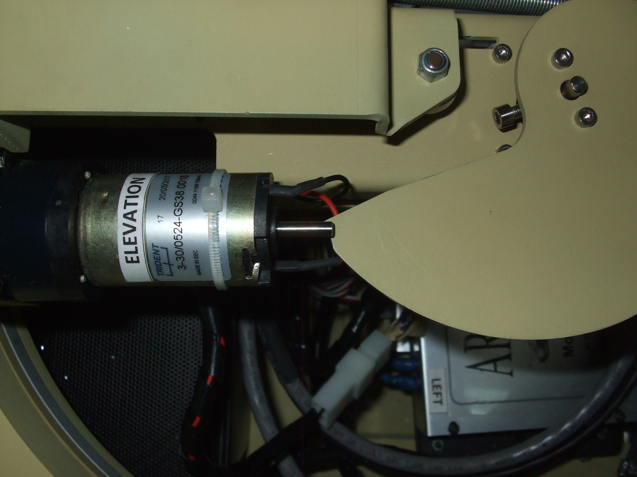

Yesterday, for the first time, fitted the elevation mechanism and recoil mechanism together in the turret. A problem was soon evident.
As can be seen, the recoil cam hits the shaft that protrudes from the back of the elevation motor. Quick email to Kian (with photo attached) and quick reply was that they sent me by mistake the elevation motor that was used before they started using a cam operated recoil. Was offered to get the motor replaced but also was suggested that I cut the shaft to size.
I took the "cut the shaft" option which I did today. Clamped the motor to the table and supplied it with 24V so that I get a clean cut with the Dremel using a cutting disk.
Elevation and recoil mechanisms refitted and tested successfully.
Thanks Monique and Kian for a super customer support.

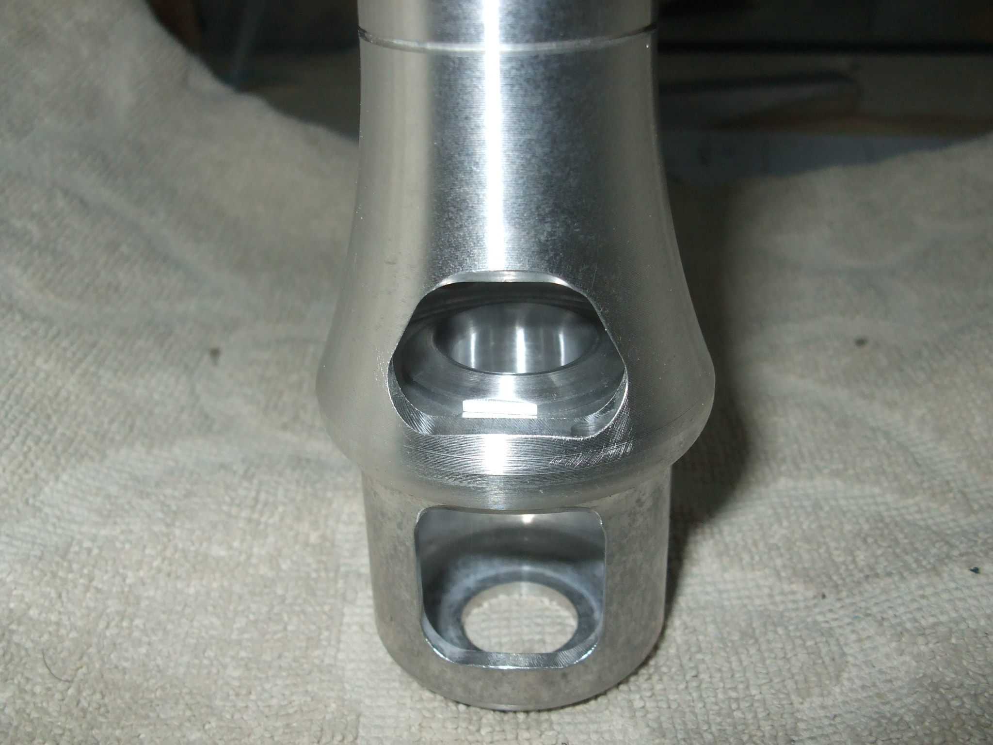

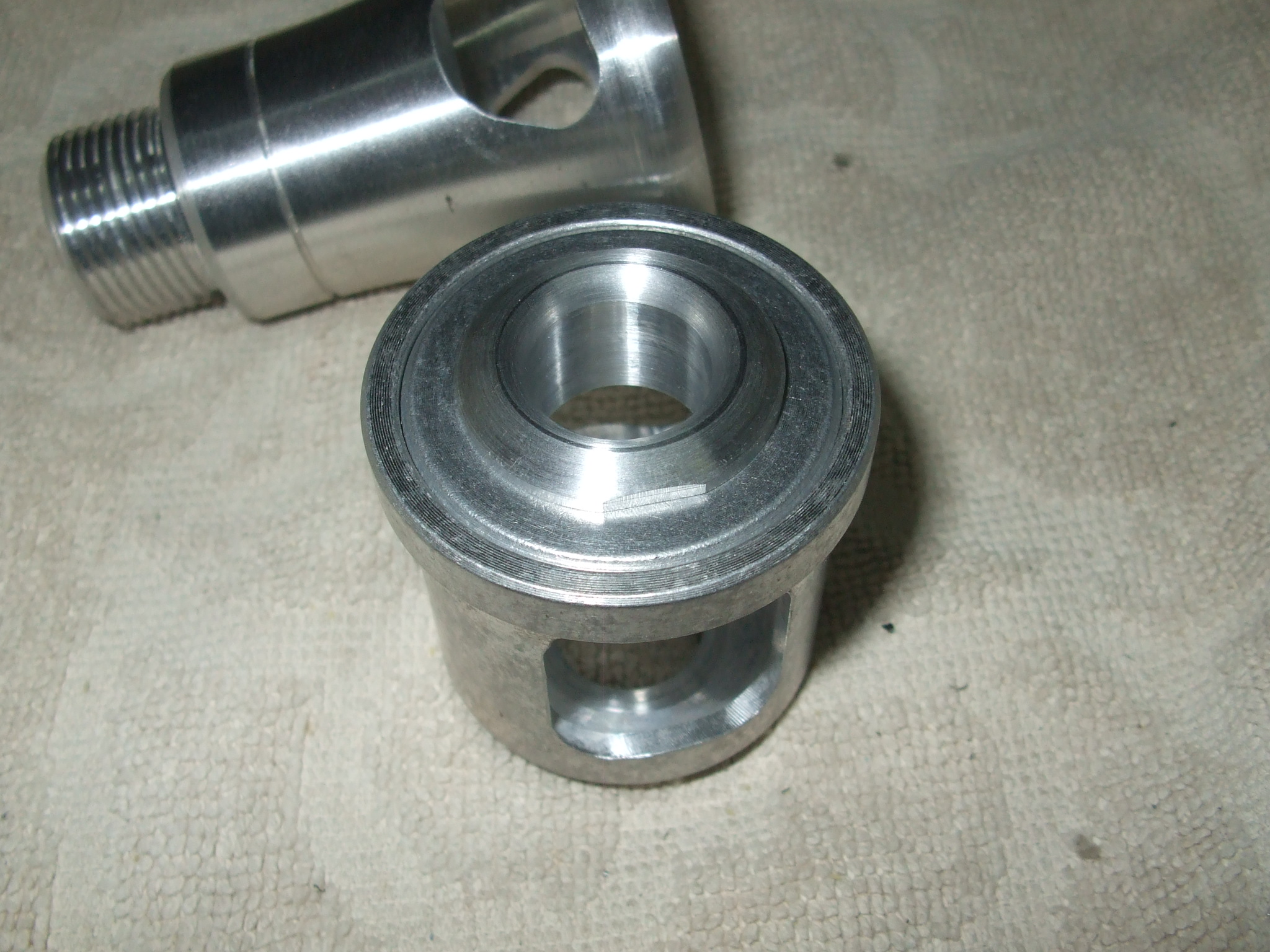

Yesterday started work on the muzzle brake. Added a piece at the back of the central baffle to make it look like the real thing. Finished it today. I thought I would have to make this thing a couple of times but was lucky and got it right on the first attempt.
Also did the two notches at the front of the muzzle brake.

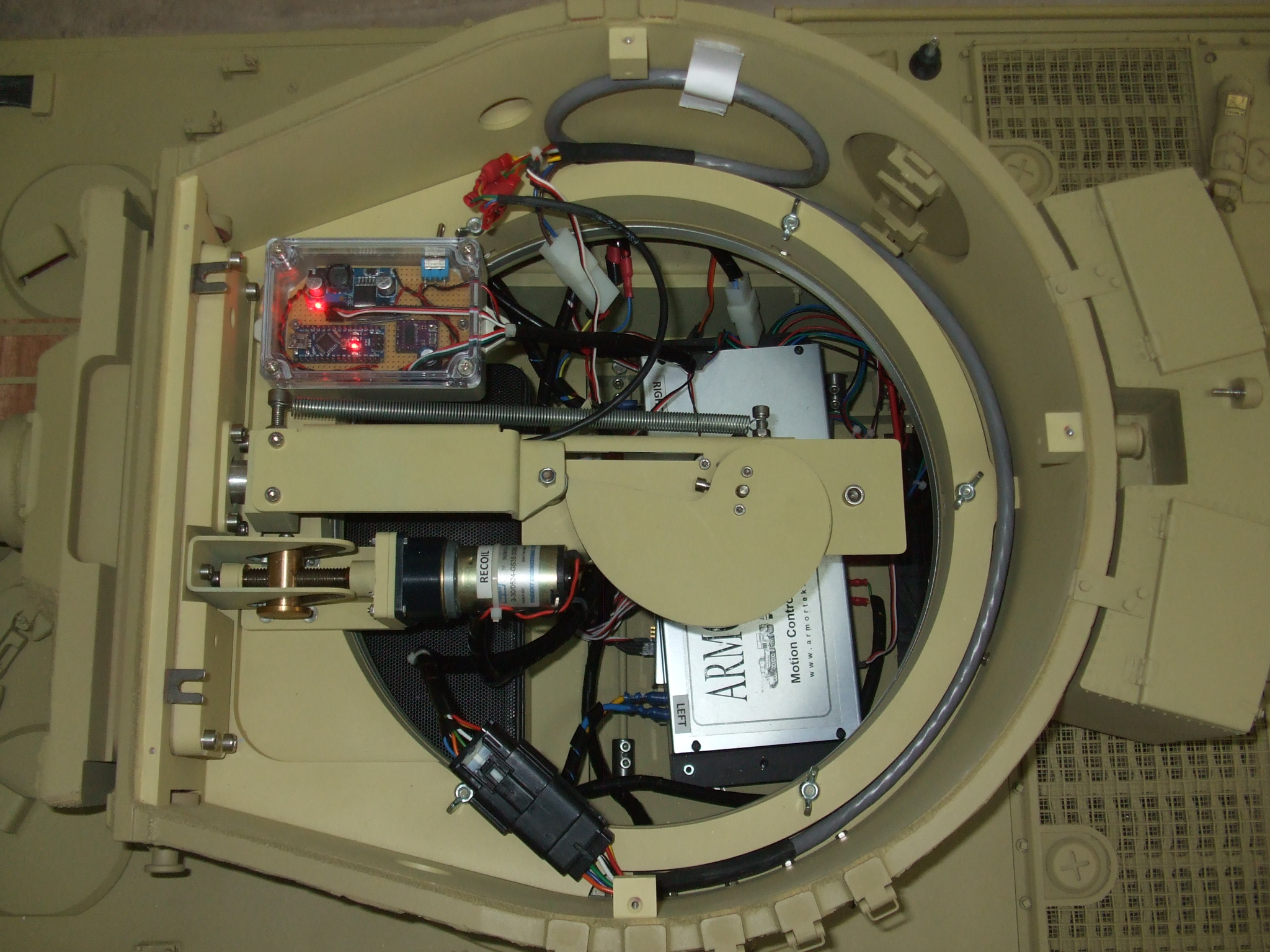

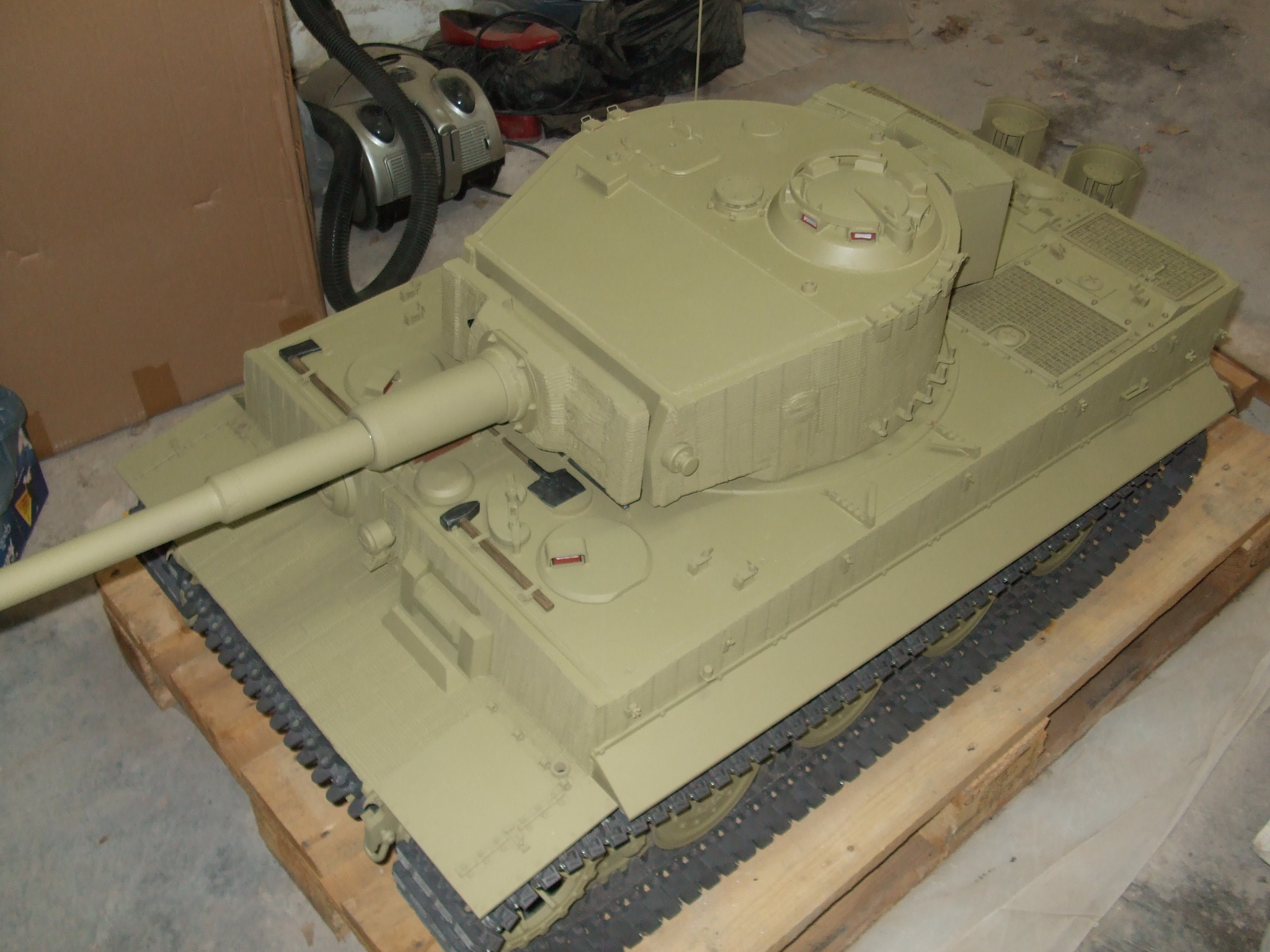

Today, with nothing else to do, I finalised the position of the Arduino recoil box and also the turret wiring sub-loom. Even put the leds in the barrel. Managed to find the turret wing nuts and bolted them on and fitted the roof.
Gave myself a pat on the back. It is really turning out well if you don't mind me saying it.
