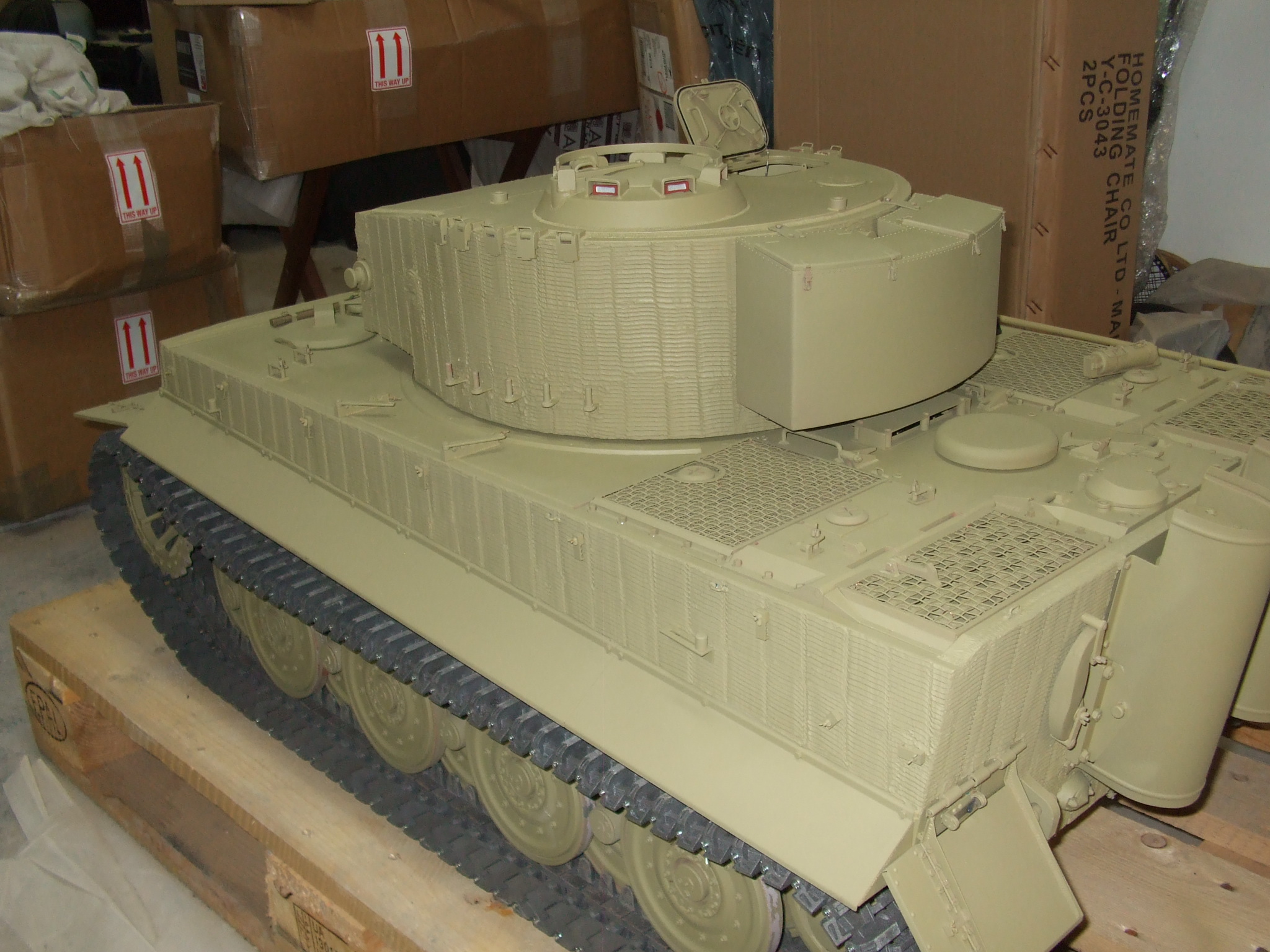

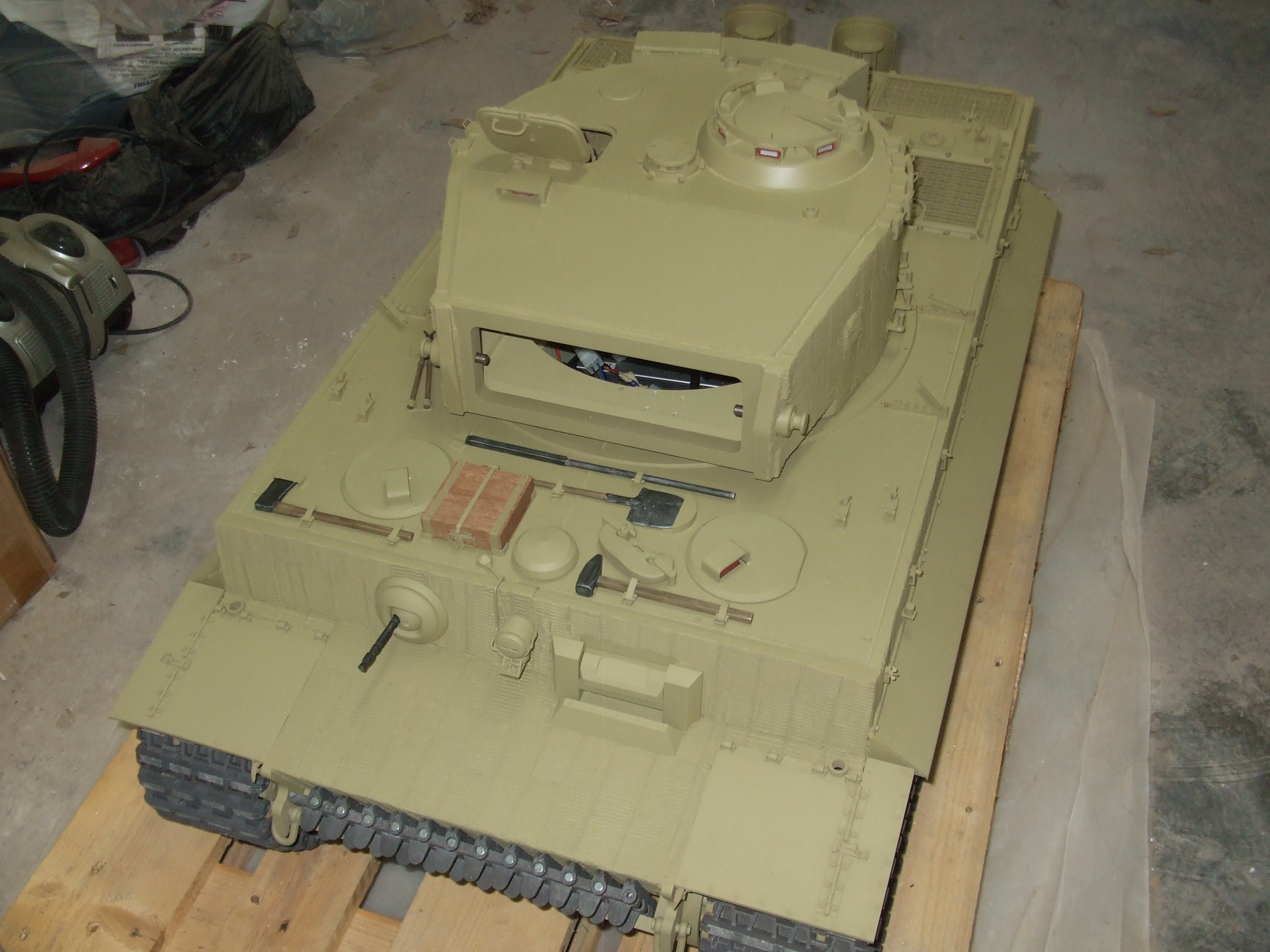

Starting to loose interest in the build. It happens to me every time a project takes a lot of time to finish so I am accustomed to it. What I do is do very short spells (30 - 45 mins) in the workshop.

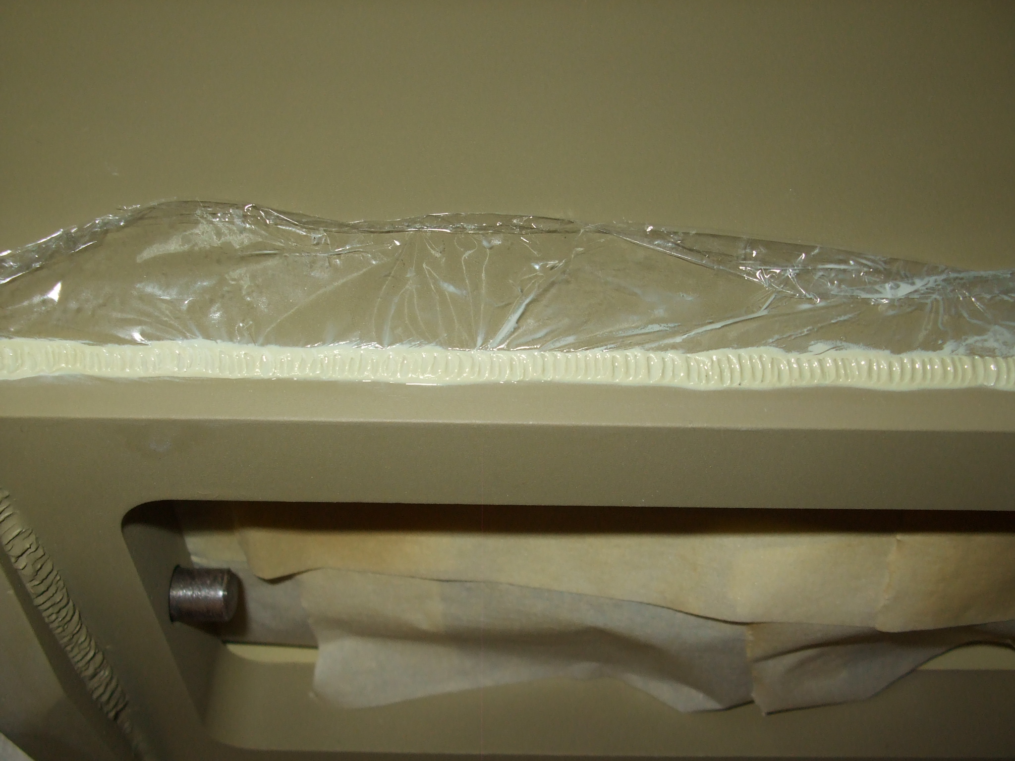

Next thing I need to do is the turret roof weld seams. Did an experiment. Placed some kitchen cling film between the turret roof and turret wrap so that the milliput will not adhere to the turret roof.
Let the milliput set for about an hour and then removed the turret roof and then the cling film.
Seems that the experiment worked. Will slowly do the rest.

Yours is a reference build that inspires a lot of us. Documenting a build is a lot of work per se and doing the work with the attention to detail that you have, well, is still more work. I would like to take the opportunity to thank you for your effort to enrich the knowledge of all of us and a special thanks for documenting the cling film method. Never seen it in pictures before. I am sure going to try that!

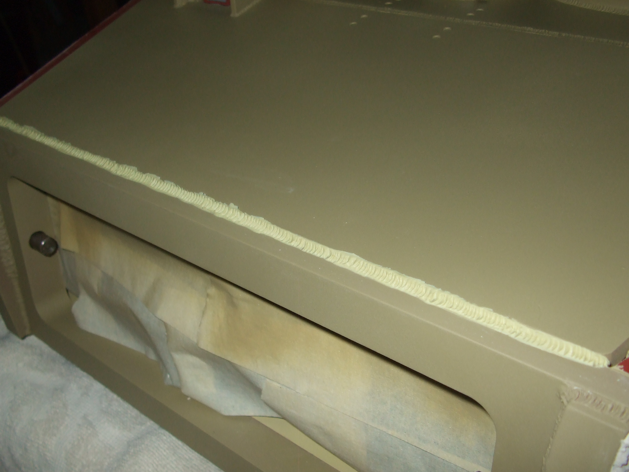

Finished making the turret roof weld seam. The cling film method worked well. How long will the weld seam survive before it gets broken? That's another story.
Now to finish painting the turret with the basecoat.

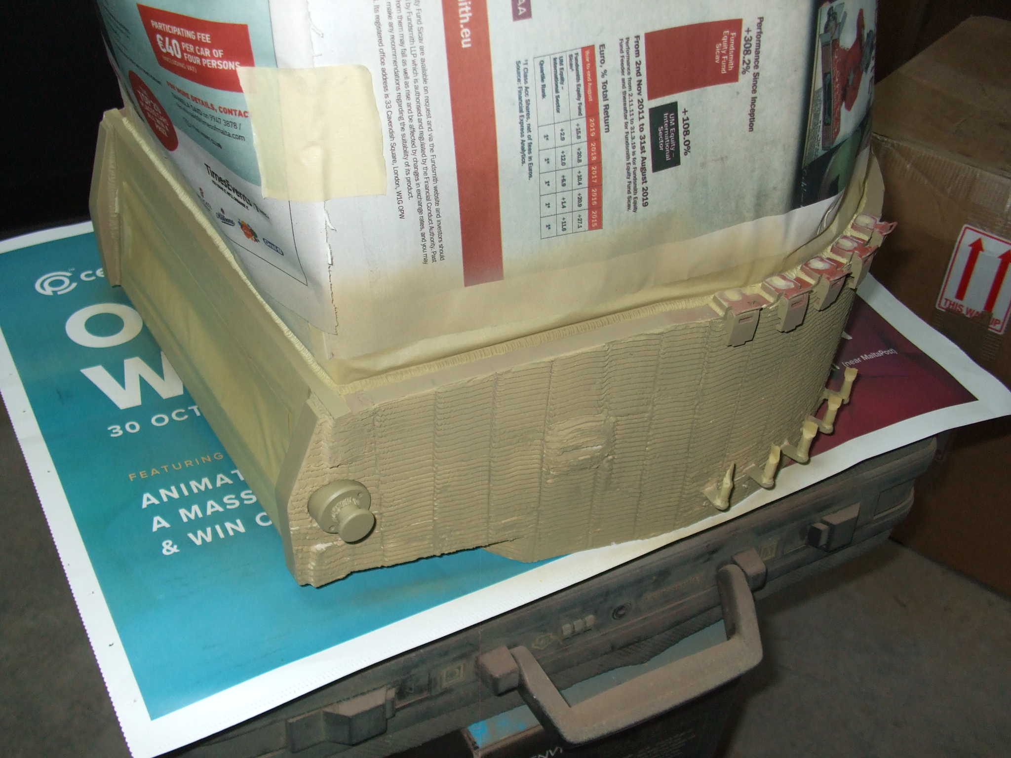

Applied weld seams to the upper track link holders and after some unconventional masking started painting the turret with the basecoat.
I think it will get three coats of paint as the tile adhesive tends to absorb the paint.

Turret wrap finished and turret roof weld seam still in one piece until now. Last thing to check is if the turret roof still fits …..
Still fits. Again thanks to David for giving me the idea of a slip-in turret roof.

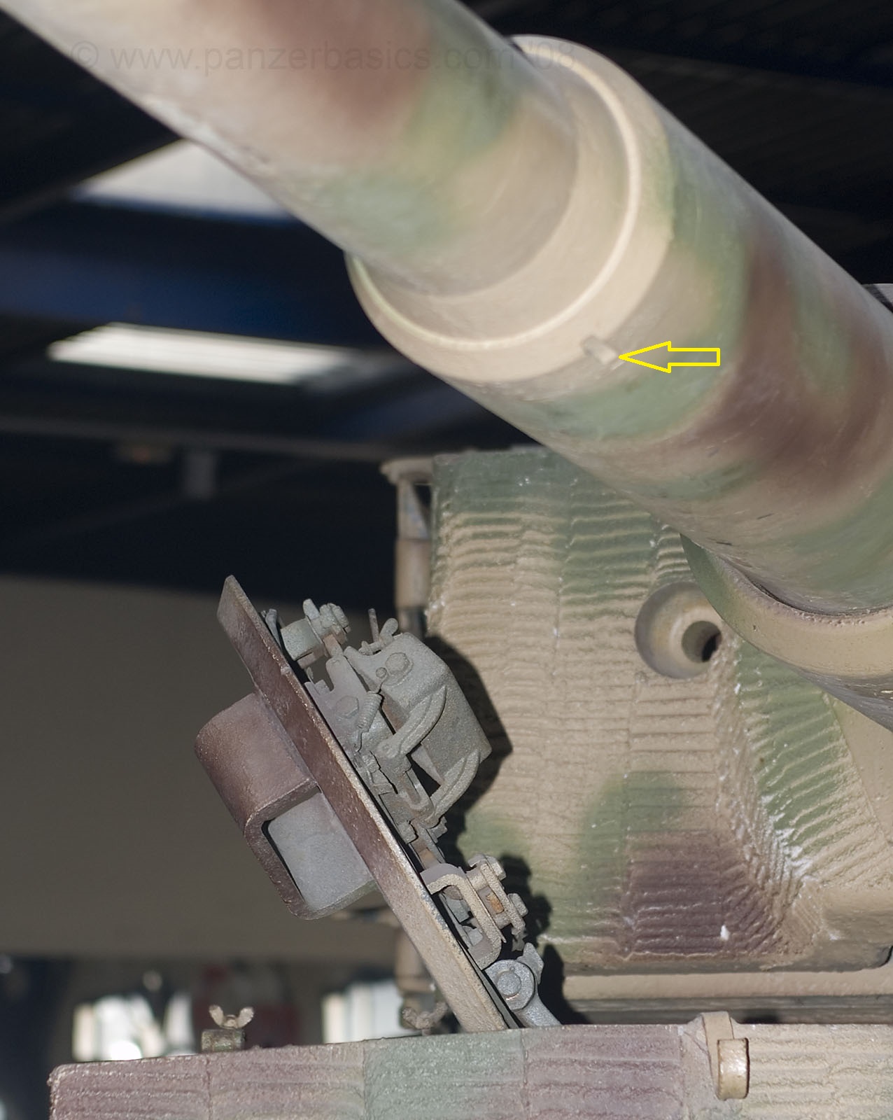

As can be seen from the above photo, half way down the barrel there is what looks like a round locking nut with a cut-out (yellow arrow). I always thought there were three cut-outs for this round lock nut but looking at all the photos I am thinking there are just two of these cut-outs diametrically opposite each other. Can somebody please confirm this.

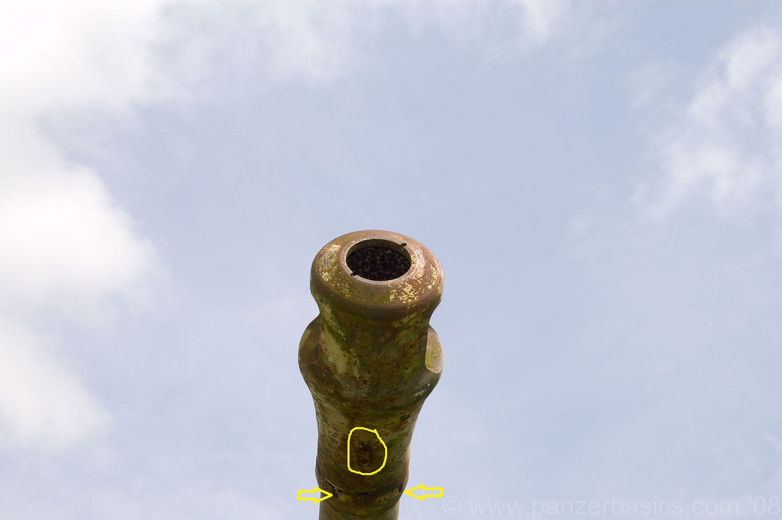

Now for some muzzle brake queries. I know there where two types of muzzle brakes used on the Tiger 1, early and late. The late model was smaller and used on the Tiger 1 late variant and King Tiger. In the above photo, the front of the Vimoutiers muzzle brake has two notches whilst the Saumur Tiger does not have them. I am suspecting that one of these Tigers has an early muzzle brake whilst the other one has the late version. So, should a late muzzle brake have those two notches?
Also, in the above photo, the muzzle brake lock mechanism (yellow circle) is shown at the bottom. Shouldn't this be at the top?
One final question. I'm pretty certain about this one but no harm in getting a confirmation. At the rear of the muzzle brake, there is a round lock nut with some cut-outs (yellow arrows) for a C-spanner. Just to confirm that there are four cut-outs in this lock nut.
