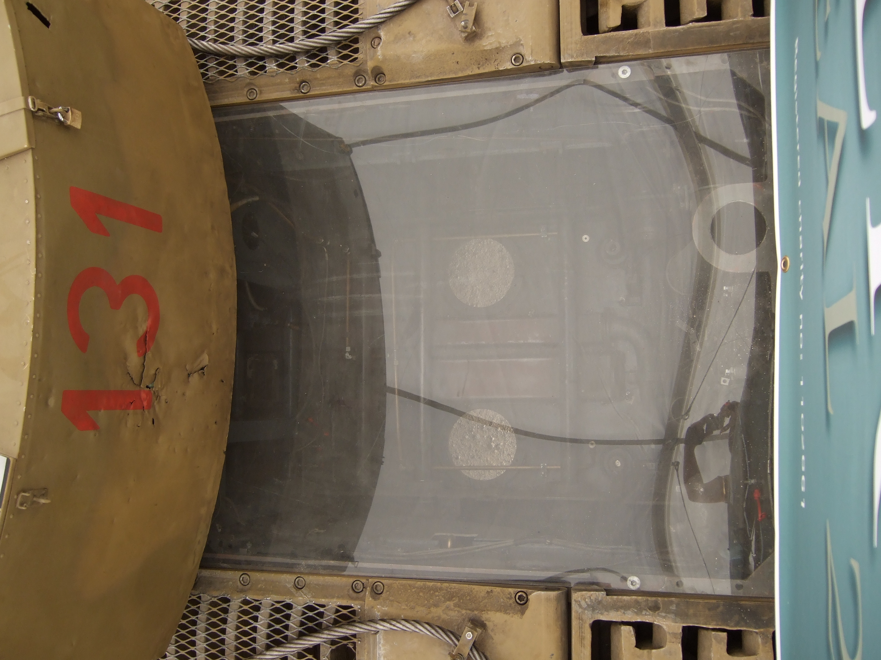

Post after statement. I'm working on that back grill area at this time. 6 of my Square bolts are too SHORT to put a nut on. Why?
My Tiger 1 #131 was made by the last owners, 2015, and I believe that someone had a bad day and missed counterboring the holes in the back, which I believe I'll be doing. After I find a few more pics of the middle back grill area. My DVD of the Saumur Tiger 1 has great pics showing the countersunk bolt holes but I believe that the Saumur Tiger is a late version. Have not found good pics of the Bovington Tiger #131 rear grill area yet. Still looking.

Tiger 131 uses cap heads

Re: Square Head bolt length
A Great photo,as i was working on the slots on the Tiger Hatches today,at least i cut the slots in the correct place
Great pic showing cap heads. Replacement bolts or original equipment? The Saumur Tiger 1 shows Square bolts, that said, it is (I believe) a late Tiger 1, where the Bovington Tiger1 is an Early Tiger 1.

Would you please (if you have it) post a pic of the back panel that the panel above the air cleaner is hinged to. Please
Sadly, when I took these pictures from the gantry, they had removed that panel so that the public could see into the engine bay.
