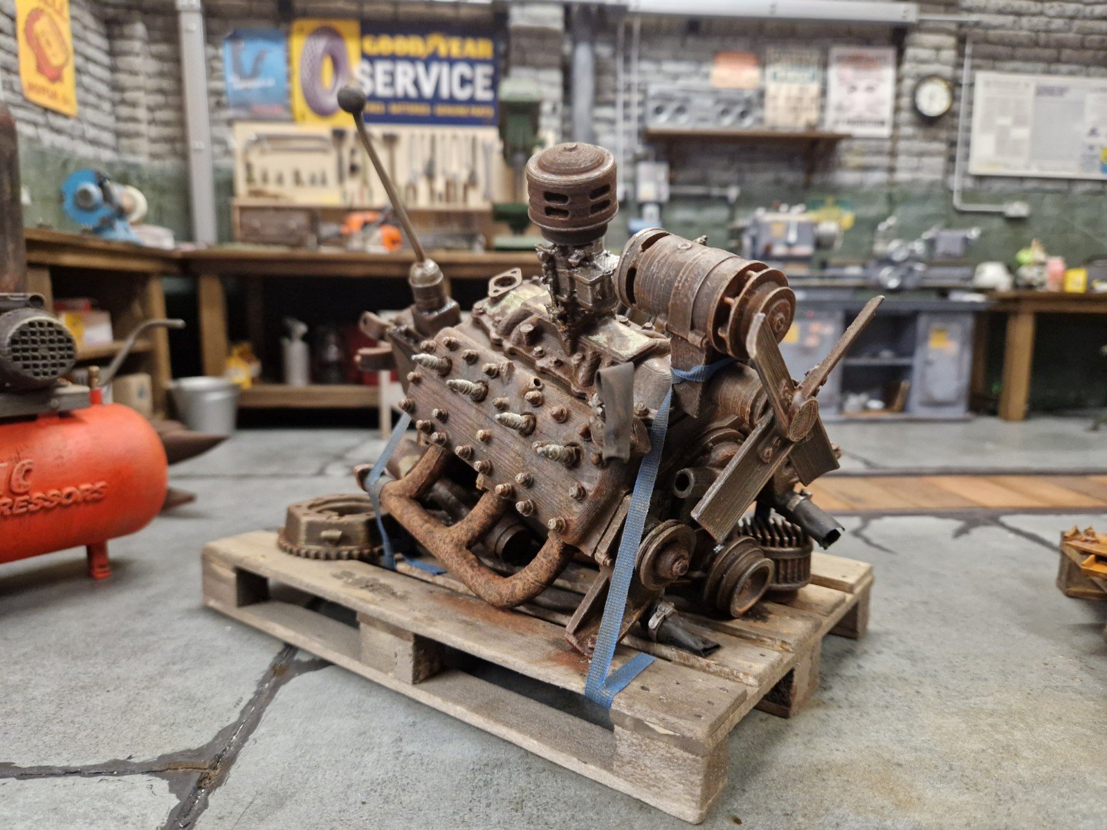

Re: 1/6 scale v8 flathead
Hi Medard,
There are some cheaper options. This was done from a very good set of purchasable .stls on Cults and printed on an Ender 5. I have added a bit more detail as always
As its all printed in separate components you could probably modify quite easily to hide a motor.
www.armorpax.net

Thanks for your reply. I have a snapmaker artisan so it’s an option indeed.
