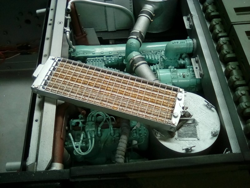

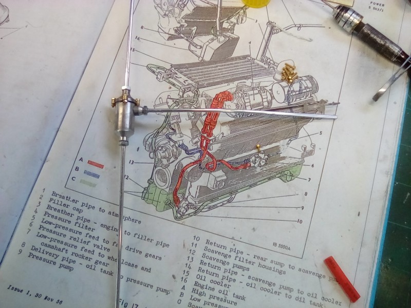

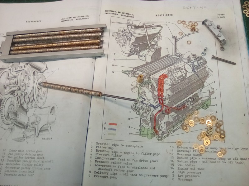

We have decided that the oil cooler fins need more definition, so it will get some.

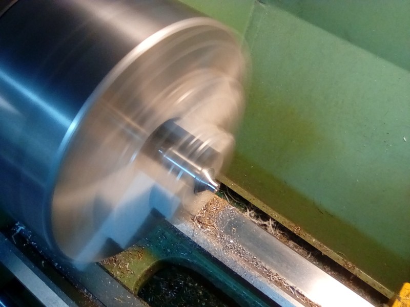

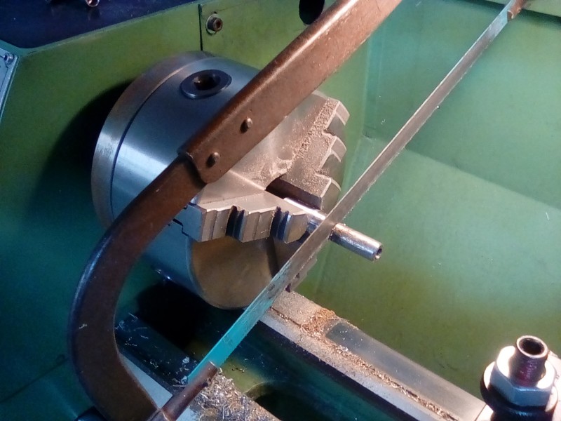

Mr Dawe suggested turning down every other washer to create lowered spacers , and it's working just fine.
I can't safely turn any more than around 20 pieces or the m3 bolt through the middle gives up
Takes a while to load the washers alternately!

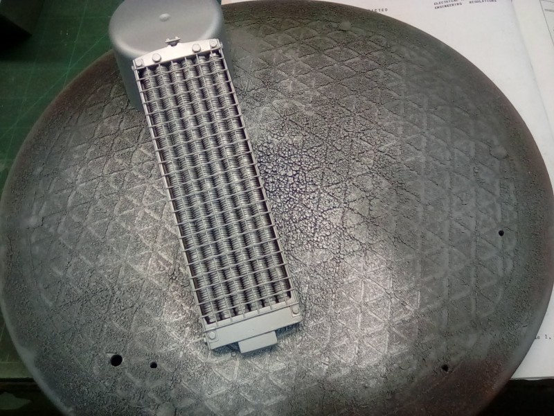

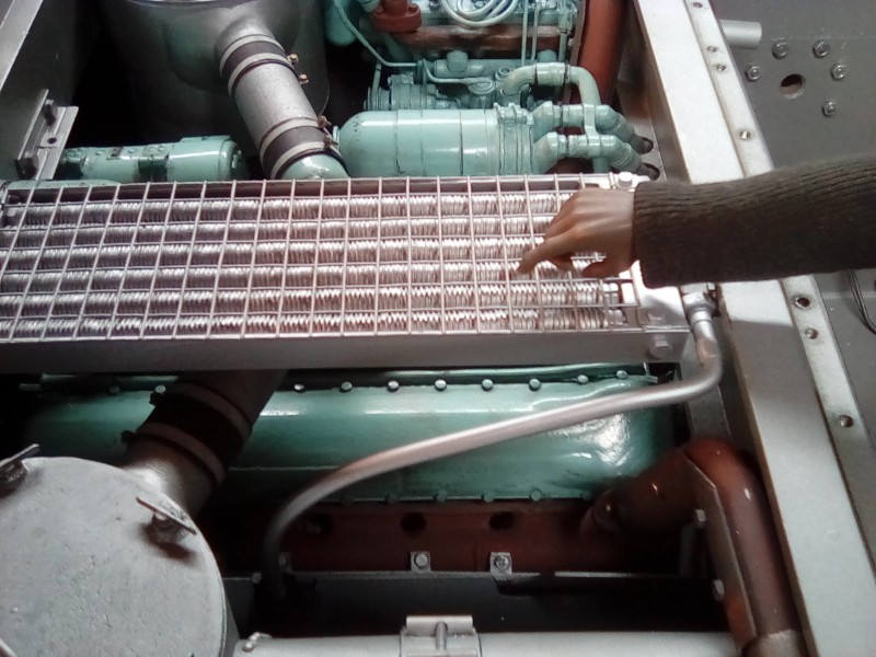

Re: Mr Dawe's Centurion.

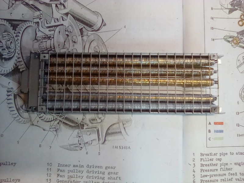

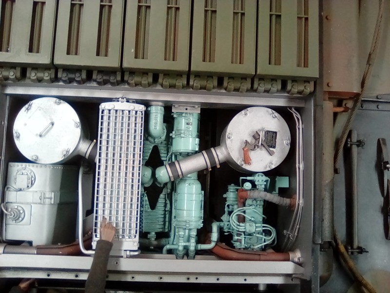

The oil cooler is now all done but for weathering
R (93).jpeg (39.04 KiB) Viewed 18996 times
Nearly done
Nearly done
Sore fingers
Sore fingers
That's a lot better contrast
And now I must start thinking about the gue water pipes

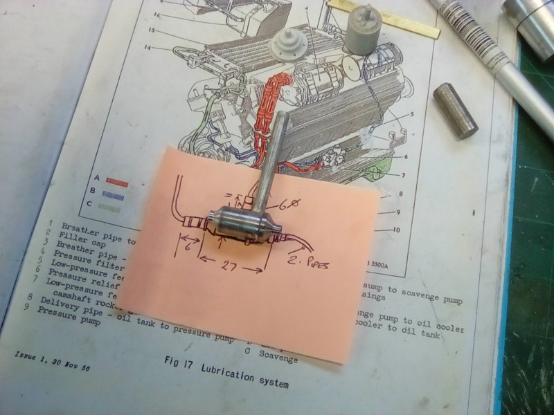

The charging set thermostat is well underway along with the associated pipe work
It's always awkward cutting these profiles on the smaller fittings
Cutting the right angle pipe branch, this takes the water away from the rear of gue engine once the thermostat opens

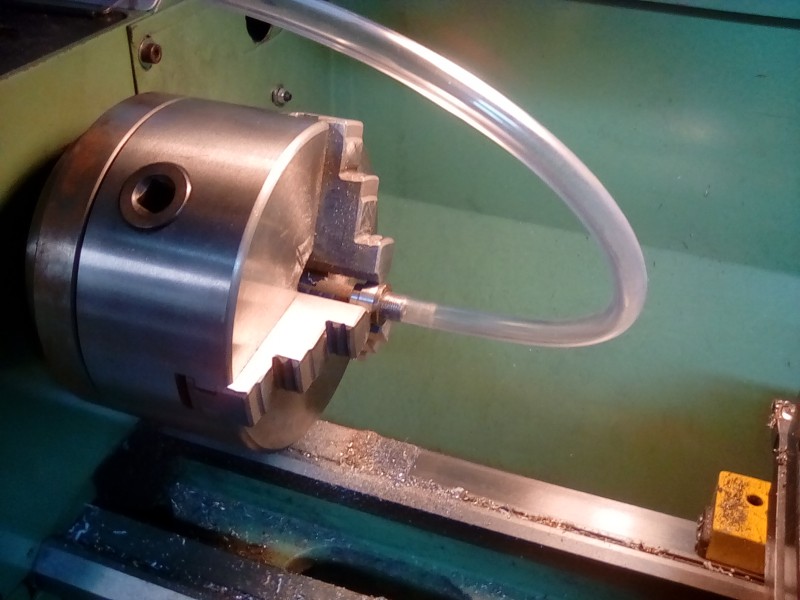

Nice little piece to work on the thermostat

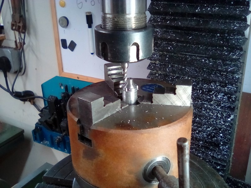

Using the mill and rotary table

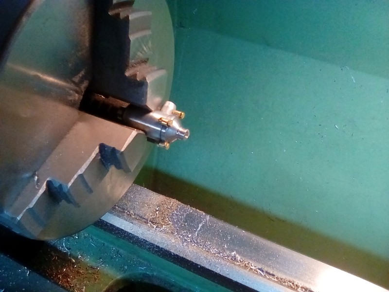

Tiny parts made from brass tubing for the thermostat detailing

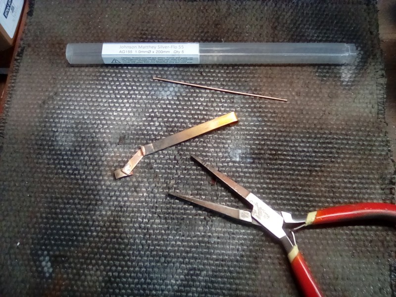

Silver solder for the air filter to thermostat bracket

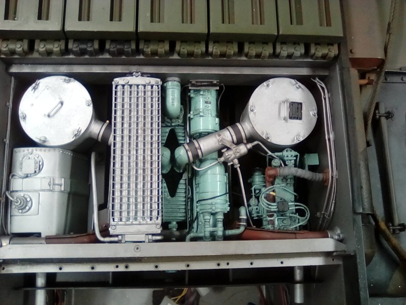

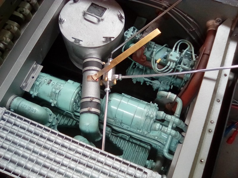

All done except for the weathering, although I have stated in the latter.
The thermostat now bolted in place
Two of the three water pipes bent to shape
Solder wire painted in different shades
The hard to see wiring is made from solder, so it's lead based and stays where you form it
All ali filler rod so it's self supporting
I think it's now busy enough in there

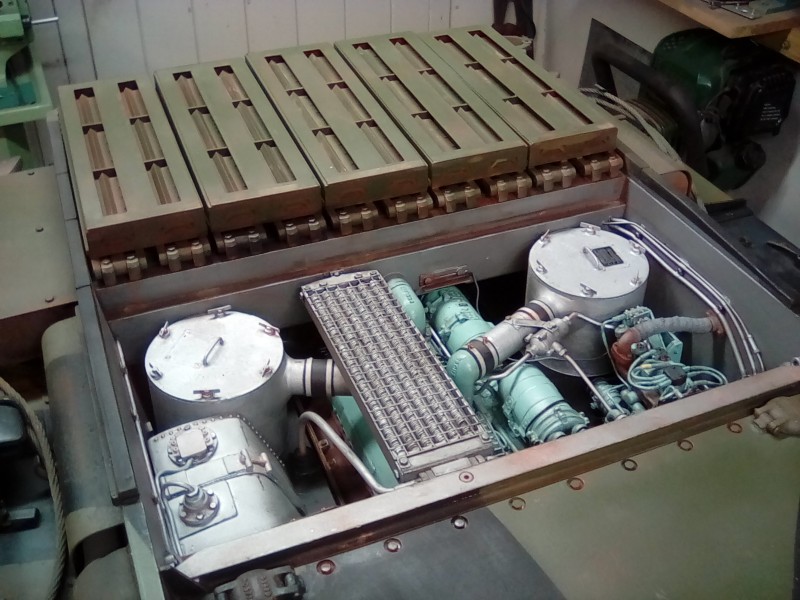

In some ways it's a relief finishing the engine bay, I can now get on with final assembly with all the little jobs that go with that task.
Speakers everywhere, well as many as I can get in, all the high pressure smoker joints are now tight, and they have to be gas tight
Final look see fit, and it does, all the systems working well including the high pressure smoker

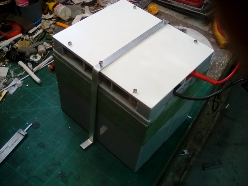

Easy way to make the battery insulated
Nice and neat and insulated
All ready to go in now, the ali battery strap is easy to fabricate and simply bolts to the hull floor

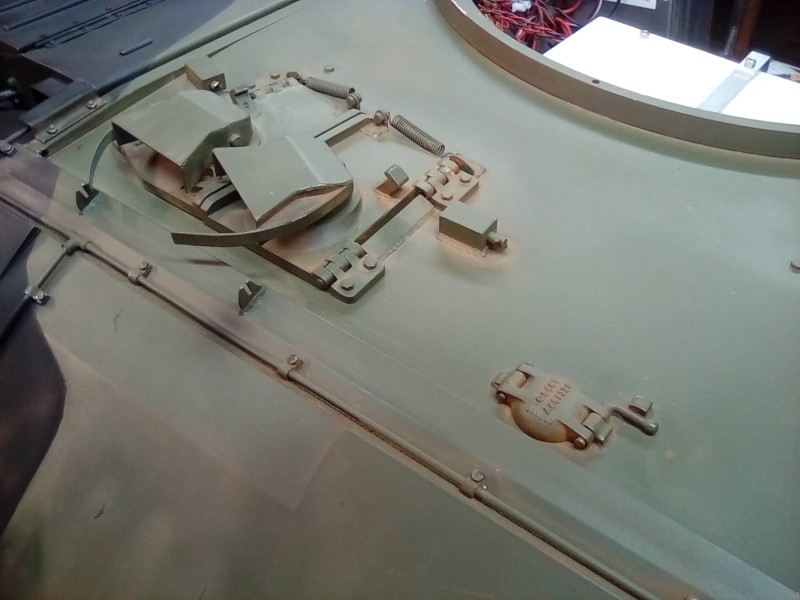

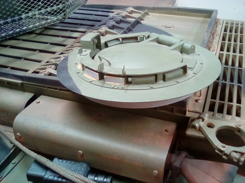

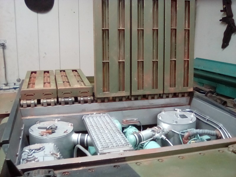

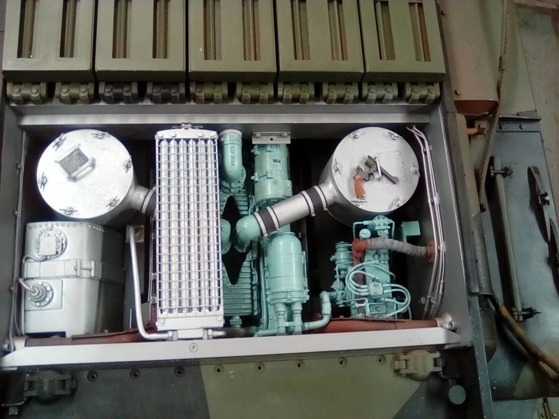

Weathering the engine, engine bay and the louvers top and bottom.

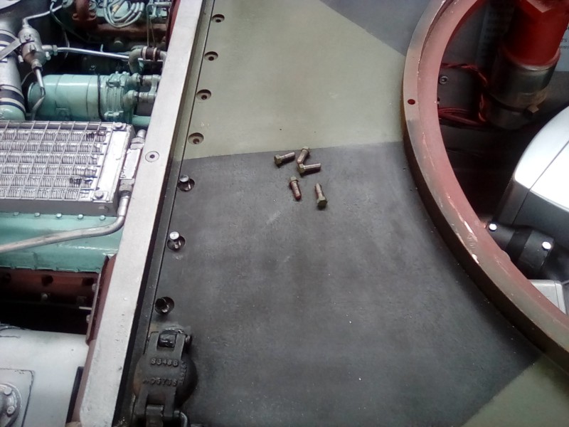

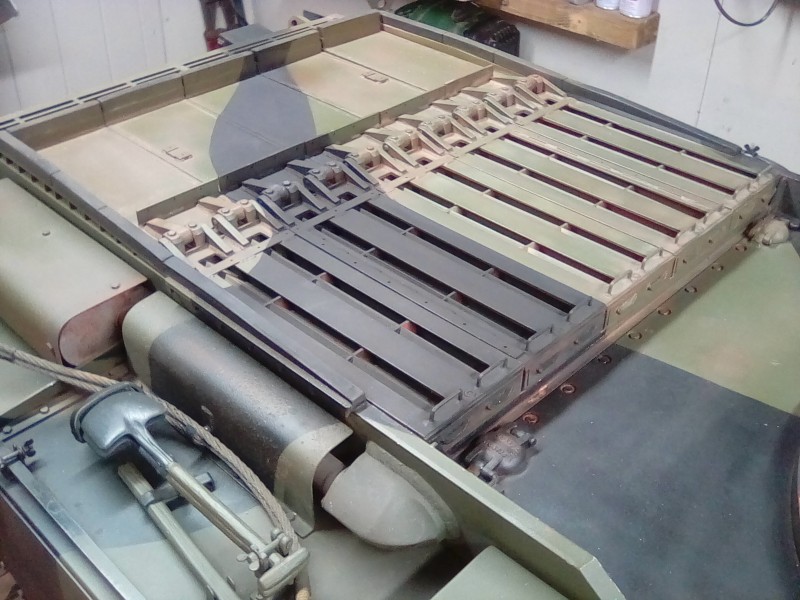

One last bracket for that speaker and the top deck can be bolted in placd
It's a lot easier to paint the new bolt heads before they are fitted

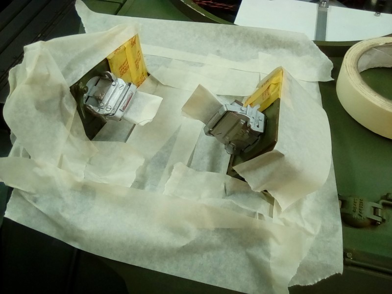

A little tapping required here and there mainly due to paint overspray
There are many steps to the weathering
The engines get their bolt heads lightly washed with couple of different shades of pigment, this simulates the general crud that builds up on an engine over time

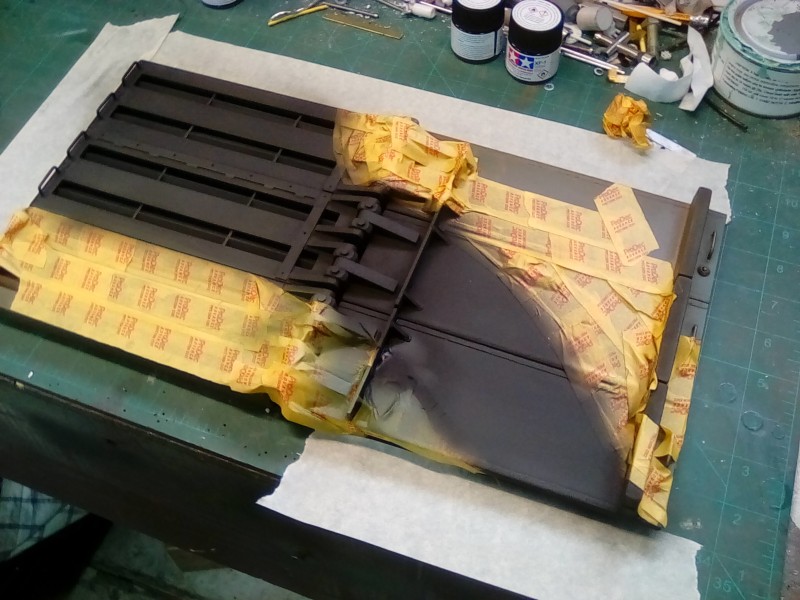

Creating the louvers support area weathering using masking tape
The first few applications of colour and effect now need rubbing back to blend in
Various weathering techniques  slowly build up and I hope it all becomes more convincing
Note the louvers support area weathering
The exhaust joints
Question for the boss, do you like this much internal weathering on the louvers? The engine bay needs lots more subtle crud

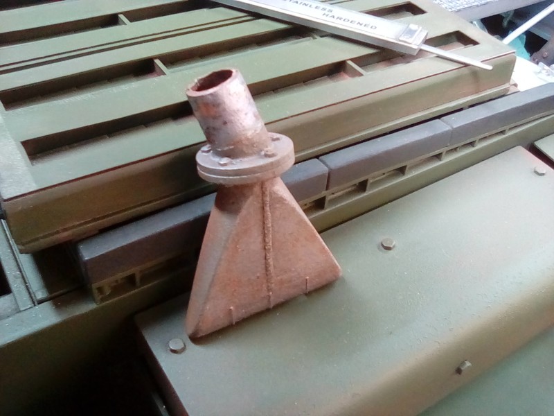

I've been putting this job off for a while
The round section needs to be square section
A fresh weld bead was needed

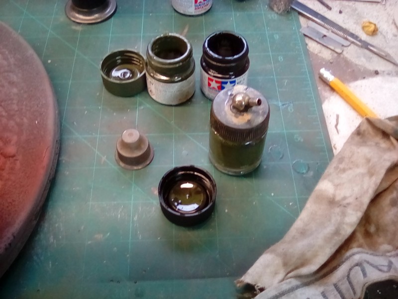

More madness, I sure am going to miss this model. Weathering continued and a few other little jobs

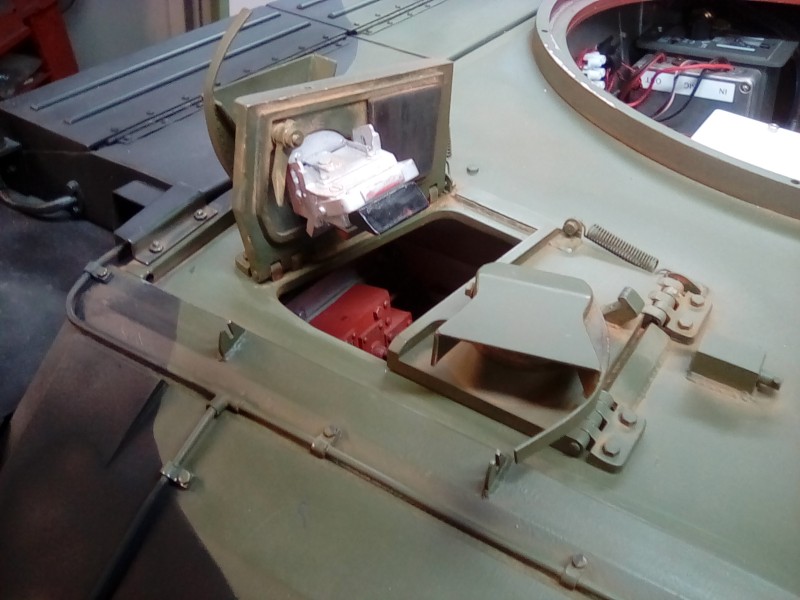

Every seam, every join and every corner needs a wash

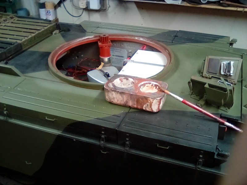

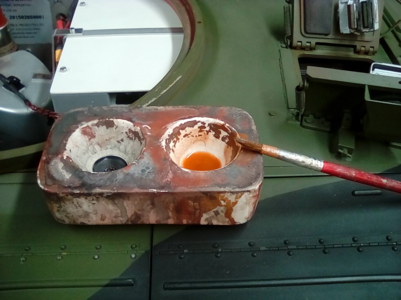

My trusty ceramic paint pot

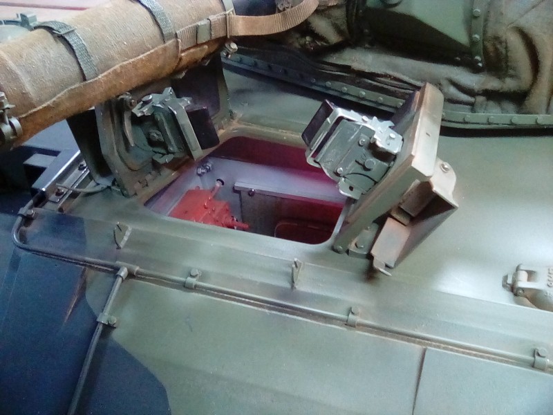

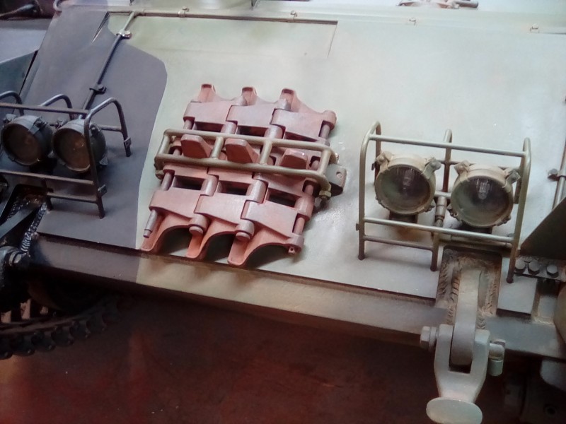

The marks left by the spare track links are useful

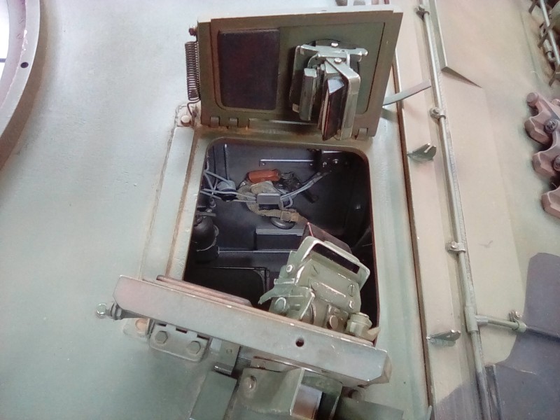

Now these scopes really need to be NATO green

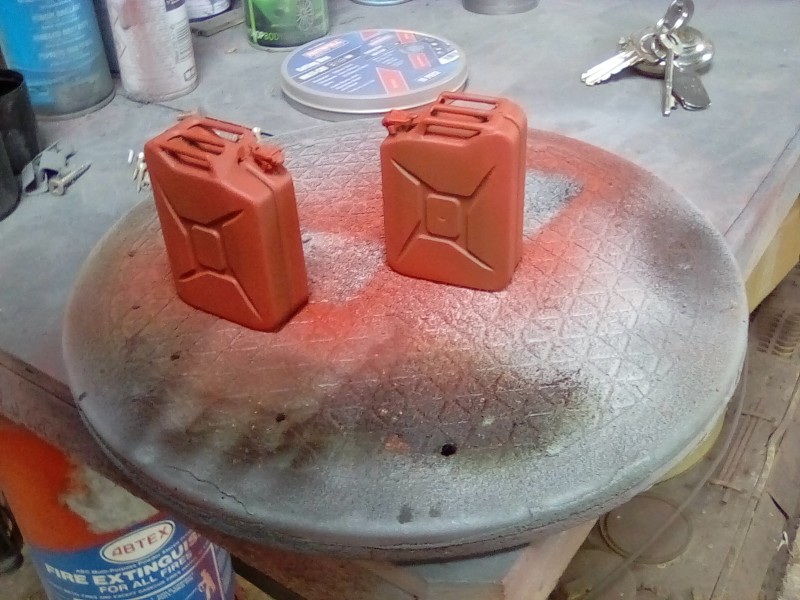

The boss wants at least one of these drums to look like it's just been issued, clear coat added before the decals, then again afterwards

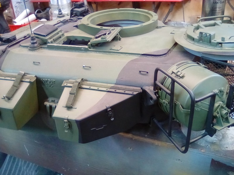

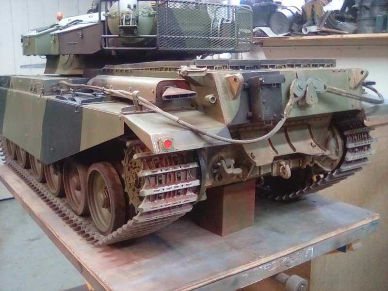

Not many more days now !
All weathered
All weathered
Most of this weathering will be rubbed back, so don't panic

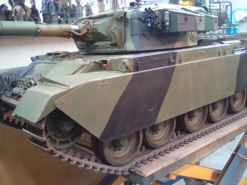

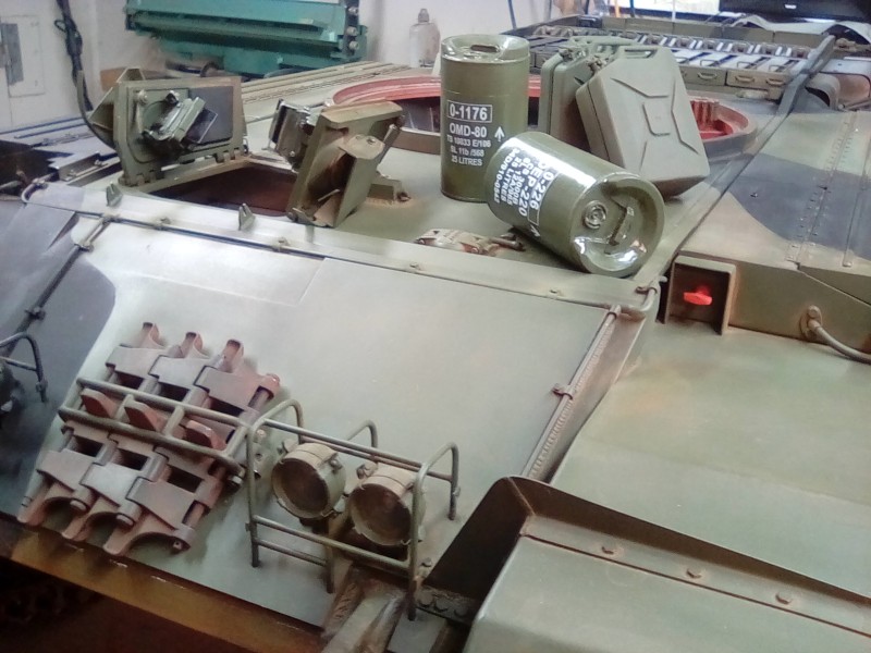

She's been on the this transport box for well over a year now
This is heavy and you must now not lift by the basket

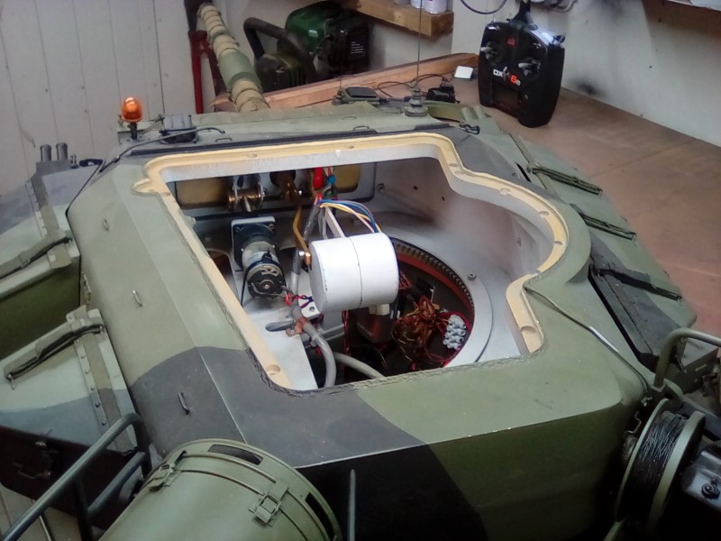

Onto the lifting table now so I can comfortably work in and on the turret
The turret should now be on for good
All good
All good

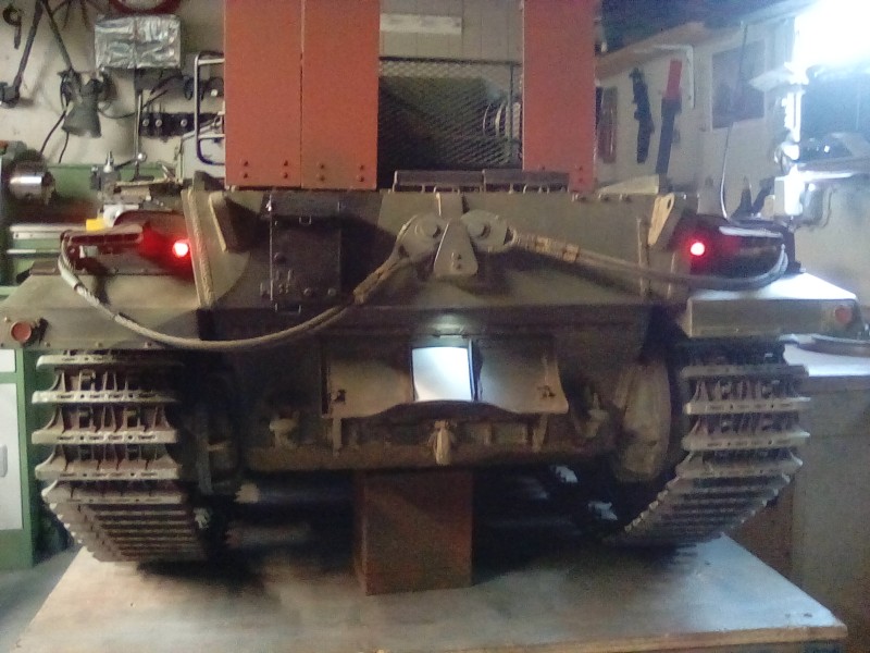

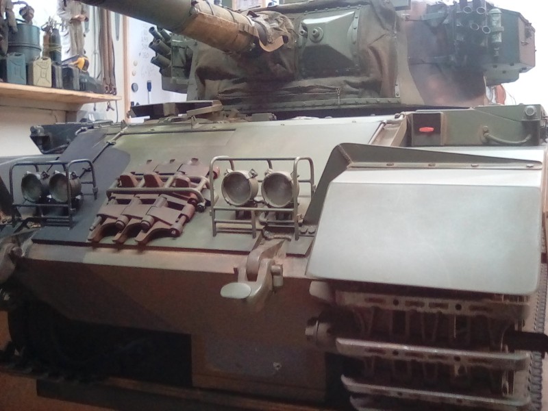

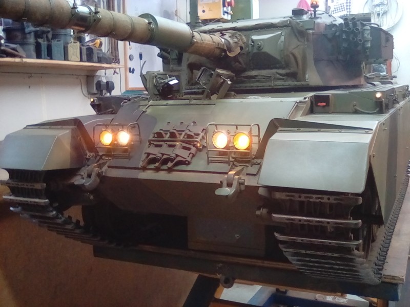

Checking the rear lights along with the convoy lamp
I must finish the stripes on the convoy panel

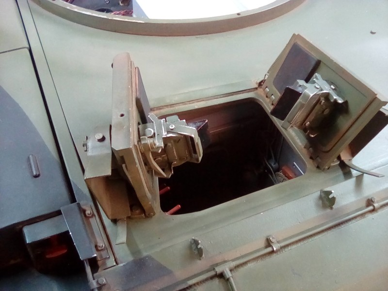

Scopes all done
Scopes all done
The barrel will be bolted slightly under level , the elevation will not be used, I'm happy with that as the drivers scopes would soon be damaged and no doubt the thermal sleeve mounts would catch on the rear deck
Here's a little job , I spend the last 10 mins in the workshop cleaning up the overspray on the commanders scopes, painting the surrounds square will be challenging
Lots more room for kit in there

The omd label sits higher than the other oep label
The convoy panel is fairly simple
The two Jerry cans are slightly different shades to add interest, simply add a little darker colour
Fixing the decals
Fixing the decals
A few more discrete touches to this area, some chipping is also required
