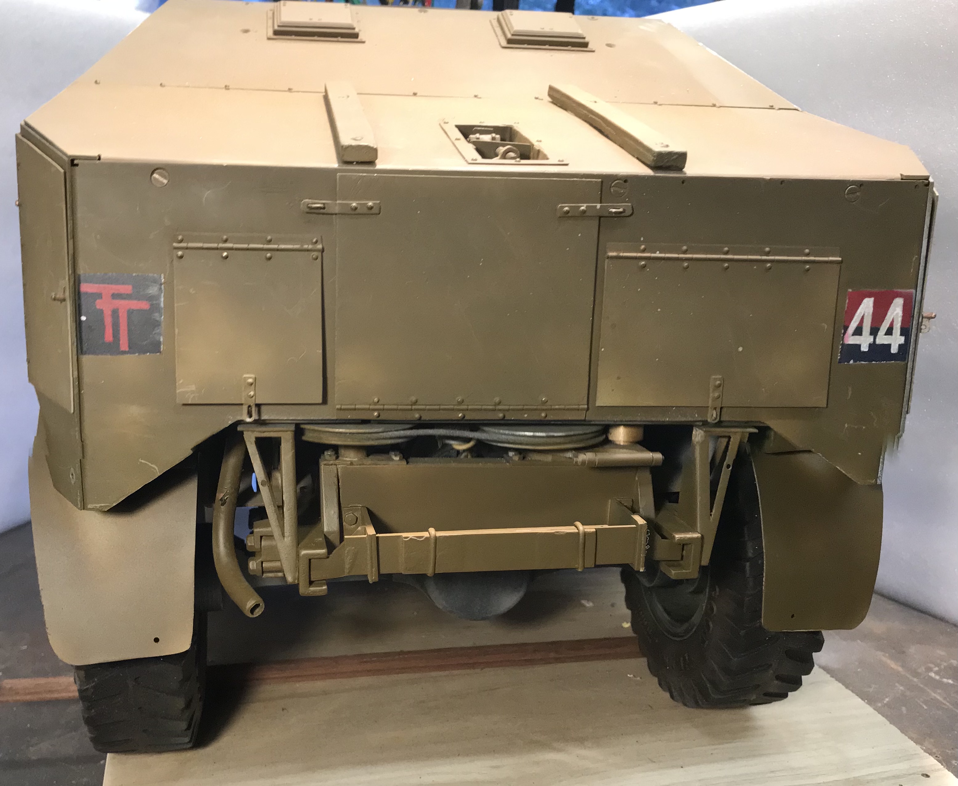

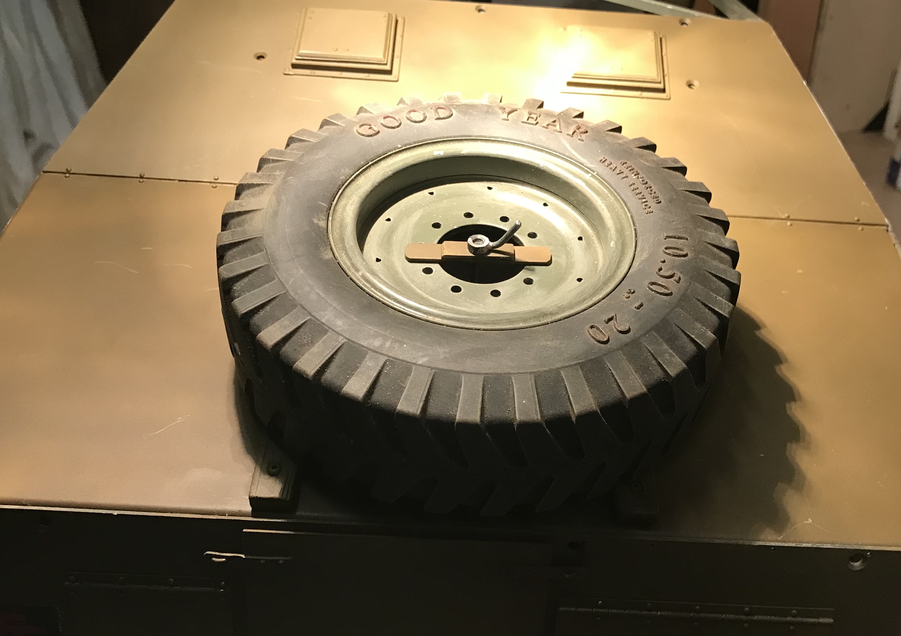

Thanks Phil, now the paint has dried you can see how the spare wheel was held in place

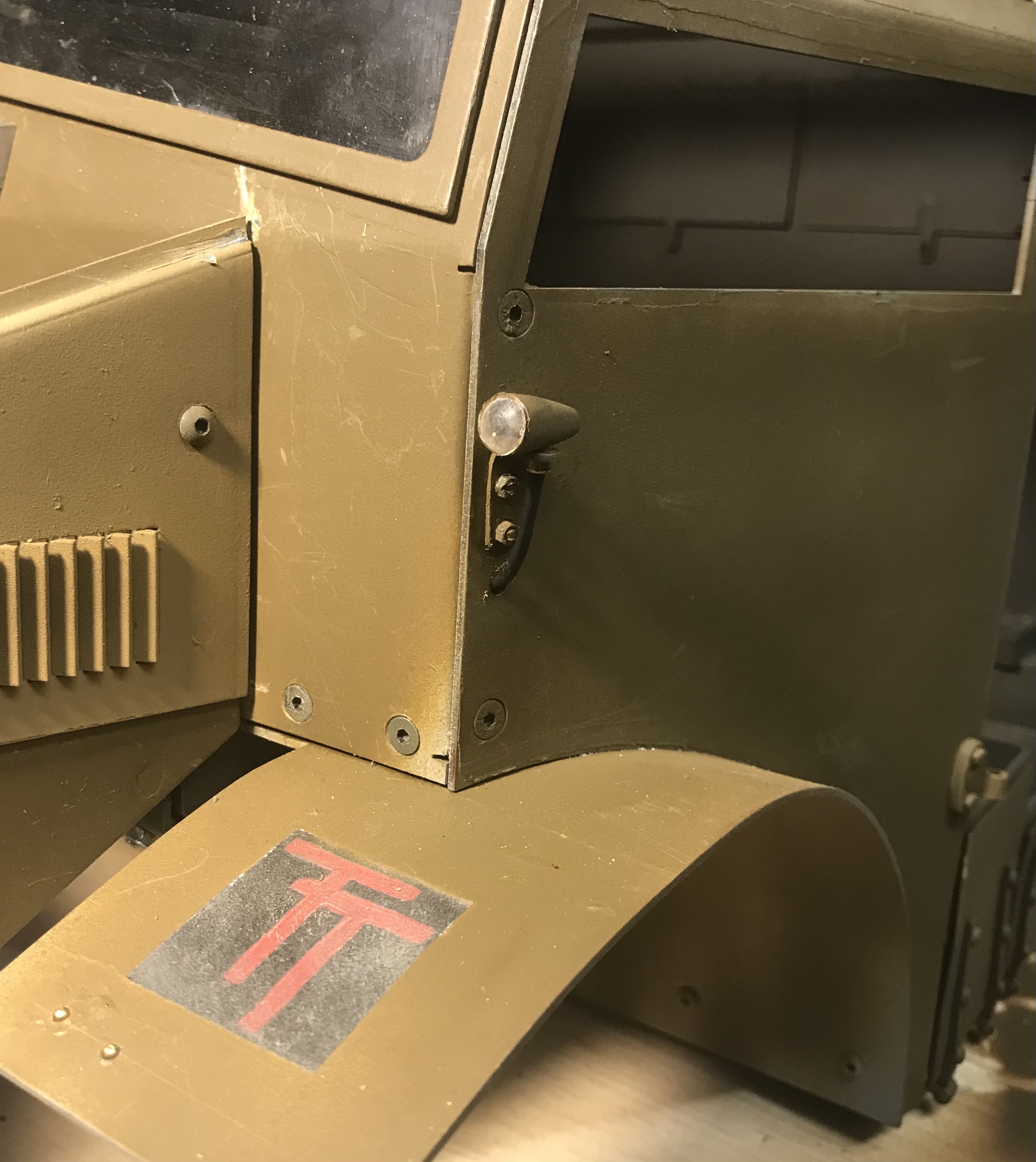

Another month has gone by since I did any work to the quad, so this week I looked for some small details to add before I finish putting it together, made and fitted the side lights, a little over size but was restricted by the size of the bulbs, also made the dashboard lamp, I wanted the bulkhead lamp to work and found is easier to make a new one out of brass,
Regards Jeff

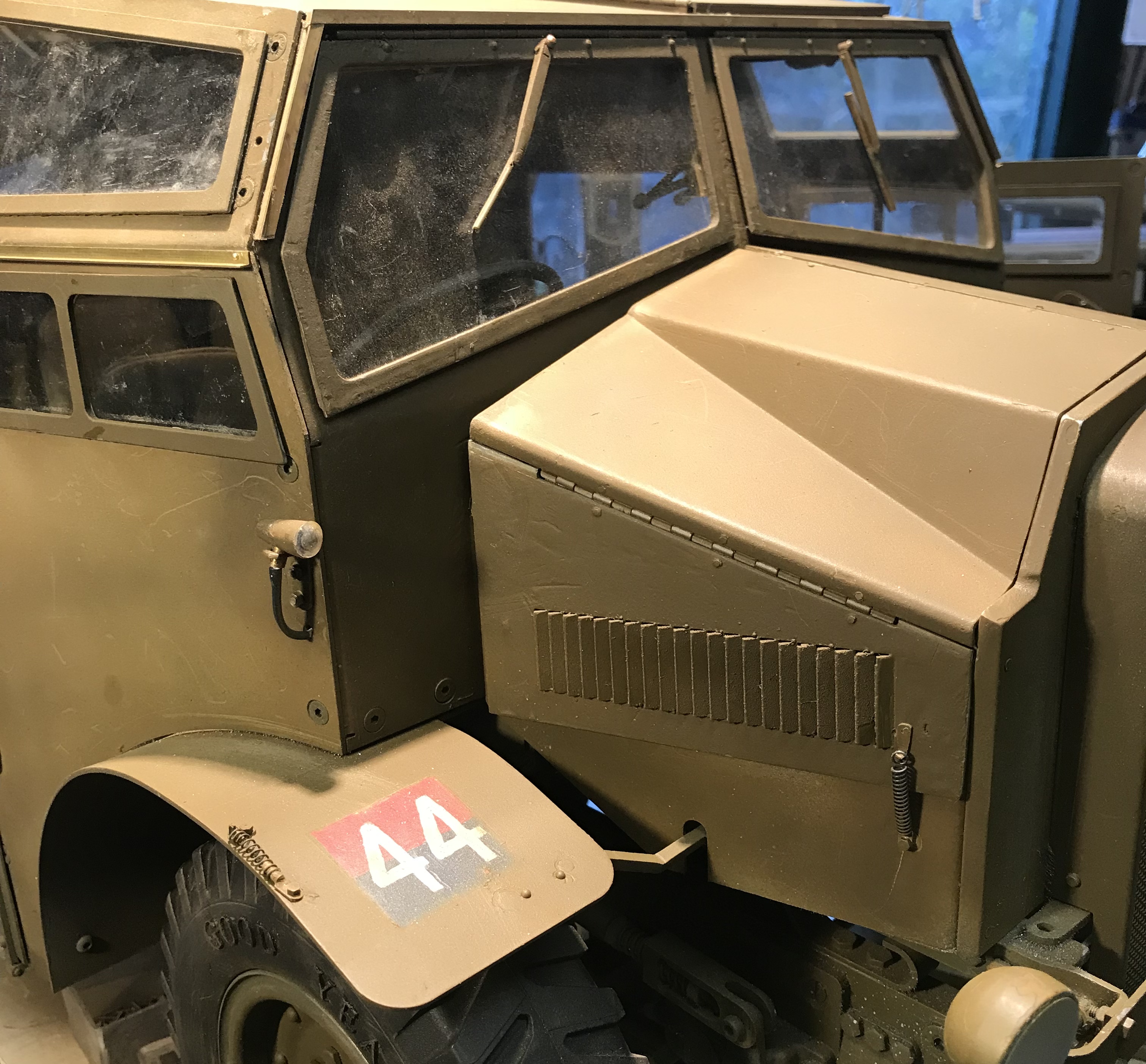

Bit more work on the quad, made a working tow hook, copied William Gardeniers, it’s a good design and easy to do, the lighting uses 12v bulbs and I wanted a separate battery, (3S lipo) fitted in the front on the fire wall and a manual switch on the dashboard, to make charging easy I hinged the bonnet
regards Jeff

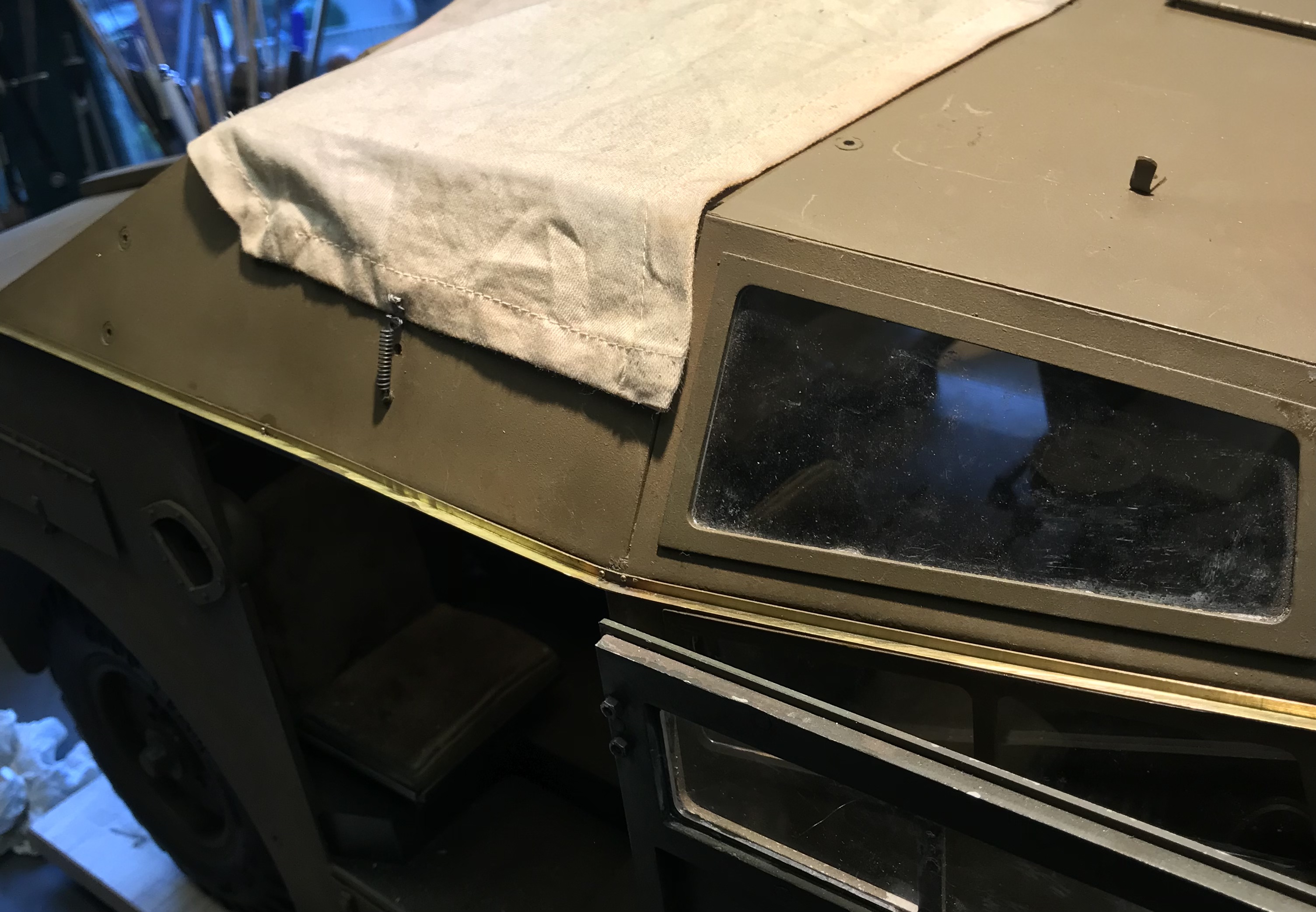

Added the springs and catches for the bonnet, door stays and roof canvas, also made and fitted brass guttering, a bit more trim to add then a tidy up, (windows are filthy) then it should be done, if anyone is interested in the quad, pm me
regards Jeff

Finished the gutters using brass angle riveted on, made the latch plates for the storage bins, and made the rifle racks from steel brass and copper, these will be bolted on, not a fan of glued on white metal, it invariably breaks or drops off
regards Jeff
