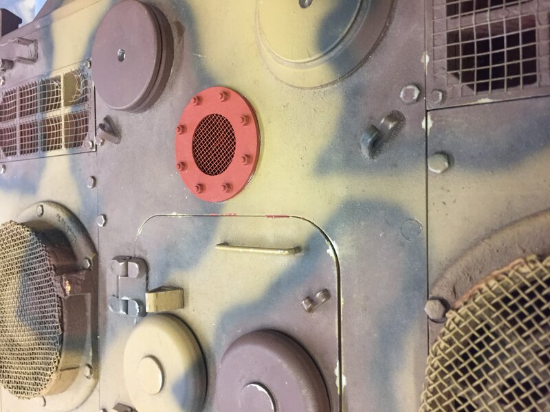

The 4 rectangular radiator grills on the rear deck of the Panther G are open and you can see straight through inside the tank.
This look is improved if you add some mesh but you should still not be able to see the insides of the tank.
It is also an area of concern if you model is outdoors when it is raining as water could get in through these 4 large openings and potentially damage the electrics.
These 4 grills were part of the radiator cooling system for the engine and were boxed in with vanes inside to direct the airflow.
Several Panther builders have replicated this in metal and they look fantastic, but it almost seems a waste to do that amount of work when most of the detail is hidden.

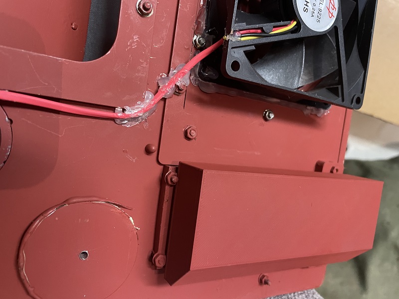

I have been dabbling with various simple ideas recently and think I've now got a pretty good solution which stops rain from getting into the tank and gives a good impression of these radiator ducts.

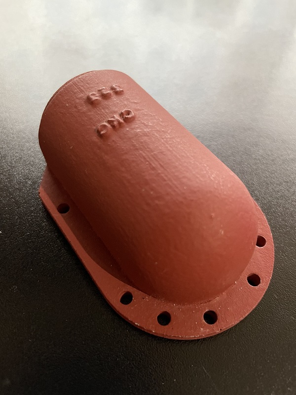

Ive designed the 4 ducts in a CAD program and then 3d printed them. They are a firm push on fit onto the base of the 4 rectangular radiator grills and can be glued in place if required.
Here is a picture to show one of the 3d printed ducts. This is where it fits from the underside. The vertical side of the 2 ducts each side should face inwards towards the circular radiator fan housing. I now need to get replace the hot glue fixing of the rad fans and cables and attach them properly.
This was only intended to be a temporary solution but has now been 3 years!
This is what it looks like with one of the ducts fitted. I have just got to paint the last 2 ducts and then glue them all in place.
I know they are not 100% accurate but they will certainly do the job intended and look a lot better than before.

Have now got all 4 of the radiator ducts fitted to the rear deck and this has really improved the look of the whole engine deck and is another step closer to completing this very long upgrade journey.
The next 2 jobs will be to complete the inner hatch detail for the Drivers and Radio Operator hatches which is now almost done.
I hope to get this done on Sunday and then upload a few more pix of them.
The Cast exhausts will be the next job and this will require a bit more work.

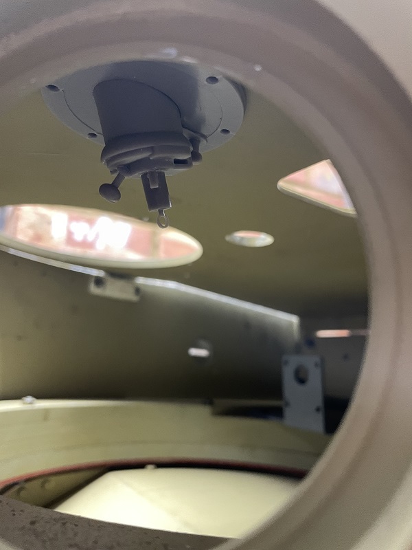

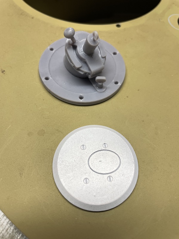

The other part that i am excited about is the close defence weapon (Nahverteidigungswaffe) which was fitted to late Panther ausf.A and Panther ausf.G as well as the late production Tiger 1 from March 44 onwards.
I was aksed if it would be possible to make the interior part of the close defence weapon for a friends Tiger 1 as it is very noticeable when the escape hatch is open. I then thought that if i could make one then it could be fitted to both my Panther and Tiger 1 as well as my friends Tiger.
So, I must have spent a couple of evenings messing about in CAD but eventually got something that I thought looked pretty good. These 2 pix are on my Tiger 1 but you get the idea.
I also drew out a new design for the exterior part of the CDW as the ones fitted to my Panther and Tiger were open and I was wanting a closed one.
I will post more pix when the parts have been fitted to my Panther.

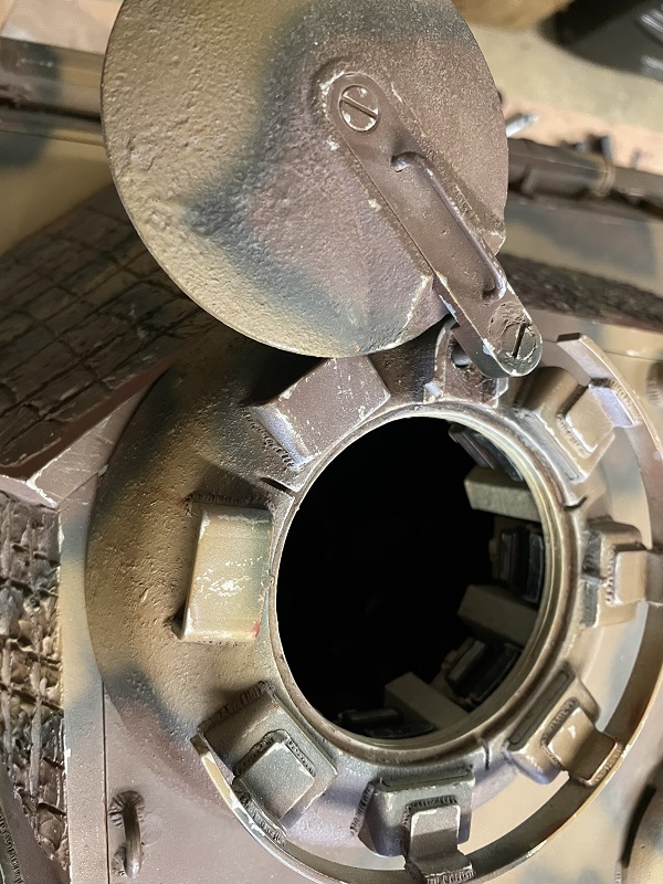

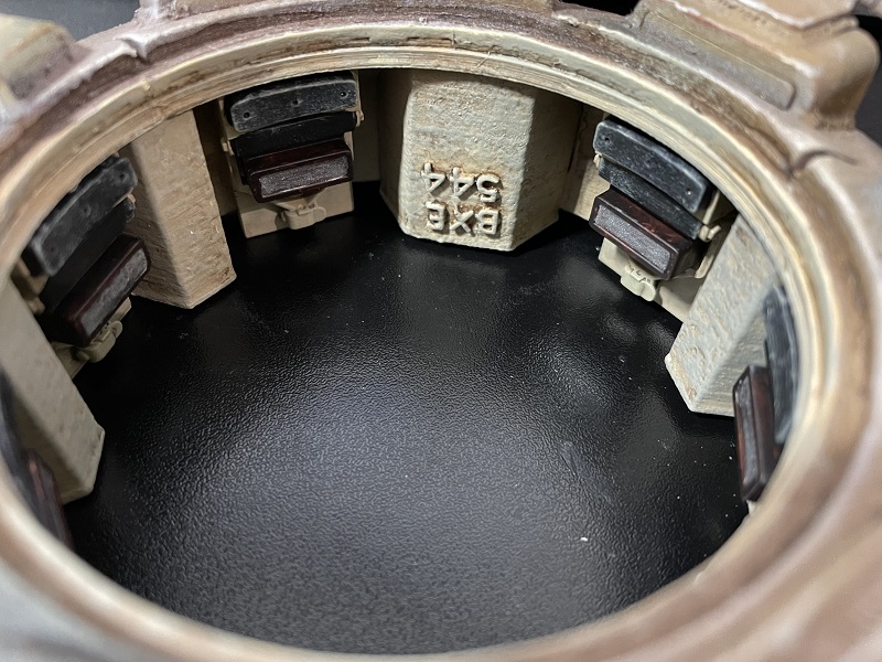

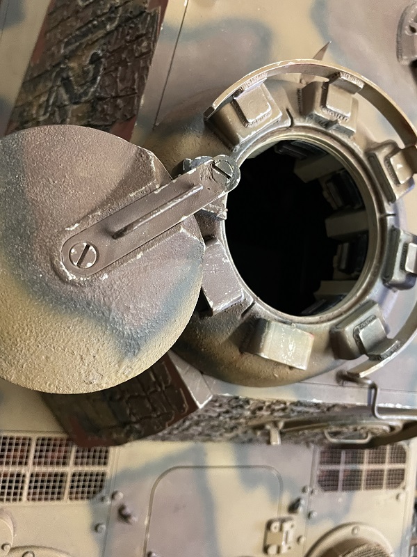

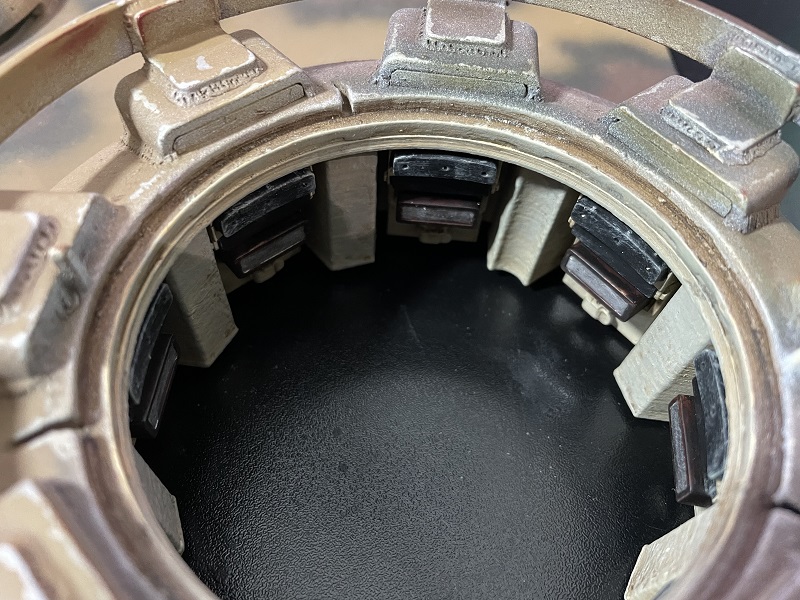

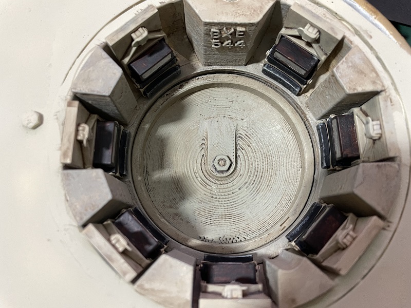

Hi guys, I have completed the cupola interior now and gave it a wash and then a drybrush prior to gluing the periscope panels into place.
I am really please with the way this came out.
Thanks to Mark Lawson for giving me the inspiration to pull my finger out and do this. He also made sure that i used the correct periscope mounting for the Panther G as the ausf.A looked very different. I have now done a design for the ausf.A type as well.
Now, my Panther was already fully assembled so was unable to make a set of accurate persicopes as I would not be able to fis them without breaking the cupola apart which I had no intention of doing. So, I designed the parts so that they would be easy to install and look good when installed. I realise that there are probably more accurate internals available but they would have cost many times what this cost me to produce and probably would not have fitted anyway.
Here are a few pix completed but on the bench.
The last 3 pix are of the outside of the tank with the turret roof replaced.
As you can imagine, this took me quite a bit of time to design the parts and my intention was to just make this for myself but if anyone wants a set printing off for their own Panther ausf.G or ausf.A then please give me a shout.
Just starting the next task which is to design and print off a set of the external faces of the cupola periscopes as all mine are currently empty.

Hi Tim.
Those periscopes look fantastic, well done. They certainly set the cupola off.
Taking orders????
Cheers Charles
Taking orders????
Cheers Charles

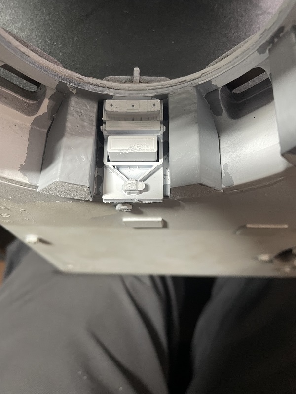

Have just fitted and painted the external part of the 7 periscopes into the cupola so i think i can call this bit now complete.
This must have been one of the quickest and simplest pieces to make and unlike most parts that i make fitted first time and did the job.
Normally i end up tweaking and adjusting parts to get them to fit or look the way i want.
I printed them in resin on my 3d printer and then primed in halfords grey primer. I then painted the body using a really good Games Workshop Contrast paint called Gore-Grunta Fur. All of their paints have odd names but I have found that using this over a light grey or beige undercoat gives a pretty good representaion of brown bakelite as used for the periscope bodies. These paints are very easy to use and 1 generous coat is all that is needed.

I painted the lens with a Tamiya Chrome Silver, then sealed with a gloss varnish.
Then I used some thinned Tamiya X23 Clear Blue to make a blue tint and then another coat of gloss varnish to seal and give a nice shine.
Overall, i am very happy with the transformation of the cupola which i think turned out better than i hoped. Originally, i was planning to have a very basic interior because that is all i thought i would be able to achieve - guess i was wrong.
Unfortunately, you cant really see the effect now that they have been installed. I might have to paint another to show as an example.

Cheers Bob, the outside parts were really simple to design and fit but really finish it off.
I was sick of seeing 7 holes up there in the cupola every time i looked at it.
TBH, a task like this would never have been achievable for me without a 3d printer.
