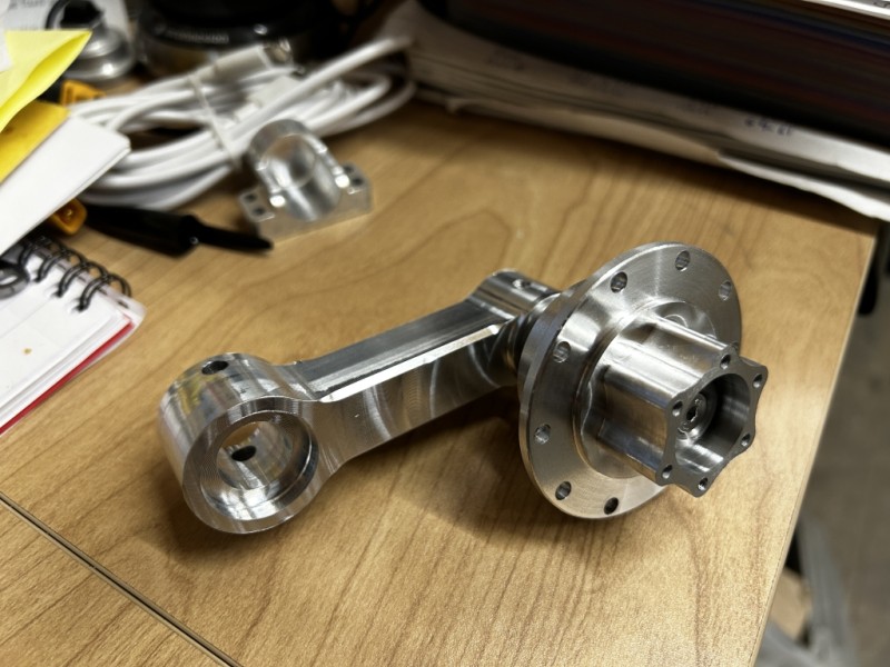

Today the first part rolled off a 5 Axis Machining Centre - the first position Bump Stop that sits above the first roadwheel.
The image quality is not great because the aluminium is far too reflective - we will get some better images once the part have been through de-burring - although that will not be for a while as we focus on getting the Panther G parts packed up and out the way

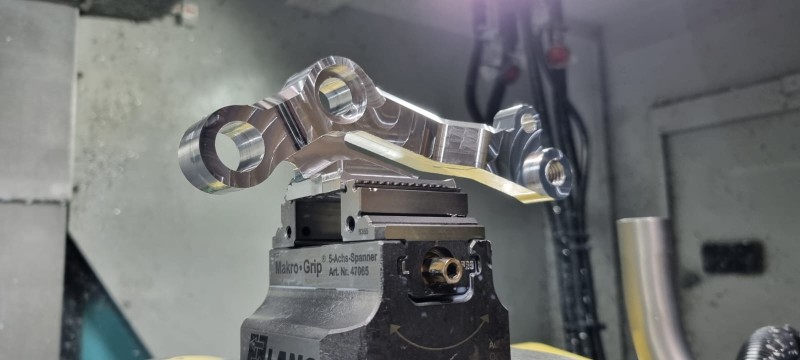

Manufacturing images of the Idler Arm on the M26 Pershing
This really shows the power of a 5 Axis machine - all 6 sides of the billet can be machined at once, leaving just a thin aluminium web that can be snapped off to leave an (almost) finished part.

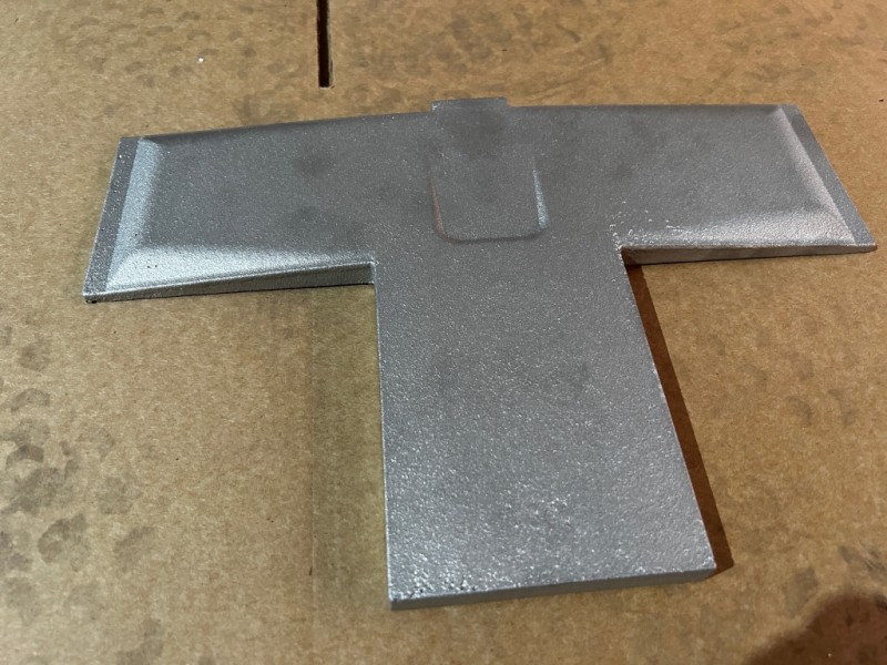

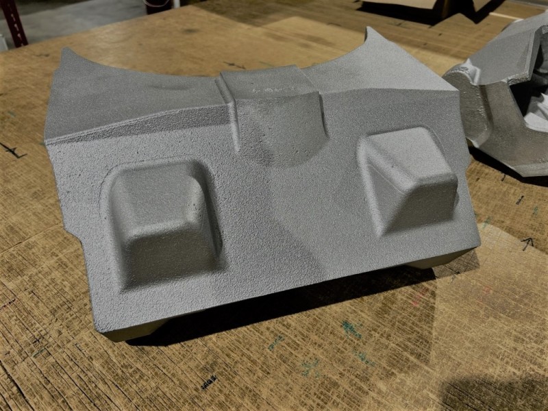

Yesterday our sample castings arrived. 3 parts - the front armour, the engine deck "T" piece and the mantlet. We will still need to wait 2-3 weeks for the turret casting.
Two of the parts are spot on and we are very happy with them. We will get the machining jigs and CNC program for the T piece done later this week - the others will need to wait until some mating parts are ready.
One of the parts has a very obvious error - let's see if you can work it out. The answer will be at the bottom of this post.
Unfortunately, the error means that the moulds need to be re-done. The supplier is checking if the moulds can be fixed or whether new moulds would be easier. Either way, it will be at least a couple of weeks delay.
The casting that has the issue is the front armour casting - for some reason the casters though the tank needed two machine gun placements!
Nonetheless, we can use this part to prove out our jig and the machining program. Will probably machine off the second machine gun position and fill it with car filler for our prototype build. At least that way we do not hold up the production process.

I was wondering what the big 'blister' in front of the driver's position is. On the right is the MG position but there shouldn't be a blister on the left... it kind'a looks like it might need a big 'bra'..
