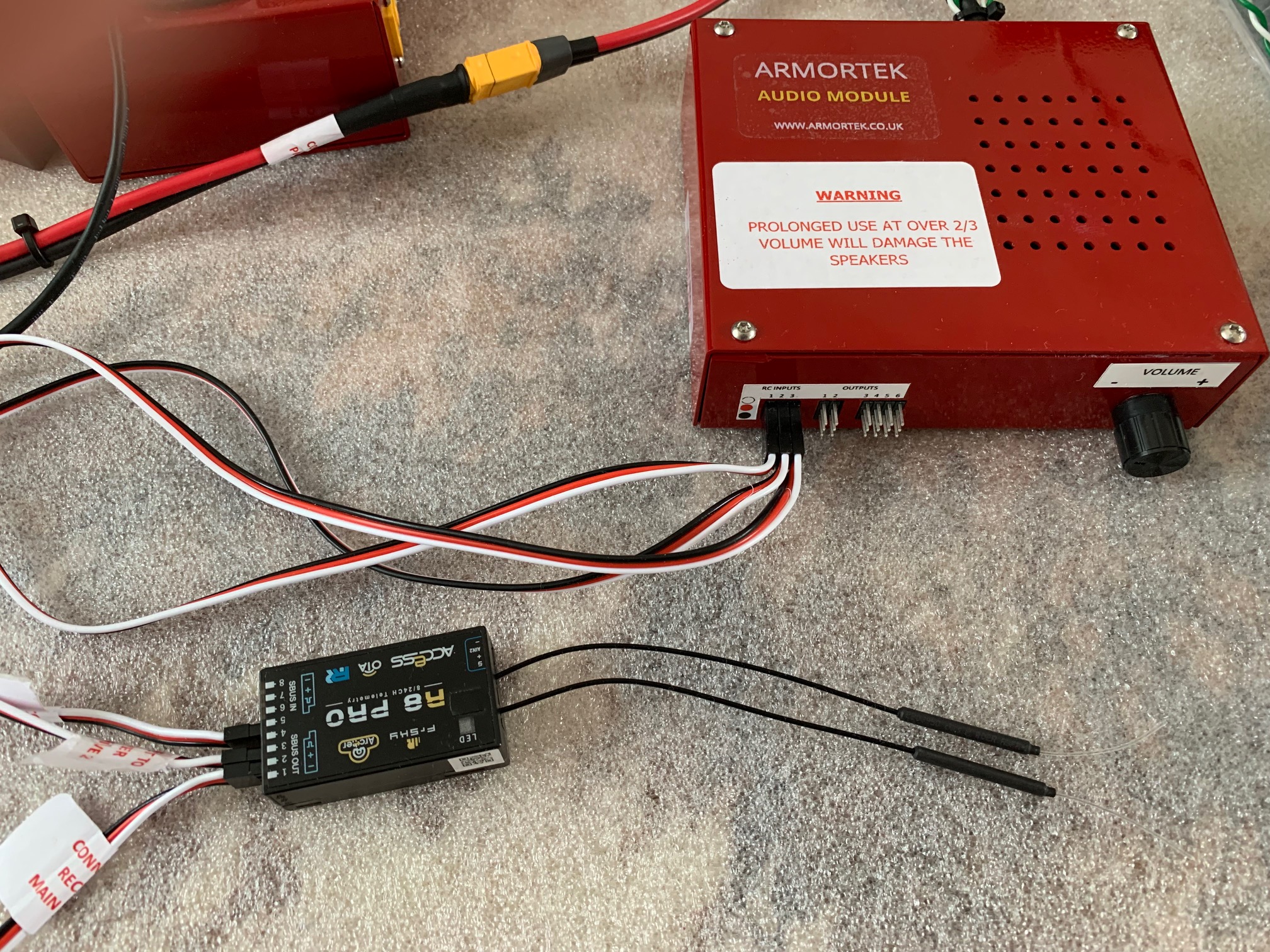

I need some advice and help to establish what is wrong with my sound system.
Unfortunately Armortek is closed due to Covid this week so I thought I would try the forum instead of disturbing Kian and Monique.

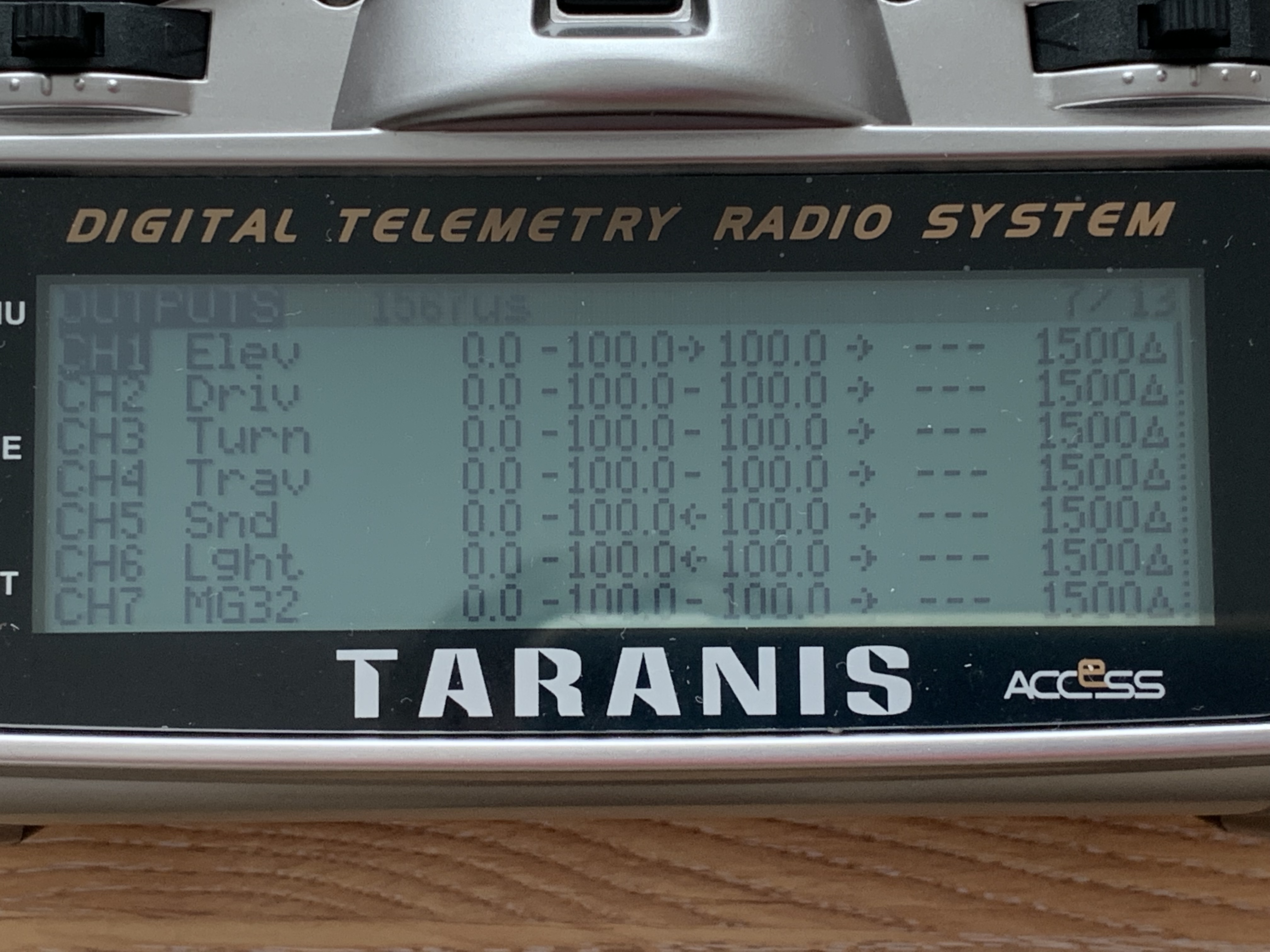

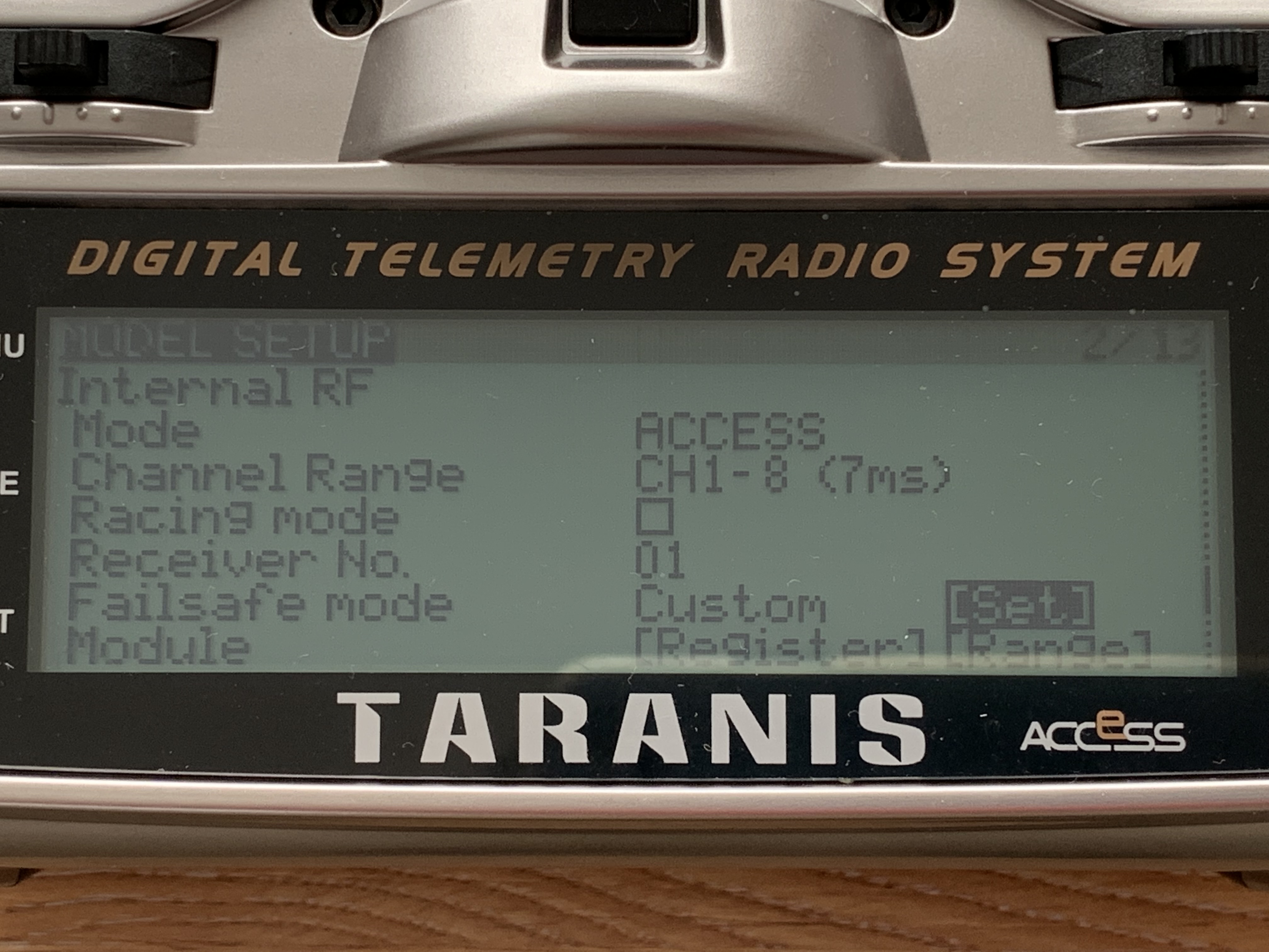

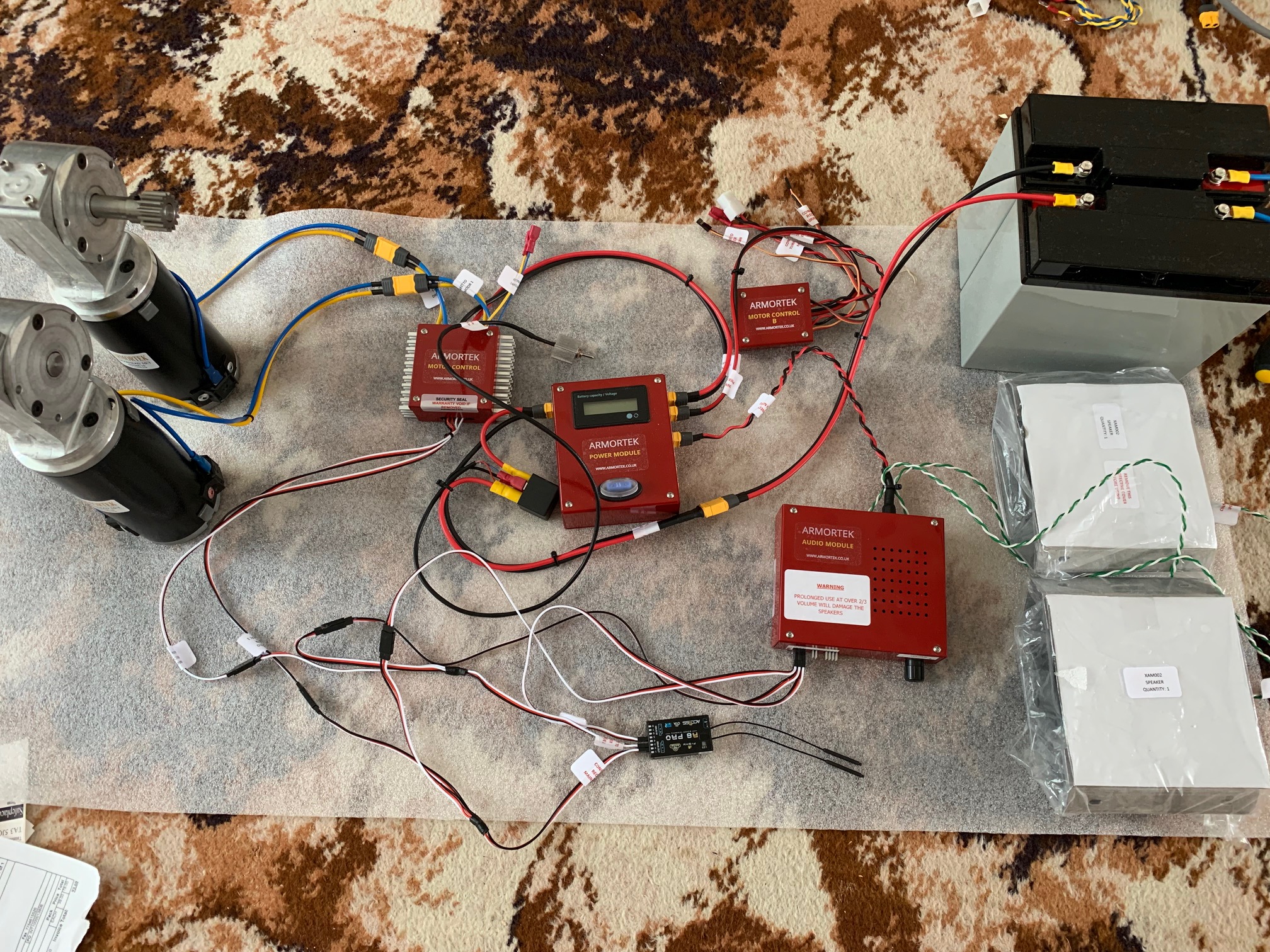

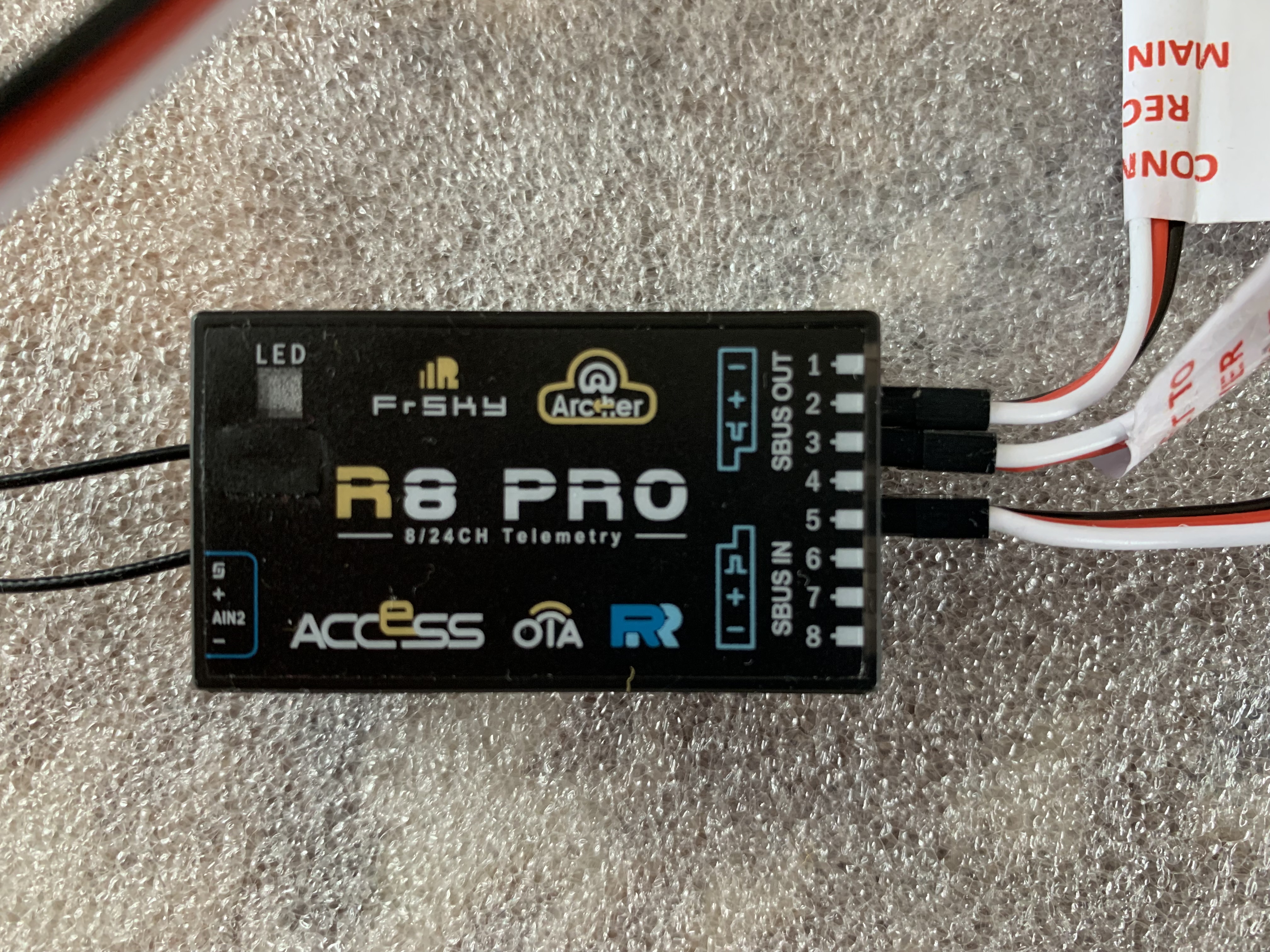

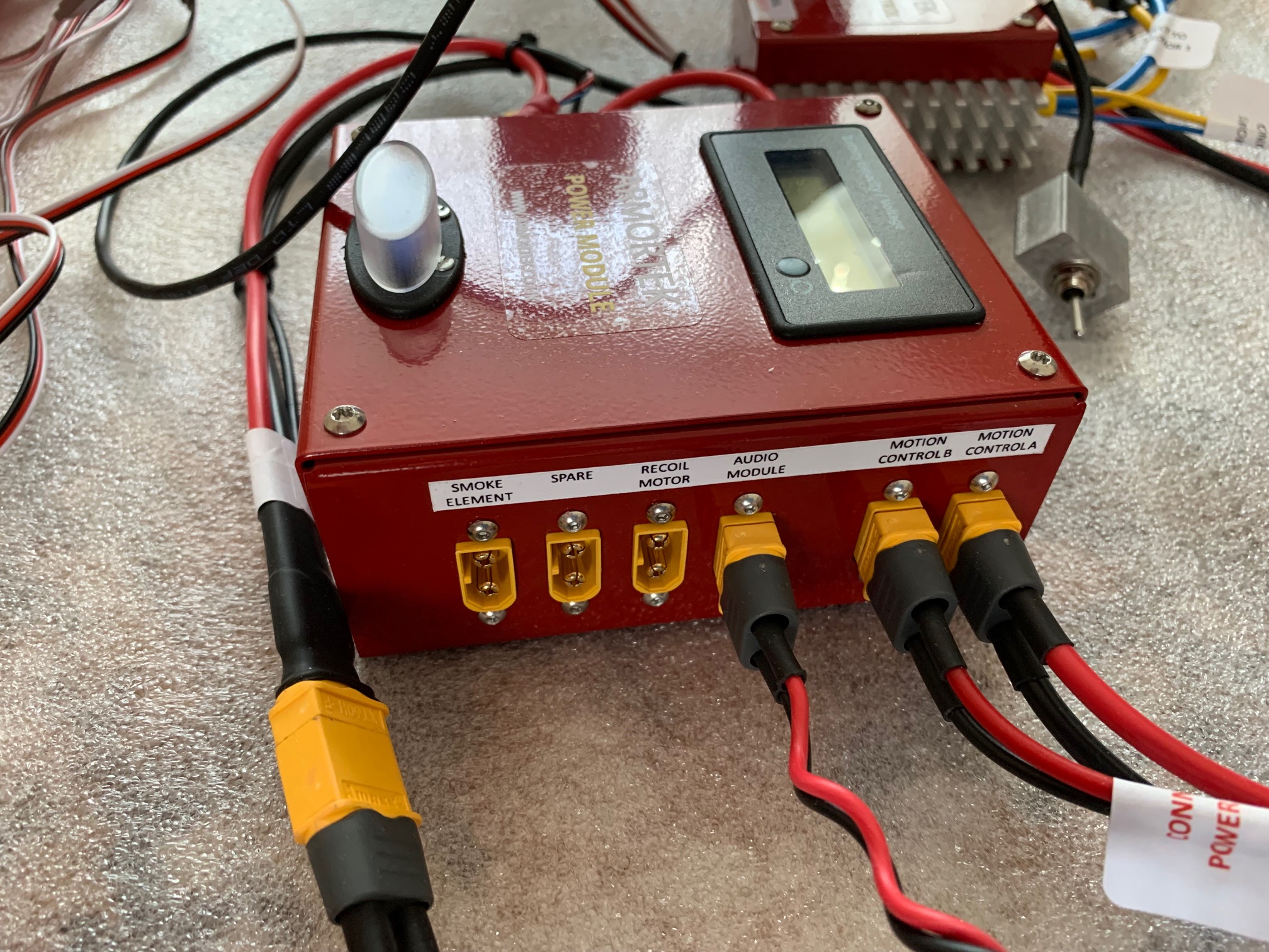

I have just set up my Taranis X9D+ 2019 transmitter and connected the modules and motors as per the first part of the manual.
I have motion control units A & B, the audio module, receiver, speakers and motors connected and have checked the connections numerous times.

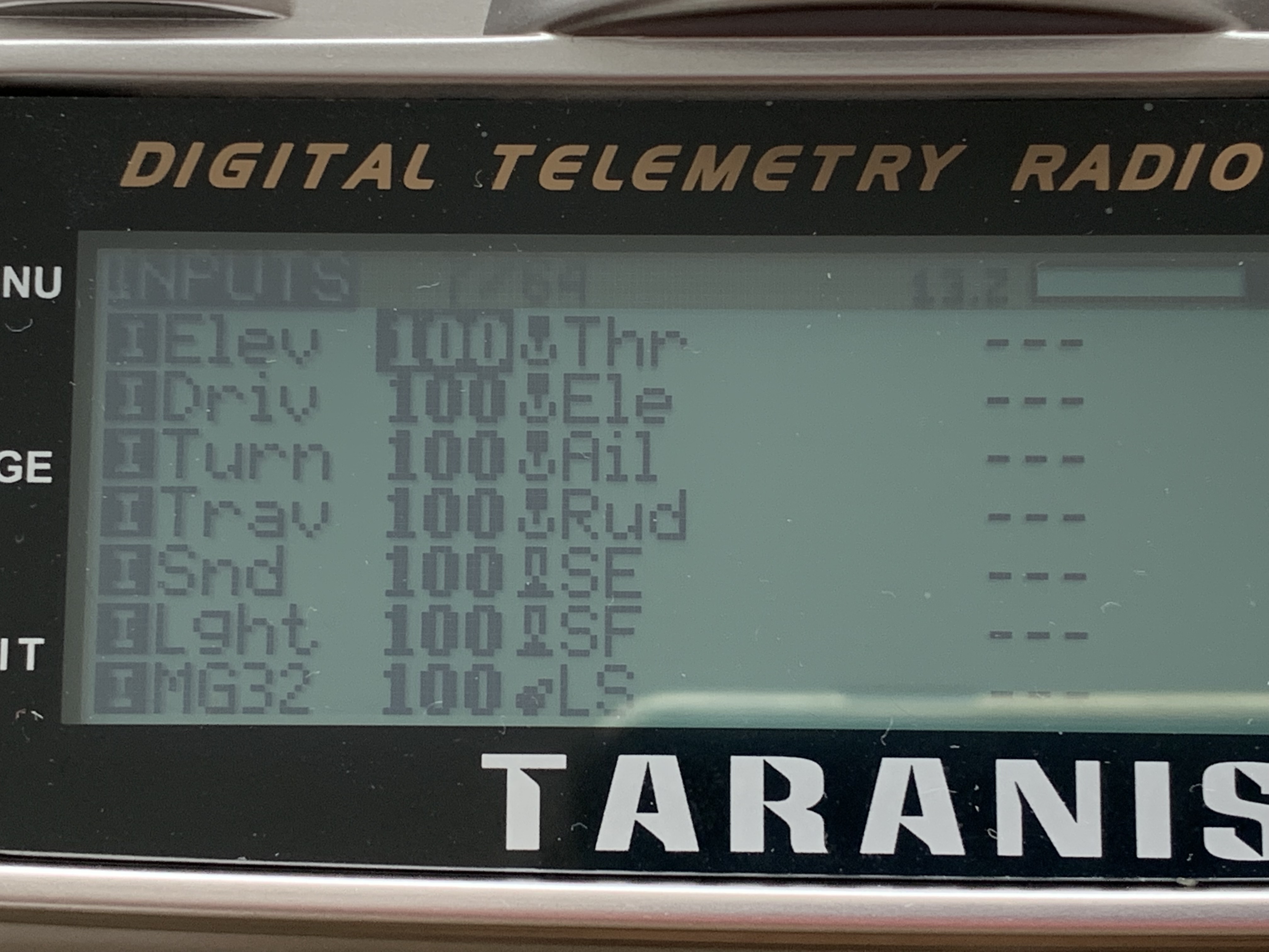

The 3 way switch (SE) is set up for CH5 and connected to input 3 on the audio module.
The motors work ok and I get a beep from the speakers when I switch the power on. There is a background hiss but nothing else. I tried the calibration button which gives a beep but using the 3 way switch as per the manual produces no sounds.
I am not sure what else I can do hence this appeal for help.
The following photos will help see how I have set things up.

All looks OK.
Have you tried the switch in both directions when doing the "teaching" step ? I can't recall if the sounds card is fussy as to the switch movement.
I know the instructions say to move it towards you but it depends on the transmitter set up. You can always reverse the channel afterwards.

Hi Adrian
I have just tried the switch both ways after getting the calibration beep, initially nothing happened, then on the 3rd attempt I got a brief burst of engine sound. I redid the calibration phase again and I now have engine sounds.
I will go over it all again now and check the other components, servos, leds etc are working in synch with the other sounds.
Thanks for you input, I can get the motors installed now and get the drive sprockets in place.
