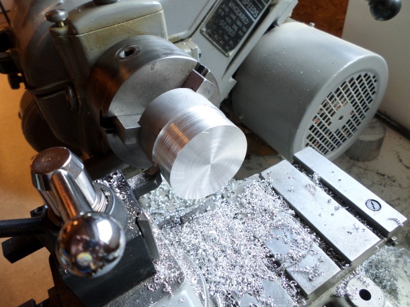

This was over complicated, so I went for another solution. I still had a linear bearing and made a plug of aluminum
where the bearing would fit into. this busing & bearing would then be put into the mantled tube.
(The busing would five support to the sides when it was glued).
The next step was to make a plug for the gun barrel, that one I made from a piece of PVC and drilled a hole of 13mm though it,
to allow the stainless steel pipe I had.
Next step is to make the bracket for the servo.
