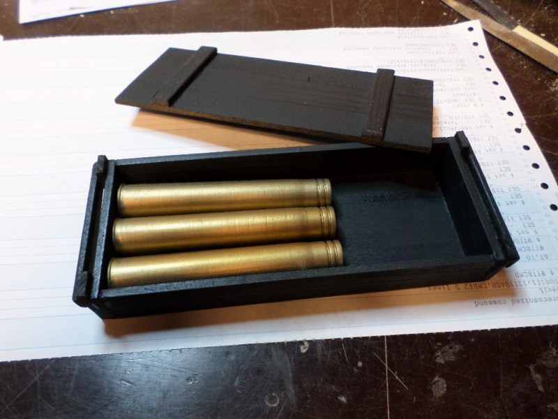

Ammunition box for shells/cartridges
In one of the pictures in this tread, a stack of ammo boxes are shown.
So, I decided to make one, acting like a prototype for now as I had to calculate it's measurements.
Made of strips of Pine for now, but want to use a bit more dens type of wood for the next ones,
as I want to make a stack similar to the one in the picture posted earlier.
The color used for spaying is 'Dunkel Grau' (Dark Grey) as ued by the Wehrmacht.
Not sure if it was the proper color for these type of crates tough.
No markings yet. Is there a way to make reusable paint stencils with markings?

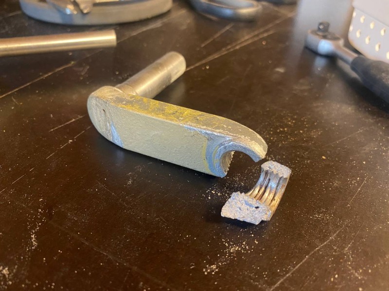

Unscheduled maintenance

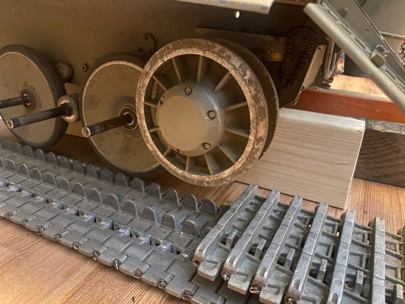

Well, after a great weekend in Overloon at Millitracks, my Tiger got some 'battle damage' during the toy crushing on
last Saturday as can be seen in Kian's video below.
Now, as we go as a small group to an event in Denmark on the 20th, some work needs to be done on the tank to make it fully working again.
Damage so far : one broken section of the front swing-arm / suspension and one broken tyre.
Some emergency repair was done on Saturday afternoon (a lot of people were just watching the process), by removing the entire
suspension assembly of the wheel.
I only needed to get some loctite and M4 cylinder bolts (some bolts are to long in the tank, I'll replace them where needed.

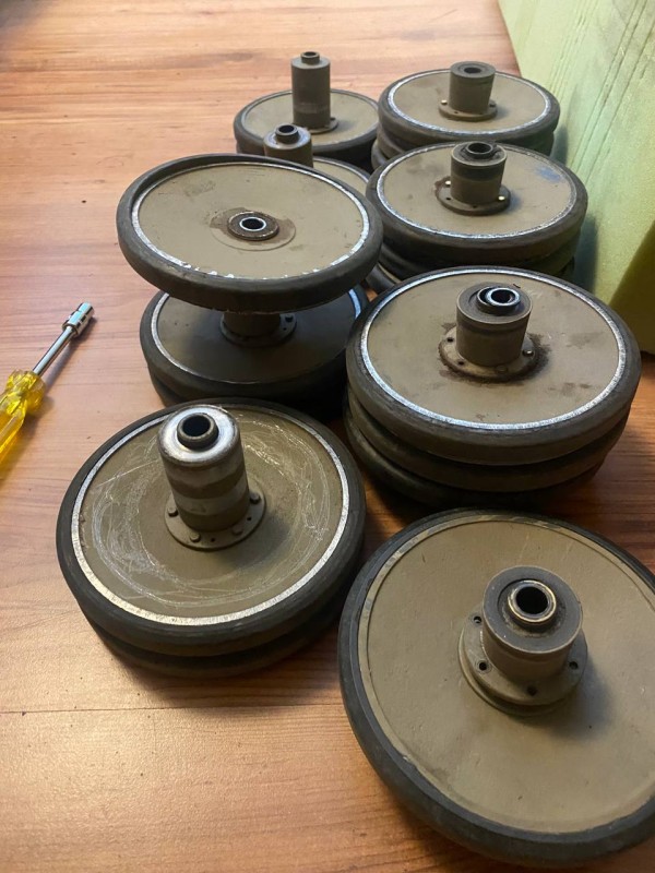

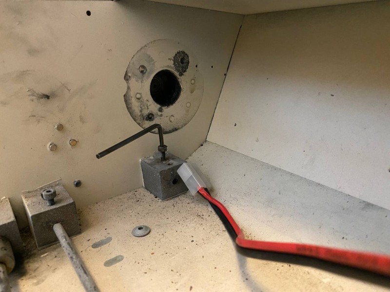

Today the wheels were removed, the tracks were opened up and the left motor was removed for easier access.
Also the idler wheels were set forward, as there was not much tensioning left. I'll remove one (maybe 2) track links to get the [proper slack on the tracks.
The removal of the tracks also revealed that some scraping was visible on the outer housing of the big gear, this could als be the reason why
the track kept getting out of the sprockets once and a while.
Tomorrow the all the tyres will be checked on their fixation on the rim, some of them can be removed very easily.

Axle trouble
Well, for those who have seen my tank making a bounce in the Armortek video above the previous post,
I used my last spare (cast aluminum) swing-arm piece to rebuild the complete axle.
Last weekend I was with 4 other members of our club in Denmark, were we had a great weekend (thank you Steen & Co.!)
My tank did not run too well, the double wheel on the replace axle was hopping the teeth on the links, and it made sometimes
some weird clacking noises.
Today I disassembled the tank so remove the right track and see what could case this odd behavior.
There were 3 issues.
1 - the tension bar was not fully tightened at the axle end - easy fix.
2 - the swing-arm was not fully moved in, there was a space of 1 mm between the hull and the swing-arm - easy fix.
3 - after fixing 1 & 2, the wheel still looked odd, and a closer look revealed that is was not perpendicular to the hull......
the cause of this problem is that the tread in the upper part of the aluminum is not at a 90 degree, 2 degrees off
and so causing the double wheel to stick out further at the track side than the other double wheels.
There is about a 5 mm difference between the first double wheel and the 2nd.
As I have no other swing-arm parts left, a replacement is ordered, I hope I get it delivered soon, so the tank is ready for the next

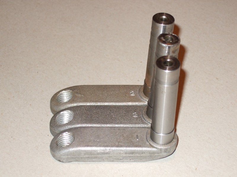

Hi Ed, the very early Tiger kits had those cast swing arms which are next to useless, they were often drilled out of square to, the newer kits have very nice machined aluminum arms which are drilled straight and true, best you replace all of them when you get a chance.
I quite enjoy this type of repair work it's very therapeutic and rewarding. Phil

This shows how out of true these old suspension arms can be. And that's just one side, so the error can be doubled up
Best thing to do when buying one of these old kits is to order a nice set of the CNC machined arms from Armortek.

@Phil and Adrian, yes, my last spare one looked like the middle one if the picture.Adrian Harris wrote: ↑Thu May 26, 2022 12:41 pmThis shows how out of true these old suspension arms can be. And that's just one side, so the error can be doubled up![]()
2 Replacement ones have been ordered (part of another order from another team member)
