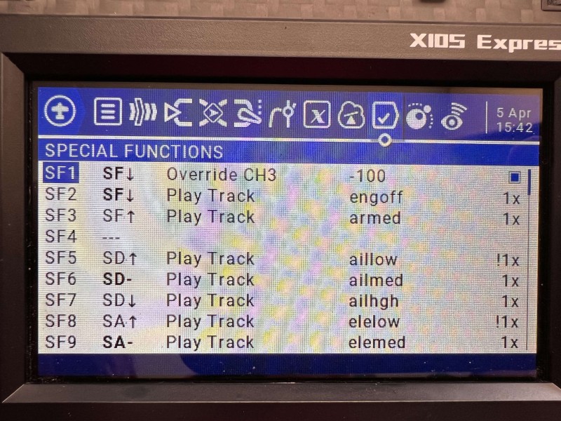

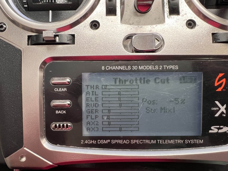

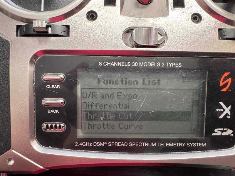

They do Adrian. In the first two pics below, on Spektrum, I've used the inbuilt Throttle Cut function assigned to the left hand two position Mix switch. The Throttle is inactive when the switch is in the up position. (If the transmitter is mishandled, it's more likely that the two position switches are knocked up than down, so the safe position should be up).
For OpenTX, all I've done is add a Special Function which overrides the throttle channel when two position switch F (SF) is in the up position. I've also assigned two sounds to the switch (Engine Off and Armed).
We'd have to think about how to implement a throttle cut switch on our different configuration. On aircraft, the throttle range is -100 to +100 with engine off in the -100 position. For tanks, the engine is off in the centre position, 0. The OpenTX implementation should be easy to edit but I'm not sure how the Throttle Cut function is implemented on Spektrum. I suspect we could use a throttle curve.
It's a good idea. For aircraft, it's a real safety issue - propellors with electric motors can sever digits. For tanks, inadvertant movement might be a problem if there is something/someone in the way or the model is on a bench. I did use to wear a neck strap on my transmitter until the day it got caught on the throttle as I was picking up the Tx. If I'd had a throttle cut switch, the model wouldn't have moved.

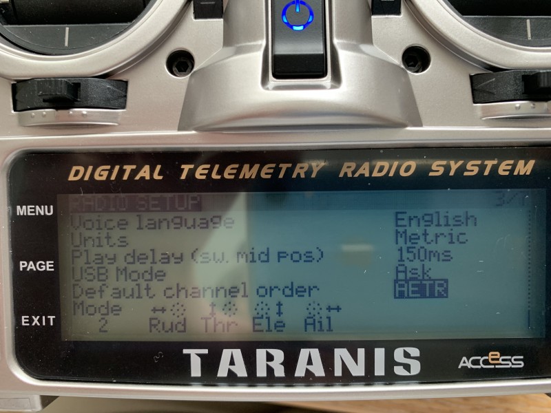

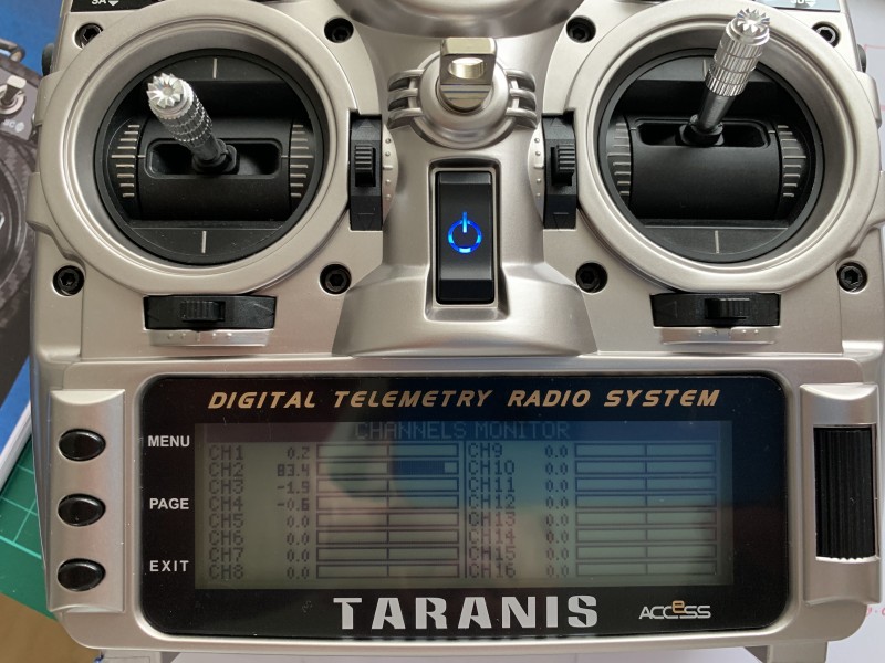

I have been trying to set up the basics in my Taranis X9D Plus 2019 transmitter but have got totally confused.
I want to use single stick driving on the right stick with elevation and traverse on the left stick. the receiver is an Archer R8 Pro.
I have set mode 2 and the channel priority is AETR (as recommended in the manual) but when I go the the channels monitoring screen I get the following from the stick inputs.
CH1 L stick L/R (Rudder)
CH2 R stick U/D (Elevator)
CH3 L stick U/D (Throttle)
CH4 R stick L/R (Aileron)
Altering the channel priority does not seem to make any difference. If anyone already using the same transmitter is able to assist with advice or point me in the right direction I would be grateful.

Re: Transmitter stick configuration
This is exactly the joy/pain of learning OpenTX.
You need to create a MIX which adds two channels together to make single stick driving possible.
So if right stick up/down is throttle and left/right is rudder, then you create a MIX CH1 which is 100% throttle and 100% rudder.
Then you create a MIX CH2 which is 100% throttle and -100% rudder.
These are what will drive OUTPUTs CH1 and CH2 on the receiver.
My radio is set up as RETA but it makes no odds as you just pick the inputs you want which tie in with the controls you want to use.
Then you have the fun of getting the motors wired so that 100% on both outputs is forwards, and left and right work as you expect.

Hi All
Thanks for all the replies and advice.
I will spend some time going through the manual and follow the advice given. I have started inputting the model and registered and bound the receiver, I think the reason the channel priority looks wrong is the model was already partially input presumably as it is using the model widgit Stephen mentions in his Open TX build thread. At present I don't appear to able to delete the model so I can start afresh. I am sure it will explain how to in the manual, just have to treat it all as a chance to learn new tricks. :D
Gary
You can't delete the active (starred) model.
Just select another one if you want to start again, then you can check settings with the current one.
