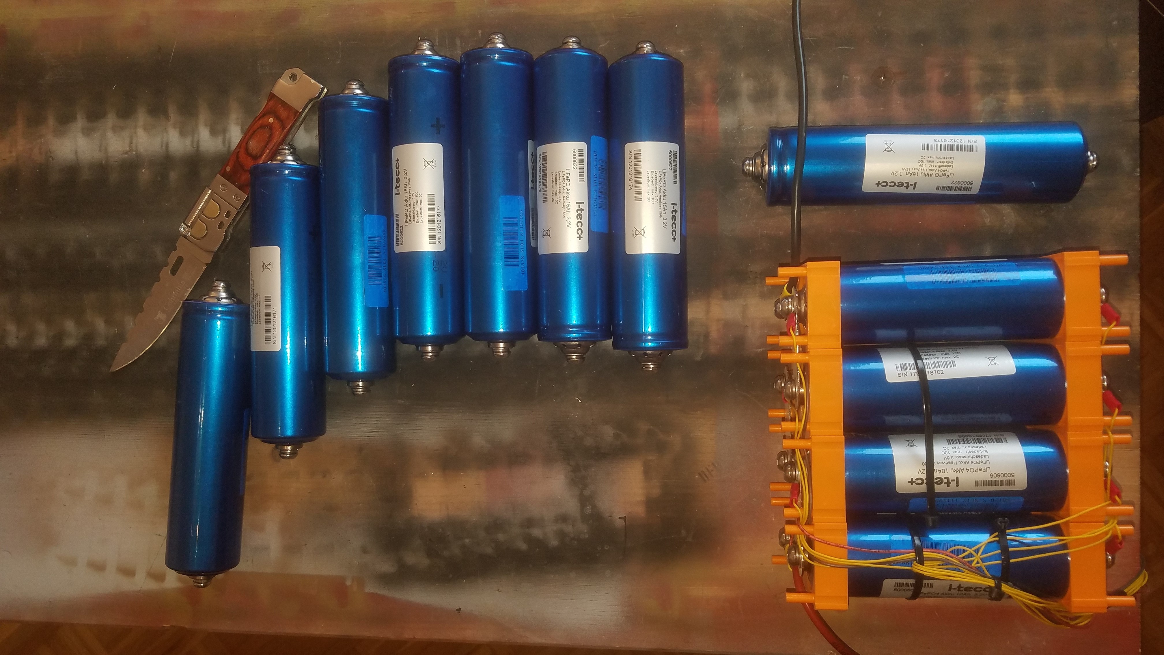

Now its going on with the interior.
First its going on with the battery. Amazing the size between 10 to 15Ah. The 10Ah is from the Famo because not enough space for bigger one.
I have in the StuG a two deck system for the electronic, so enough space for the big battery and a two speaker box for sound.

Have you also tested the drive with the 10Ah battery? I would be interested in whether it is sufficient, apart of course from the possible driving time.
florian rudolf
Posts: 678
Has liked: 297 times
Been liked: 645 times
Re: Florian StuG build
Post by florian rudolf »
Hi Michael,
No, I haven't tested it. It would certainly work.
My FAMO weighs about 120kg and runs with the 10Ah battery for about 30 minutes.
With the FAMO, I built the battery so, that I can change it quickly. With the StuG it is permanently installed and cannot be changed quickly. So I decided on a stronger one.

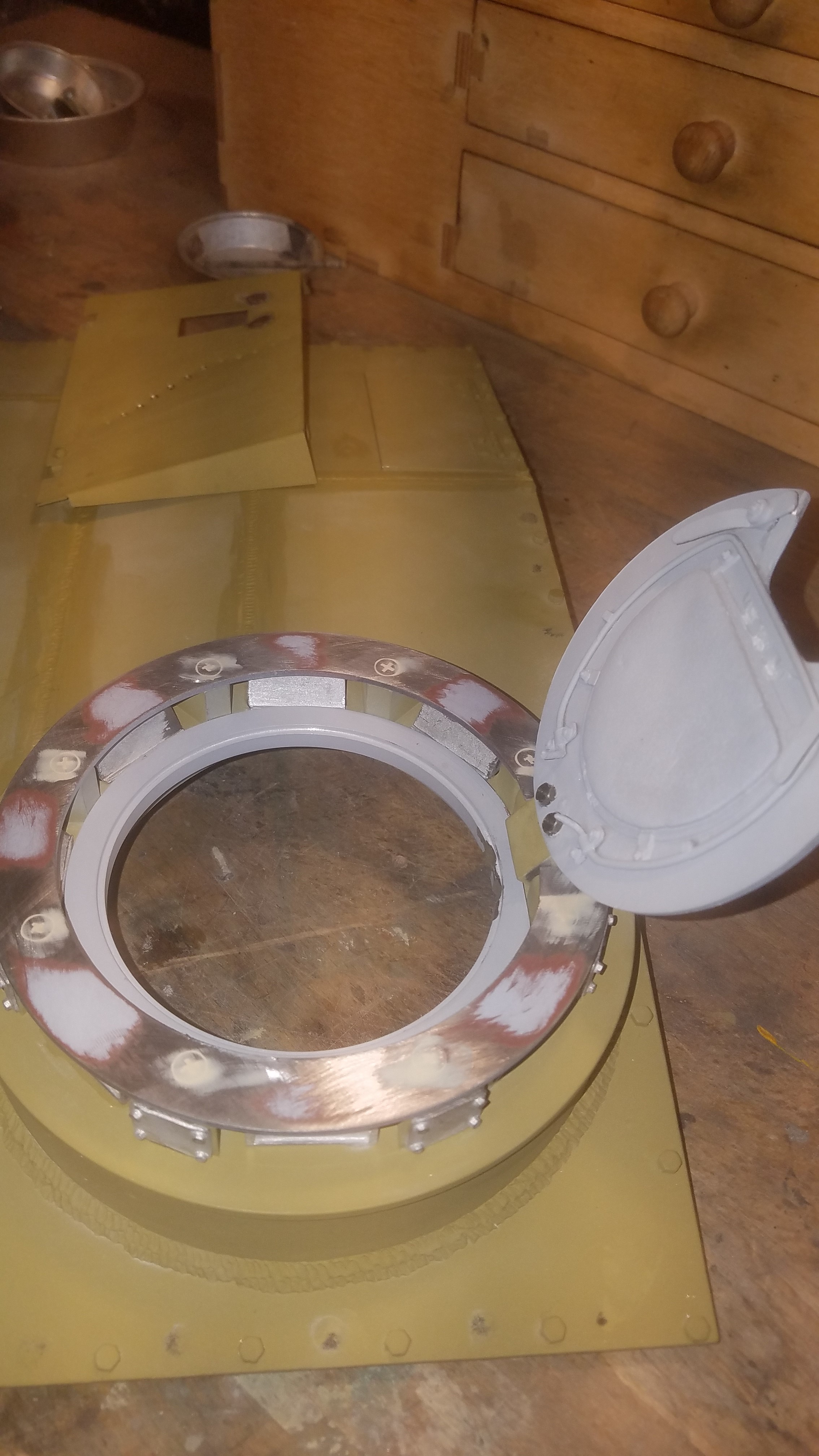

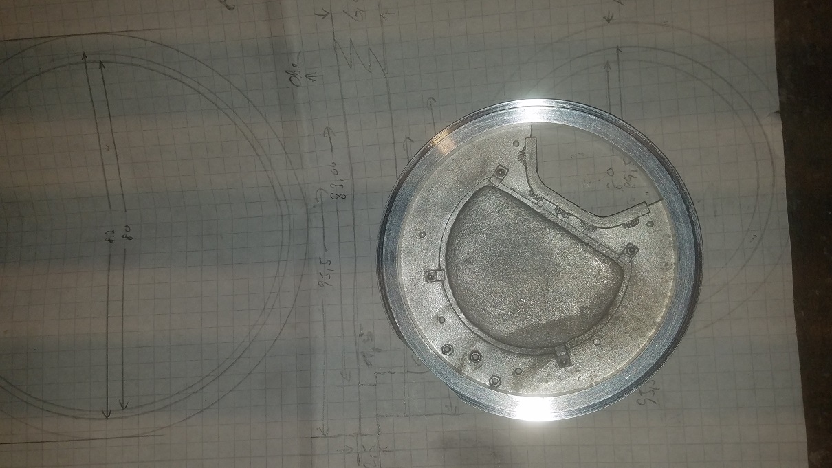

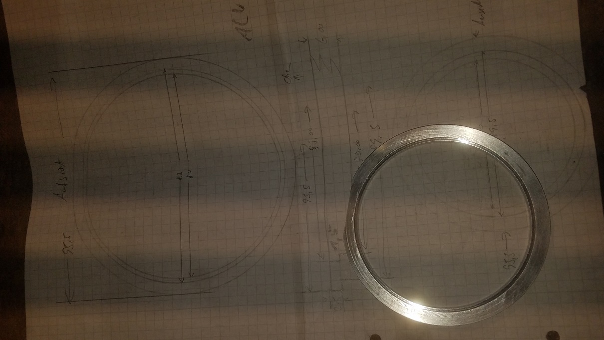

Today some more metal work at the turret.
Made the ring to connect the AP hatch

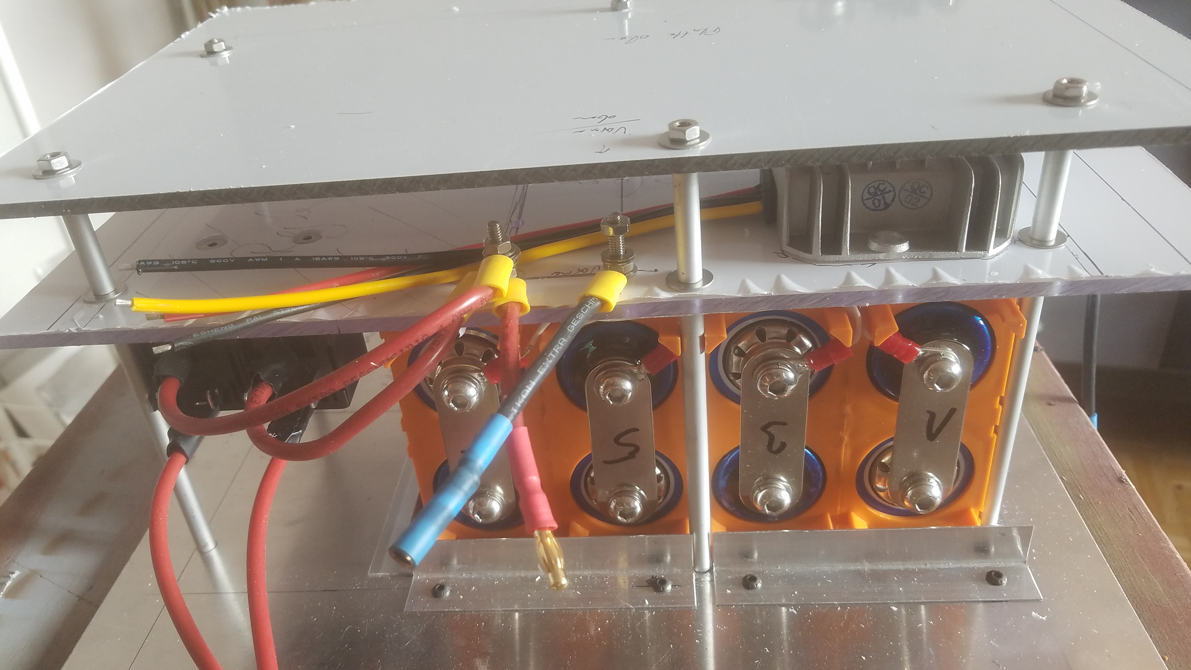

Did some more electric work today.
Next comes the soundbox in working process.

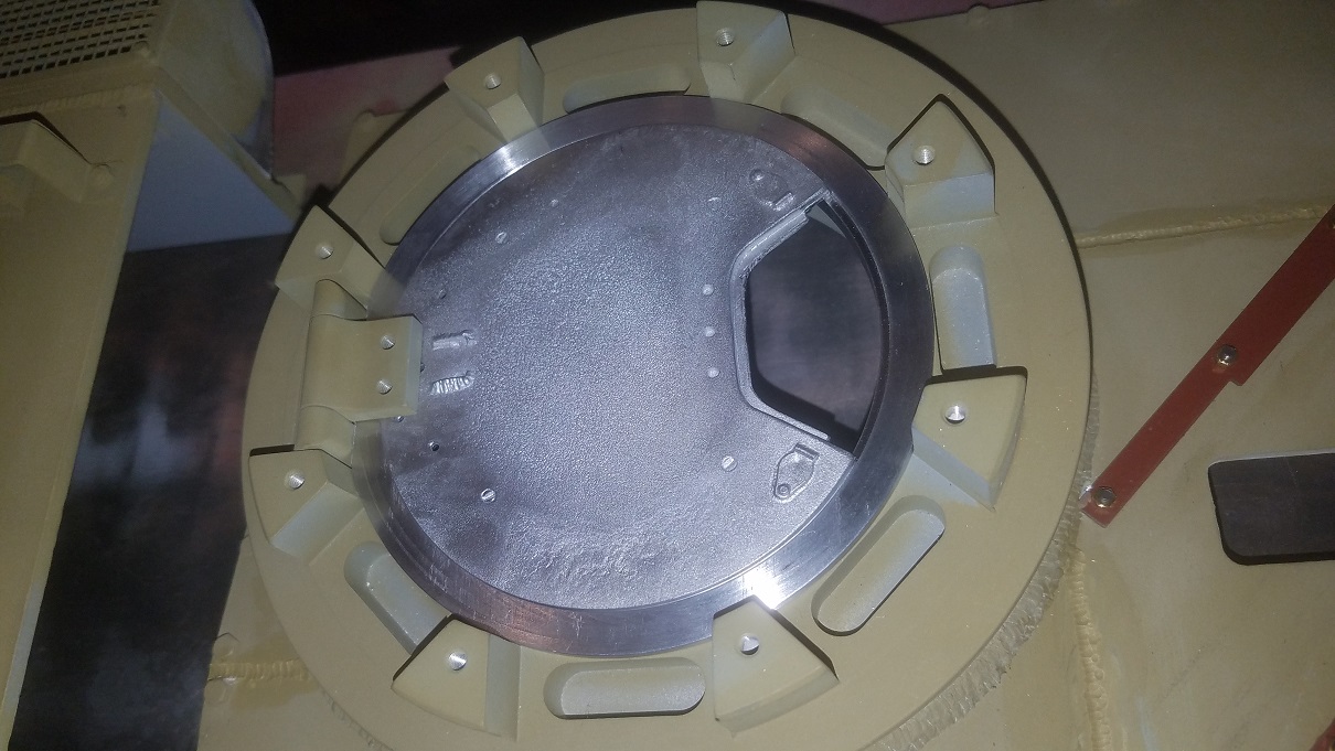

Now I finished the Comanders Hatch and start final painting.

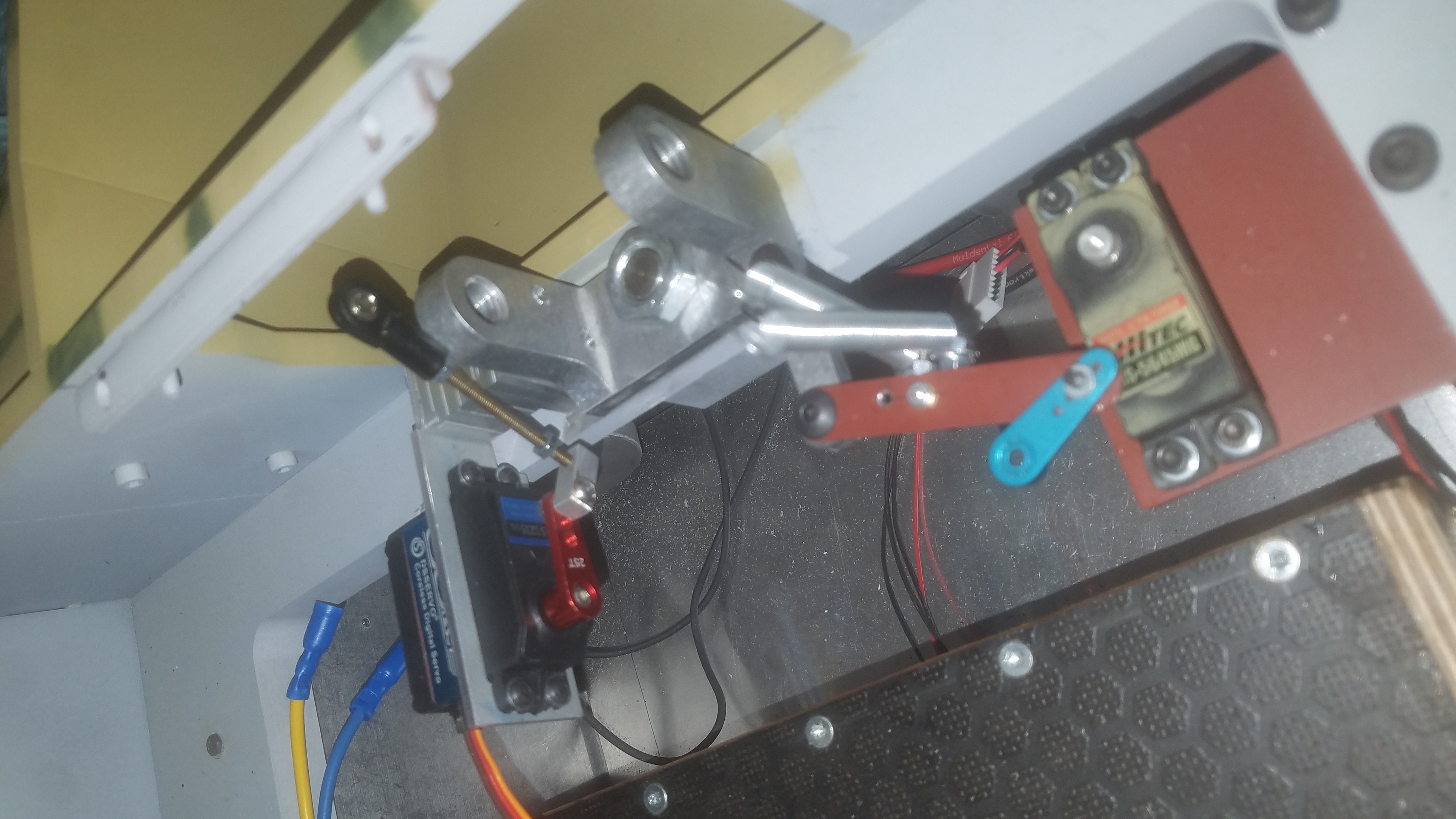

Did some work at the gun mechanics. You need a strong servo but it works well.
