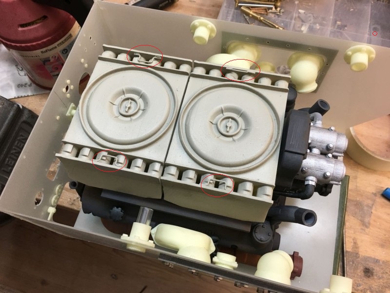

Like the 3D printed engine air filter details. Are these 4 handles printed too or metal parts added later on ?
Lerh Chang
