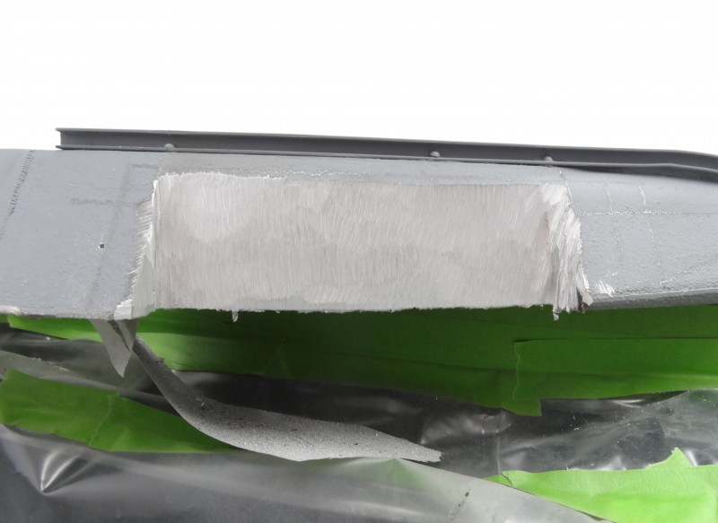

For many weeks I’ve been ‘umming’ and ‘ahing’ about reshaping the front casting. More specifically where it runs under the turret ring and joins the rear side plates. Today I finally decided to give it a go.
After 4 hours with a grinder and various files the basic shape has appeared. There’s quite a bit more to do before it’s right. The curve on the underside needs to be more exaggerated but also the join with the rear side plates needs attention. The join should be further back, which may be tricky. First, I will refit the track guard and try to imagine what the modified locker will look like and then make a decision.
Its not right yet, but it’s a start.

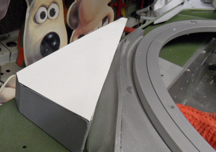

Made a mock up with card board to show you what I had in mind, I should add Richard Goodwin has the same thought due to the need to align his Berlin camo patterns, I wasn't sure if it was necessary due to the Batus Camo I'm imagining for my model.
As soon as the the mudguards go on, it will annoy some as it did myself.
The triangle bin on the original model was way harder to make than if it had been made scale, but then of course the upper armor casting would have needed altering.
We are where we are.
As I said before if done well the extended scalloped triangle bin could look pretty good unless you open it, the upper armor casting overhang disappears to a certain degree within the bin. The bin extension could be made from plastic card, steel plate or aluminum.

This job has taken a lot longer than I imagined it would. Apart from the shear quantity of material that has to be removed the next hardest part is trying to get both sides symmetrical. It would have been a lot easier if the casting hadn’t been fixed to the hull but I got there in the end. Now all I have to do is remake the storage bins.

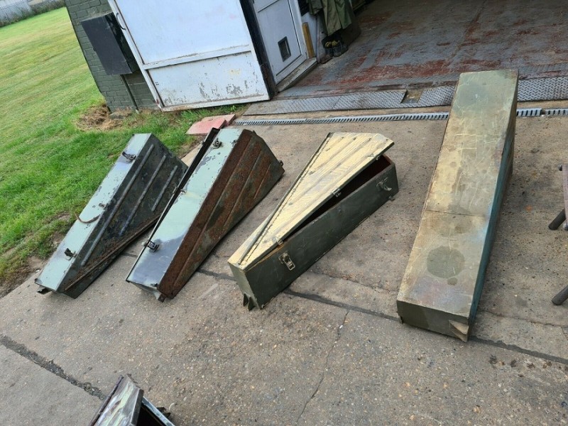

For the nostalgic. Buy your own on ebay
and a little bit more detail. (underneath :lol:)
