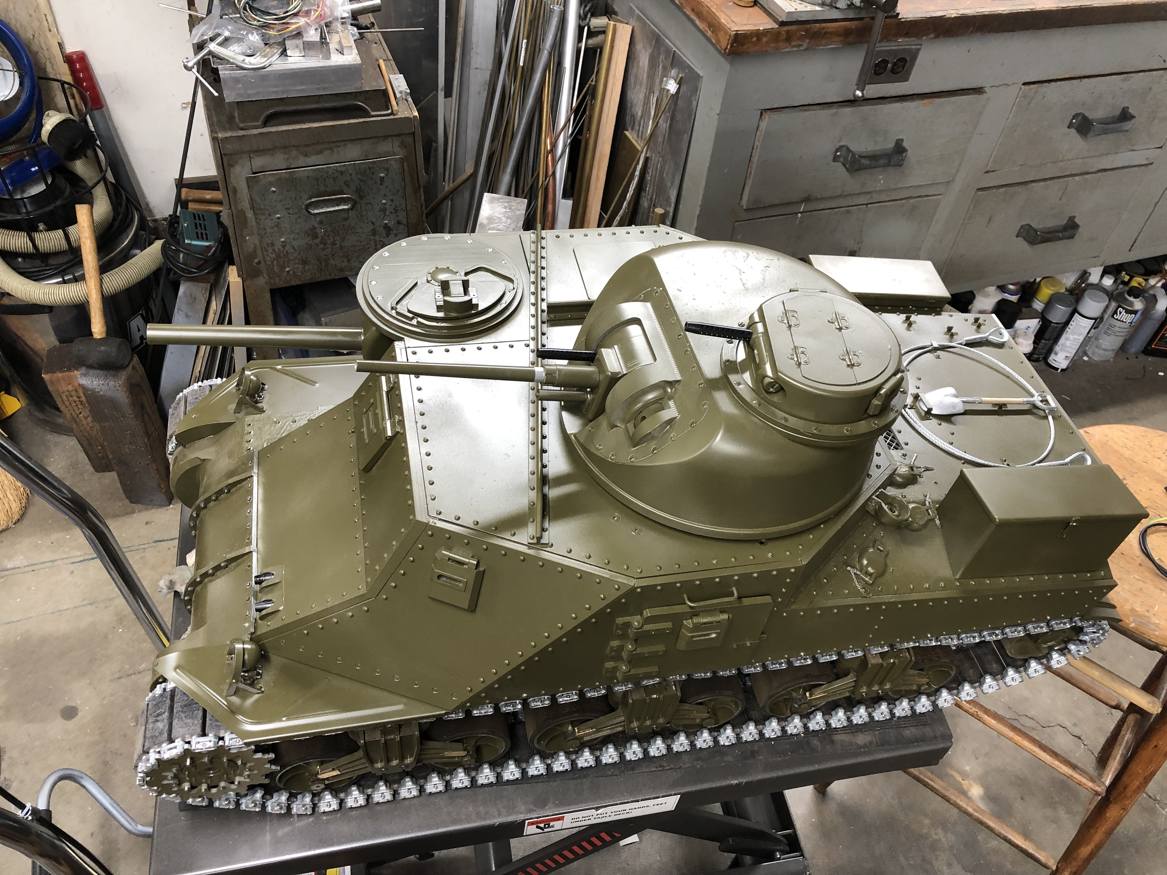

As I wrap up work on my M3, now just waiting to apply final touch up paint then insignias I reflect back on what's what.

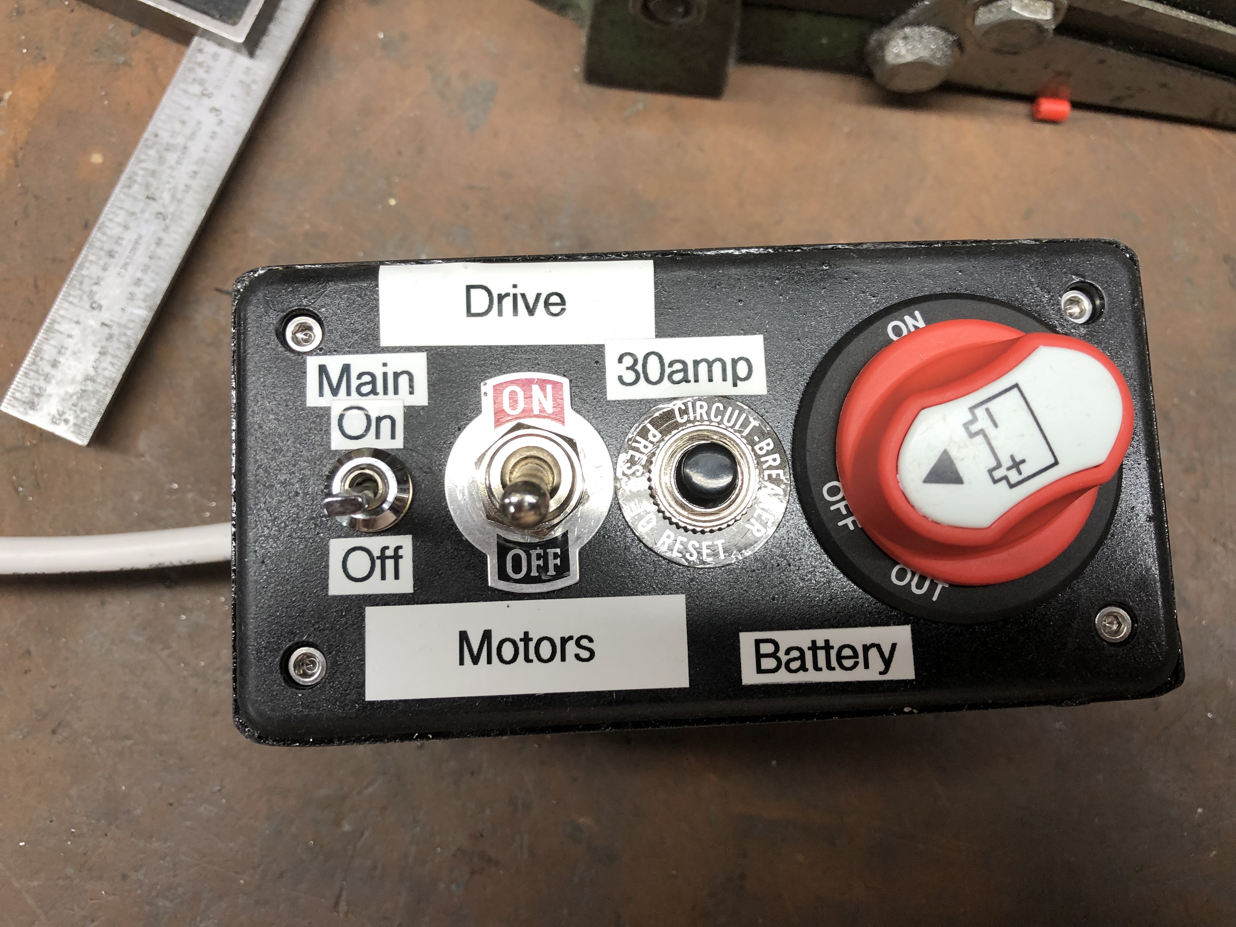

I implemented a 'control' box from which I am able to have a main battery cutoff, disable the main drive motors
so that other radio tests made be made with worrying that the model will take off when I inadvertently bump the stick
(ask me how I very nearly shredded a thumb on a Kavan helicopter tail rotor many years ago!) as well as having a redundant
circuit protector. I have used flexible 10awg silicon shielded wire and high quality XT60 connectors for anything I've made or touched.

On the whole as my first Armortek construction I like it, It's a very good model, a good product and I'm decidedly hooked as my growing pile of
these kits will attest.
