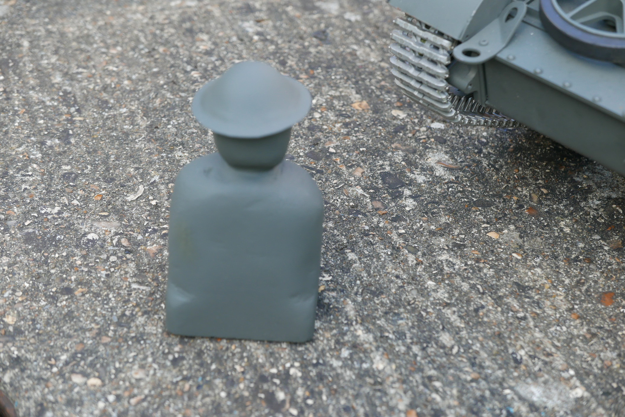

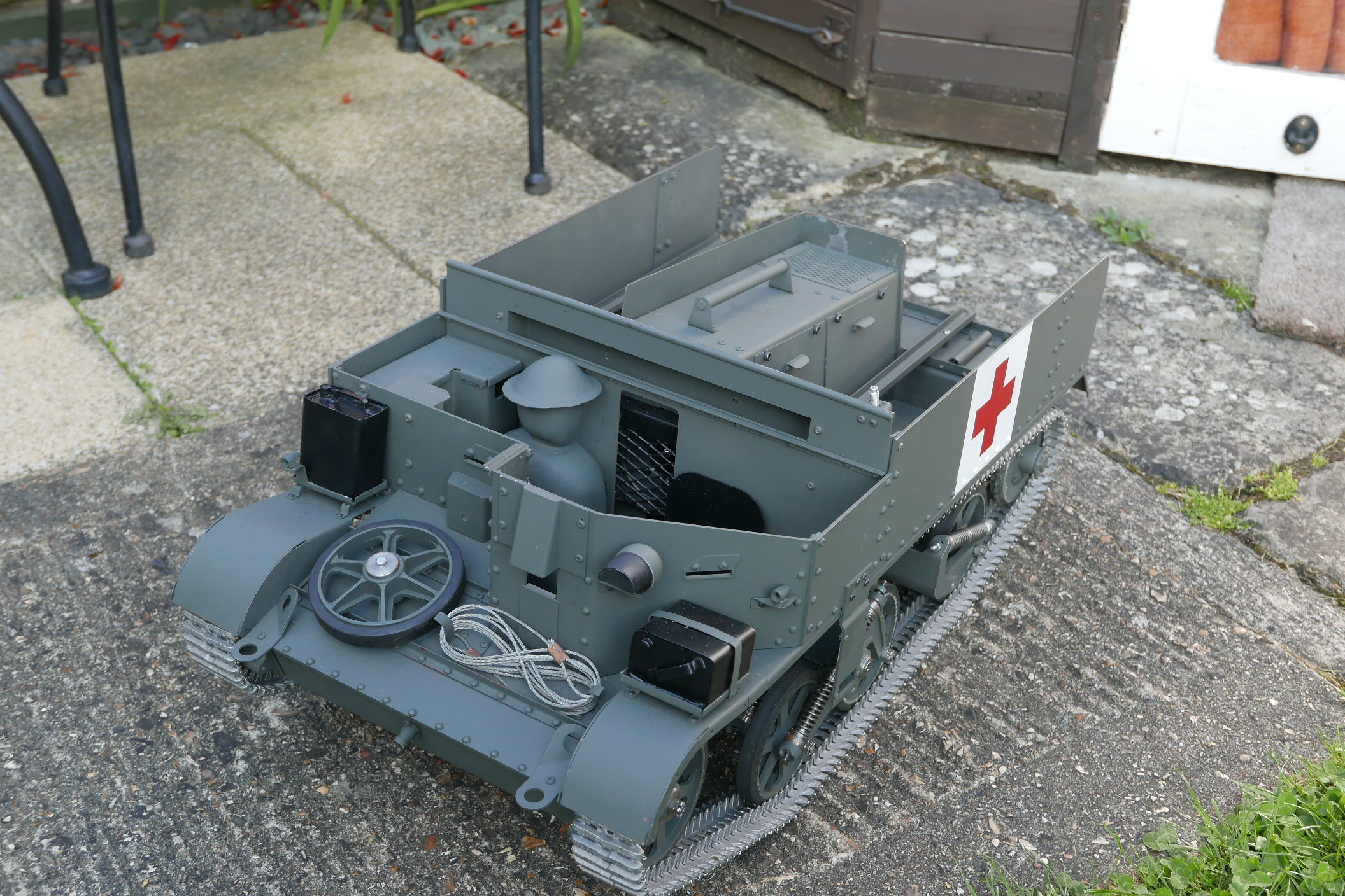

Further to the discussion regarding a driver (or lack of it) further up this thread I decided to find a middle ground between no driver and a doll.. er, I mean scale action figure in period correct outfit (
). The pictures should need no further comment. The 'body' is balsa wood and the helmet was beaten out of a disc of steel against a wooden former and finished to shape with some body filler.
Hopefully it provides enough of an illusion of a driver. Kind of fits in with the 'jerry cans', more a suggestion of the object rather than a detailed representation.

Looks good to me
nice little seat filler, from a short distance you'd be struggling to tell the difference from a real Eddie.
