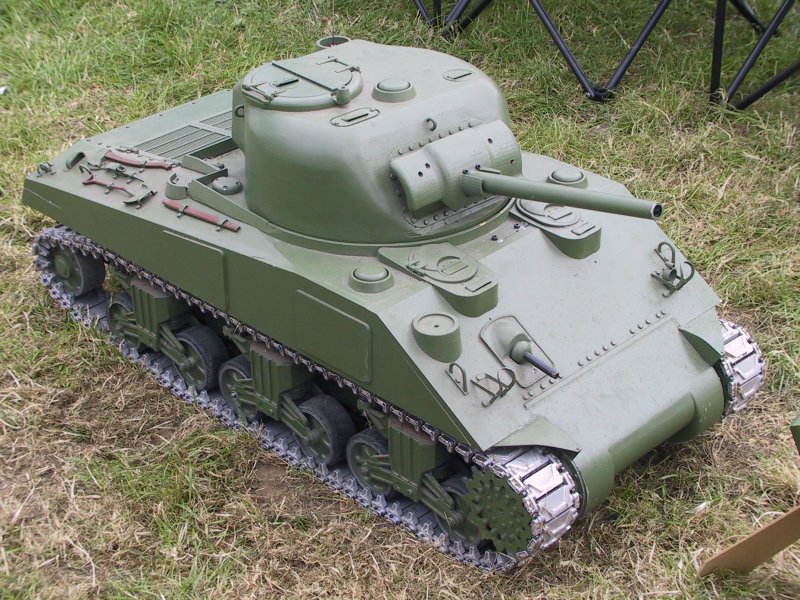

According to the pictures I have she'll be 20 in May, so I ought to get her running again. Nearly there, just currently stuck on getting the motors fitted as they don't bolt to the hull sides like the production ones, but just sit on brackets bolted to the floor.

I'm basing that on the fact that the EXIF dates in the pictures I have are 2001.
She became the rust bucket, but she's now all shiny again :-)
I dug the hull out this afternoon, which reminded me that the Acetal tyres on the wheels have suffered with age and split. I've spent a couple of hours trying to find a decent price for 85mm diameter acetal bar, or even better tube, but it's all at a silly price. I could 3D print new tyres, or just fit production rubber ones, but that seems a shame given everything else is original.
The kit I bought in 2006 has a bracket at the back of the motor but also four holes in the final drive housing around the aperture for the drive gear, to which you can bolt the Parvalux motors via an adaptor. This one used the same system as the earliest Tigers, with two brackets on the motor which bolt to the floor and there are no holes in the final drive. Any, all very Antiques Roadshow :wink:

Perhaps one last 2020 update. I redesigned the Sherman air cleaner box to be much simpler, and slightly smaller. Will be using these 3D printed version.
Mostly printed parts:
Assembled air cleaner box, take 2:
Installed: Original on right, new smaller easier to make on left! :roll:
Happy new year everyone. Hope to continue <and finish> this in 2021.

Few updates on this old girl. Trying to get it finished before E8 arrives. A few more detail bits added.
Sledge from alum and cherry wood handle:
Image]
Sledge mounted:
track spanner mounted:
Side tools mounted: Shovel is brass n wood, pick and axe are kit parts. Axe is modified - made slightly smaller. Armorpax excellent footman loops.
springs on front hatches:
Rear end overall:
Still a lot to do. Till next time,

Plugging away on this old girl....Nearly finished with the detail bits...until I find something else to fix. :roll:
Added faux grease fittings to wheels. Nearly ready for the faux grease...
Faux fittings to Idler wheel:
Never quite liked my original color for the tracks so overhauling the tracks - slow job. The retainers for track pins are the "new" type much better than stamped steel originals:
Added faux sand shield attachment rail to hull.
New front lamp gaurds courtesy of Fabrice L. for xmas! Thanks Fabrice -looks better!
Fitting the turret bullet gaurds - needs some fill under the rear.
Finished the pioneer tool fitting:
I think that's it... till next time.
