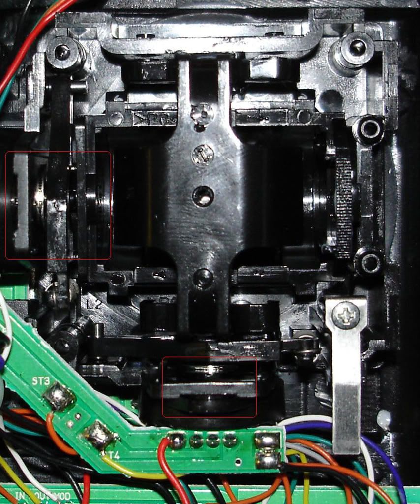

After much trepidation I decided too look into the back of the 6ex.
This is inside after it was fixed, the bottom red square is where I had to refit one of the yoke bearings back into its hole and the L/H middle square is where the potentiometer?? had been jolted out of its recess. Both tracks are now working correctly so all is well. The small switch that was broken off is not used to control anything on the tank. i should have taken before and after photos.
