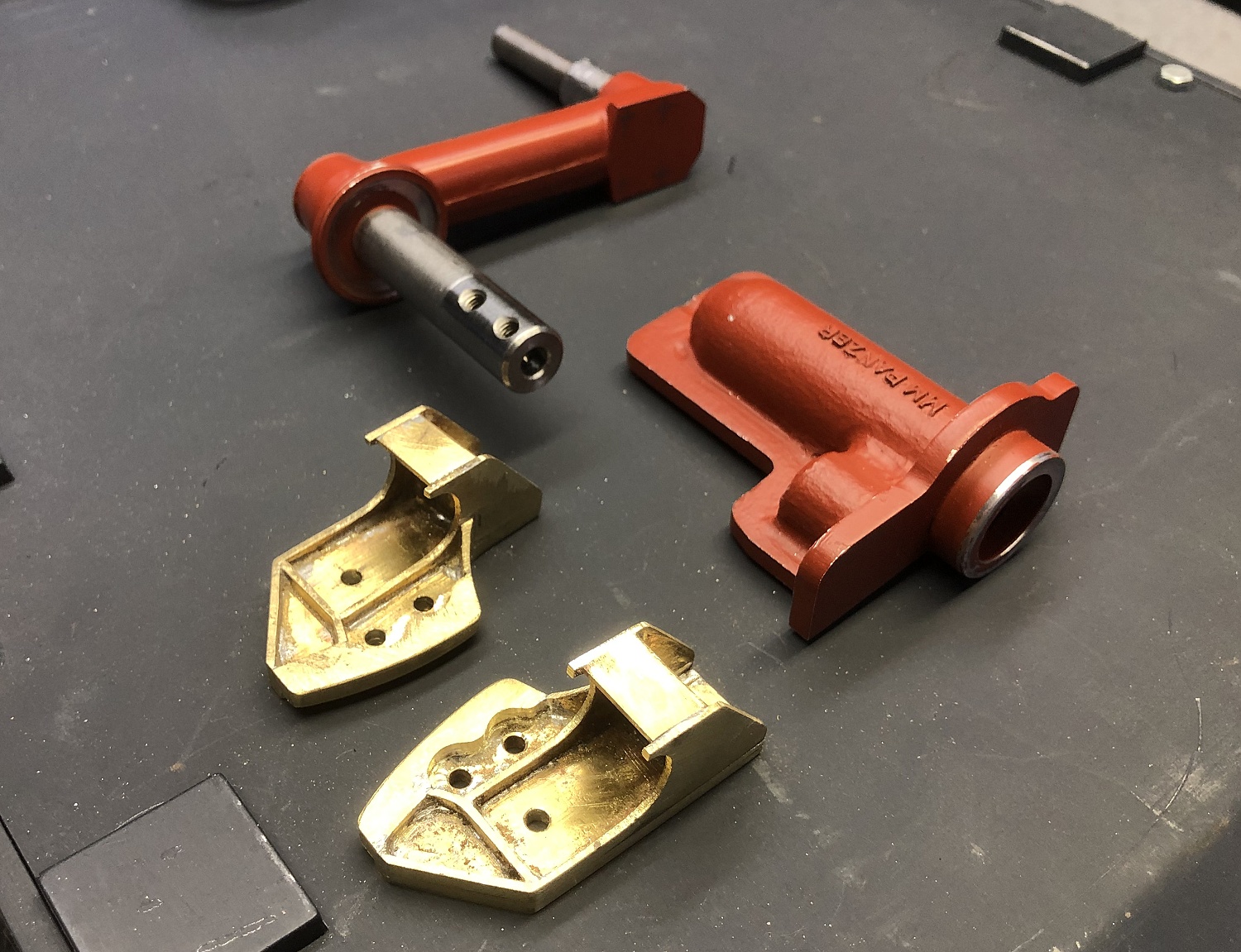

Hello guys,
After long break I decided to continue with my unfinished Panzer III kit. I prepared new suspension arms and wheels. Now hera are prepared only first prototypes. I will see about the casting progress and success because it won´t be able to make only two parts modl for most of the prototype. It will be challenge :D. I am sending few new photos from the preparing.
Have a nice day
Michal

Thank you for nice comments. I continue with the preparing of others parts. Hera are some new. I made new damper with all details and support rolls in two variants, for Panzer III and StugIII. Everything is neverending story :)
Have a nice day
Michal

I finally finished the casting of my parts for PIII and StugIII. I prepared new holders, wheels, arms, rolls and bumps. Now I could continue with fitting of castings. It is neverending drilling and making screw thread. But first holders are on these places.
Have a nice day for everybody
Michal

Only for the inspiration. I finaly finisched all arms holders and I started with the rubbers blocks for bumps. The first models are ony from a wood. Now it is neccessary to prepare modle for rubber casting.
Have a nice day
Michal

I finnaly finished the bottom part of my PANZER III. I prepared all bump stops, hatches-covers and arms. I hope in few days MY PANZER will be on his arms :D
