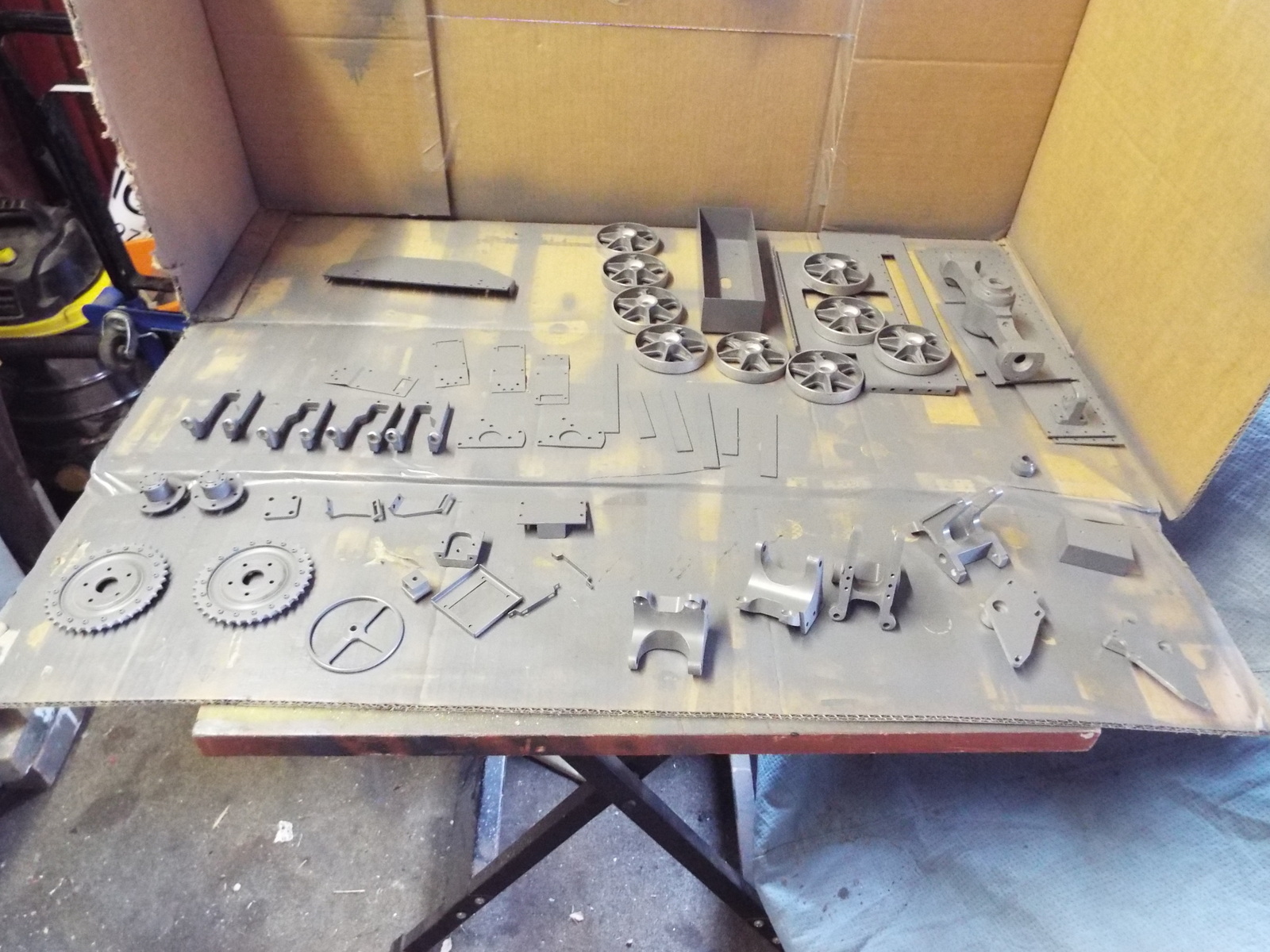

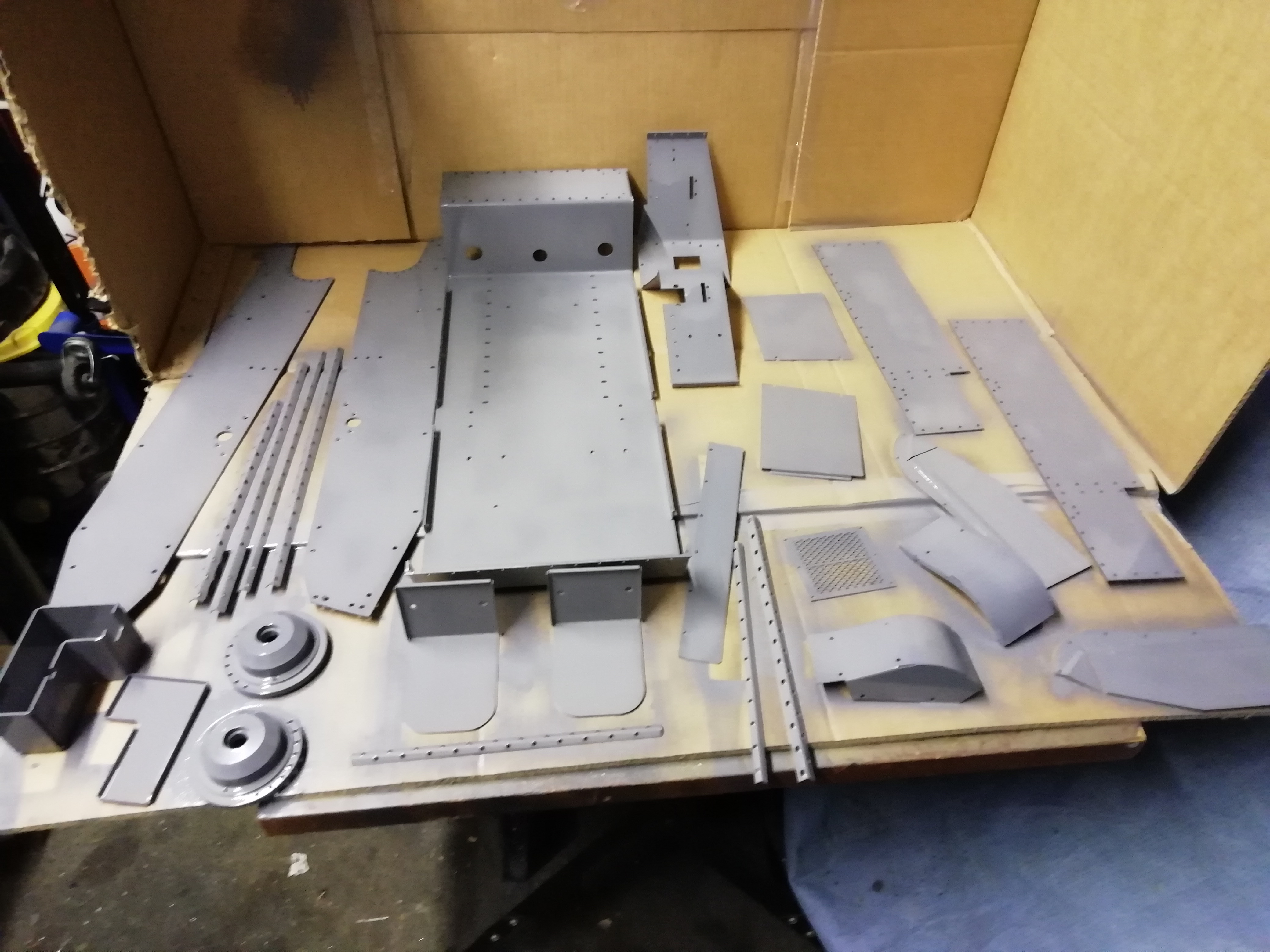

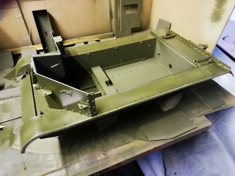

Made a start, 2 sets of tracks built 648 links and pins. Now priming all parts before assembly.
Dennis.
Dennis.

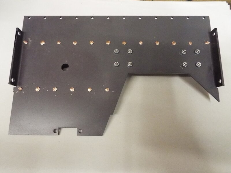

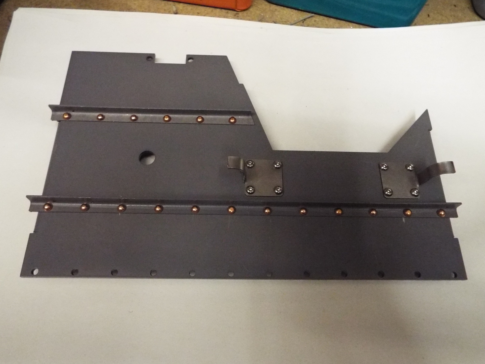

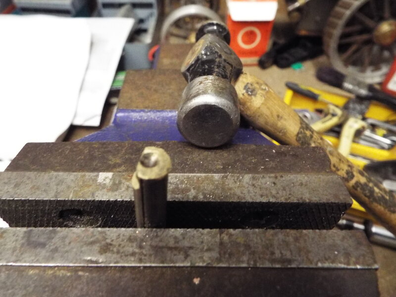

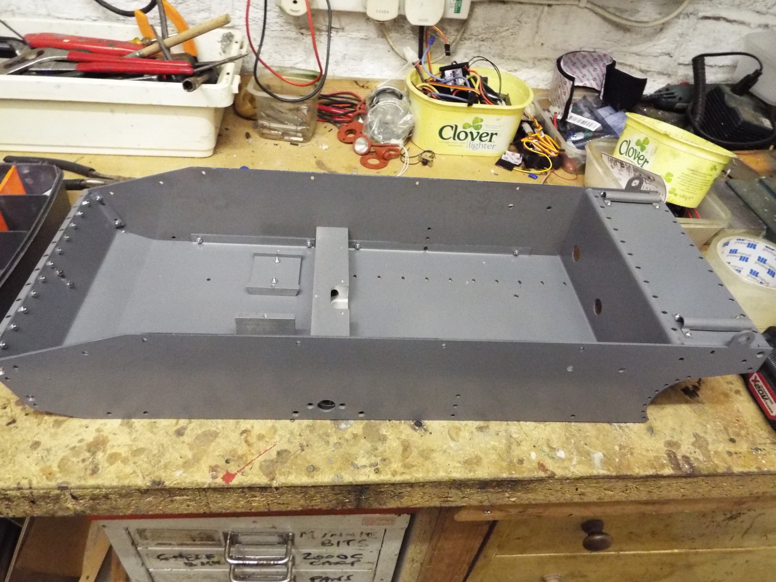

Some photos but not much progress as it's a bit cold in my workshop at the moment.
Dennis.
My rivetting tools
All rivetted no superglue here
Dennis.
My rivetting tools

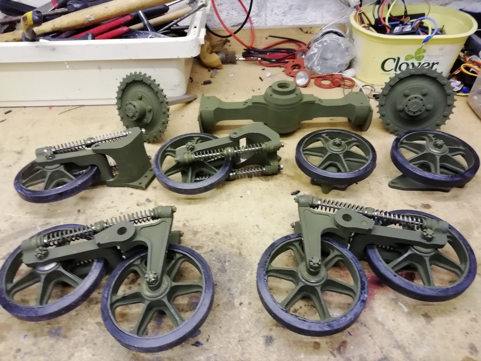

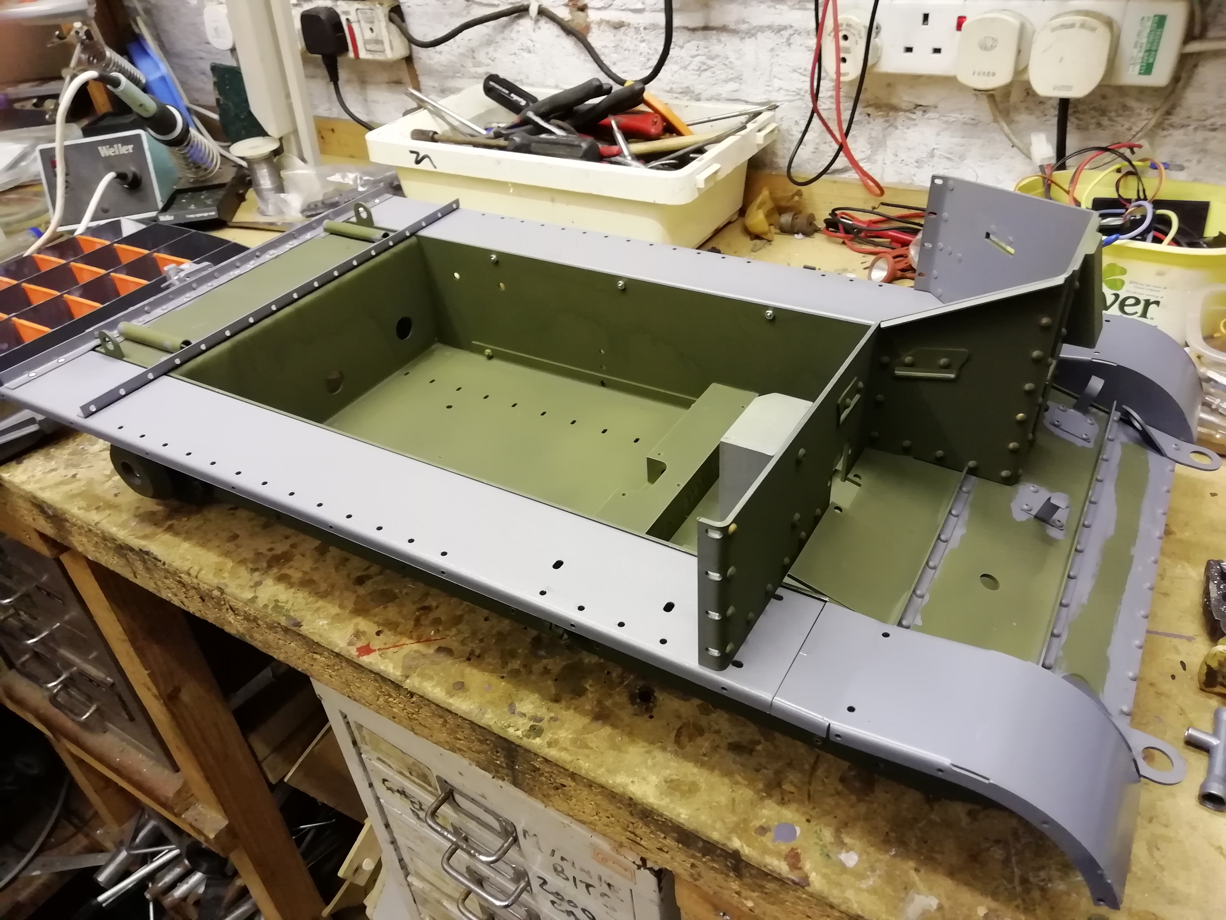

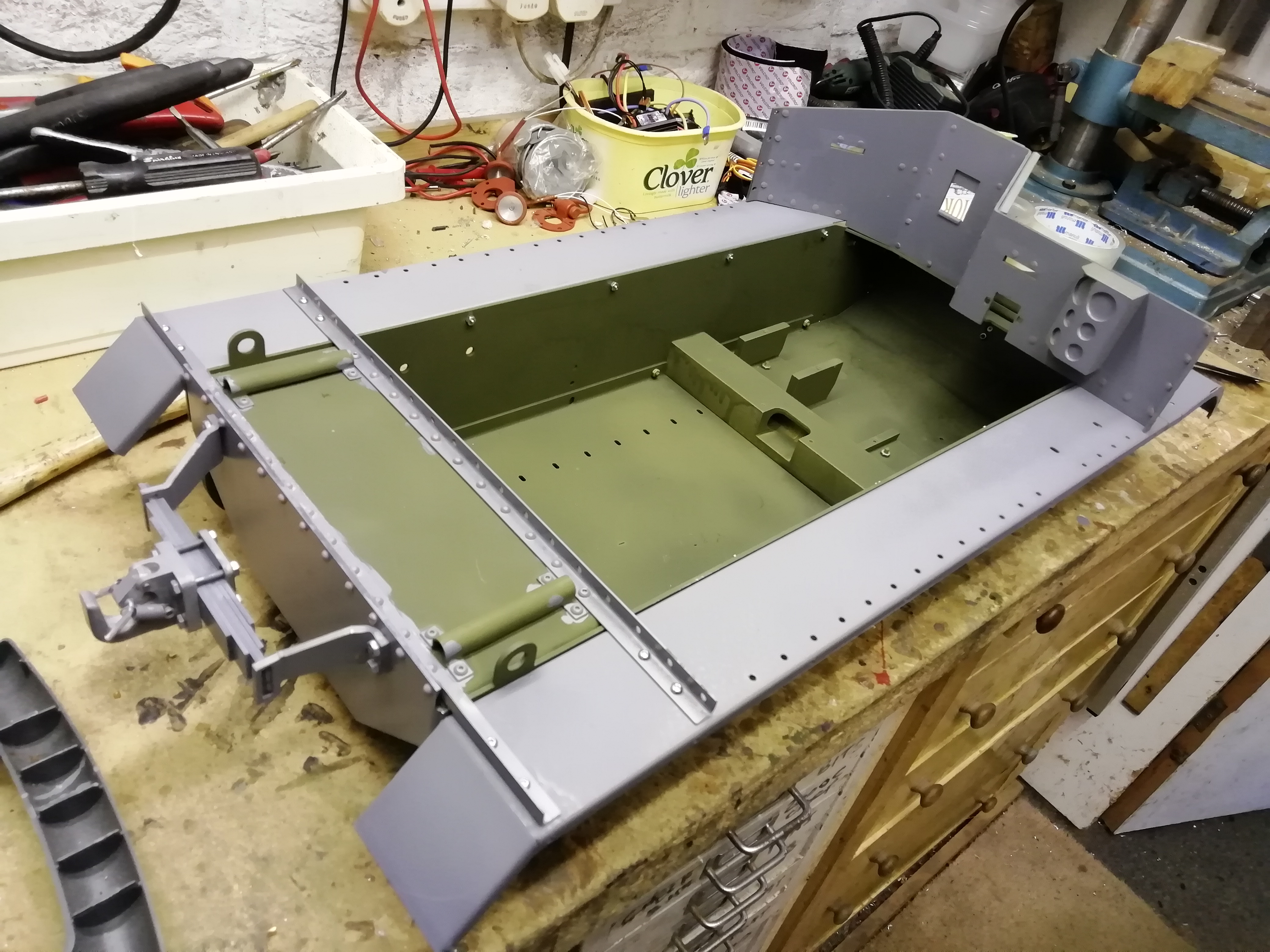

Getting there slowly. Motion pack arrives tomorrow.
I found that the rear bogie set none of the bushes that fit in to the springs would go in to the springs as they were too big, whether the springs were too small or bushes too big I am not sure but in the end I had to turn all 12 of them down in the lathe to get them to fit. The front bogie set were ok.
Dennis.
