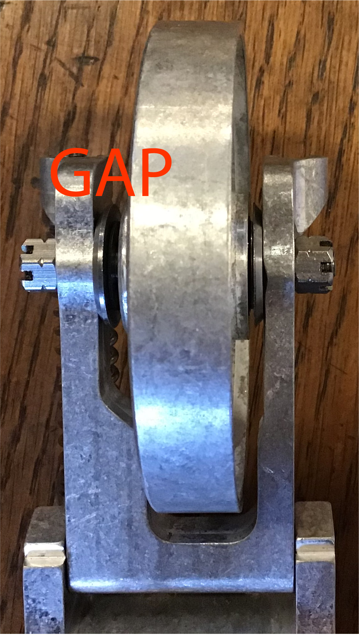

Hi Guys
I am a complete novice with my first kit.
The problem I have is that I need 5 x 0.5mm shims so that the wheel doesn't move back and forth on the axle.
The photo is with 2 shims on the axle.
Clearly I am missing something but what?
Any help appreciated.
thanks

Bob I agree there is a need for a few more shims to centre the wheel on the swing arm. I have used appropriately sized washers from my bike spares. Also you will loose a bit of play when you tighten the axle nuts. This is a great kit to work on, my advice would be to build it straight from the box as a dry build. The beauty of these kits is that as you get more experienced you can unbolt it and start again if you want to upgrade it.

I assume that the reason for having component er0229 is to allow the wheel enough movement to self align and the movement should not be shimed out other than an M8 x 0.1 thick on each end to prevent the outer race on the rotating wheel bearing rubbing on the static er0205. Basic wheel alignment can be obtained by the requirement to shim the space between er0205 and the wheel support frames to prevent the excessive bending of the legs of these frames when tightening the nuts on the end of each axle.
This has to be the reason for the length of component er0229 as it would be simpler to make it shorter and use an M6 shim between the wheel and er0205 to prevent the wheel from binding on er0205 and then to use additional M6 shims to aling the wheel within the frames.

I am wondering if its to do with flexing the track for the steering that you need some play in that part.
