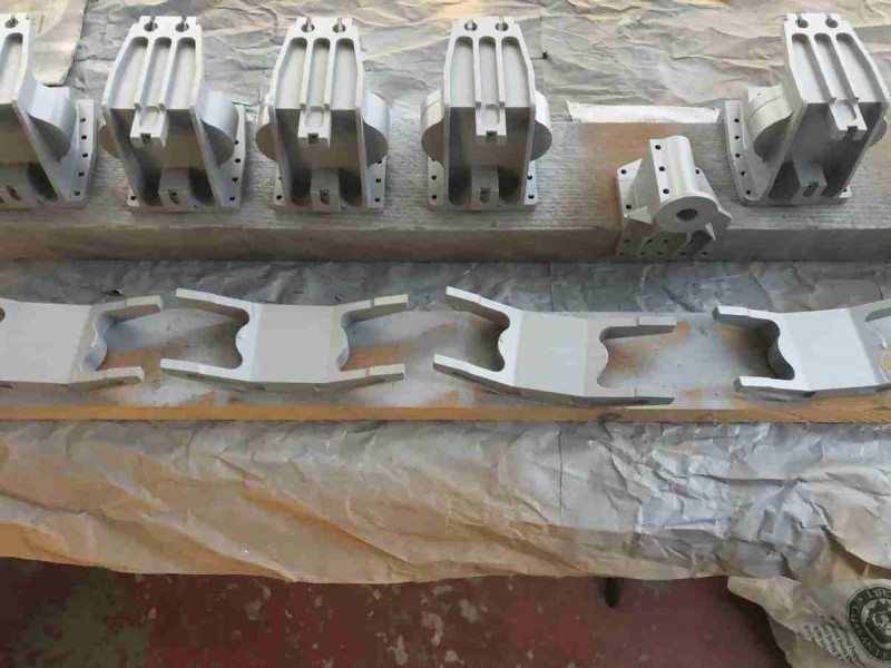

Firstly I removed the primer that had been laid down as I was certain it would not be compatible with the coating system
I'd chosen which was Klasskote epoxy. First their grey primer followed by Olive drab green (#41). After a combination
of sand blast cleaning and solvent paint removal then clean solvent washing I was ready for other modifications and
painting of the suspension components.

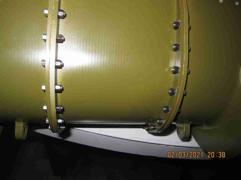

[*] For the transmission/differential housing I increased the countersink depth on the steel flanges so the count-sunk screw heads
would be below the surface of the flange. Hopefully this will allow the cover sections to mate more securely.
For the tow point mount holes I added a counter sink to allow the screw head to 'disappear' below the surface of the interior surface;
really only a cosmetic change- it appealed to my sense of mechanical tidiness.

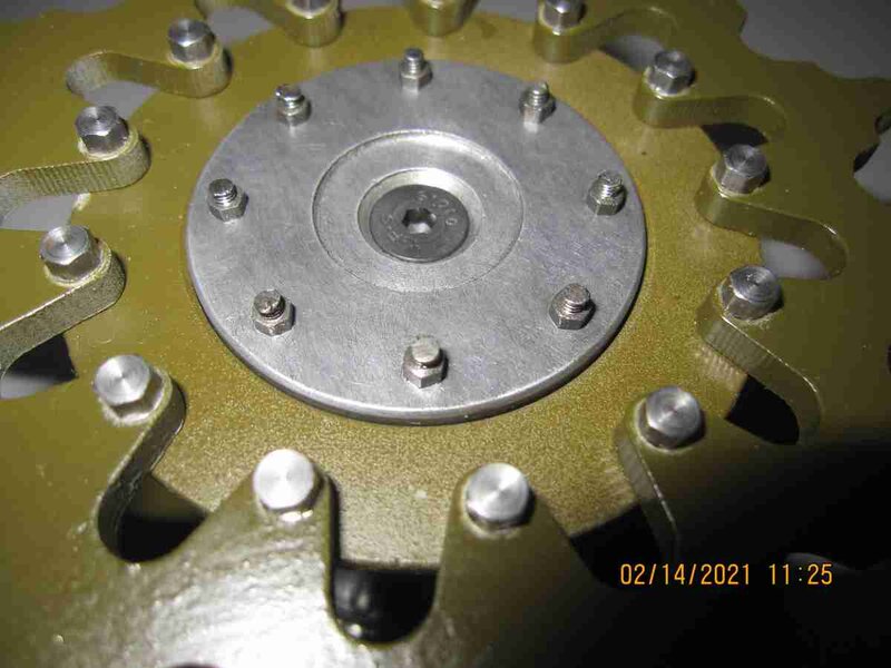

Made new axles for the road wheels that I hope add more of a original look. Made with a proper step to use the OEM nuts and washers on the
inner side; the step being so tightening the assembly will not bend and compress the wheel bracket.[*]
The axles are a compromise, considering the the axles itself is an 8mm rod it doesn't allow for a small_er hex on the end so these are larger than I would
like and still maintain a small circular bearing area on the inner surface of the hexagonal section. There it is.

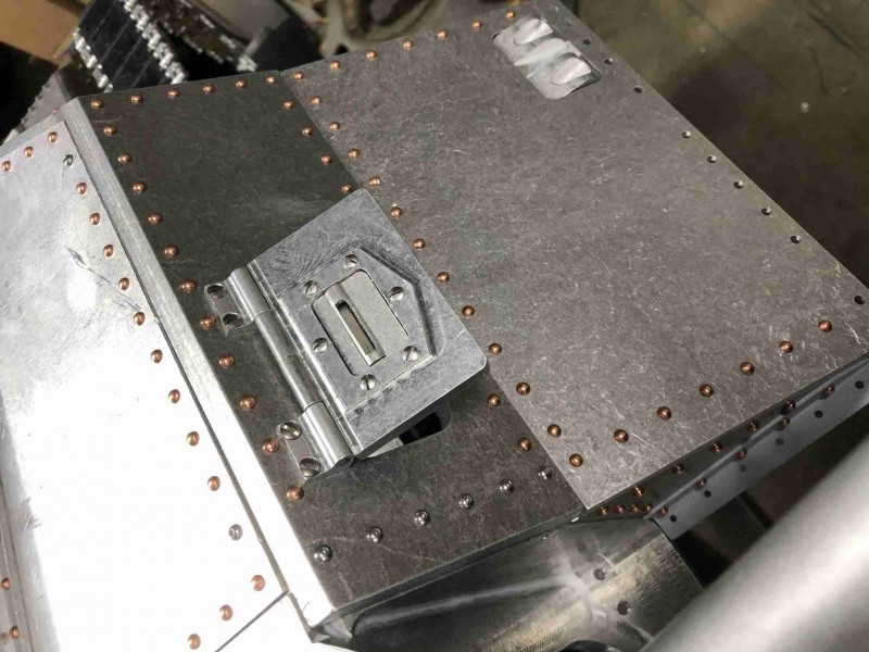

I've been making slow progress on my M3. Partly waiting for parts, screws, rivets, tools and splitting my time trying to tie up loose ends on my 1/10 scale Kaelble truck marathon project.
I'd decided early on in building the M3 that I didn't want to glue in the myriad of rivets. I wanted to compress them akin to the way rivets are implemented. Now I've done a fair amount of ersatz riveting over the years; some cosmetic to fill holes, some functional to actually bind parts together
such as several components of my foundry furnaces and the upper body panels of a 1/10 scale Hetzer. I'd say 90% of what I've done is flush riveting intended never to be seen in the finished product. 3 years ago I also began as a volunteer aboard the USS Hornet museum as a member of the aircraft restoration group: well guess how a lot of aircraft parts are fastened together! I learned about 'rivet squeezers' over there. So...
I decided that I would replace some of the kit's copper rivets with slightly longer ones so I could press them the way I wanted. Long story short I purchased 5/16" (~8mm) rivets to replace those intended for the thicker plates of the M3. I made a light chamfer (countersink) to the rear of the holes
so the compressed rivet would have good purchase and that was my sole prep. After discussing squeezer press options with a fellow Armortek and modelling enthusiast here in the colonies I decided upon an adjustable squeezer and squeezer die set appropriate to the task at hand. Once all of these bit were here at home, which was yesterday in the case of the longer copper rivets I let fly my new tool. After 15 minutes of work with the press I had both lower hull plates fully 'riveted'. I'm now trying to decide if I want to actually rivet the upper hull plates together with functional rivets where practical as I don't see a need to disassemble it once it's completed; my argument being if it were a cast hull disassembly wouldn't even be in question.
My original idea was that I'f file any excess rivet that was in the way on the reverse side but these compress so completely that minimal or no clean up is required; the photos shown are as they appeared after implementation.
Photos follow to document the day's rivet_O_rama...

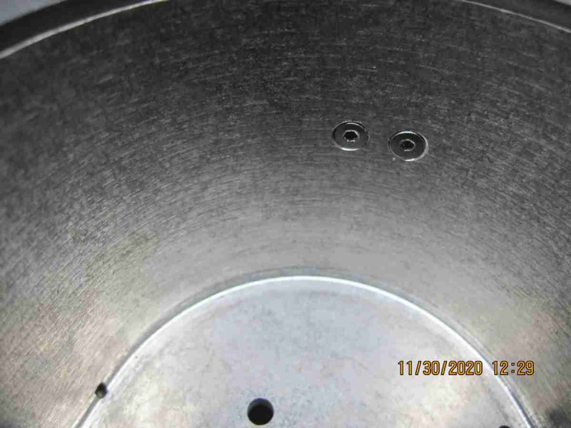

I have recognized for some while that I have an odd sense of which details of a model matter to me. Some things which matter to others don't
trip my radar. For one thing anything that requires me to glue anything on a model just don't grab me. I do like the effect I've seen on others' work
but can never get past the fact that these details aren't really an integral part of the model.
Anyway I ramble. One of the aspects of the models, and this began when I started 1/10 scale are the fasteners. This was probably more pronounced in the smaller scale as appropriately sized fasteners couldn't be had by a quick trip to the hardware store. I was rather forced to purchase from model engineering companies. I became used to and later to insist on proportional hardware whenever and where ever I could manage it.
The M3 was no exception. The transmission housing is just such a prominent feature of this model I had to do something. Here what I have done so far.
I have implemented M3 stainless steel miniature hex bolts from MVD in Germany and steel M3 Castellated nuts from Jürgen Stehr. You actually have to look pretty close even in 1/6 scale but it does make me smile. Chalk it up to one of Jerry's eccentricities. Hopefully after having waited for a while one these (and other) items I will be able to forge ahead and make some noticable progress but I've also realized that I'm just slow - with the demanding schedule of a retireee....

If I were in a race with a tortoise he'd be lapping me by now. I've always been slow at this hobby, well perhaps not for the first 6 months after I got my first larger scale tank so many decades ago. Where's the fire, right?
I'm still turning over in my mind how I want to actually finalize the construction of the upper hull; it's actually sitting with the major bits all connected and the basic lower hull is waiting for a change in the weather in order to paint. This and my other projects allowed me to consider the final drives and idler assemblies where two aspects had caught my eye. I wanted bolts to secure the cap for the idler and outer cover for the sprocket. I realized immediately that the configuration of the sprocket wouldn't allow the same solution as for the idler. I used SAE 0-80 steel hex heads for the idler and for the sprocket I
'fudged' it by using SAE 2-56 screws with recesses machined into the inner face of the cover and 2-56 hex nuts on the outside to secure them. I feel the effect of both of these is rather nice. tapping the 0-80 holes in the idler isn't the most enjoyable way to spend part of an afternoon but the result is worth it. I used a one size up tap drill as there's not a lot of stress here and the prospect of snapping a needle-like tap in these parts didn't appeal to me. So that coupled with some A9 cutting fluid (my go -to for aluminium work), frequent tap cleaning and the job was done.

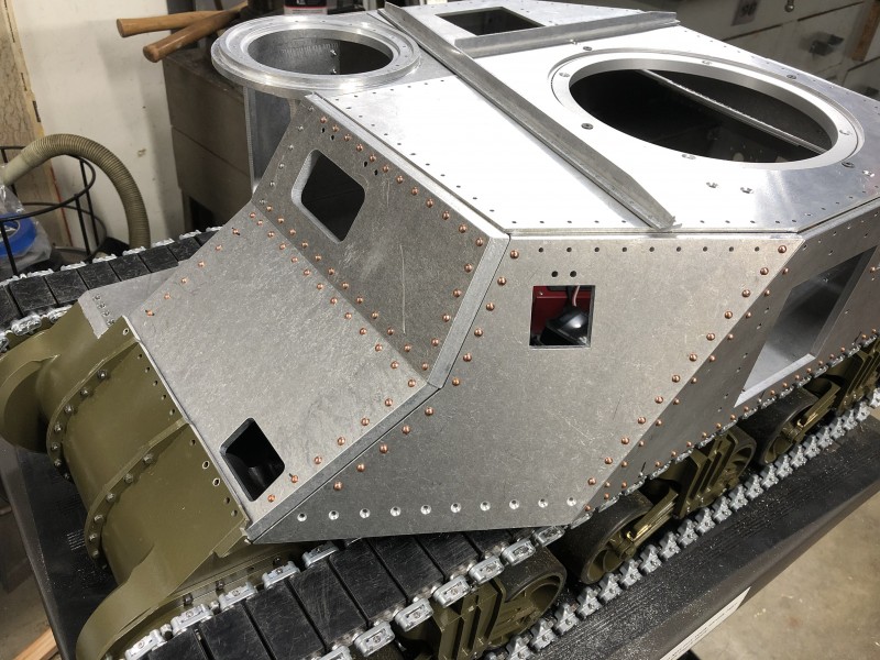

I've made some decent progress on my M3. I'd decided that I wanted to assemble the upper hull using as many actual rivets as possible.
I never plan to take the actual apart once it's together however I want to be able to remove the 'roof whenever needed for easier access
and be able to remove the entire upper in the even that I need to perform major service on the lower. With my smaller 1/10 scale models
I'm used to either cast or fixed uppers that can be removed as needed yet stay in place rigidly.
I purchased a variety of rivet lengths in both copper and aluminum from Hansen Rivets here in the states. So far I've done most every rivet as either a fully functional, structural rivet or a 'decorative' rivet but fastened as a rivet for all but I believe 12 button head screws but only becuase I decided not
to alter the casemate for the 75mm gun/ hull side of the front glacis bracket which attaches to the casemate. I also made my own 'mobile riveting tool
since it wasn't possible to use the above described rivet squeezer. In many cases I used a backing washer to give the inner peined shaft of the rivet proper purchase.
Where screws or bolts were used on the original vehicle of course I will maintain the proper screw or bolt for that position.
It was an interesting exercise to determine the proper order of parts assembly so as not to rivet myself into a corner. Manhandling the assembled upper
hull was also quite the challenge by myself. Happily everything seems to be aligned well enough and I stress tested the upper well enough to prove it's quite strong! I still need to perform a bit of body work to conceal some of the original kit fabrication tooling marks but this is trivial.
Not perfect but I'm happy with it.. Be kind... Looking forward to taking this out on my newly revised proving grounds, previous tests showed that the model is unkind to closely cropped weeds....

Looks so good Jerry. Just wonder how many rivets are needed in one M3 tank ?

Have made progress on the M3. I'm slow at the best of time but the more photos I examine, other build threads I read the more I say "I want that!"
But what I want even more is not to spend 5 years on one model!
I appreciate the nth level detail when I see it but seldom have the drive to execute it, plus if it entails gluing something I'd prefer not.
Still other things just bug me and I feel compelled to change them, to make the model 'mine'.

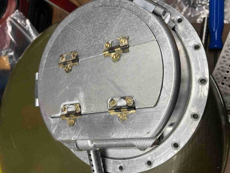

I spent entirely too much time on the rear stowage boxes, riveting the tiny hinges on to the basic boxes that I'd silver brazed to seal them up
plus making hasps for same. Seeing the the commanders cupola hatch wasn't what I wanted I made a new set of those parts. I'd vowed not
to make my own hinges for any of these things but spent more time modifying the kit supplied hinges than what I likely would have done had I made my own. I think I'll cast new ones 'down the road a piece' but for now the modified ones will serve. I modified the stock hinges to allow use of SAE 0-80 flat screws- I threaded the parts carefully so as not to need nuts that would take up space; need to fill original hole at the front top of cupola.
Riveted the filler caps part together, shaped and textured a bit with JB Weld ( a glue!) and plan to install retaining chains on the locking pins.
When riveting the upper hull together I replaced the aluminum bars intended for the upper hull sides and read plate where they connect to the roof with thick aluminium angle. I did this so I could make the roof detachable and yet rivet the angle pieces to the hull sides. Makes for a fairly robust structure.
I've now got all the bits lined up for this model, having just received the recoil parts so I'm hoping in a month this construction will be mostly complete.
After that I will need to decide which of my kits I should build next!

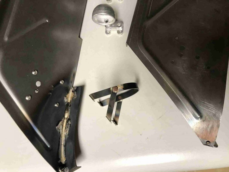

- Brazing the front fender pieces together
Brazing the brush guards together
Modifying the lamp bases
Making a sort of hasp for the side access hatches
Making an approximation of the front glacis ProtectoScope
Retaining chains for the filler cap pins.
