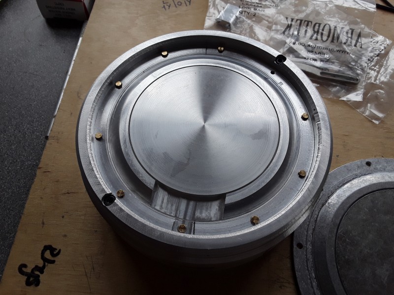

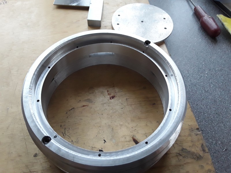

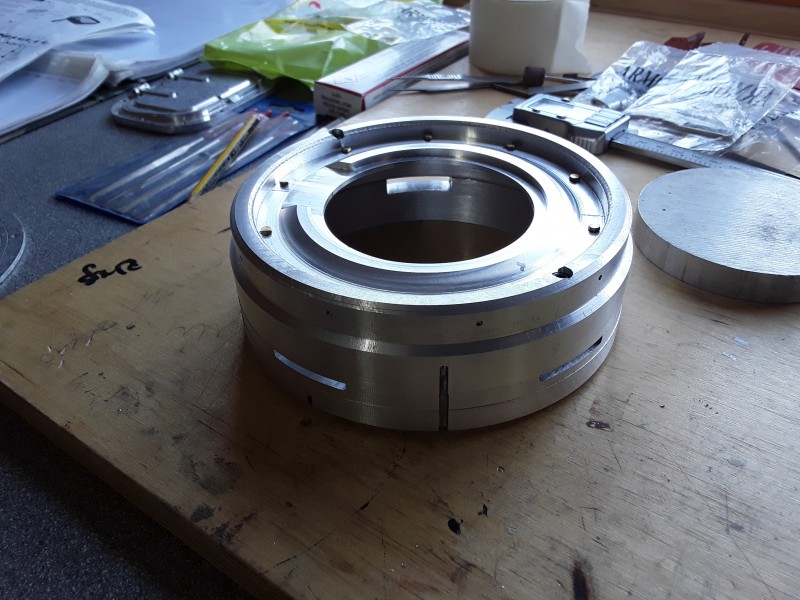

I have made the decision to try and upgrade the cupola as I know it would annoy me everytime I look at it if didn't. So using the two main parts from the kit as the starting point then first thing to do was to reduce the diameter by 7mm for the main body from 152mm to 145mm and the upper ring to 140mm. This part was straightforward as I could hold the parts from there inside diameter in my 3 jaw chuck on the rotary table.

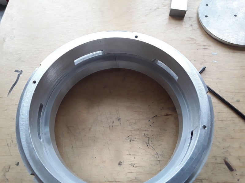

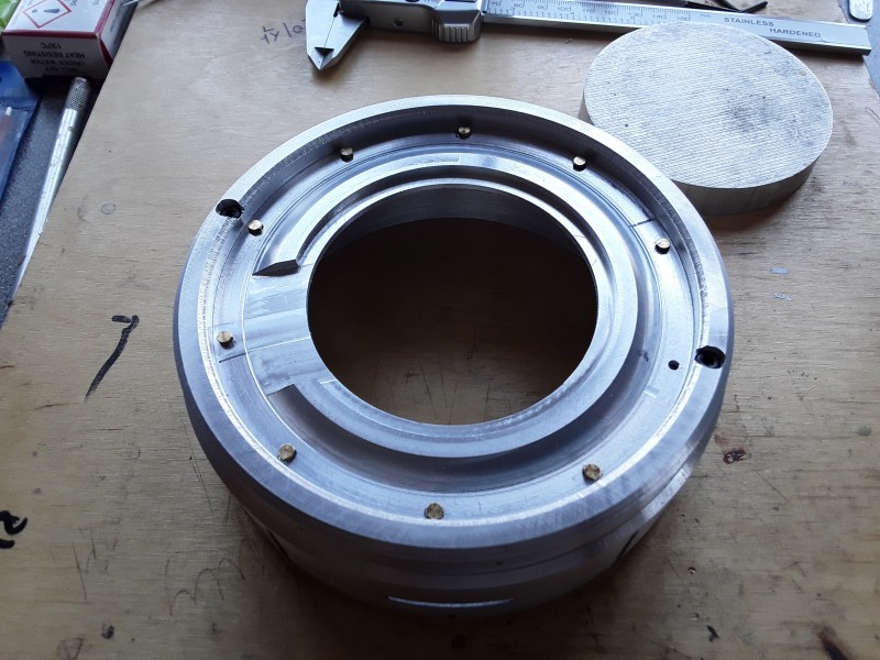

The next part of the upgrade was a lot more difficult to do as I could not fit the large round 150mm billit needed to make the insert ring to get the right internal measurements. So to get around this problem I had to drill out the centre by hand and use a hacksaw for the rest, then clamp it on the rotary table and machine 3 points to clamp it in the 3 jaw chuck this took all morning to do.
Once I had this billit in the chuck it was straight forward to make the part and fitted inside the cupola perfectly, I was one very happy chap.
As I have now destroyed the fixing position for the cupola to the turret roof I have drilled and tapped some fixing points to flange that sites down into the turret roof and will fit some small plates to grip under the roof.
All the measurements that I used were from David Brydon tiger tank website so a big thank you for the info.

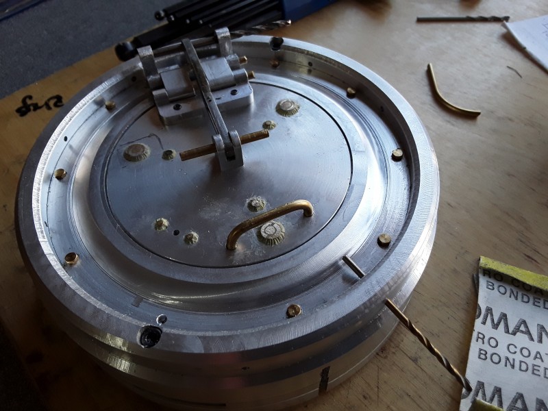

It's been a while since my last update, most of the time I have just been tinkering with the cupola hatch trying to make work properly because the hatch is 5mm smaller in diameter than the original armortek part. It has taken me a long time to make the new hatch and this has given me new prospective of how complex and over engineered the tiger 1 is (that's my opinion).
I have drilled the drainage holes for the cupola at 20 degrees and 2mm in diameter also repositioned them either side of the vision ports. There are a few more bits and pieces to make and then the cupola will be ready for painting
