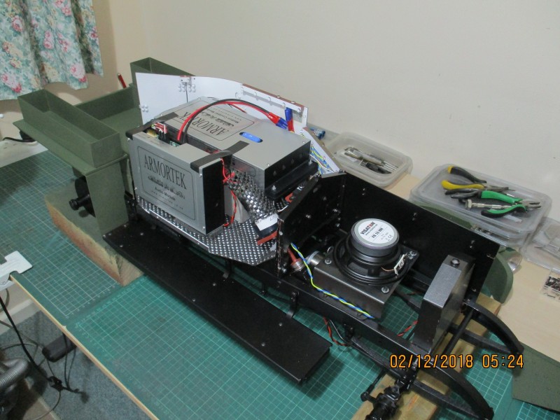

Morn'in, a bit more tinkering. I located the speaker in the engine compartment as I will not be building the RR engine, loads of space.
I fitted the 'steering motor' and being aware of the instruction, 'great care must be taken to ensure that the steering box is free running' ..etc,. etc,. I slackened the mounting bolt/bracket holding the drive motor, thus allowing the whole shebang to settle and align itself. Suffice to say it worked a treat. O for a few more years to build these lovely kits....

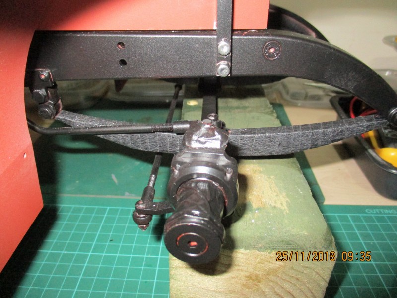

Good morning everyone, dull and drab though it may be....this is my small contribution to authenticity, wrapped my ' leaf springs' in my ladies, leftover, flower arrangement tape....
..Mick
Re: Mick's Roller
That's a nice touch Mick what colour do you have planned for the under carriage?

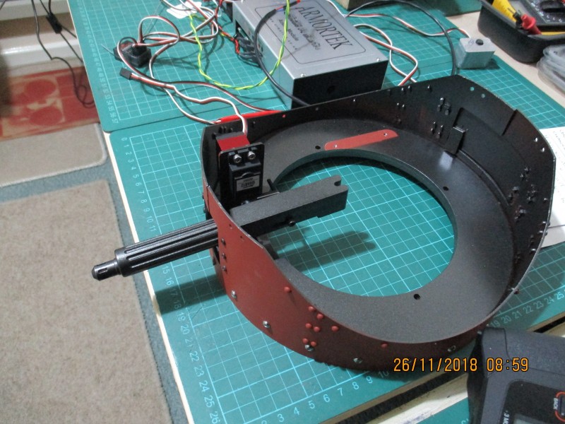

Hello chaps, I have begun the strip down. it is so much easier to paint if the parts are removed first. I am pleased with the Rolls and since picking up the build I am well satisfied....almost didn't get there. I posted one or two photo's, more as a reference for myself...thanks to everyone who 'liked'...Mick.

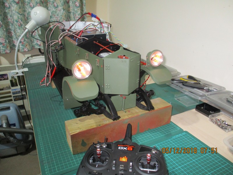

Re: Mick's Roller
Hello everyone, the motion and audio units fit snugly within the Rolls Royce main body, the wiring will be tucked away later. I have tried using different switches on the transmitter, for both head lights and radiator doors. The rad doors look better using a three way switch rather than a proportional switch, it's just my preference. The 'yellow' headlights look fab and suit the model well...Mick.
