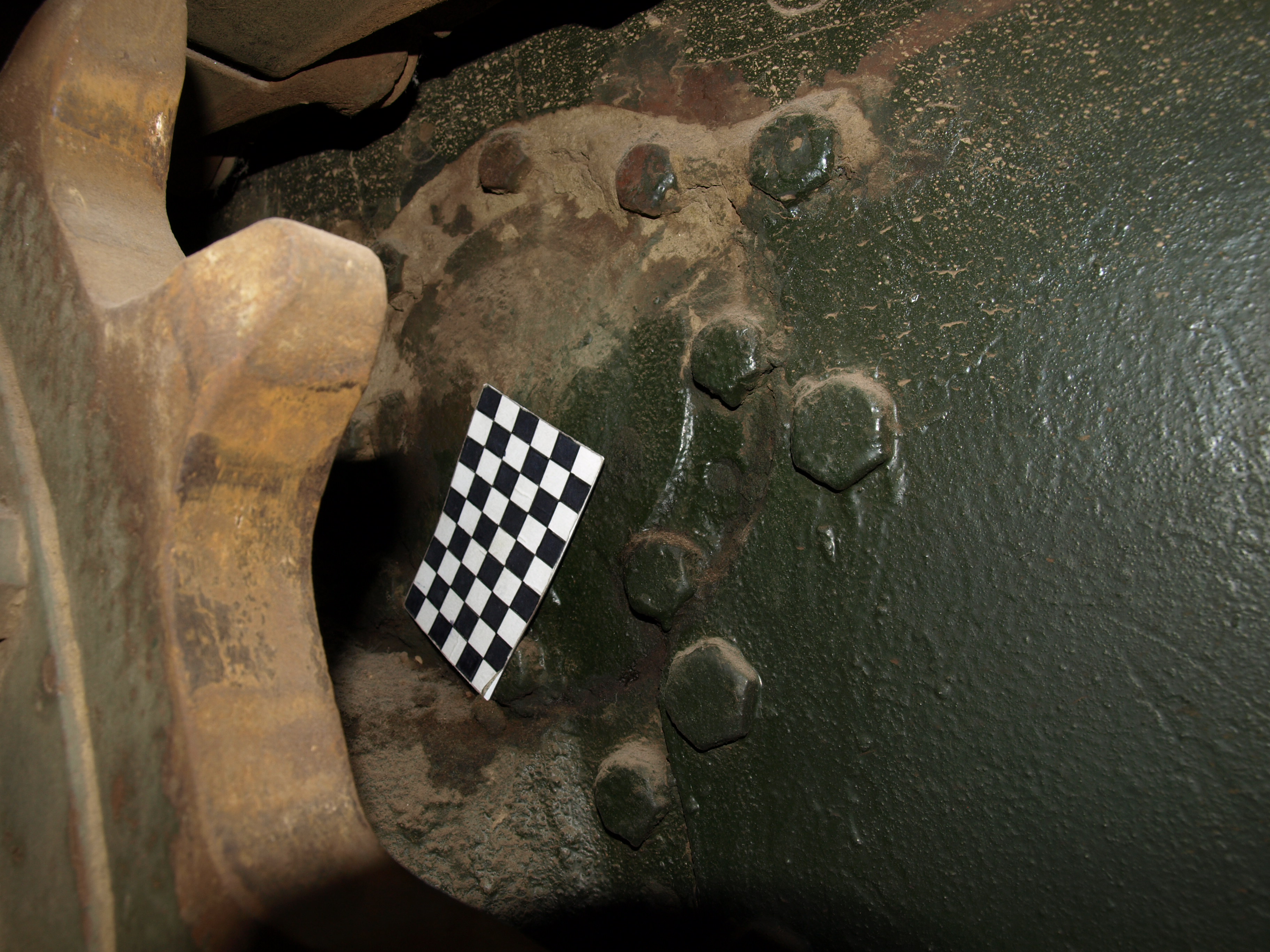

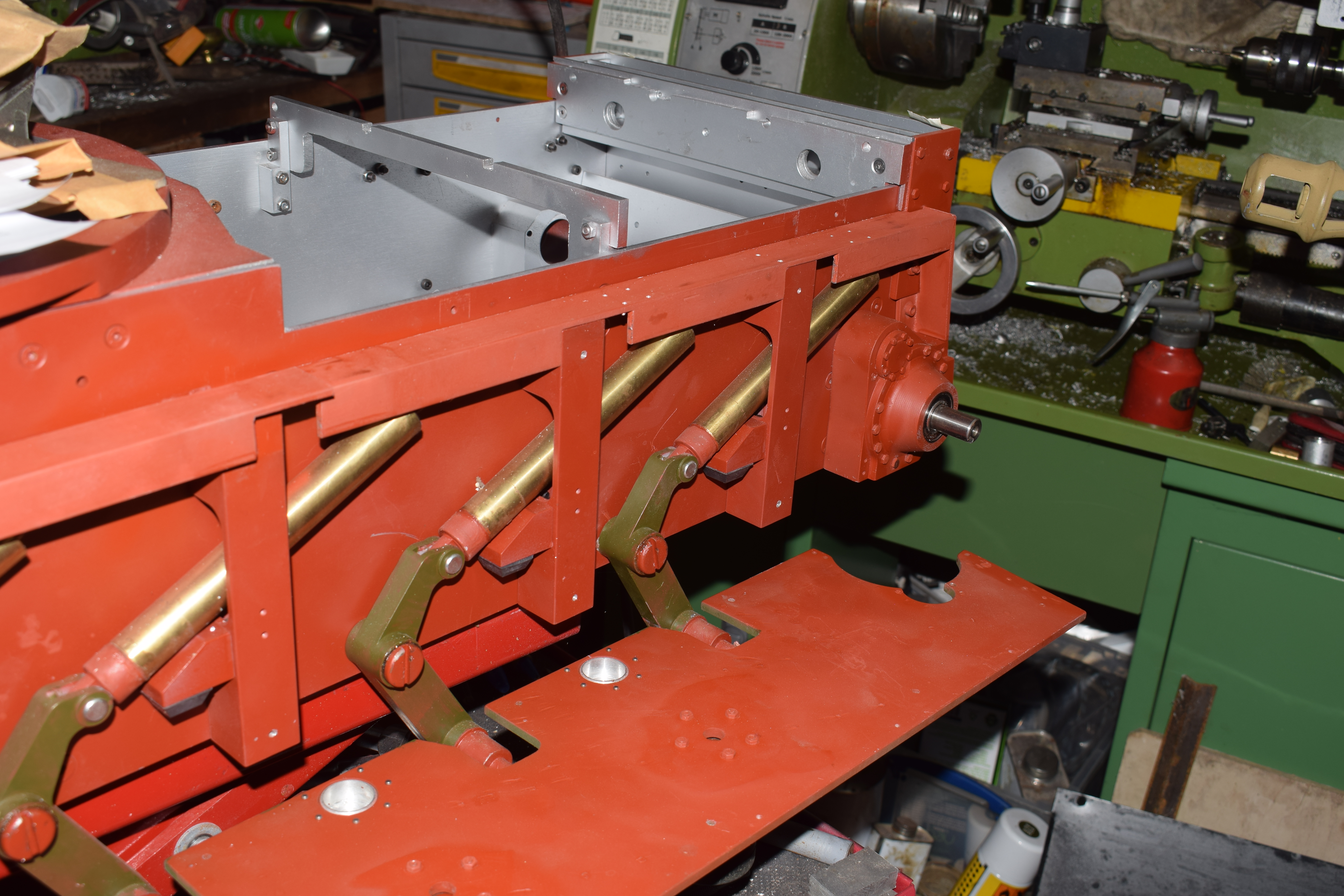

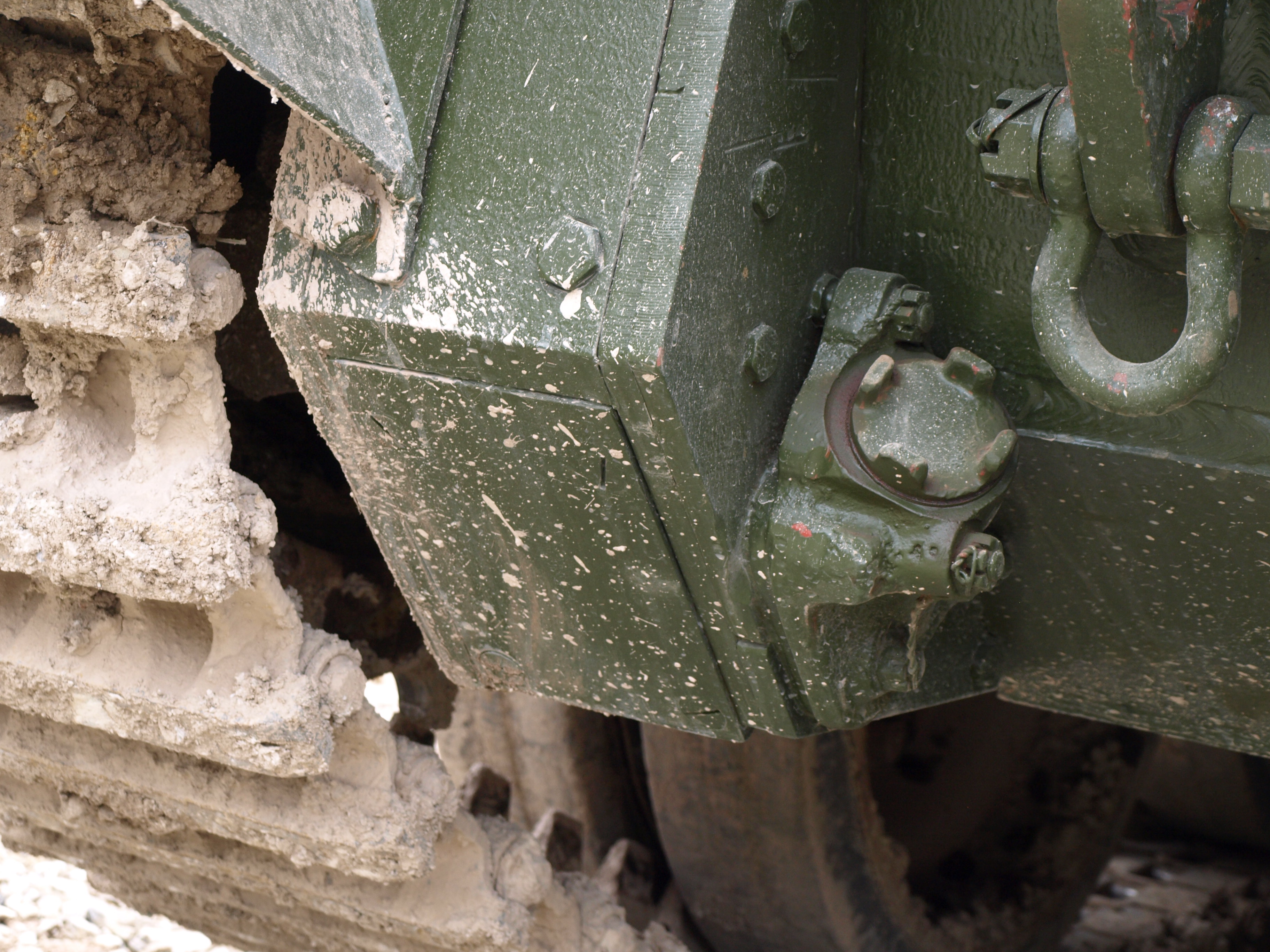

Stephen White spotted the cover plate lurking, nearly hidden, ready to cause angst. I have chosen this picture to be my prototype, it has a simpler profile to reproduce.

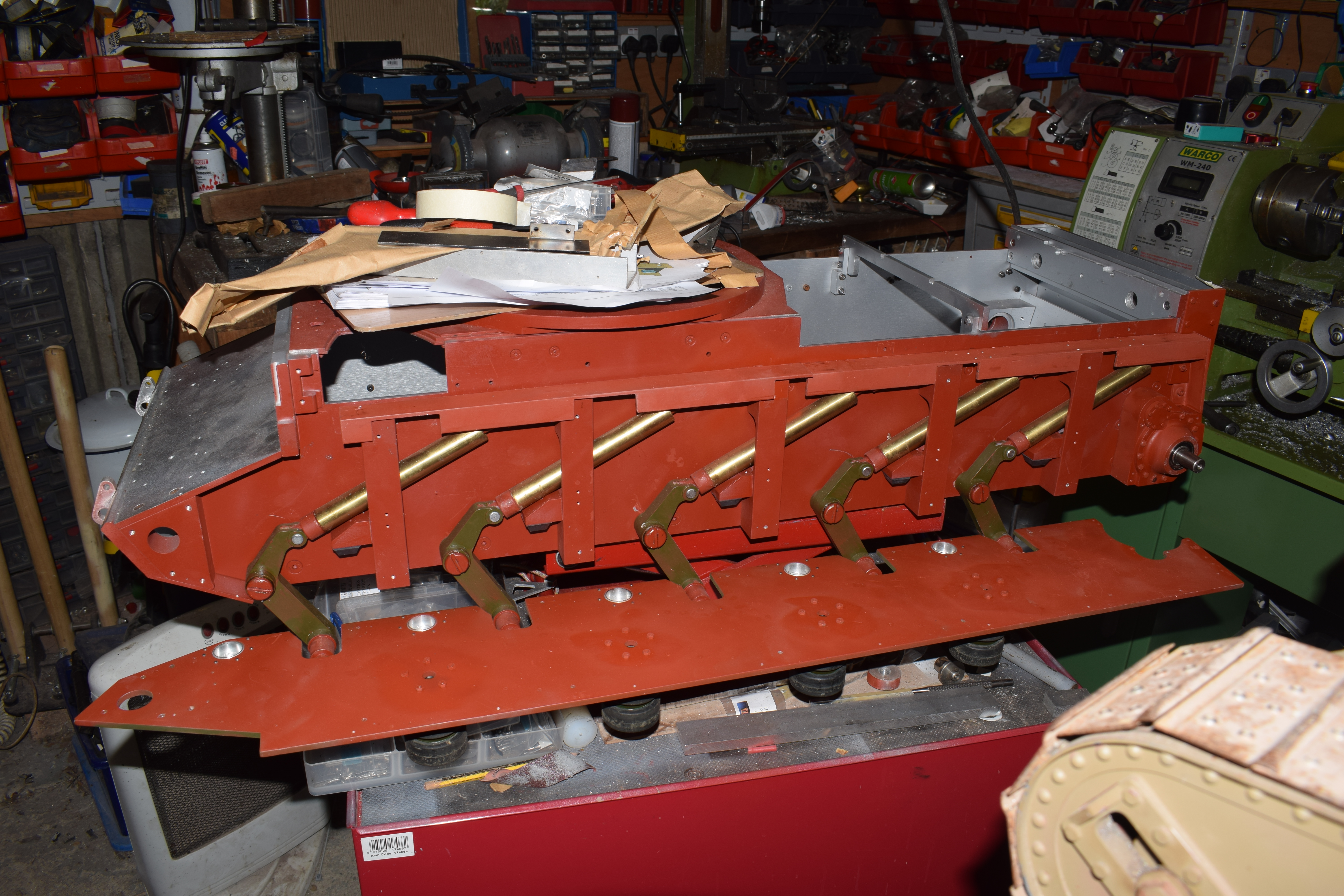

These are the finished items fitted in place, so the side plates are now nearly done, waiting to be installed.
So time to clean up, tidy up, and get the Red Oxide out!Steve

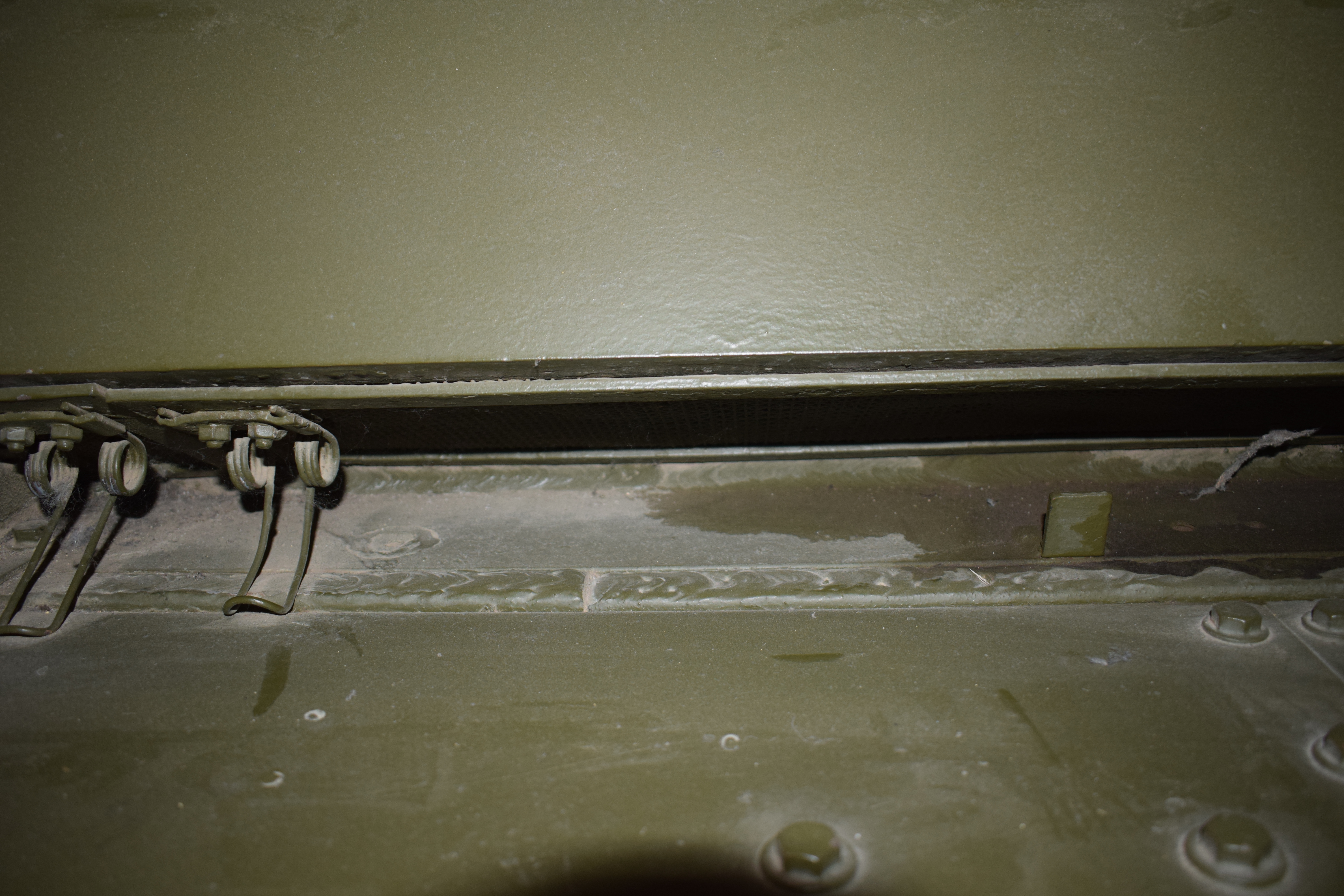

It is peculiar how a detail that you have never noticed before suddenly becomes apparent. The Comet at Tank Fest made it so obvious and I cannot avoid it.
I am now waiting for a delivery of bolts from Knupfer so as to start bolting things together, hopefully early next week!
This is how I have replicated these plates with their counter sunk bolts
This was done by skimming the edges to replicate what I can see on the TankI am now waiting for a delivery of bolts from Knupfer so as to start bolting things together, hopefully early next week!

Re: Comet No 34
Highlighted by the mud I would say

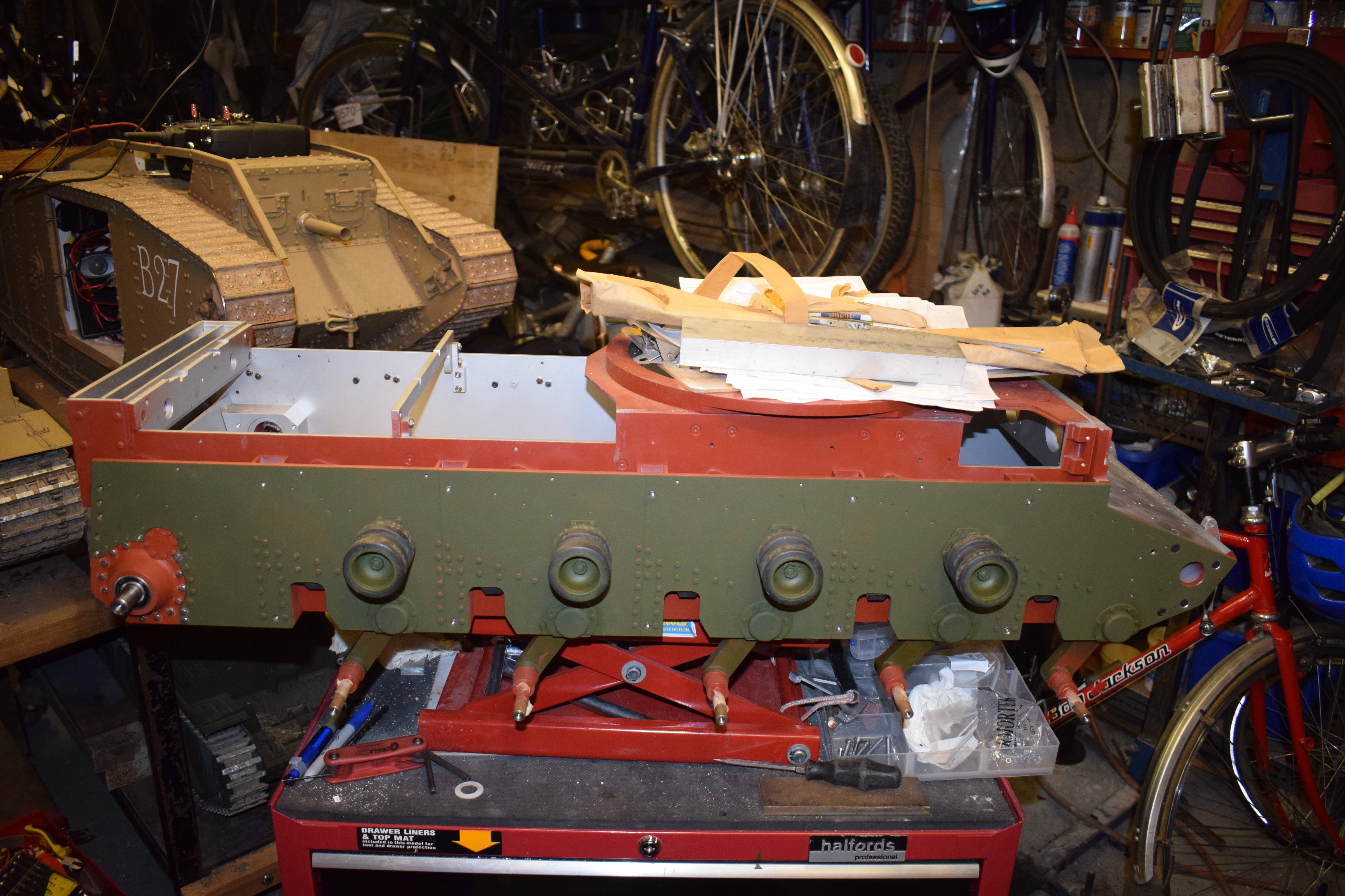

Re: Comet No 34
Side plates on, with countersunk attachment bolts left clear so that they can be removed for servicing.

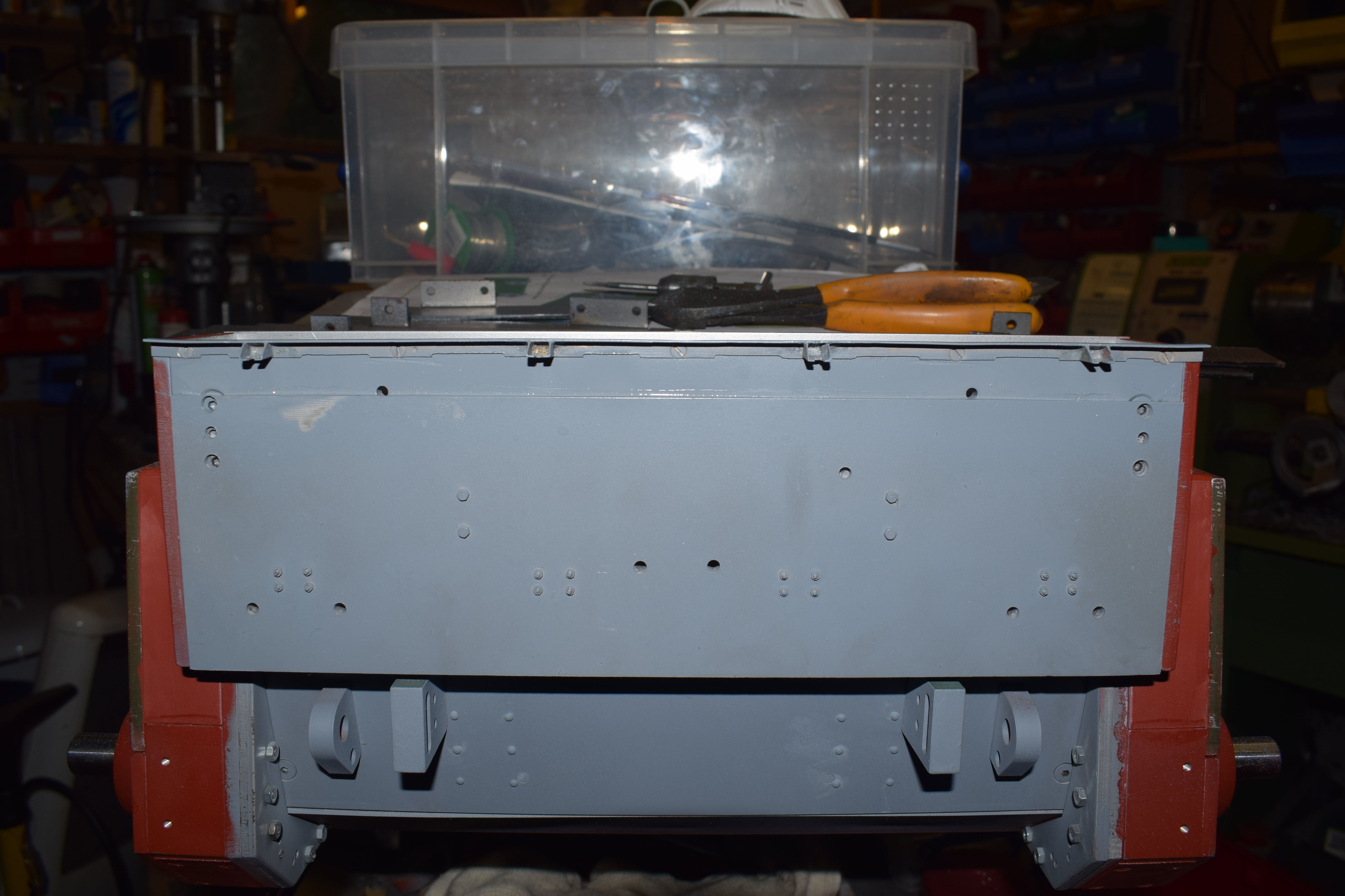

Life has a habit of slowing things down, I have been tackling the rear plates. The major thing was to duplicate the Cromwell derived rear plate that has no exhaust holes, install the bolt heads for other details. The other issue was to replicate the angle iron that is welded to the top edge which has the retaining lugs for the Exhaust Cowls.
Job nearly done: The question now is fabric paint or Milliput for the welds? The ancilliary is what make of fabric paint and where to find it?

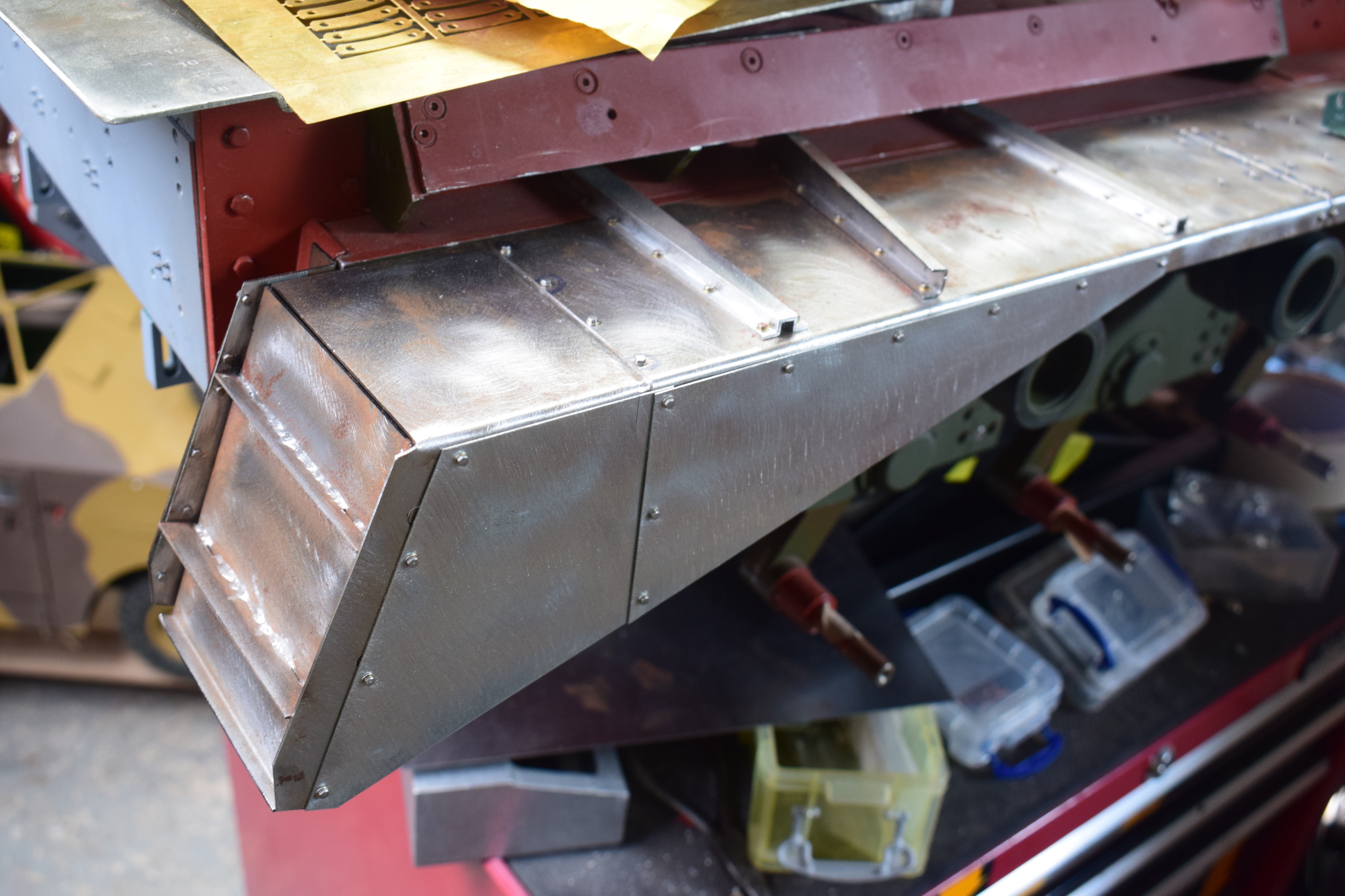

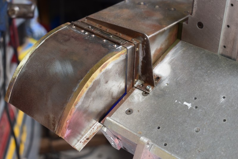

Well one Comet post deserves another! Mudguards have been entertaining me for a while. I thought the side plates had enough bolts, but the mudguards have involved a whole load more.
I hope to move on the wheels, and drive sprockets, necessary to do before fitting the mudguards for real.
The front had new full width hinges and then remodelled arms, now with two sides. The forward part had the 'angle iron' edge fitted to it.
The rear had the side plates added and then the steps on the rear of the mudguard remade and soldered in place, all fun and games, but worth the hassle as it now avoids the bolts! I will be forever grateful to Derek for telling me that steel can be soldered.I hope to move on the wheels, and drive sprockets, necessary to do before fitting the mudguards for real.

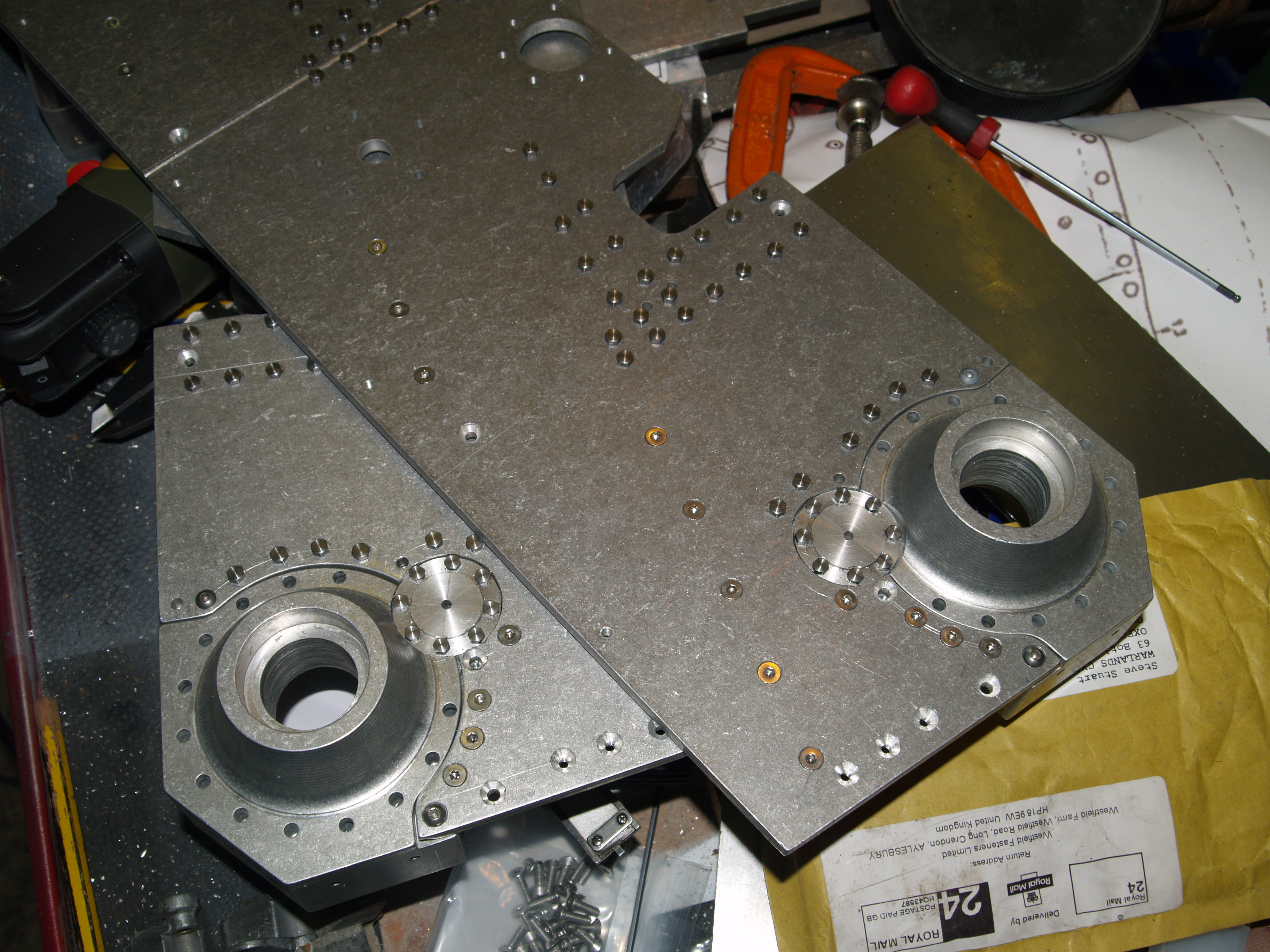

Re: Comet No 34

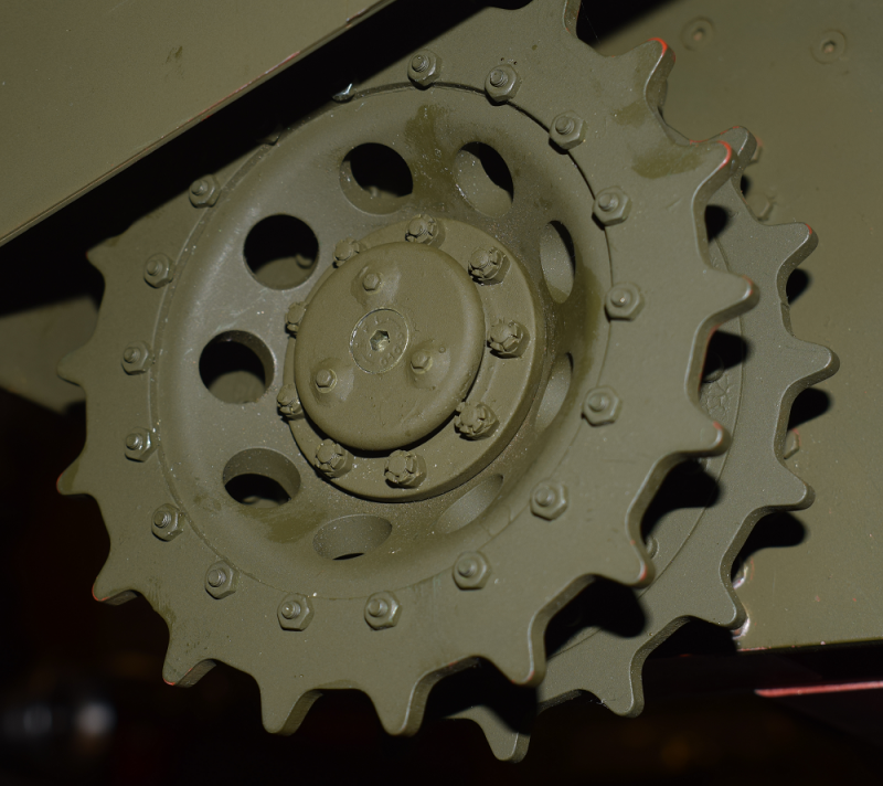

Mudguards nearly there, but the drive spocket centre cover needed tweaking to have the three securing bolts, but practicality means that the 5mm cap head bolt is replaced with a counter sunk bolt that is seated on a plug to ensure the head sits at the correct level. The shape is not quite convex enough on the top, but at a glance it ought not to worry too many people too much!
