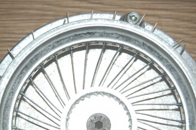

OK, I made amistake with the wheel, Here are a couple of Images of the single wheel I have started.
Can anyone spot my error please? I thought I had done it right, put a spoke in and move it to the third hole along in the outer rim.[img
][/img]

Spokes look bent... and like too many of them in the same direction.
I can't say for sure as my kit has not arrived... but I've played enough with the 'real' 33 x 5 Dunlop rims that this looks like you have way too many spokes in one direction and that there should be no bends in them.
Wheel lacing is a bit of an art. In real size... and especially in miniature. Pochers were tough. Even the ScaleLink kits are difficult to get right. But I am willing to be the Armortek instructions are good. Just count to 10... and it will come together.

Kiran recommends that you finish off the spokes in one direction before starting the other.
Must admit there are 'bends; in the spokes, that is a result of placing one in the hole of the inner rim and moving it into a hole in the outer rim. Then a ferrrule is place over the end, pull the spoke tight and super glue the ferrule and spoke together.
Couldn't quite get the pull to straighten it while the super glue set.
I've got some super glue debonder on the way, next time I assemble it I'll try pre bending the spoke so that the head sits flush with the inside of the hub.
