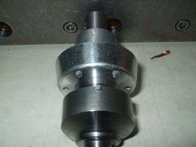

Managed to find something else to do. I have test fitted the idler tension mechanism. Needed the usual deburring and also had to refresh a couple of threaded holes. There is an end-float in the idler shaft of about 1mm. I could eliminate it but something tells me to leave things be. I added some miniature adjustment tabs as per real thing.
Glued them with JB Weld. Had to use a tweezer and magnifying glass! I guess it's an age thing.

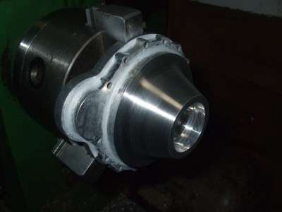

Also had a go at the idler tension covers to remove the ridges on the tapered part.

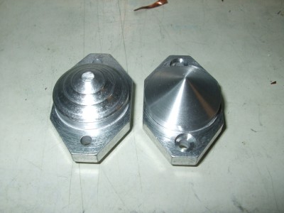

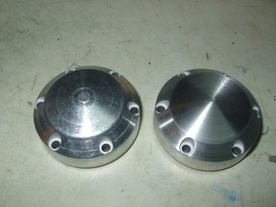

In the meantime, I am still playing around with the idler components. Cleaned up the casting ridges on the idler hubcaps on the lathe. I will be changing the fixing bolts for this component from 3mm cap screws to 3mm hex with a one size smaller head.

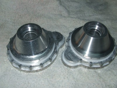

All the idler components have been etch primed and put to one side. Started the clean up operation on the drive cases. Removed the light machining marks from the tapered portion of the drive cases. This time I put it in the lathe and used sand paper to do the operation. It did not take long.
Deburred all the edges and test fitted the bearings and the geared drive shafts. Even a minute burr will not let the bearing or shaft fit properly. Masked the cases and will etch prime them next.

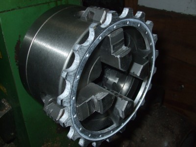

Cleaned up the sprockets. Used the same method as for the idler. Had to use the 4-jaw chuck as the 3-jaw was too small.
Used the 4-jaw chuck to also create a light chamfer on the sprocket ring teeth.

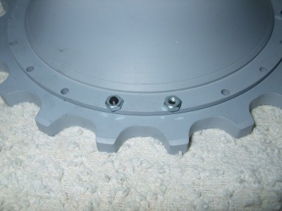

Nipped for a short while to the workshop. The idea was to temporarily fit the sprocket rings to the sprocket assembly but ran into a minor problem.
The screw on the right is the specified length screw for the inner sprocket ring. It is a bit short. On the left is a 10mm version of the same screw which looks better. Not worried as I was going to change these screws just the same. As I am progressing I am changing to stainless steel hardware.

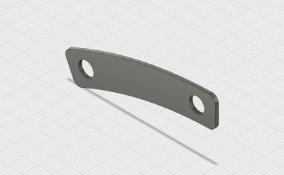

I also had an idea of using lock tabs for the inner ring just like the outer ring. I have to try and making these extra tabs myself. Buying two photo-etch sheets for just these tabs does not make sense. I could also use washers with lock tabs (these are seen on some real sprocket photos), but using two different locking systems on the same sprocket assembly would not look too good.

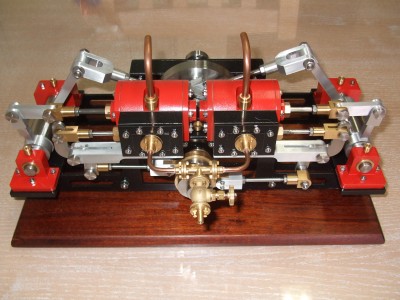

So, instead, today I finished up my previous project which just needed a wooden base. At least now it is in it's proper place at home and not languishing around the Armortek boxes risking getting damaged.
What size is specified in the manual, as the 2010 Mid Tiger manual I have here gives the sprocket ring/tab bolts as being "M2.5 x 10 CAP" ?
I know your picture was a mock up but the Bovington Tiger has the nuts on the outside.
- Has liked: 794 times
Adrian, just now had another look at the manual and it is specifying M2.5X8 Button.
In the meantime drew up the tab.
The idea for the moment is to print it out and then glue it to a thin brass sheet, drill the holes, and cut with scissors. Don't know if it will work out though.

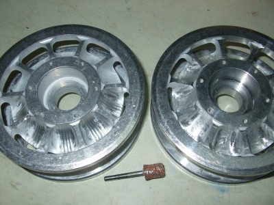

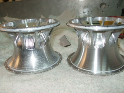

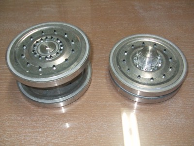

Still babysitting the cats here but the wife should be coming back this afternoon. Yesterday I went to the workshop and brought home enough parts to do a trial assembly of the two types of road wheels.
Built them up exactly as shown in the manual to see what modifications, if any, can be done. First thing that came to mind is, as these wheels are interweaved, is there any possibility of mounting them on the swing arms fully assembled. From the looks of it, it might be very difficult to do it but if there is a method of doing it, I would love to hear about it. I then had a look at Tim Bowman's build where he describes a method with the outer wheel of the wide axle fitted at a later stage. There is also a mention of Steve's method but this one I could not find.
So what's the easiest way of fitting these road wheels to the swing arms?
