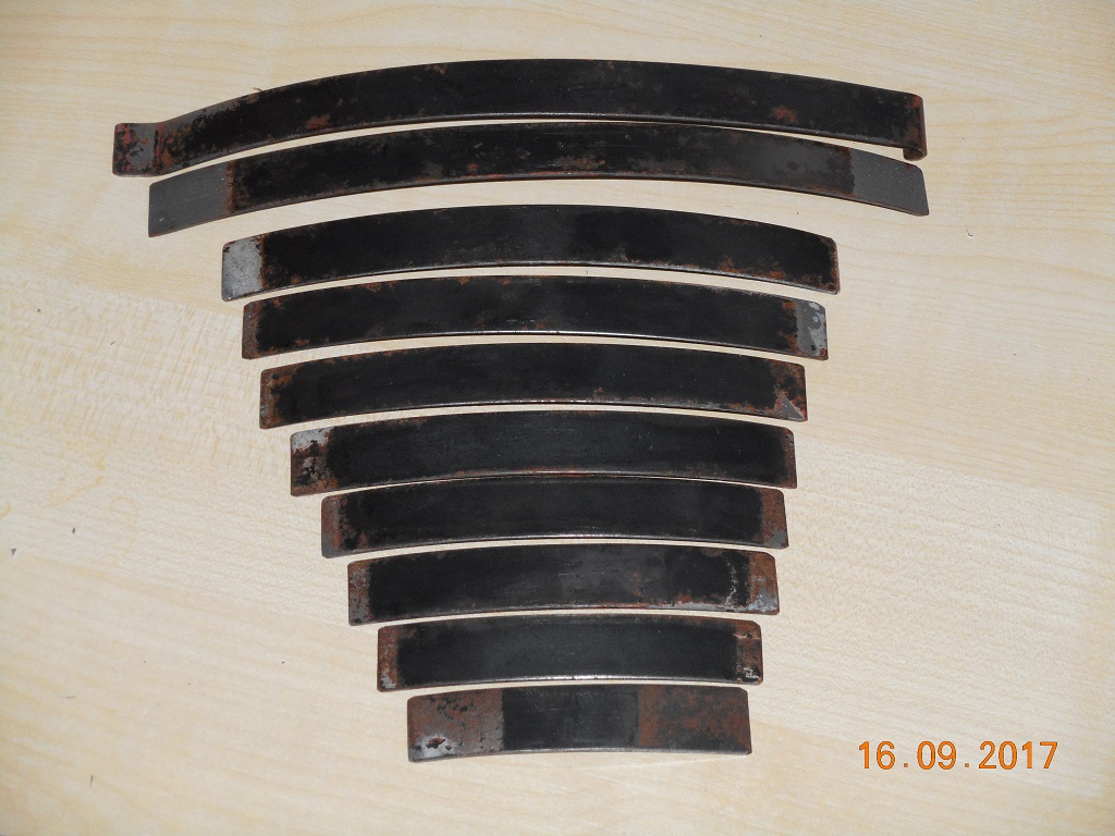

What have people done in the past to protect the leaves of springs on the Sd.Kfz half tracks, and more recently the Quad ?
The Sd.Kfz 7 I am rebuilding has quite a bit of surface rust on the leaves, especially on the ends:
I wonder if a layer of PTFE dry film lubricant would provide sufficient protection.

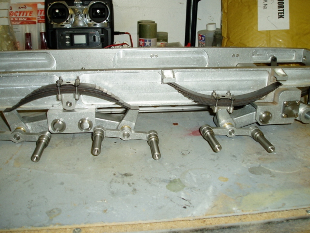

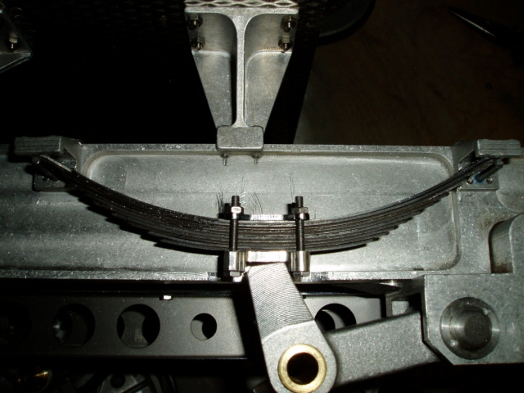

Just as Peter has said, I just painted the ones on my last Sdkfz 7. One other thing to think about when installing the springs, the smiling set (the one on the right in the photo.) frustratingly fall out of place when you pick the model up or when the tension is taken off suspension.
I fitted a second pin, off set enough to allow the spring to slide through, but it can catch it when the load is taken off.
