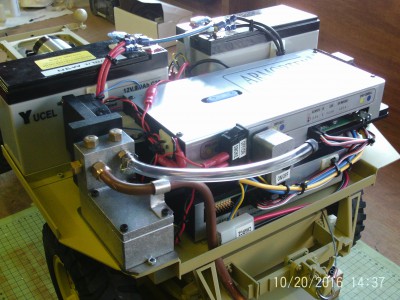

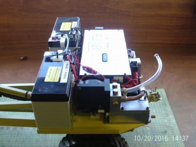

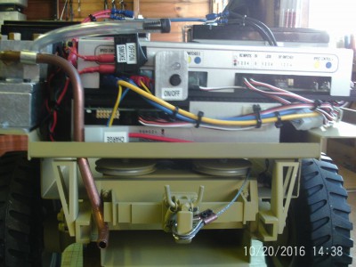

couple of pictures of the yucel Y9-12 batteries and electronics fitted, its a tight fit, made a few modifications to the smoker mounting, the lower rear outside mounting plate filed the corner off so I could move the smoker as far back to give a bit of room between the fan and battery, you could just angle the smoker if you wanted, made a mounting bracket to secure the exhaust pipe to the flange fitting on the smoker, make sure you drill the hole in the correct place for the exhaust to go down and clear the chassis rail and body bracket, also drilled and taped a new filler hole in the rear of the smoker, if I did this again I would angle this hole up slightly to make it easier for the fluild to flow in to the smoker body, I made the large access panel in the rear of the body so it would open so I could gain access to the power button/charging lead/smoker filler tube and smoke on/off switch. in the last picture note where the loom goes between the chassis rails and up in to the electrics tray, if you go in front of where it is it will foul the body when you fit it, just make sure the wires are away from the winch drum, hope this info helps others.

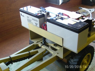

I had today some time too fit my battery these are lifepo4 headway 15 ampere i have not orderd the elektro from Armortek so i have more room in the back.
With Regards William

Re: Morris Quad Batteries
That's a tight fit
It should last for ages though, as I use exactly the same ones in the T-34, and the Quad only has the one motor.
Where have you placed the BMS board ?
