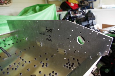

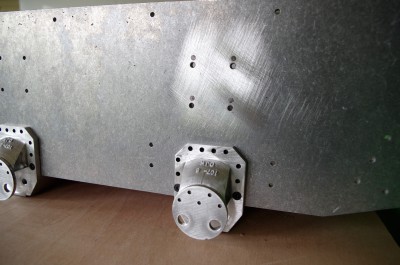

I have made a start and this is my first go at uploading some pictures so I will hopefully figure it out!
I have added some letters to bogie arm and lowered the last return roller.
Sorry about the nautical markings but that I understand!
Armortek instructions are not exactly highly detailed but as they say "measure twice and cut once" really does apply!

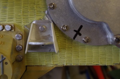

Been in hospital for a new knee so not much time for tank building lately but
trying to resolve that now!
Extra detail being added lettering and numbers, bolts, tab washers to lock bolts. Bump stops cut and replaced with plastic card. Zimmerit. Idler bolts changed for round head.
Extra detail being added lettering and numbers, bolts, tab washers to lock bolts. Bump stops cut and replaced with plastic card. Zimerite

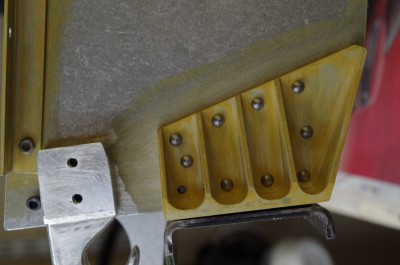

Nuts on drive wheel housing changed to castellated by cutting 6 slits in the nuts with a dremel. Tedious and not easy!
Has liked: 1495 times
Been liked: 1699 times
Re: Paul`s Panzer iv build (001)
That sounds like a good way to break a few windows :!: :shock: :!:
They look good though :D
