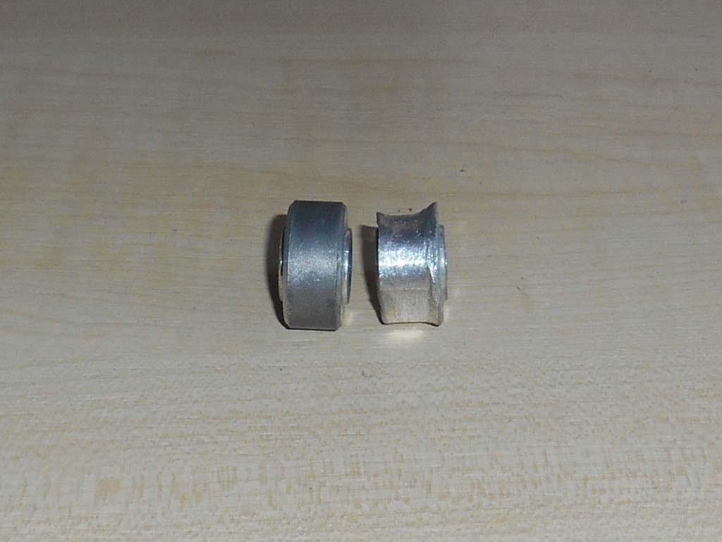

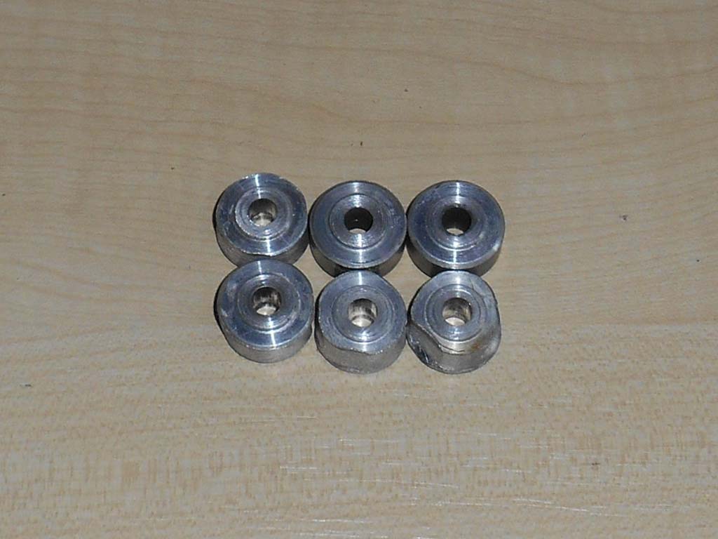

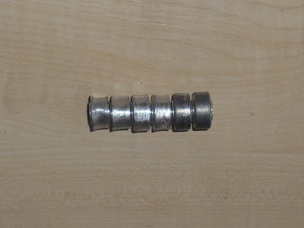

This is what happens when they stop going round:
You can certainly tell the two which were still rotating.
From the witness marks on the pins, it would appear that the rollers were stuck on the pins, rather than there being debris around them. There was a certain amount of grass but it pulled out easily and wasn't jamming any of the mechanism.
Fortunately, the engineering department :wink: chose a soft grade of aluminium for the rollers, making them sacrificial, thus saving the more expensive track links from excessive wear.

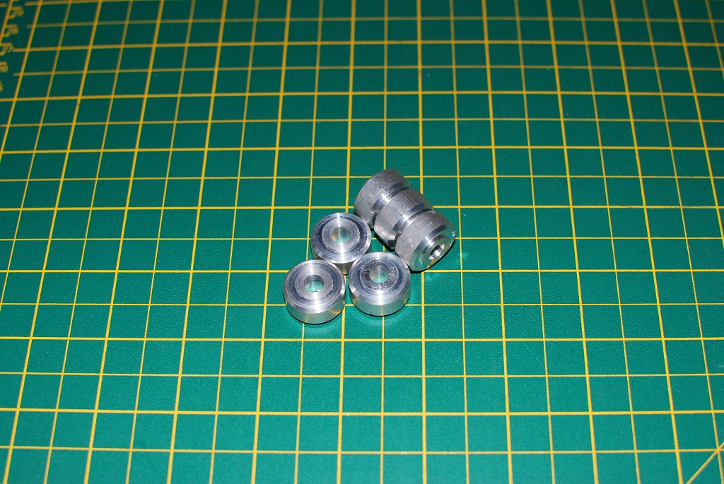

So, rather than get new steel rollers from Gill, I decided to see if I could use the CNC lathe to produce some new ones. After some assistance from Mark regarding material choice and machining speeds, and quite a few 'dummy runs' :oops: I've finally produced two complete sets for the T34 demonstrator.
These are the new rollers:

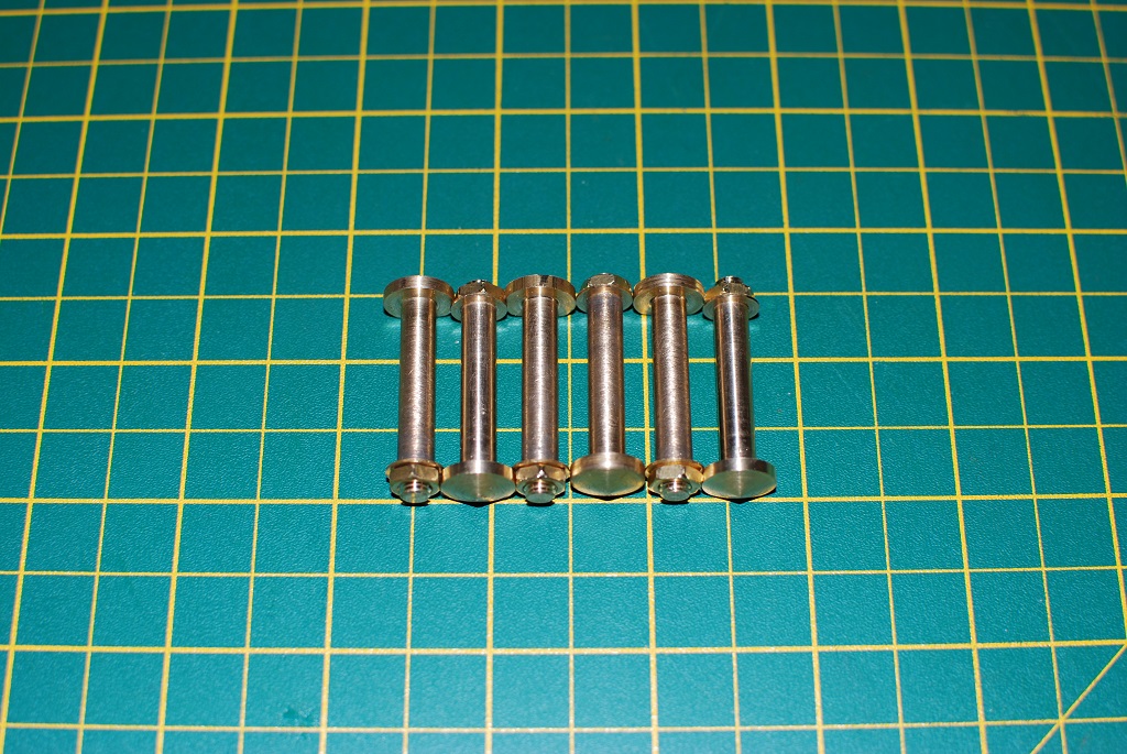

The replacement brass roller pivot pins, with coned ends:

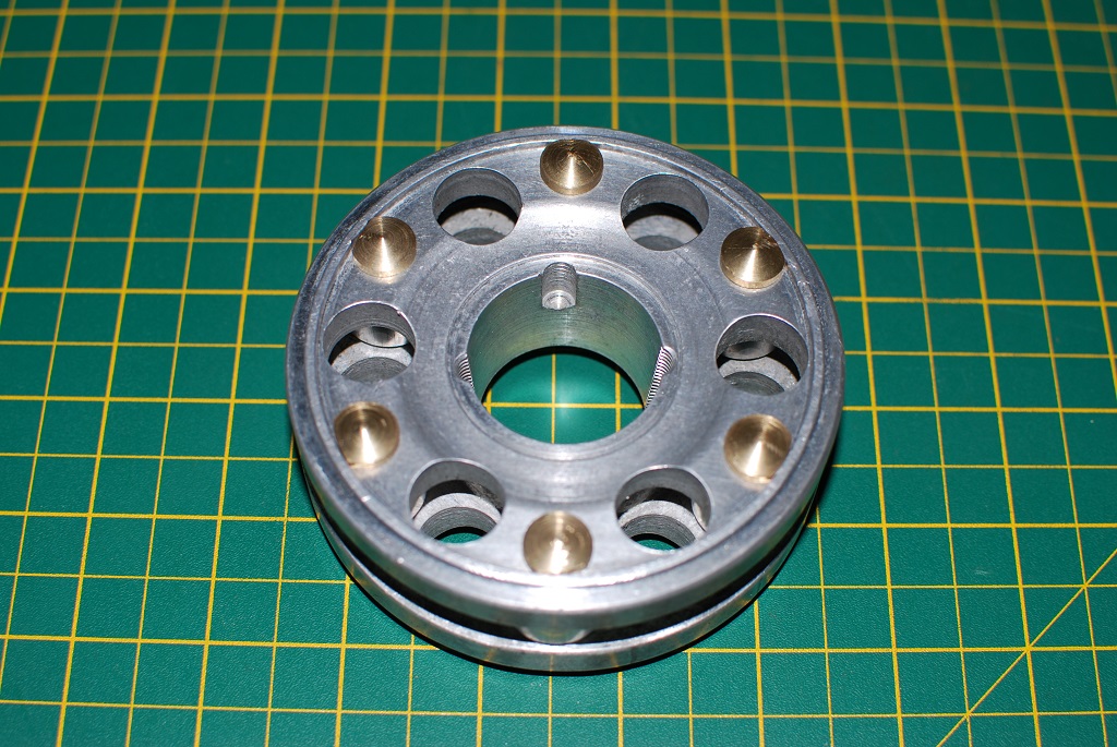

Here is one of the sprockets, fully loaded and ready to go back on the T34.
