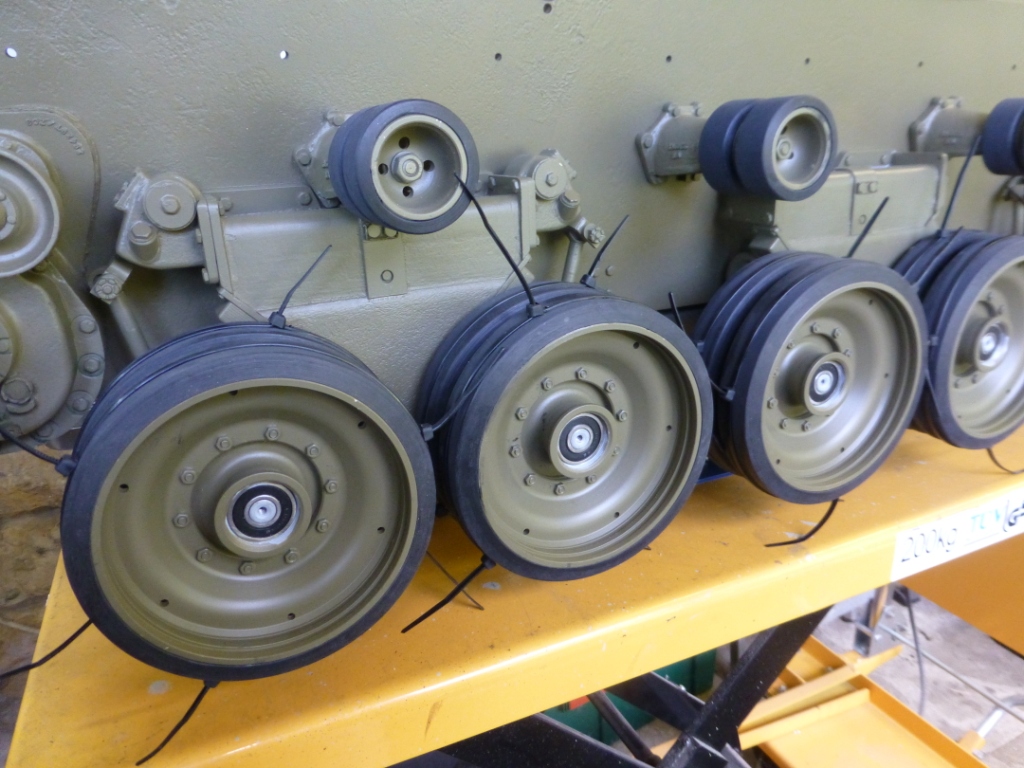

To ensure a continuous and close bond, cable ties can be used whilst the adhesive is curing:

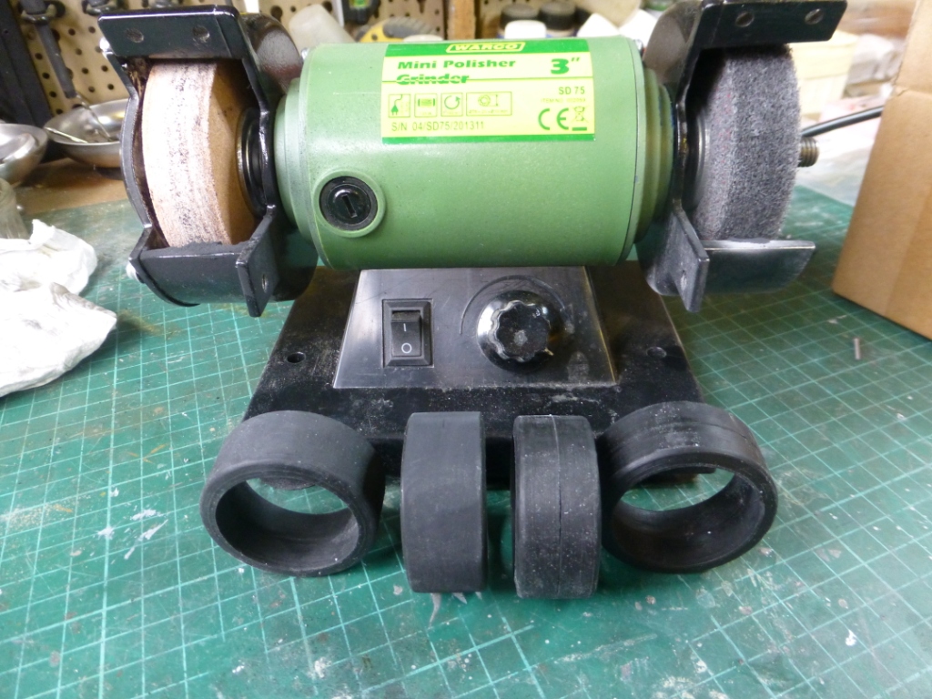

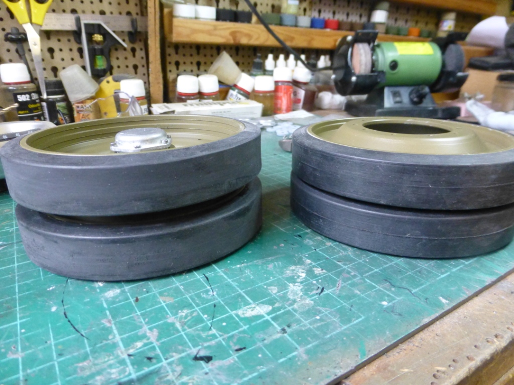

3. Finishing. As supplied, your tyres have a visible moulding seam. In use, this will slowly wear but for scale accuracy, the seam can be removed with careful use of an abrasive. If used with appropriate care, a small bench grinder can be used to speed up production:
