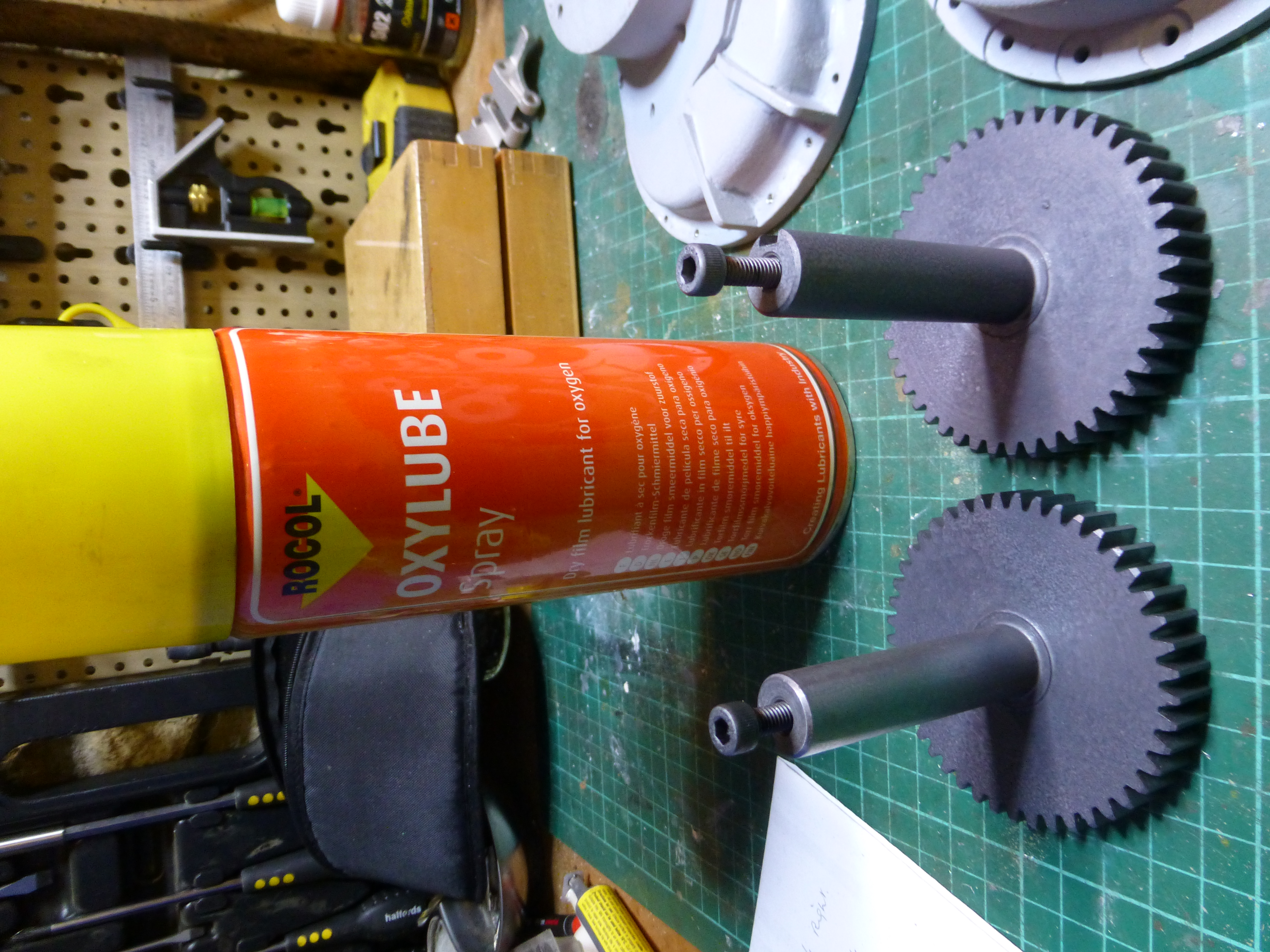

A number of dry, molybdenum based lubricants are available. The specification for Rocol Oxylube is:
Inorganic, resin bonded dry film of molybdenum disulphide in aerosol. Developed to lubricate sliding mechanisms such as plain bearings, pins, cams and slides particularly in vacuum environments.
•Designed for applications where contamination by aggressive chemicals or petroleum based solvents; oils and greases would destroy conventional lubricants
•Fast curing time
•Dry film lubrication – resists pick up of contaminants
•Prevents galling, pick up and seizure
•Suitable for fine threaded components
•Approved to Rolls Royce, Naval and NATO Standards. Also approved for Submarine Clearance
•Temperature range of -200ºC to +450ºC
Really useful that it's approved for use in Royal Navy submarines, if you intend fording.........

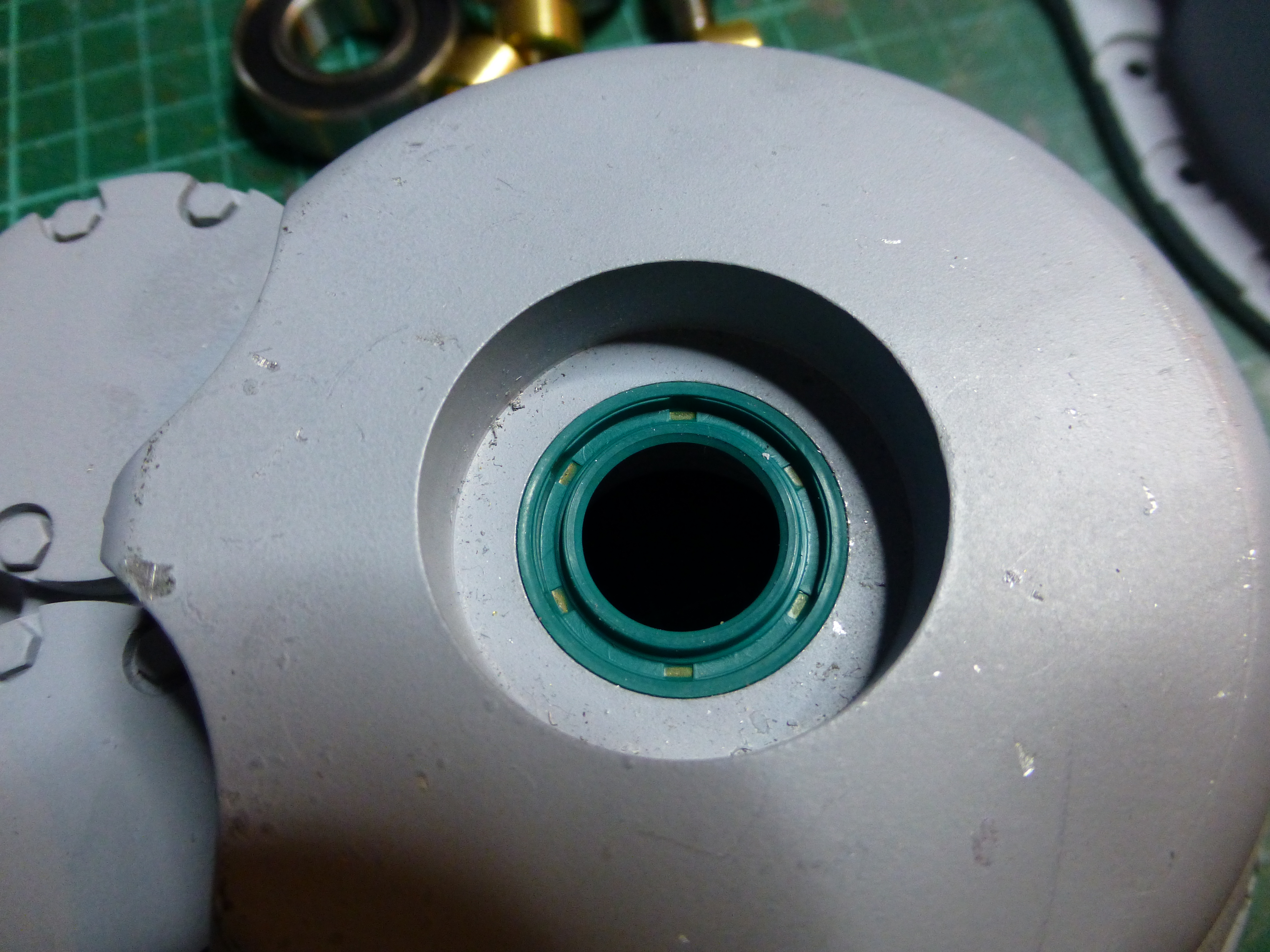

Final drive bearings are provided with external seals to prevent penetration of contaminants:

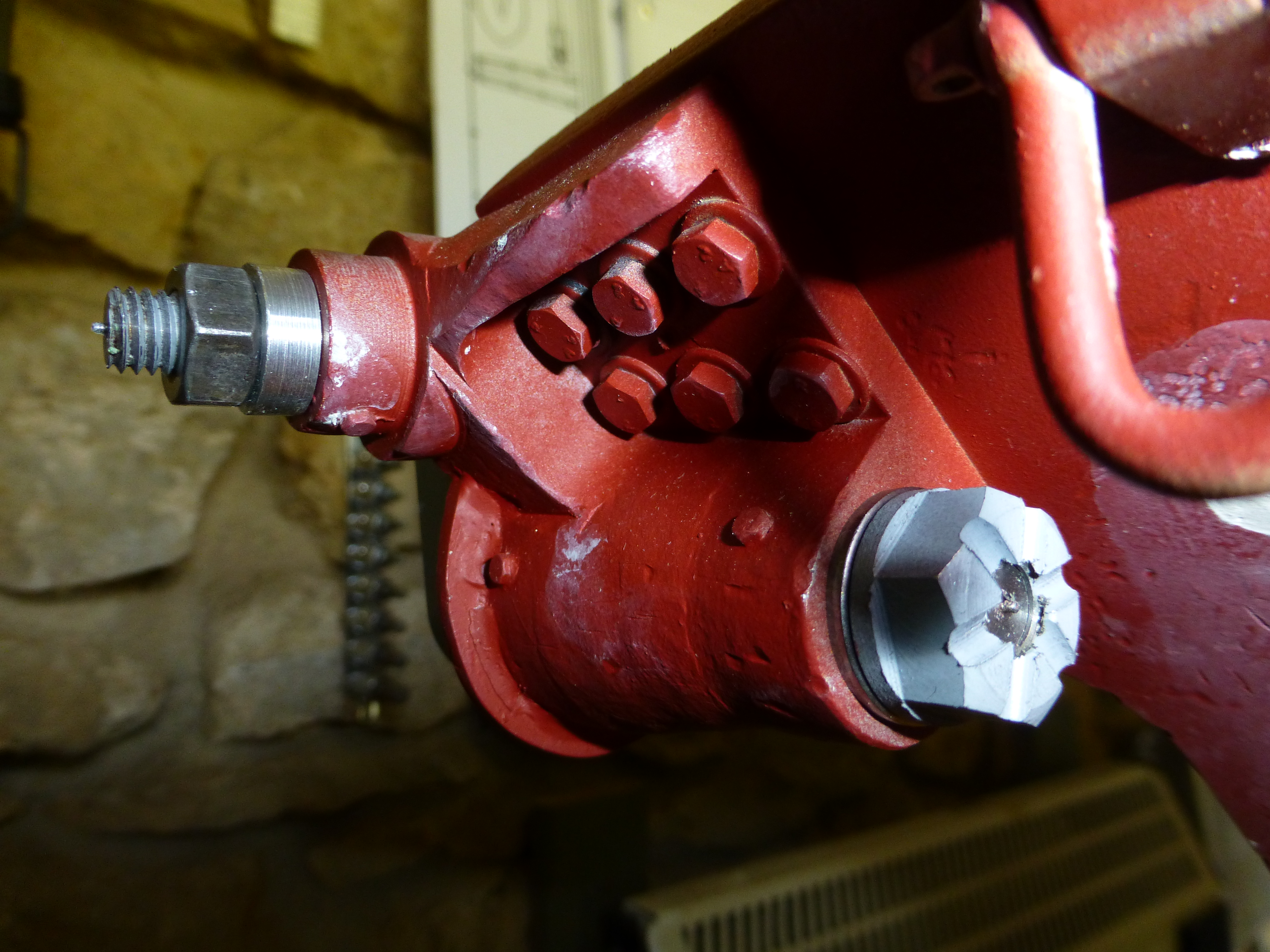

The general advice is to avoid wet lubricants on the drive train. The only exception is the threads of the external track tensioning mechanisms, which can benefit from a light application of molybdenum grease:
