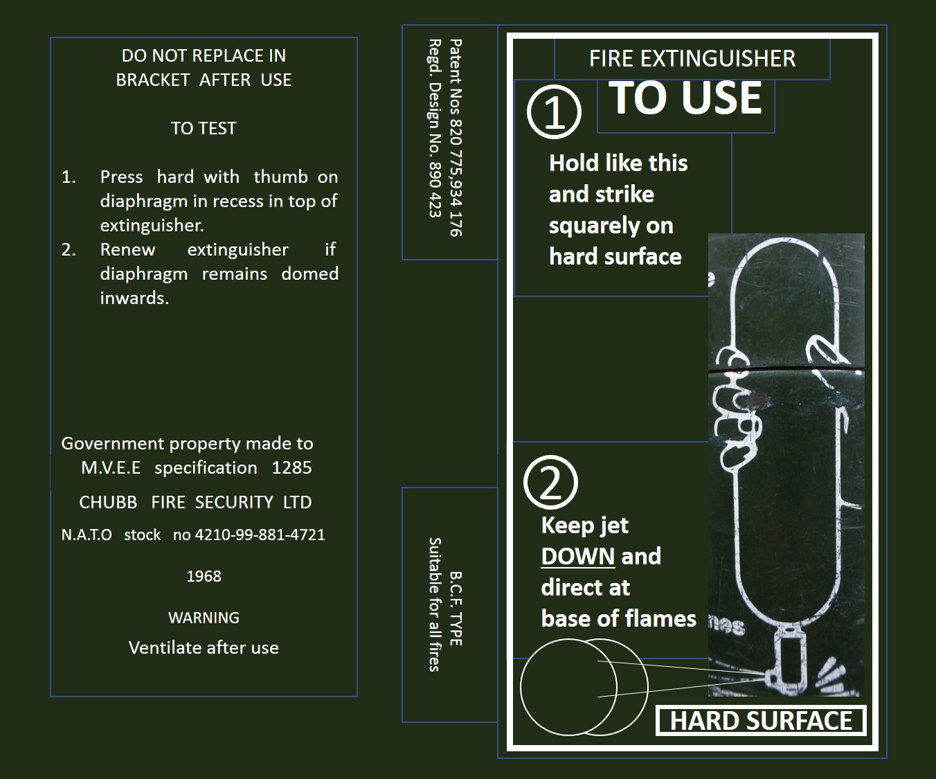

The second example is a fire extinguisher label. It's largely text, which is easy to create in Powerpoint, using text boxes. It also contains a graphic to show how to operate it, which would be very difficult to draw. The secret here is to use part of the reference photo to fill in the graphic.
The reference photo:
Text boxes drawn in Powerpoint:
Graphic imported into Powerpoint, cropped to size and inserted into decal:
It's worth mentioning that if you want to match an original colour in Powerpoint, there is an Eyedropper function in the Shape Fill Menu, which allows you to sample an original colour from a reference photo (here British Army Deep Bronze Green) and apply it to your decal. Very useful.
The decal is now complete, although you can see the join between the bit created in Powerpoint and the imported graphic:
