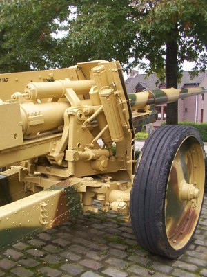

I'm trying to do some 3D printing to add details to my Pak 43/41.
I'd like to print the Notek convoy light, but I can't seem to find dimensions anywhere.
Would anyone have that information to share?

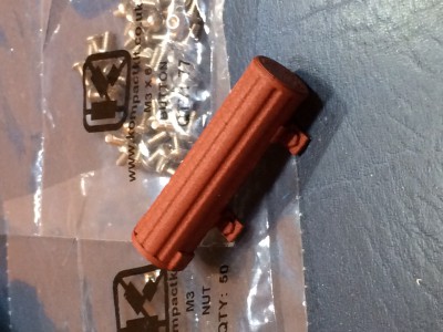

This is my first attempt at 1/6 scale modeling.
Here are a couple of items I've been working on: My version: These parts may have been in the acetone vapor bath a bit too long. They are a bit shiny, but paint may resolve that: This is the light I'm hoping to get dimensions for:

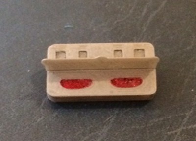

Re: Notek Convoy Light
Thank you Christian, for the photos and measurements.
Here's my first shot at it. I don't have any green fingernail polish...Have to talk to my wife about that.
I couldn't decide if I wanted the flap up or down, so I just put it in the middle.
Now I can work on the shield.
Gary

The German rear light notek had two half-moon windows down:
right it was orange and signaled the "stop" and was visible even with the metal flap down, the light left was a normal light red convoy.
Above, there were four green windows (in pairs) for the convoy night:
if the pilot of the tank that followed saw two green lights: good!
But if he could see four distinct lights green maybe it was too close!
I hope this link will be useful!
http://www.hobbyhavoc.com/oldhavoc/inde ... opic=664.0
The flap could not remain half open: the side there were four metal tabs lock.
You have to decide how best to place it.
