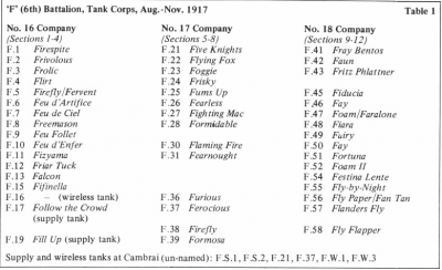

out of curiosity I had a look not too many about found this one though also found tanks names for f 6th battalion tank corps 1917 might come in handy
colin

Colin, thank you for your list of 'F' Tanks there are some good names there! I have settled on a B Battalion Tank, Bloodstone (II).

While looking through Steve's excellent build history for clues as to how he did the top rear armour plate I noted this earlier posting by Colin.colin fairweather wrote:out of curiosity I had a look not too many about found this one though also found tanks names for f 6th battalion tank corps 1917 might come in handy
colin
As an aside, you might be interested to learn that F30 "Flaming Fire" was another Beutepanzer, captured after Cambrai. She (as she was a Female) became "Lotte", also of Abt. 14, and was lost on 1 June 1918 at the Fort de la Pompelle in the same area as my "Liesel". While "Liesel" was removed and replaced in around 1926 for 'Health and Safety' reasons, "Lotte" survived intact until 1942.
How do we know this ? Well, basically, British paint was a lot better than German paint ! After a few winters the German paint wore away (except for the Iron Crosses), allowing the F30 on the front horns to show through clearly. I've got several postcards showing this.
Anyone doing "Flaming Fire" ? Certainly a tank with history .......
