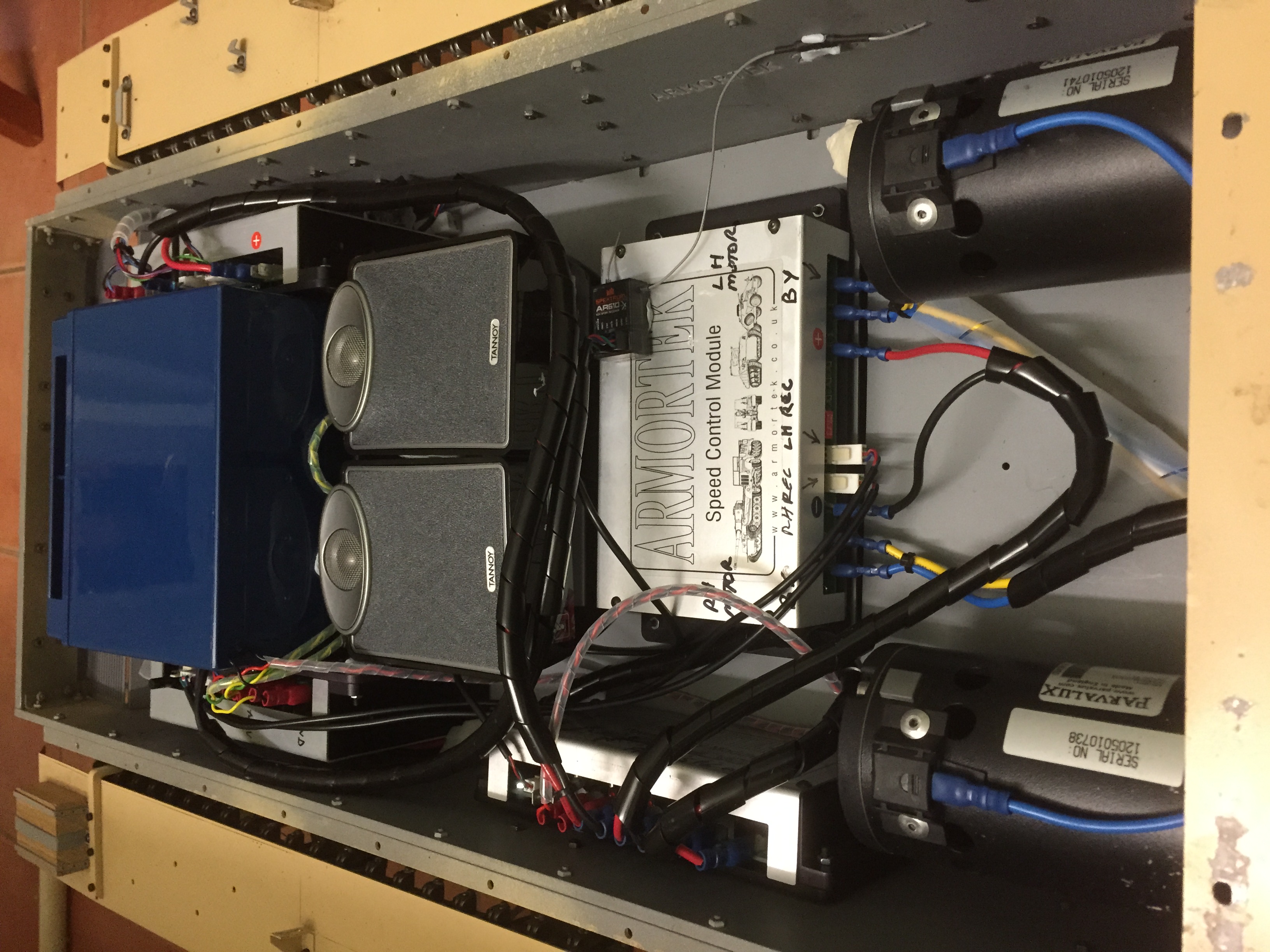

Re: StuG III 014 - A Team Effort
Amplifier Module Testing
The Amplifier module has been added and tested OK. See attached YouTube video. The sound card volume is still set low during the speaker run-in period (10 hours).
We tried a few different layouts regarding the module layout in the hull. One issue with having the larger modules like the Amplifier module and Auxiliary module vertically mounted in the centre of the hull is that the wires protrude higher than the hull side. When the fighting compartment goes on its flush with the top of the hull and protrudes inside the hull and crushes down on the cables.
So we put the Amplifier module and Auxiliary module further back so they are under the rear deck which sits higher than the fighting compartment at the sides. The modules are just blue-tacked to the side of the battery. Whenever the battery needs a charge we just pop the modules off the battery.
We also didn't mount the motor control module between the motors as we found that made the power cables to the motors inaccessible without removing the module.
The speakers were mounted lying down which projects the sound upwards and also because they are too tall for the fighting compartment if mounted vertically.
Next step is connecting the slew and elevation motors in the fighting compartment.
If anyone has any photos of the limit switches in place that would be useful. Also we're not sure how the gun recoil is supposed to work we can't find any mention of that in the guide. So if anyone had any tips on that it would be appreciated.

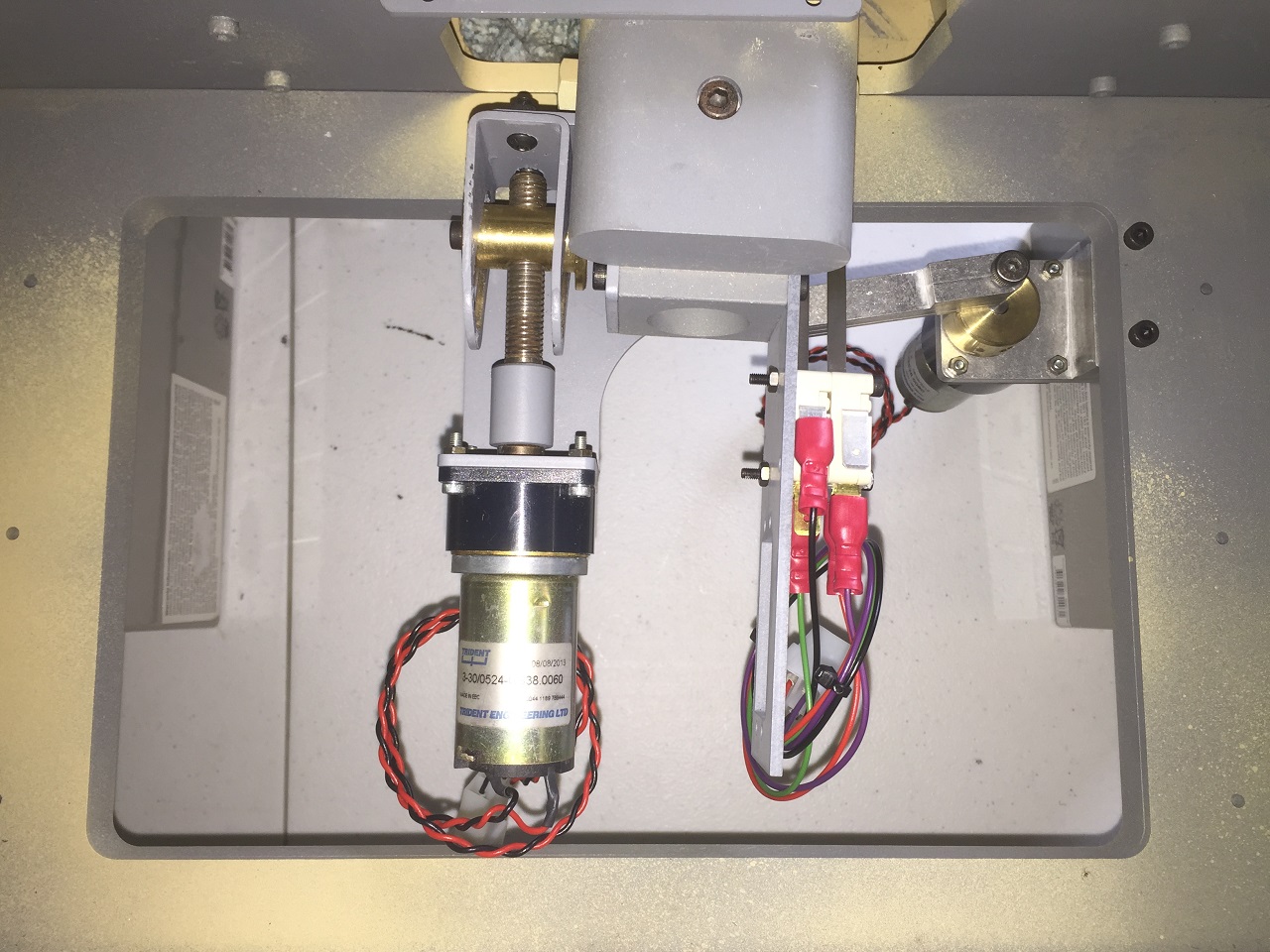

Mounting Slew and Elevation Motors
Mounting the Slew, Elevation Motors and Elevation limit switches wasn't too hard we had to replace some of the supplied fasteners for ones that fitted. Both motors are the same. Where ever the guide mentioned turret turn motor we applied that to the Slew function as of course the Stug doesn't have a rotating turret.
So far we've only tested the Slew motor and have used the rudder channel on the left joystick. Using a switch produced too much speed in movement. See attached photos and video of Slew motor in action.
Next we plan to try and set the limit switches and see if we can get the Elevation motor to work.
YouTube of Slew Motor in action.

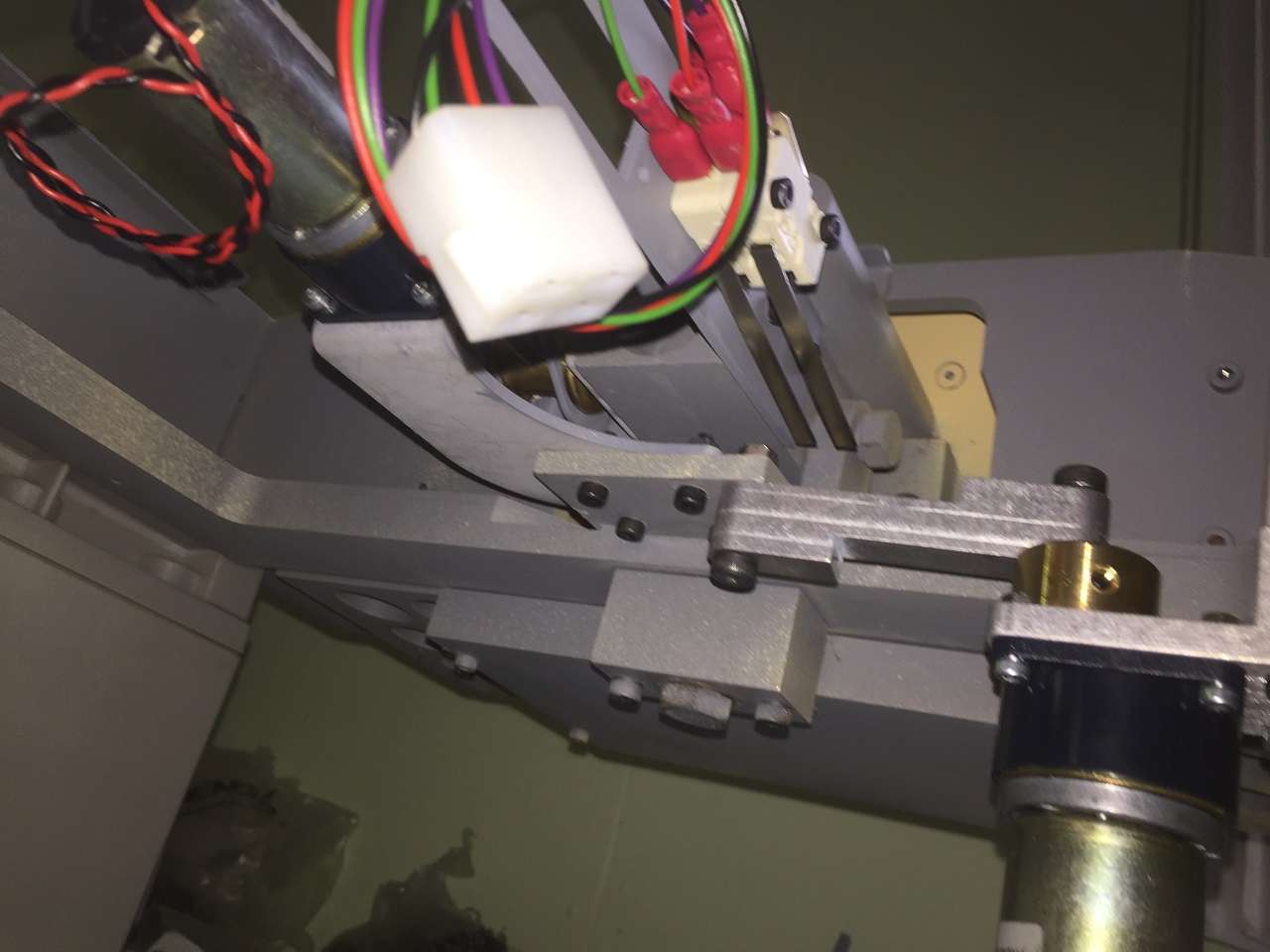

Testing Elevation Motor and Limit Switches
The first issue we had here was one of the limit switches was incorrectly wired out of the parts bag. The Limit switches have three possible connection points, two at the back and one on top (Common). You always need the common wired and either one of the other two connections points (giving normally closed or normally open). The metal finger closes the micro switch depending on the position of the finger.
Note the guide had the correct wiring connections so if you followed that you were right.
The one we had a problem with was wired with the two rear connections. (See photos for correct wiring).
We used the Aileron control on the Spectrum DX7s for the Elevation control.
The inside limit switch controls the up elevation and the outside limit switch controls the down elevation. Setting the outside one was the hardest as it contacted the conrod going the to top of the Slew motor. The conrod is narrow and can move so it required more tuning to set that one.
The up elevation switch is normally closed so it cuts out when the micro switch is depressed. The down elevation switches is normally open so the micro switch needs to be depressed for motion to occur. Once the finger loses good contact with the conrod it released the micros switch an motion stops.
If you listen closely to the sound in the YouTube video you can hear the micro switches clicking on and off.
Next challenge is the recoil kit.
