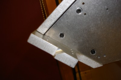

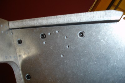

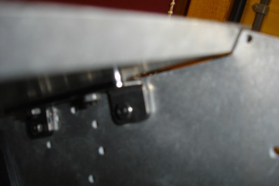

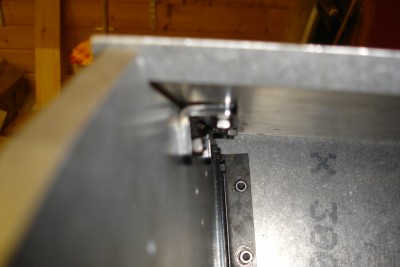

Hi guys, had my first tinker with my Centurion. Assembled the hull and tried to square everything up but found the front upper plate did not seem to fit flush to the side panels. The brackets appeared to be not bent far enough. Has anyone else experienced this? Is this the norm and do you just makes adjustments and tighten up leaving this gap?
Any suggestions would be most appreciated.
See attached
See attached

It is normal for the angle brackets to spring back slightly once bent, so a little adjustment may be necessary.
You may also find you need to clean up the edges of parts to make sure two pieces sit snugly together, whether that's deepening a cut or smoothing the sharpness off an edge.

Nothing unusual here, I had the same. There are three issues. Firstly, the lateral overlap (where the glacis plate is wider than the hull sides) mirrors the real thing. Mark has got the scale effect just right. Secondly, the brackets can be a little out. The easiest way to deal with it is to take a small modelling needle file, enlarge the holes a touch and drop the brakcets until the gap disappears. The third issue needs a bit more work with a flat file if you want the glacis to sit flat or normal to the hull sides. This is because the hull sides are not vertical. The small outward splaying causes the innner edge of the hull sides to sit slightly higher that the outer edge. The model will be perfectly OK like this and you could just fill the gap with a fake weld. Or you could take a file and relieve the edge until it is normal to the plane of the glacis. Either way is OK.
Hope this helps.
Regards.
Hope this helps.
Regards.

Hi, Adrian & Stephen
Thanks the reply and suggestions, I will file a little away just to make the plate sit flush to sides.
David.
David.

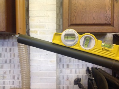

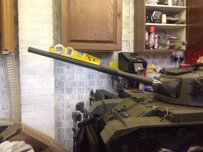

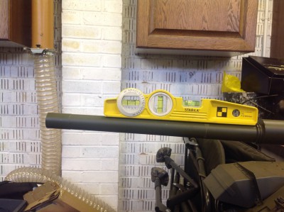

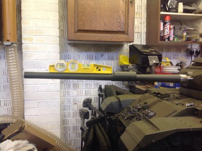

I have just had a tinker with turret and gun mantlet as I am waiting for some material to arrive. According to my research the gun depression was 10 degrees and the elvation was 18 degrees, but on fitting mine it was about 2 degrees and 15 degrees. Is this a normal fit for the model or can it be made to a depression of 10 and elvation of 18 degrees ?. will the motor unit allow for this much movement ?. (I do not have the motor unit yet)
Any suggestion would be most appreciated.

Not measured it myself accurately but I think you will be struggling to get that much elevation and depression .I don't think the motor will drive that far.You have to set the limit switches a touch shorter than the motor will drive or you start bending the recoil bracket inside .Better to be safe than sorry.
I will try and put some pictures up of mine tomorrow

Hi David,
Some pics of mine.I haven't done any fiddling with the elevation at the moment other than to make sure nothing gets bent.I still have the recoil to fit so I suspect I could get more deppression with a few adjustments.

I've just got onto the elevation question. As you say, the real vehicle allowed a nominal 18 deg in elevation and ten in depression for both the 20 pdr and 105mm. I've measured the current setup on my model as 7.5 deg elevation and 13 deg depression. I'm now going to remove material in order to achieve the full range of movement although as you say, the leadscrew will provide a finite range of movement. I'll post some pictures on my thread. With the current setup, any fouling can be avoided by setting the limit switches but I'd like to achieve a range of movement more representative of the real vehicle.

Hi StephenStephen White wrote:David (and Chris)
I haven't actually tinkered much with this at the mo.The limiting factor appears to be the lead screw.I can't say I have noticed any material clashes.Having said that, mine may have already been work on.
I like your idea for the linear actuator.I have seen some German (Panther) I think on you tube using this method.
