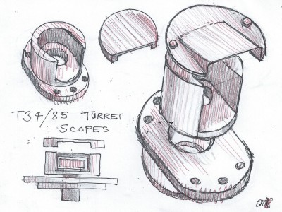

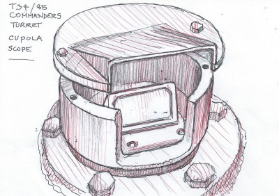

Hi Folks,
Turning my attention to my T34-85 Turret, having a go at upgrading improving Armortek periscopes for the cupola and turret roof. Quite straight forward simple alterations in changing them into working swivel periscopes.
Cheers for now
Ian
from Glasgow

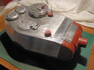

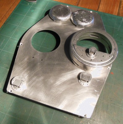

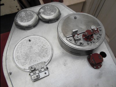

Here's a update on my slow progress on my T34/85 Turret Roof, hatches periscopes etc.
Cheers Ian
from Glasgow

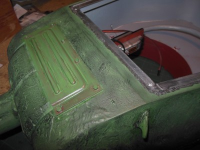

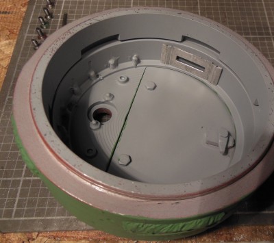

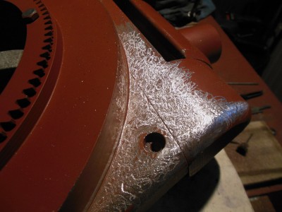

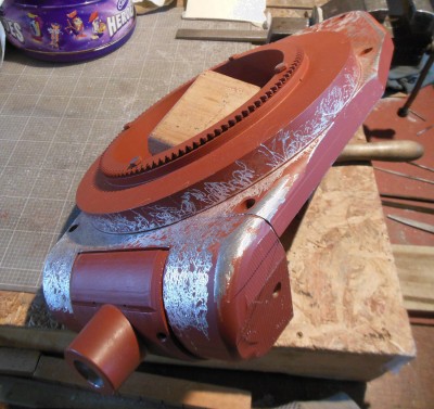

….next I had a go at rough casting my T34 turret, by roughing up the surfaces on the walls and base. Later I will add epoxy putty metal to build up certain areas, before I prime and paint eventually.
Cheers Ian
from Glasgow.

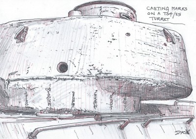

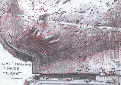

……not forgetting my drawings I like to create to get the feel of the subject matter.
This time of the rough castings of the T34/85 turret etc…..
Cheers Ian
from Glasgow.

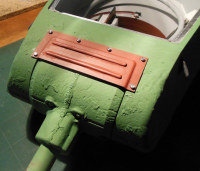

Continuing on with my rough casting of the T34/85 Turret and other details.
More to follow!
Ian
