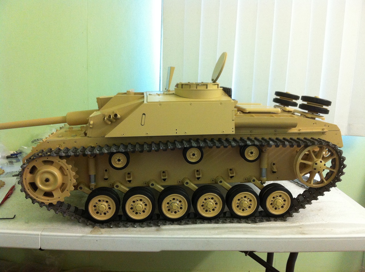

Tracks
At last a job where you can put your mind in neutral. it was quite meditating building the tracks. The guide mentions about 97 links per track loop. We did 93 with the suspension unloaded and no weight on top.As mentioned in the guide that did loosen up over a couple of days of the kids spinning the tracks around. We then put the fighting compartment and rear deck on and managed to take out one link making it 92 links. The track is certainly tighter but eventually with drive motors and batteries etc we expect the suspension to sit a little lower. Let us know if you think the track looks to tight in the photo. (92 links). We just put primer on the track pins.

Rear Deck Accessories
We applied the engine vent mesh, spare road wheels and barrel cleaner. The barrel cleaner actually has three parts but we couldn't fit the third rod in, but you'd have to be expert to notice it missing. Also with some of our spare tracks we loaded them into the purpose build rack on the back of the fighting compartment. This was common in the historical photos and looks good we think.
We are also pondering getting another one of these guards from Gil and Mark and mounting on the front loaded with some extra track links. We think we'd be able to tap the extra holes needed.
We've also considered mounting the spare wheels on the side of the fighting compartment held on by the tow chain, however haven't got detailed enough photos to see how it was actually done in practise.
On that front quite a few crews hung track links on the slopped upper surfaces however again we can't see from the photos we have how they were mounted.

Rear Deck Overhang
We'd like some advise on the Rear Deck Fit. With the fastener holes lined up the Rear Deck doesn't sit flat on the hull top due to a small amount of overhang on the rear of the upper surface. If we slide the Rear Deck back a few mm it will sit flat but the fasteners don't line up and also you end up with a few mm gap to the fighting compartment.
We plan just to shave a bit off the rear of the upper surface but wanted to check in case we were missing something. A 1:35 model we have appears to show some overhang.

Thanks Lacopo your explanation was very thorough. We are not machinists and have only basic tools so we thought from your explanation we have two options.
1) Grind a chamfer at the top of the rear plate like your photo of the full size panzer.
2) Trim the excess off the rear overhang, which is not true to the original design.
We'll try option 2) as the easier option since the rear plate is 8 mm thick and grinding a chamfer on that is a bigger job.
Only expert eyes like yourself would notice that it's not quite right.
