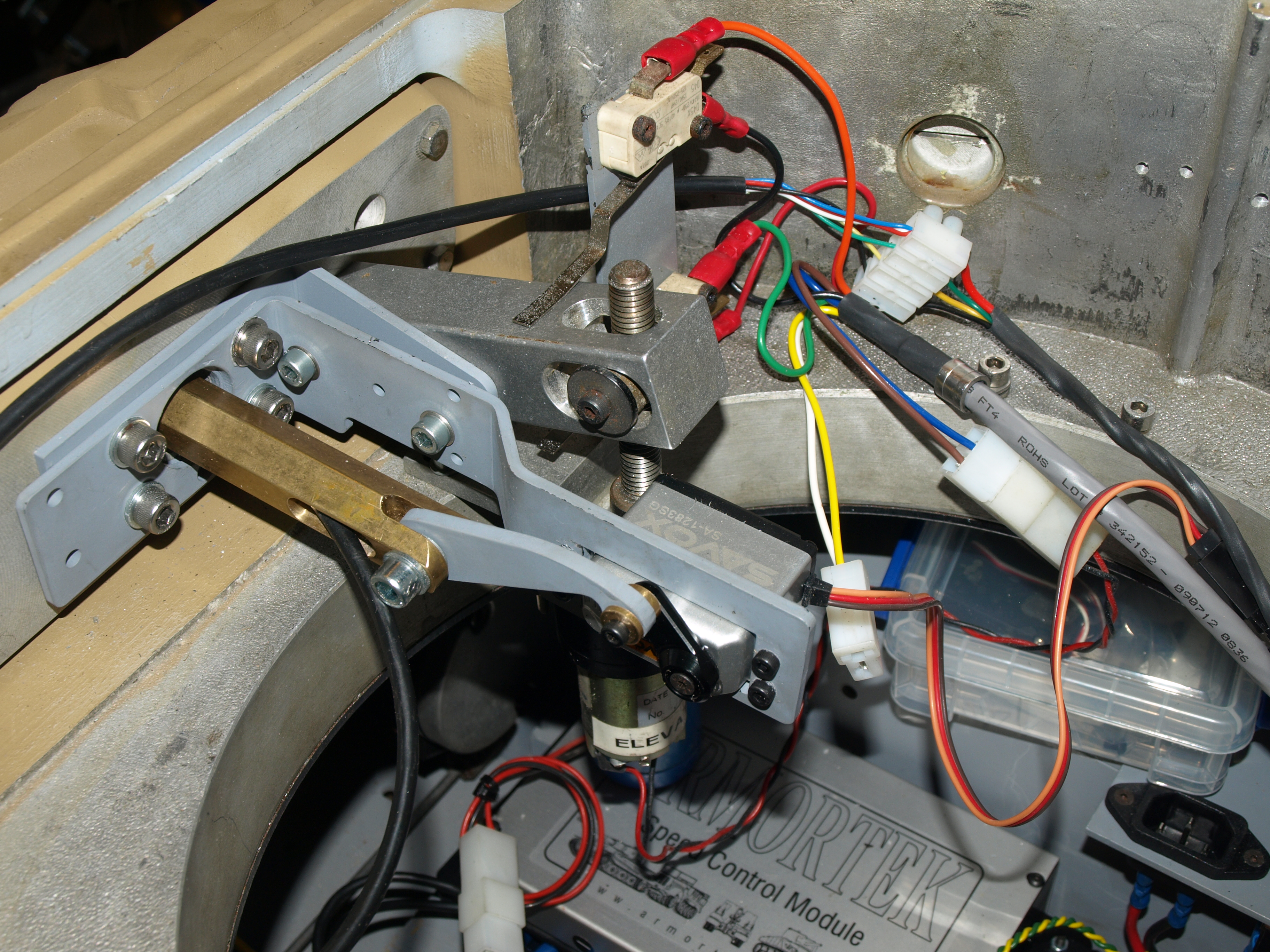

That Looks sharp1 How do you control the Servo ad the brackets are homemade?? Martin
- Posts: 779
- Location: Oxford
- Has liked: 264 times
- Been liked: 195 times
Re: Eary Tiger Recoil
Hi Martin
The Armortek Recoil Module is located out of view within the Hull. The Bracket for the Servo is the one supplied for the late Tigers, but with a few extra holes drilled to mount it onto the Mantlet and to secure it onto the Elevation Bracket, to strengthen both.
The thing that is home made is the linking arm from the servo, I made this so that it would hook over the servo arm so that at no point in the arm's movement would the link foul any part, because I think I have the servo in facing backwards.
My next thing is to find out the correct position for the Gun Barrel?
