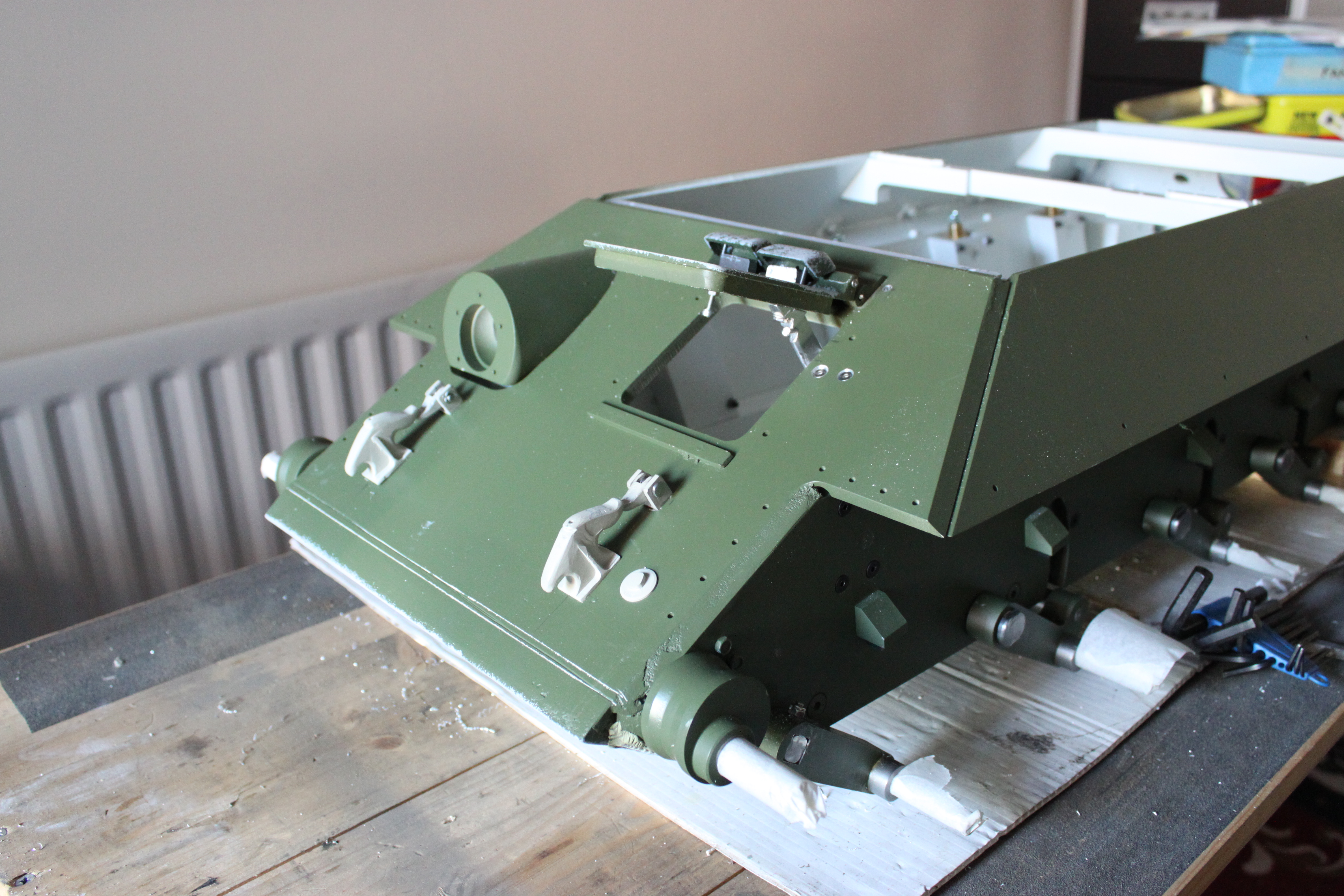

I have been following progress builds on the Armortek Forum on various members T34s. I have reached the stage were I would like to change my rounded Front Stretcher to the sharp angled shape I prefer to the rounded one that comes with the T34 kit.
I noticed that Phil has a nice sharp angled to his front stretcher on his T34/85 kit. What I want to know is how he and any other builders go about making this part! and if anybody else has pics of this particular build up, I would be most interested in seeing them.
Ian
From Glasgow, Scotland
Ian

Re: FRONT STRETCHER FOR T34/85
Hi Ian
I just found a peice of thin aluminium angle section,I think it was
10mm x 15mm x 1mm.
I used epoxy to fix it to the rounded front and if I remember right the longer
leg was downwards and the top was level with the uper front.
I finished the joints with miliput welds but I sanded the top one flusher
so it looked a bit like a ground weld.
The little bit of open end to the angle i filled with milliput and sanded
it level but not so much as to see the metal angle shape.
Later I spotted two little brackets on the front of some T34-85 and I made a
pair and these were glued with althread studs witch just nicele went through the
angle and into the "D" front,further strenghthening it.
Hope this helps,There should be some pictures in my earlier postings.
Phil

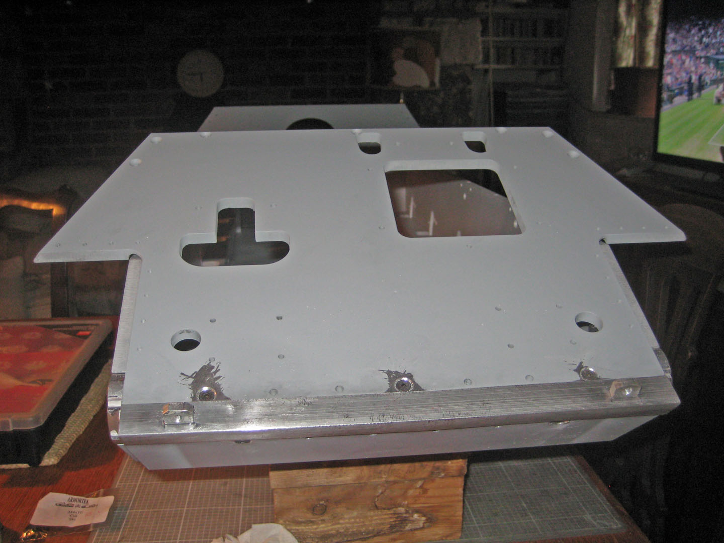

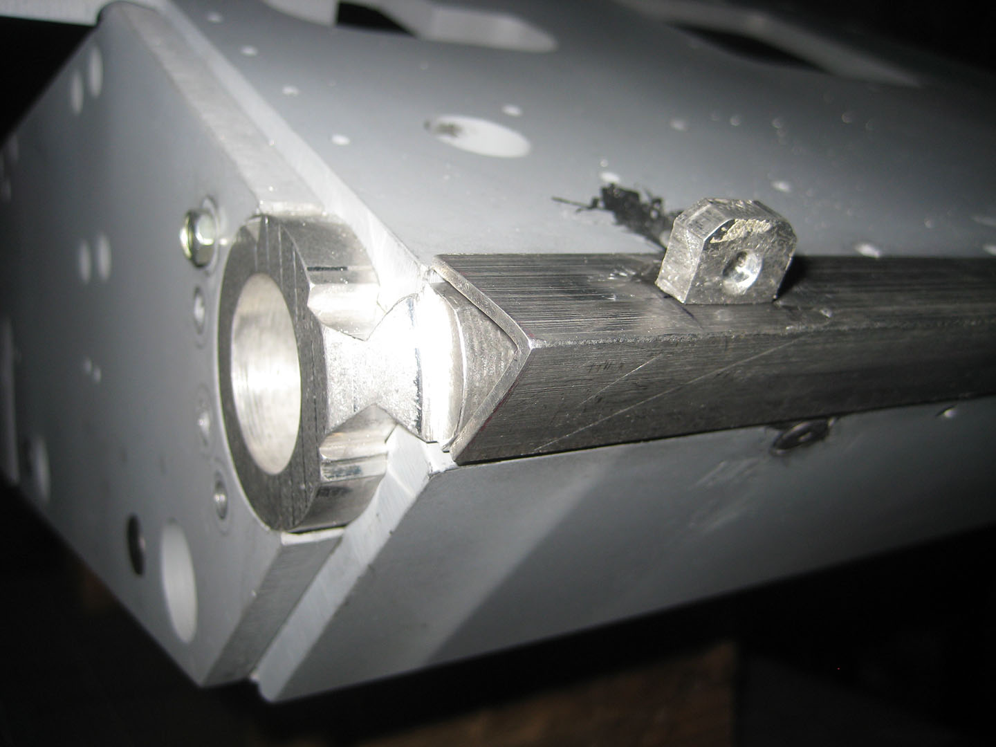

I wanted the 'square' front too. I made it from aluminium bar, shaped to fit and bolted to the nose.
John.
John.

Thanks for showing me your pics of your T34/85, suppose to be showing me the sharp end so to speak!
Unfortunately your pics only show the top half's and the lower half's are all grey, blocking out your front stretcher, which you wanted to show me the aluminium to the nose with the 'square' front?
Perhaps if you don't mind trying to send your pics again, so that I can see the whole picture this time!
Ian
Ian

Try using the sliders at the side of Johns pictures then the
bottom comes into view.
Works for me
Works for me

As Derek says, the pictures look fine to me also. They are uploaded to this site which puts the sliders on the sides.
if you want more pictures , see my build thread 'T34/85 #007 taking shape'.
John

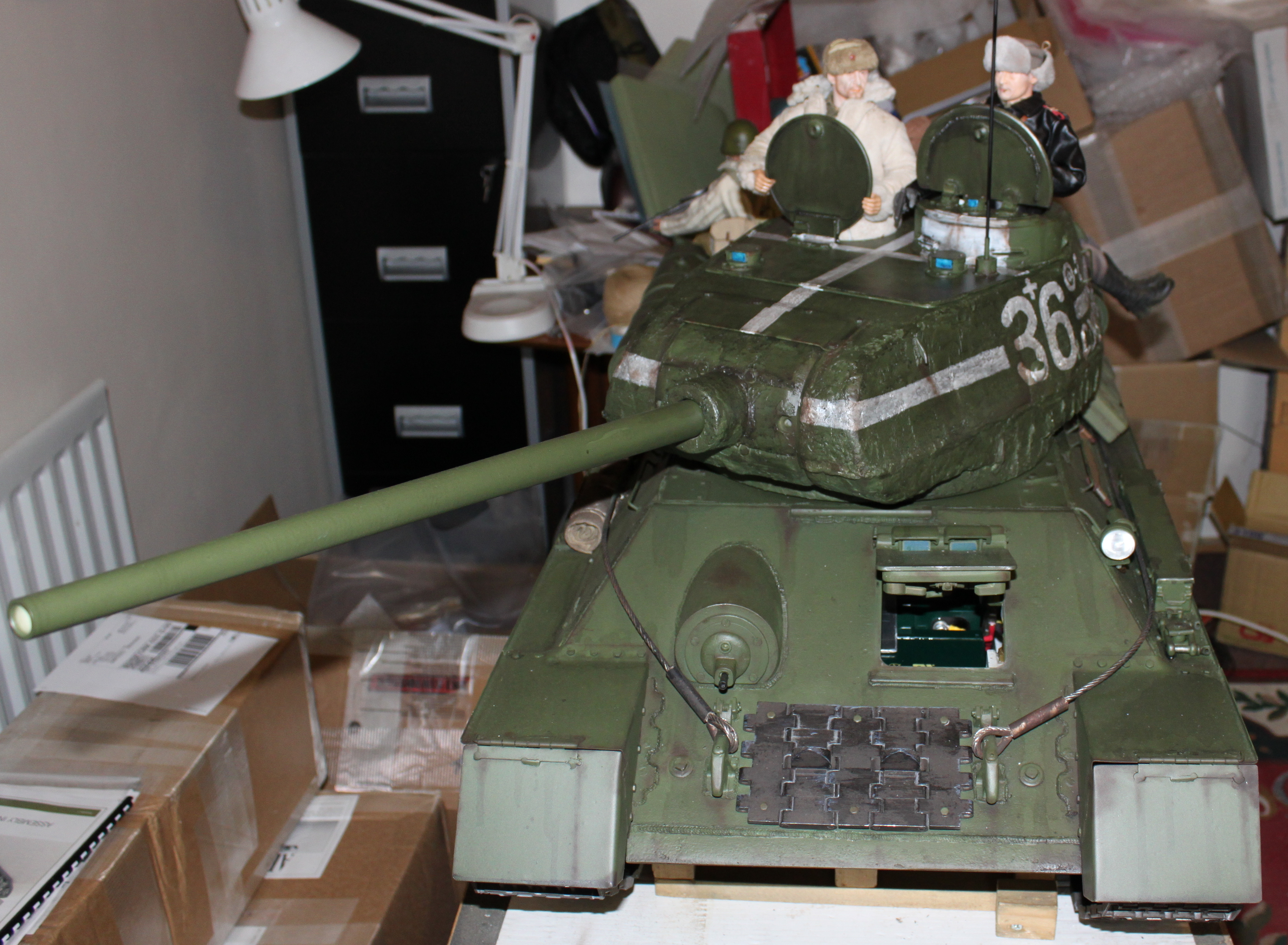

Just an update on my progress on my T34/85 Front Stretcher. I managed to change the rounded stretcher original part into a more angled sharp look for my tank, hope it look's right to your expert eyes! I just need to counter-sink my screws etc.
Cheer
Ian
Cheer
Ian

Yes that front will look good when you have it all filled and painted
and the screws hidden.
Phil

Thanks for your comments on my front stretcher, I've added the two small eyed hooks onto the stretcher now before filling in the two ends.
