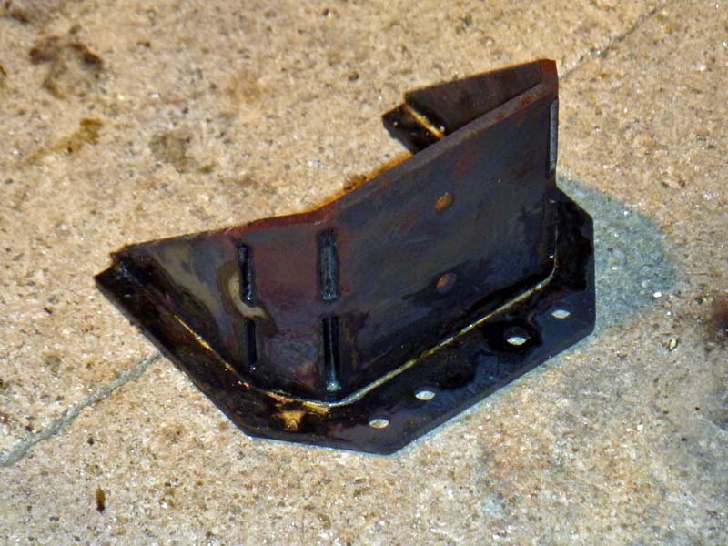

Here's something I've been working on for quite some time now :oops: :oops:
The return roller brackets on both Sherman models have been simplified for production purposes so I was interested to see how easy it would be to improve their accuracy.
It starts off with two pieces of 2mm steel.
Picture 1.JPG (34.1 KiB) Viewed 4524 times
I've made up two of the most common bracket shapes. An M32, which used to be a gate guardian at the REME museum, had both types fitted, which was handy for measurements and photographs.
I've added slots and tabs in in order to better align the piece when soldering. It also helps as the sides are quite springy, so they hold the parts together.
These prototype parts have slits cut into them to make the bending easier, but as they're only 2mm steel, I hope to be able to make up a jig to be able to fold them without the slits.
I had hoped to fill the slits with silver solder but I can't get a good enough separation between the different areas, so I end up reheating the main join. These ones are simply filled with JB Weld.

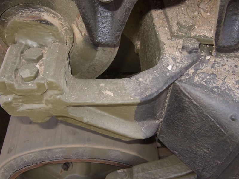

Next, the parts are silver soldered together.

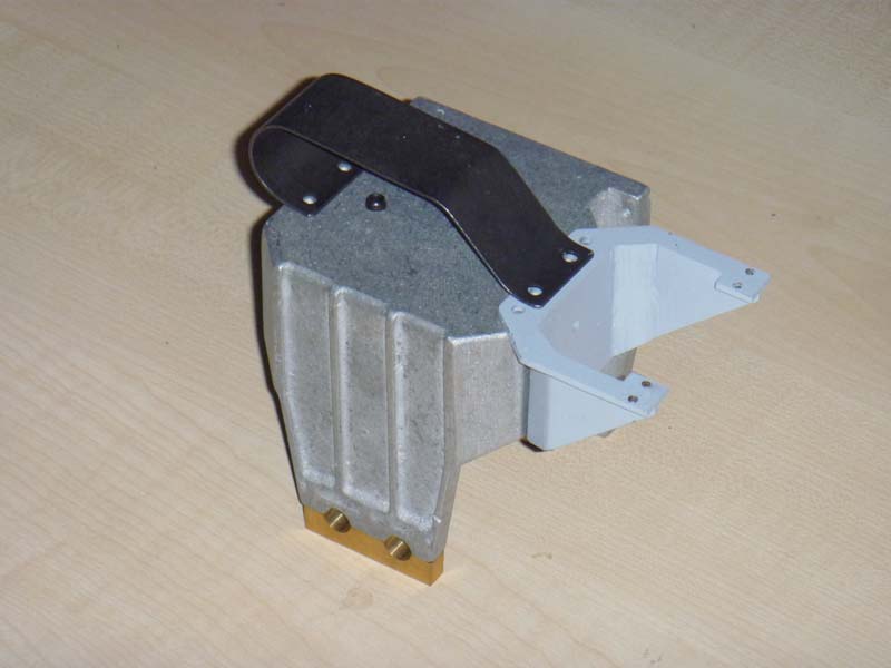

It's quite a while since I've done any soldering, so I made quite a mess of the first one. I gave this one more time and preparation and the result was much much better.

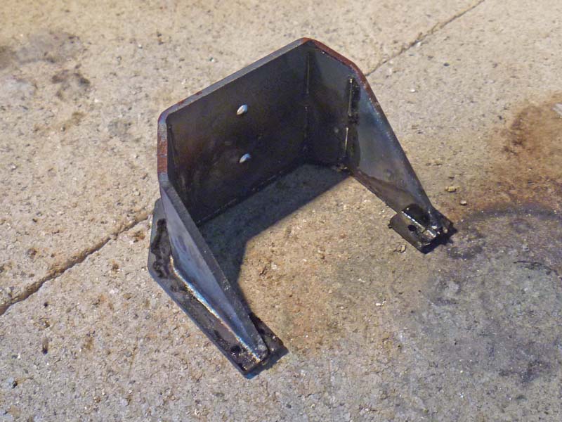

This is how the part looks installed on the bogie housing.
Picture 4.JPG (49.42 KiB) Viewed 4523 times
I've gone for four holes as that is how the original was mounted. I plan to fit four dummy bolt heads to the inside face and use CSK screws in the mounting holes, which can then be hidden with filler.

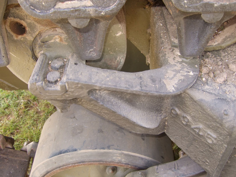

Finally, a quick comparison between the stock part on the left and the new part on the right.
Picture 5.JPG (52.58 KiB) Viewed 4523 times
I should probably have sprayed the stock part with primer as well, to give a better contrast to the piece, but I'm sure you get the picture.
